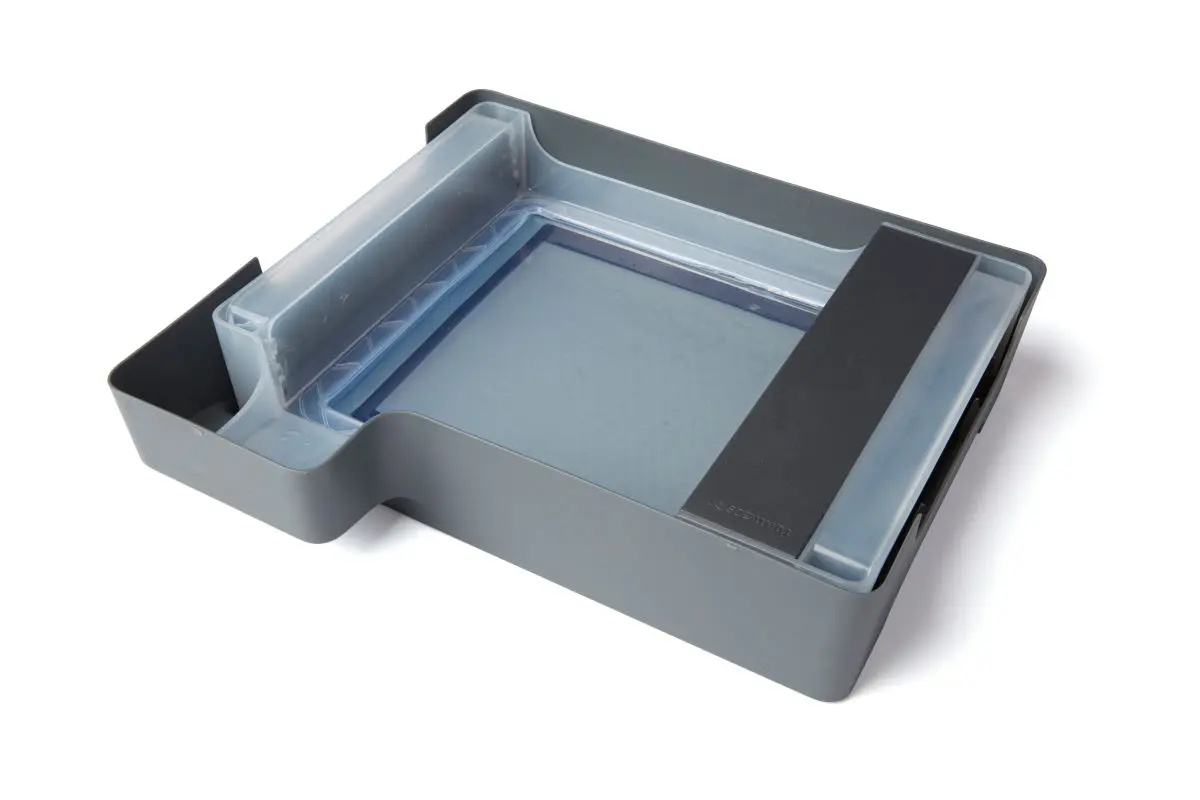

Resin tank in case, open

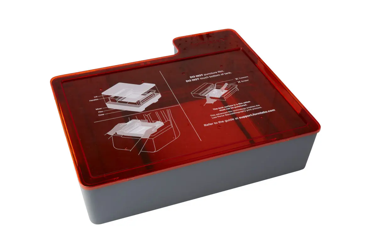

Resin tank in case, closed

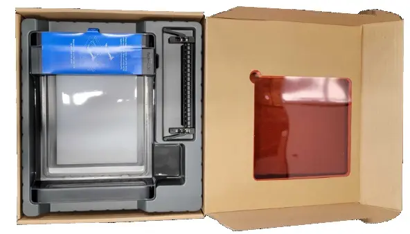

Resin tank in updated shipping box, open
