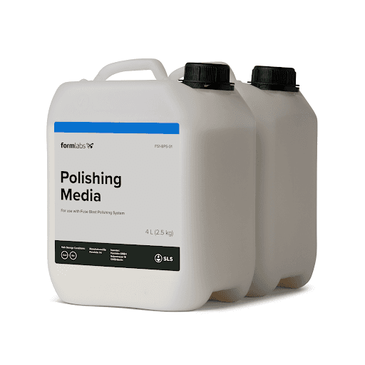

The Fuse Blast is only intended for use with Formlabs recommended media: 200–300 µm (50–70 mesh size) glass media (available globally from many sources) or Fuse Blast Polishing Media (supplied by Formlabs). Using other media types may interfere with operation or damage the machine. Contact Formlabs Support before attempting to use any foreign media.

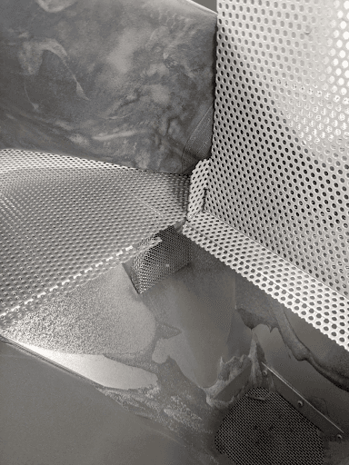

Do not overfill the blast chamber chute when adding media into the Blast chute, or you may clog the air inlet.
