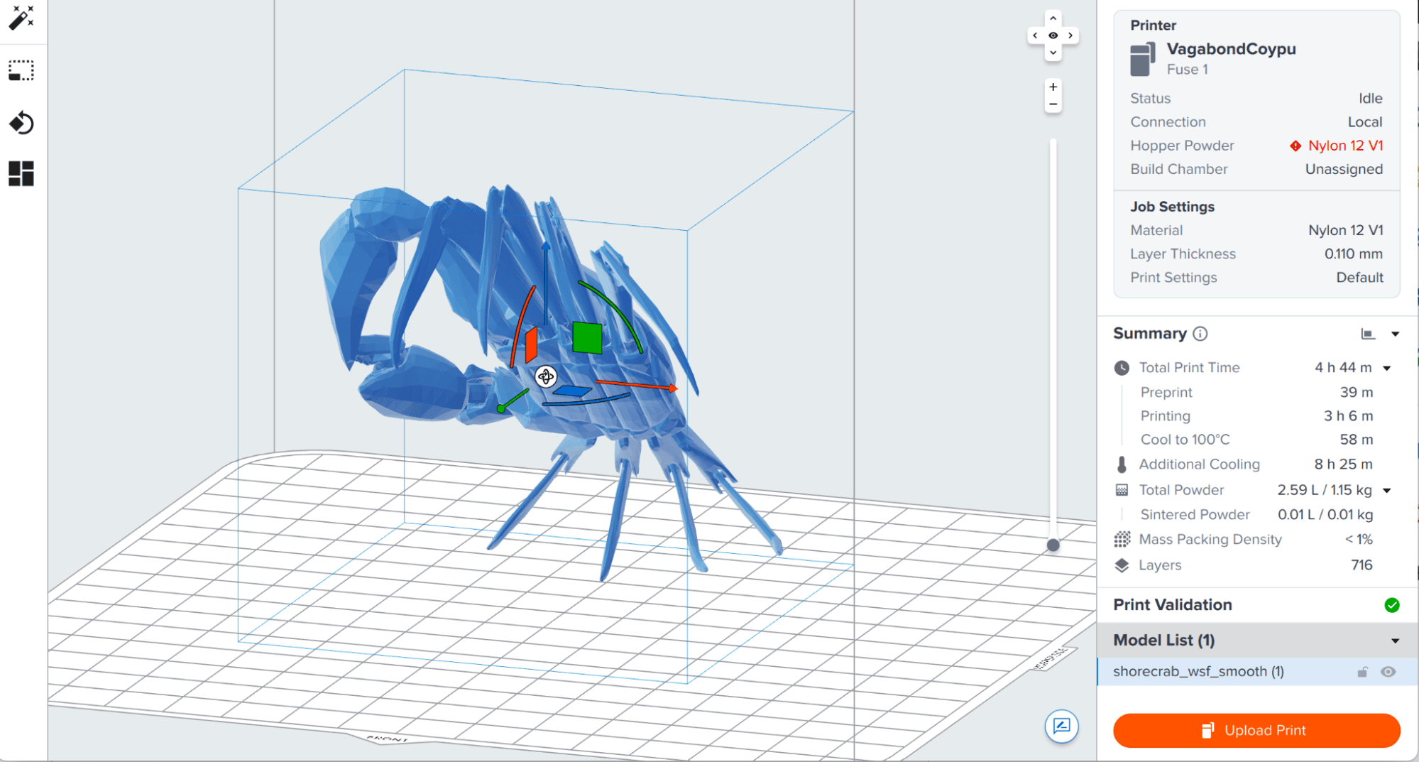

The Summary panel shows the following information:

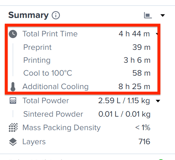

Total Print Time (SLS)
The Total Print Time is a rough estimate of how long your current job would take to print and initially cool within the printer. It updates each time your model is adjusted in PreForm. Click the refresh icon after making changes to see the calculated Total Print Time. Different part layouts and orientations affect print times. To help reduce print time, refer to Model orientation best practices for SLS printing.
The Total Print Time is divided into different stages of the printing process: Preprint, Printing, and Cool. The Additional Cooling time is the amount of additional time it would take for the powder cake to cool to room temperature within the printer.
Print stages
alttext
Preprint: A series of actions the printer takes to prepare for printing. During this time, the printer performs an initial set of tests to confirm its operational state, prepares the printing bed with powder, and brings the build chamber up to temperature.
Printing: The time it takes to sinter all parts, including post-coat layers and the print label.
Cool: The time it takes to cool the build chamber and print down to a temperature at which it is safe to remove from the printer. For example, for most Formlabs SLS powders, this temperature is 100 ºC. You may need to allow the build chamber to cool outside the printer before recovering your parts with the Fuse Sift.
Additional Cooling: The time it takes to cool the build chamber to nearly room temperature while inside the printer.

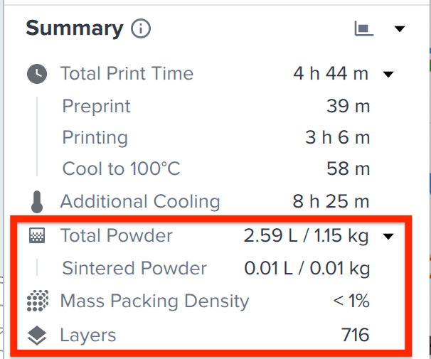

Understanding powder usage (SLS)
alttext
Total Powder: The total amount of powder (sintered and unsintered) it will take to complete the job. This includes the powder required to prepare the print bed and insulate the print walls.
Sintered Powder: The total amount of powder that is sintered in the build.
Mass Packing Density: The percentage of sintered powder versus unsintered powder by mass. The formula is Sintered Powder Mass / Total Powder.
Layers: The total number of layers a print requires during printing. This does not include preprint or post print layers.
Moving the Summary panel
The Summary panel can be undocked from the right panel to display on the left side of the workspace. When it is undocked, you can minimize the panel to display only the Total Print Time, Volume, and Total Print Cost (SLA) or the Total Print Time and Mass Packing Density.
