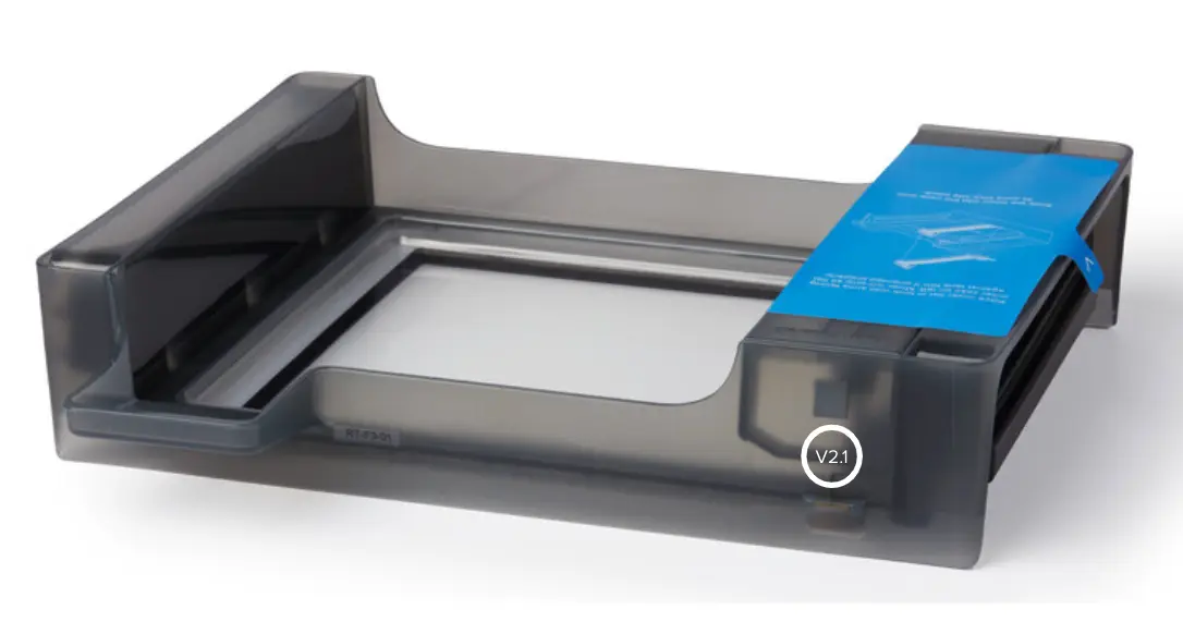

Form 3 Resin Tank V2.1
  • SKU: RT-F3-02-01
  • Prints with all resins compatible with the Form 3/Form 3+ and Form 3B/Form 3B+
  • Required for printing with Castable Wax 40 Resin
  • Features a small V2.1 sticker on the back left of the tank, above the ID chip
  • Manufacturing process change that improves the chemical characteristics of the tank’s print film.
Note:
Replaced the Resin Tank V2 as the default resin tank for the Form 3/Form 3+ and Form 3B/Form 3B+ as of January 2021. Please see formlabs.com/store for more information.

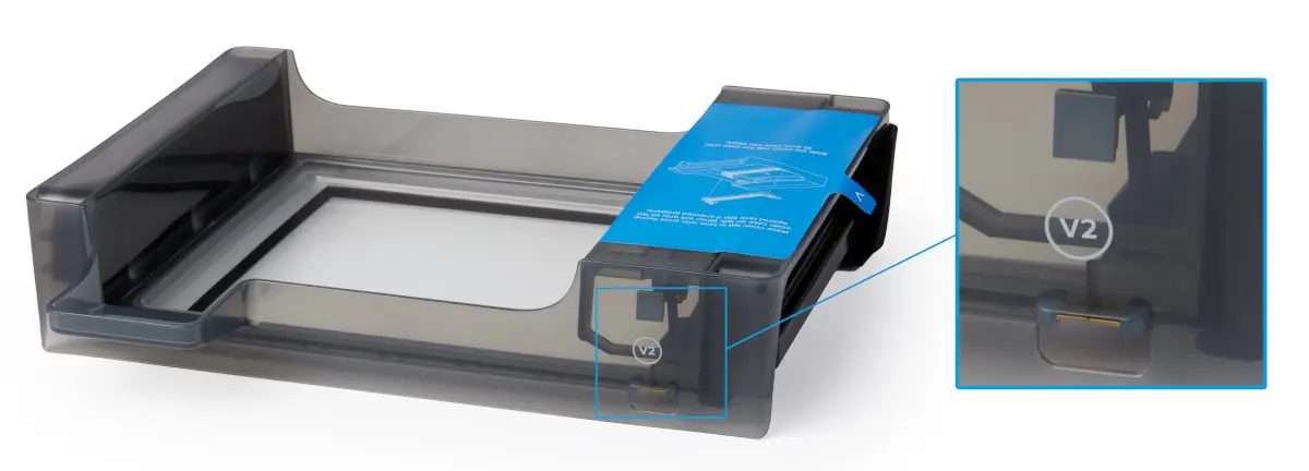

  • SKU: RT-F3-02
  • Incompatible with Castable Wax 40 Resin
    • Form 3/Form 3B/Form 3+/Form 3B+ printers will not fill a Resin Tank V2 with Castable Wax 40 Resin.
    • Form 3/Form 3B/Form 3+/Form 3B+ printers will not allow printing with Tank V2 and Castable Wax 40 Resin.
  • Features a small V2 sticker on the back left of the tank, above the ID chip
  • Replaced the Resin Tank V1 as the default resin tank for the Form 3/Form 3+ and Form 3B/Form 3B+ as of January 2020.
Form 3 Resin Tank V2 sticker
