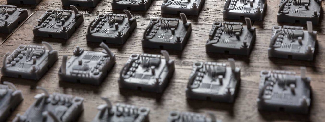

The Formtest in the Lab
At Formlabs HQ, the Formtest is probably the most frequently printed part, other than the Rook (which you can request as a free sample).
The Formtest is the 3D model used at Formlabs to evaluate our printer's performance.
Any time we make changes or introduce new software, process, material, or resin, we use the Formtest to evaluate the most important performance aspects. Even if the change or new development passes validation testing on the first attempt, the team still prints between 16 and 32 Formtests to make sure that all is well across several printers and that print success is repeatable.

Anatomy of the Formtest
After several attempts at theorycrafting the perfect test part and multiple rounds of practical iteration, the Formtest v1 emerged as a good compromise between intended goals, degree of difficulty, and practical considerations like print time and resin usage. After all, reliability testing means having to print multiple hundreds of this particular part.
The Formtest v1 contains features for all four categories mentioned before as well as a fifth “functional” category to relate the results to real world applications:
  1. Positive features: wires and two sets of walls.
  2. Negative features: holes and two sets of slots.
  3. Structural features: two sets each of bridges and overhangs.
  4. Dimensional features: base and octagonal-base cylinder with known dimensions.
  5. Functional features: M4 nut hole, M4 bolt, M4 threaded hole.
The range of sizes of the positive and negative features were chosen such that the smallest of each should be just achievable on the average Form 2 printer. Any loss of quality is immediately indicated by the absence of the smallest feature, like the thinnest wire or the smallest hole. More severe diminishing of print quality will result of the absence of the next smallest feature and so on, allowing us to grade each set of features on a scale of 0-5. The Formtest is designed such that certain qualities, on average, are just within the capabilities of the Form 2. We’ll talk more about this in a future post.
We print hundreds of copies of the Formtest whenever we're developing new printers, materials, or software and score each part printed. This allows us to iterate on our work until the change passes the test.
Structural features, like bridges with spans of varying lengths and overhangs of obtuse to acute angles, serve as indicators for loss of green strength, changes in peel forces, and issues with layers on the underside of parts. Again, the score here is discretized, but on separate scales.
To determine dimensional accuracy, both orientations of the base and the four orientations of the cylinder can be measured with a micrometer or, if you don’t have one, a set of calipers. When measuring these dimensions, proper post-curing techniques are particularly important; an undercured part is typically oversized by up to 200 microns compared to the fully cured version. Deviations from the intended sizes (50 mm for the base, 4 mm for the cylinder) were tabulated and fit to a statistical scoring model after all data was collected.
To put it all together, the following functional features were included:
  1. Nut cut-out.
  2. Threaded bolt.
  3. Hole.
These are intended to tie any scores and findings of the previous categories to real life effects: if the part isn’t produced perfectly, would it be noticeable? Using store-bought M4 nuts and bolts, each feature is tested and evaluated binarily to yield a score between 0-3.
In addition to the presence of each of these features, the part is functionally symmetrical along the diagonal, making orientation on the build platform a non-issue. The text serves as a way to distinguish parts from each other as all printed parts will, ideally, look the same.
