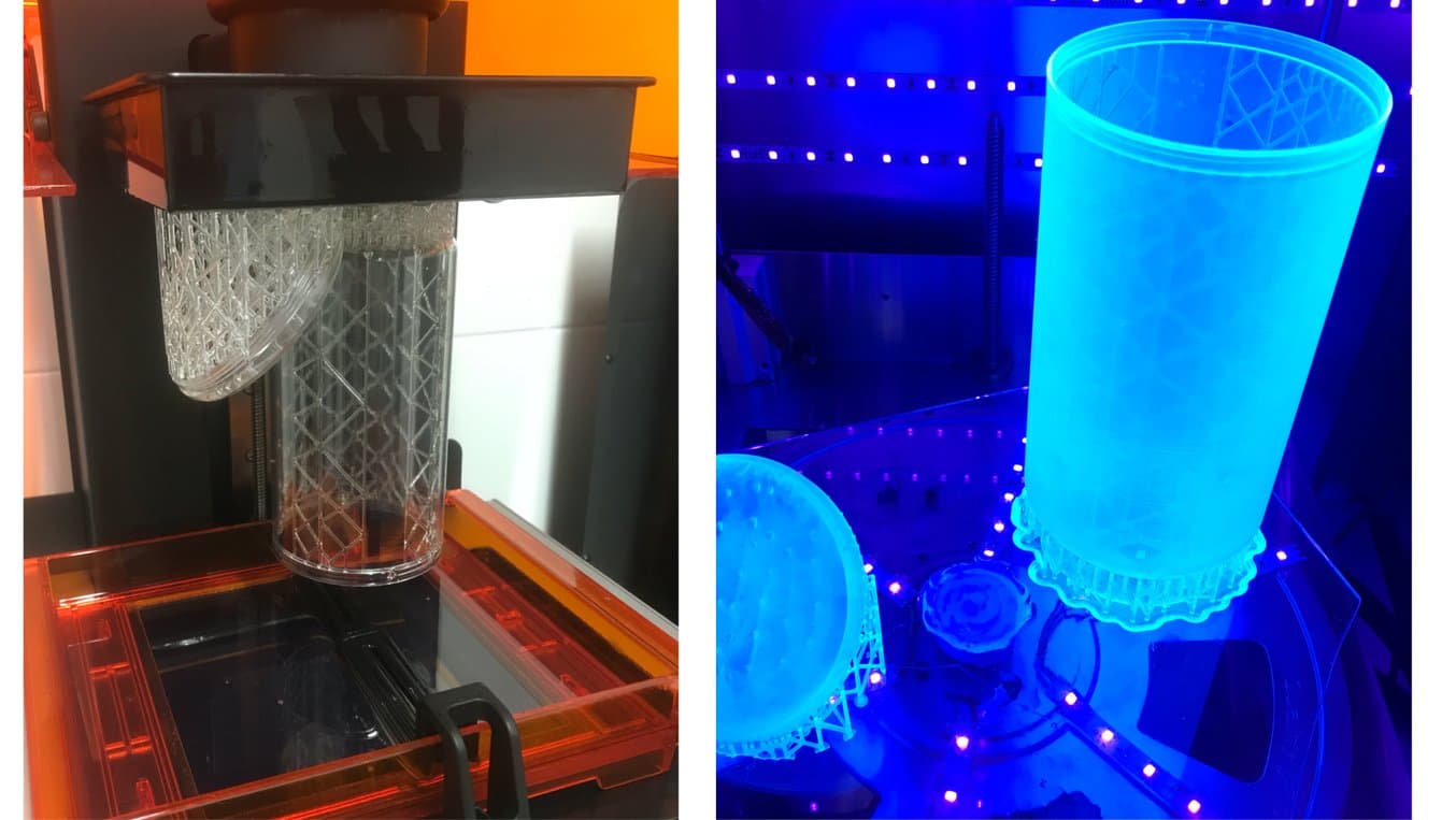

After they came up with the design, they 3D printed the first prototypes with a fused deposition modeling (FDM) 3D printer. Then, once they required more accurate mechanical and aesthetical prototypes, they turned to stereolithography (SLA) 3D printing.

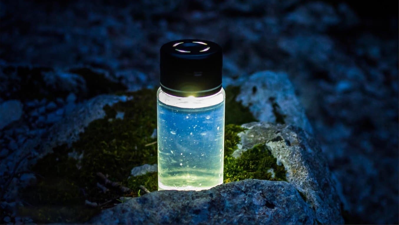

![](/_next/image/?url=https%3A%2F%2Fformlabs-media.formlabs.com%2Ffiler_public_thumbnails%2Ffiler_public%2Fda%2F72%2Fda72b99b-3d9e-4015-8378-20cb38d7fa69%2Fimage1.jpg__1354x0_q85_subsampling-2.jpg&w=3840&q=75)
The bottle can purify water using ultraviolet LEDs, and also function as a flashlight, lantern, or signaling device. These looks-like and works-like prototypes were fully 3D printed with SLA technology.
“To obtain a prototype as close as possible to a product manufactured with traditional manufacturing equipment, we used a Formlabs 3D printer with SLA technology. You can have working prototypes with detailed aesthetics, the right tolerances, and other things that are impossible to have with FDM. All the parts are easy to finish and paint. There are no layers on the parts, so you can finish them easily without using a lot of sandpaper. The results we obtained with this printer have been impressive,” said Petrella.
The final design consists of a cap and the bottle itself. The cap is composed of five plastic parts, the internal electronics, and a battery. The designers used Black Resin for the cap, while they printed the bottle in Clear Resin.

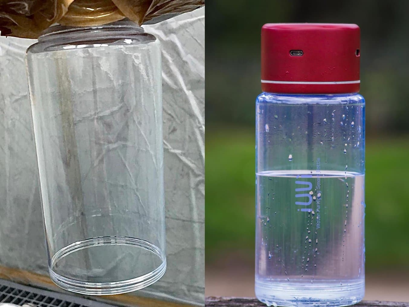

![](/_next/image/?url=https%3A%2F%2Fformlabs-media.formlabs.com%2Ffiler_public_thumbnails%2Ffiler_public%2Fcc%2F25%2Fcc252b0d-84ce-4cff-87c4-2fce28b49ab1%2Fimage6.jpg__1354x0_q85_subsampling-2.jpg&w=3840&q=75)
The prototype of the transparent bottle was 3D printed in Clear Resin.
“One of the more complex steps in the creation of the prototype was the transparent bottle. Using the Formlabs Clear Resin and a long and precise post-production process, we managed to obtain transparency equal to that of a mass-produced part through injection molding. The result is impressive and almost impossible to distinguish from a final product,” said Iannini.
![](/_next/image/?url=https%3A%2F%2Fformlabs-media.formlabs.com%2Ffiler_public_thumbnails%2Ffiler_public%2Fa0%2Fe1%2Fa0e1fd76-54bd-4aca-a4f4-1289b6507ad6%2Fbottle.jpg__1354x0_q85_subsampling-2.jpg&w=3840&q=75)
After 3D printing, the bottle was cleaned, post-cured, sanded, washed again, and then coated with polyurethane spray.
“The most difficult process was to have the surface of the printed part totally smooth because that’s the only way to have a completely clear bottle. We used different grit sandpapers to get a smooth surface finish. Then, we used soap to remove the grease from the parts and increase transparency. At last, we finished the bottle with polyurethane spray. Overall it took one or one and a half hours to create only one bottle,” said Petrella.
