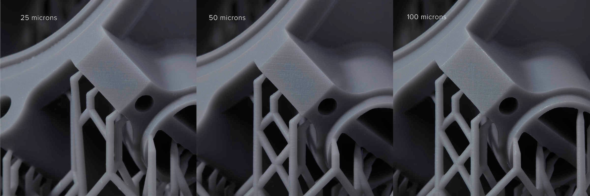

Layer thickness affects both the speed and quality of a print. Thicker layers print faster, but sacrifices detail. Thinner layers print more slowly, but are able to capture finer details. Most materials have a variety of layer thickness settings to choose from, so there’s always an option to suit your needs.

Layer Thickness is measured in fractions of a millimeter, often given in microns. 1 micron (µm) is equal to 0.001 of a millimeter (mm). To provide a sense of scale, 100 microns is the same thickness as a sheet of paper or a human hair.

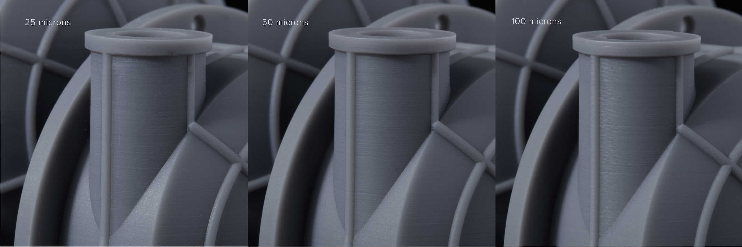

Thicker layers reduce Print Time. Setting the Layer Thickness value to 100 microns (0.1 mm) or greater reduces the overall number of layers that need to be printed.

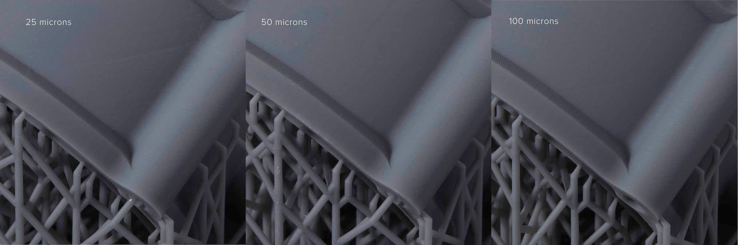

Thinner layers capture fine details. Setting the Layer Thickness value to 25 microns (0.025 mm) reduces the distance between each layer. With more layers making up each feature, the resulting part has a smooth surface finish and fine details.

Keep Print Time in mind. Prints with a 25 micron layer thickness take roughly four times as long as prints with a 100 micron layer thickness.
