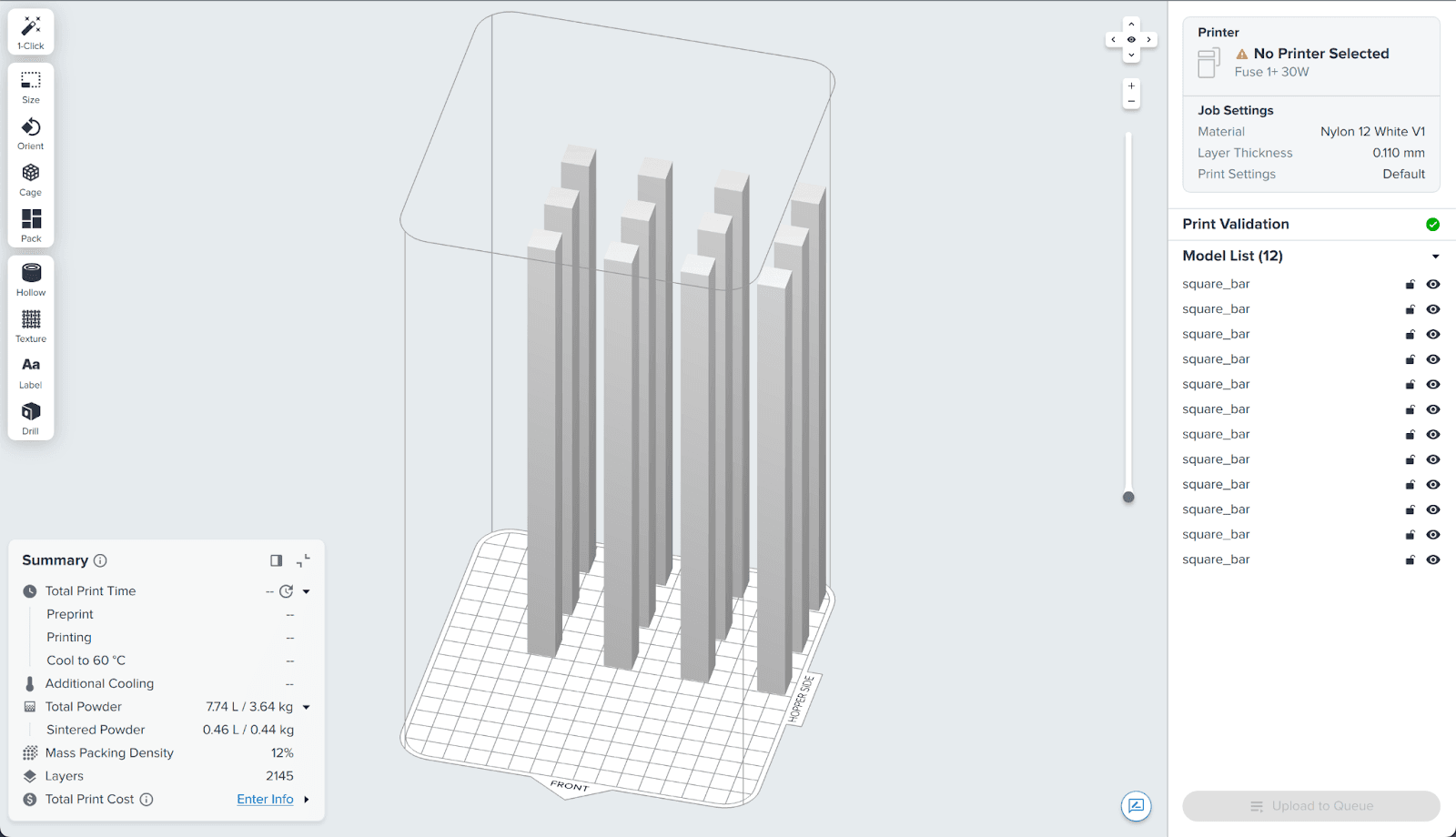

Certain geometries, specifically those whose cross-sections do not change significantly along the Z-axis, do not print as successfully with fresh Nylon 12 White Powder. If you plan to print those types of models, age your powder after tuning the bed temperature. The aging process only needs to be performed once to create sufficient recycled powder for the first print.
An example of a model whose cross-section does not change along the Z-axis.

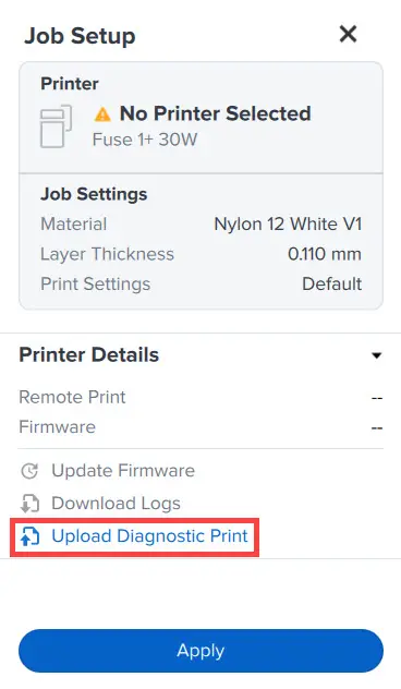

  1. In PreForm, select your printer. In the sidebar on the right, click Upload Diagnostic Print. The Upload Diagnostic Print window appears.
  2. Click Browse and select the downloaded FLZ file.
  3. Click OK to send the print file to the selected printer.
