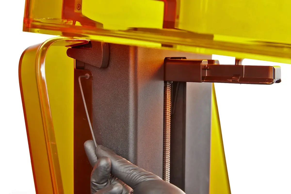

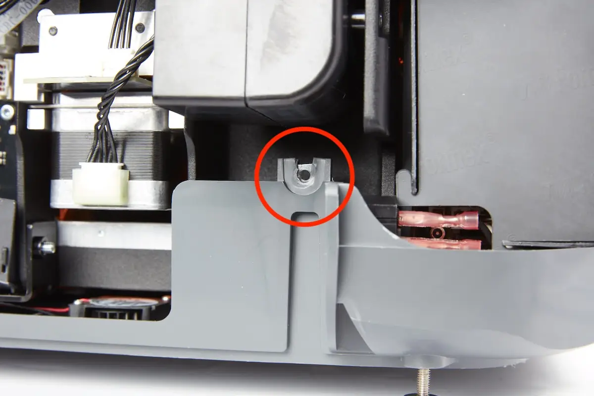

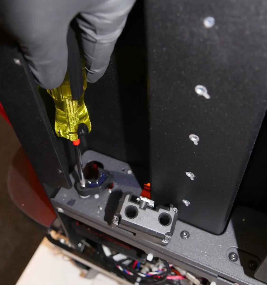

Open the printer cover. There is one screw on each side of the Z-tower. Depending on the age of your printer, they may be 2 mm hex screws or T10 Torx screws. Use the appropriate driver to loosen and remove the two screws on the side of the Z-tower.

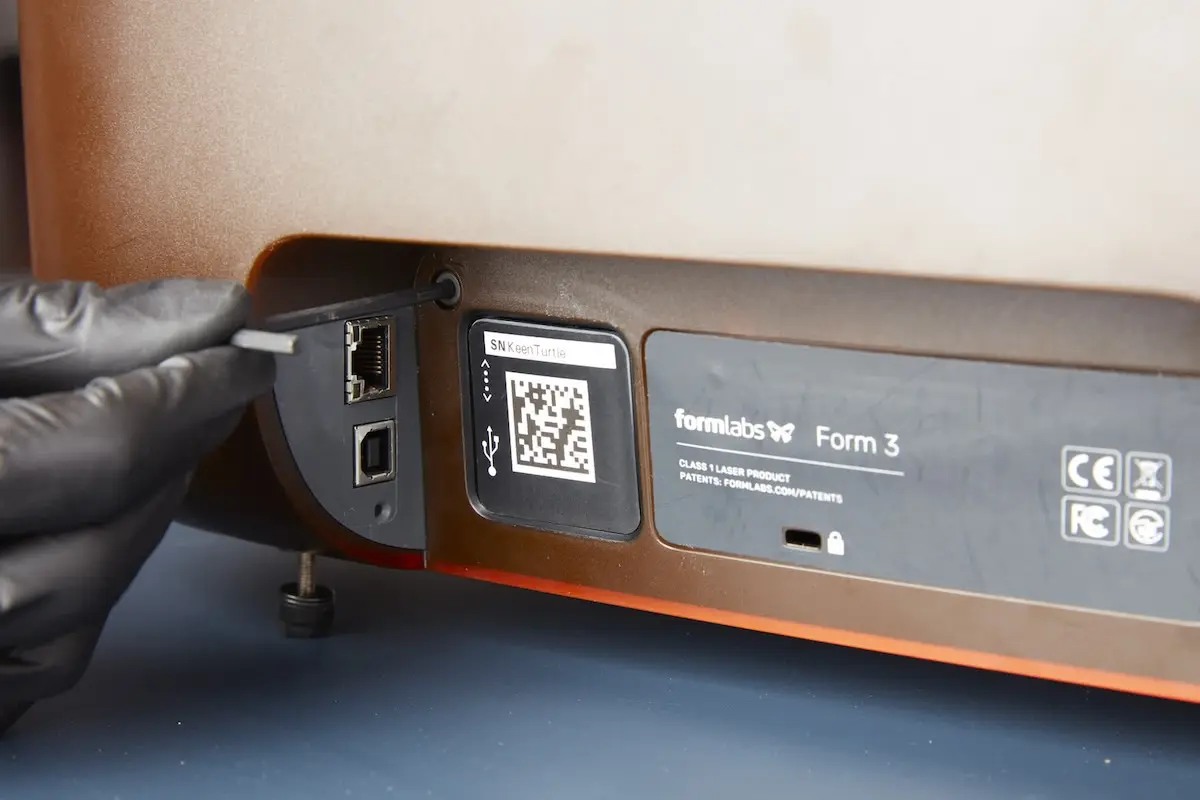

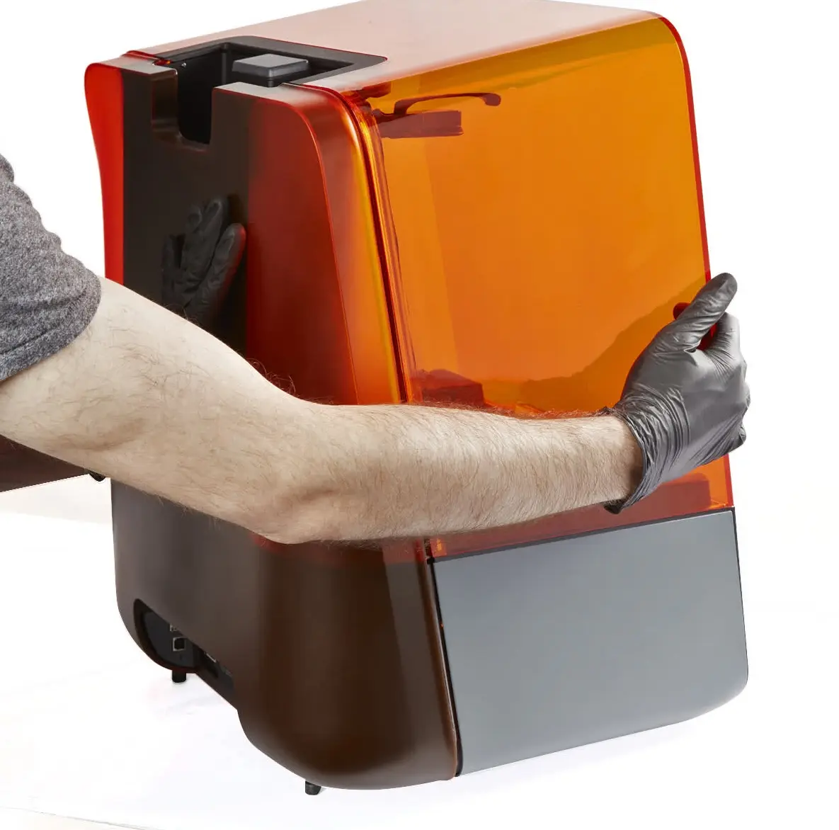

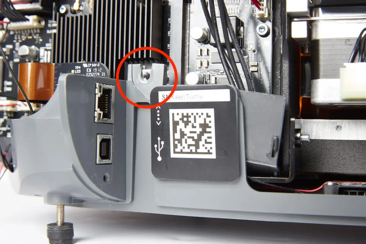

Rotate the printer to access the rear. Use a 3 mm hex driver to loosen and remove the two screws on the back of the printer, near the power and data ports.

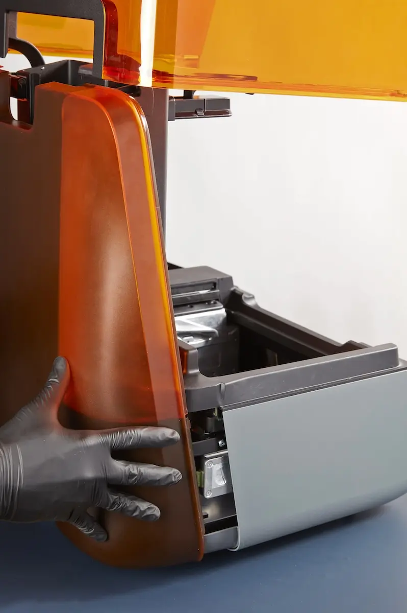

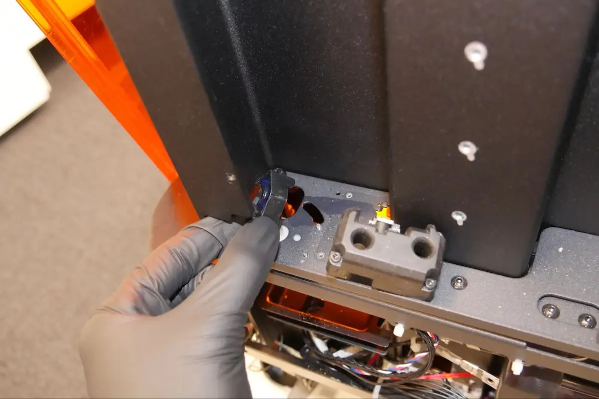

Gently flex the sides of the rear shell outwards to unclip it from the printer frame. Pull the rear shell directly away from the printer to remove it. Set the rear shell aside.
Locate—but do not remove—the two nuts, retained in the lower shell, that previously secured the external rear shell screws. Ensure that they did not come loose while removing the rear shell.

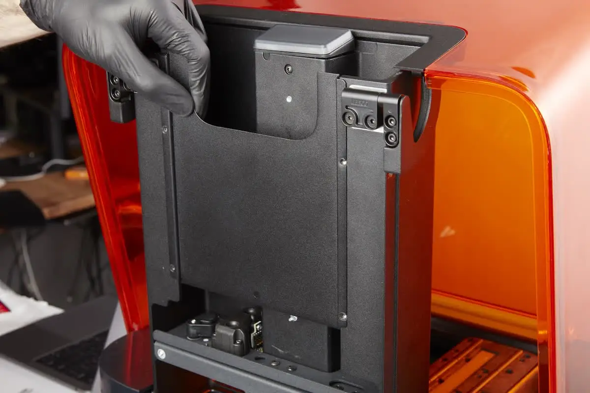

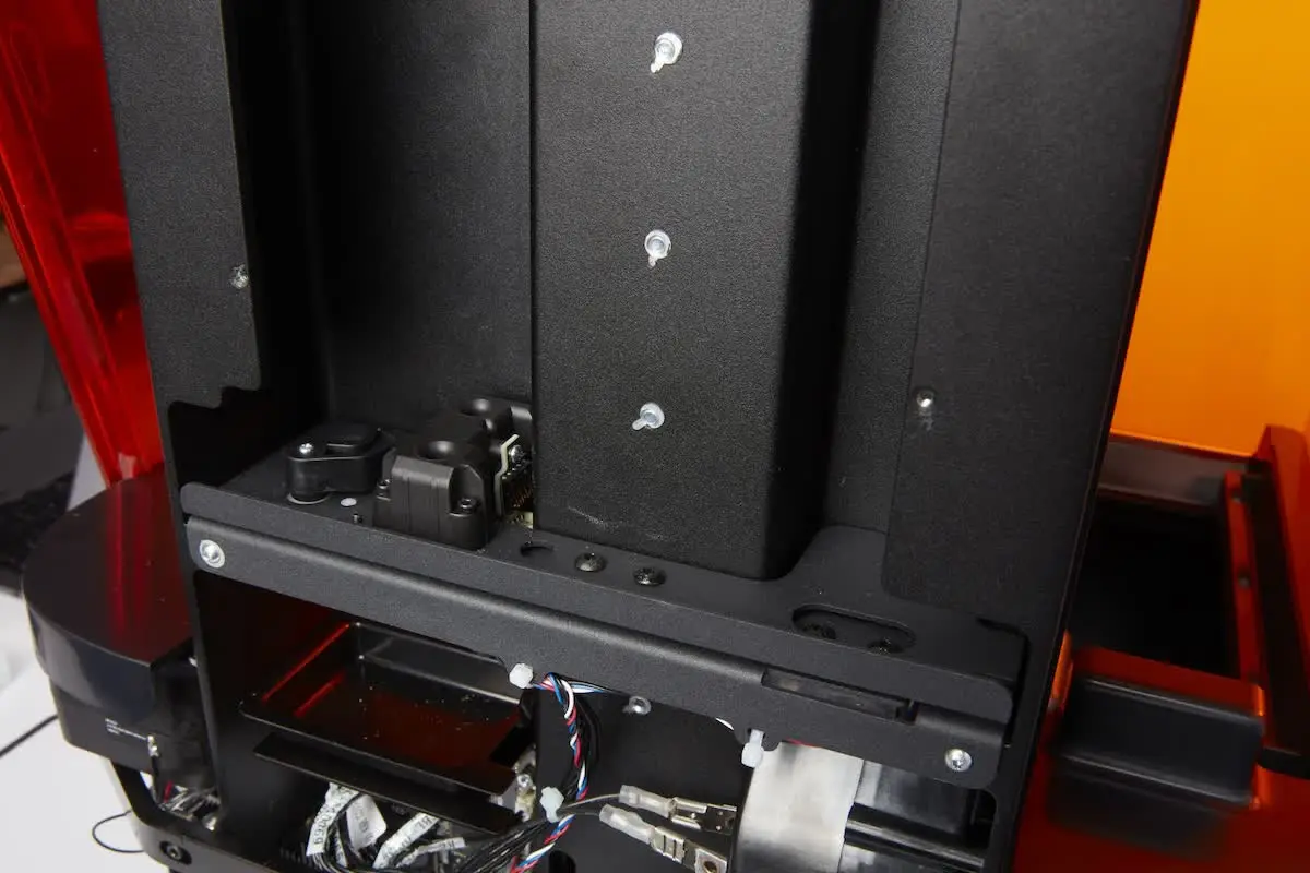

Step 4: Access the cartridge dispense arm

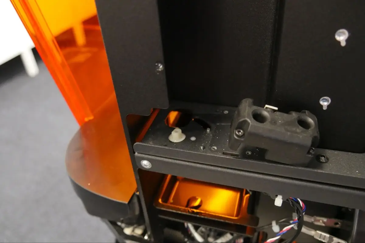

There are two ways to access and replace the cartridge dispense arm: by removing the cartridge floor or by removing the cartridge slot plate above it. The cartridge floor is held in place with two 2 mm hex screws, while the cartridge slot plate is held in place with four 2 mm hex screws. Depending on your machine, one set of screws may be easier to remove than the other.
Test both sets of screws. If any given screw requires excessive force to loosen or feels like it may strip, try the other set. Instructions for both paths are provided below. The photos in the sections for removing and replacing the cartridge dispense arm show the cartridge slot plate removed and the cartridge floor left in place.
Option 1: Removing the cartridge slot plate
Overview: Remove the plate that covers the resin cartridge slot to gain access to the cartridge dispense spring and arm.

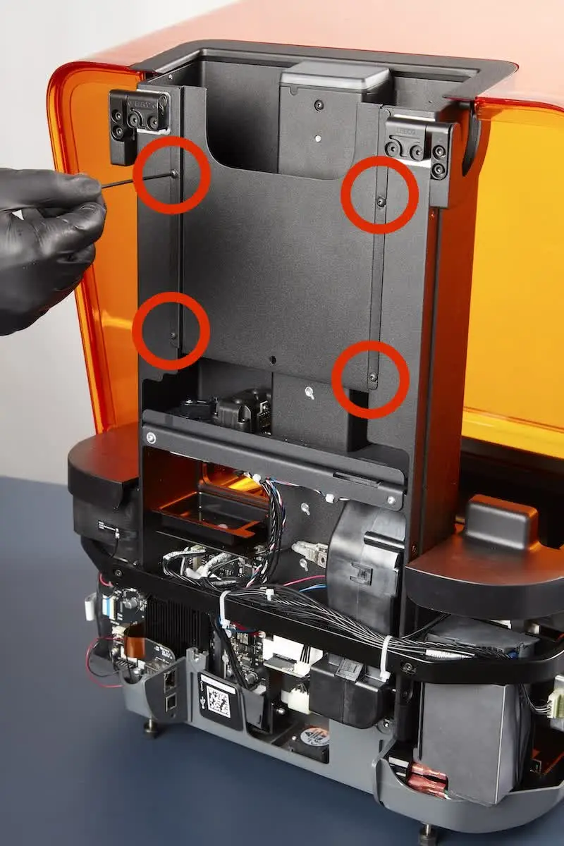

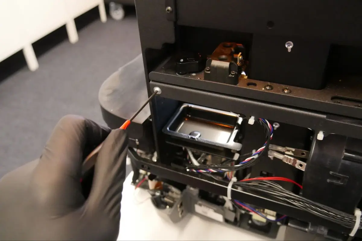

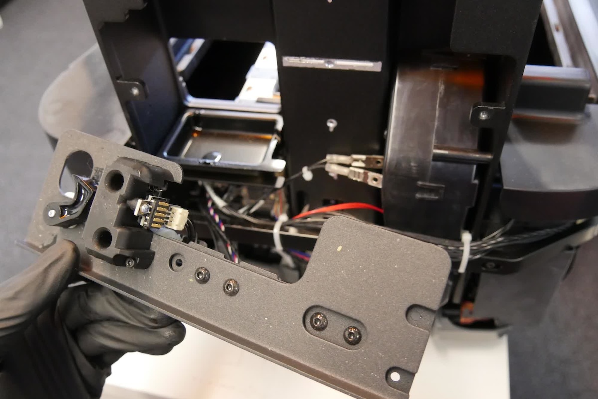

Step 1: Remove the cartridge slot plate screws

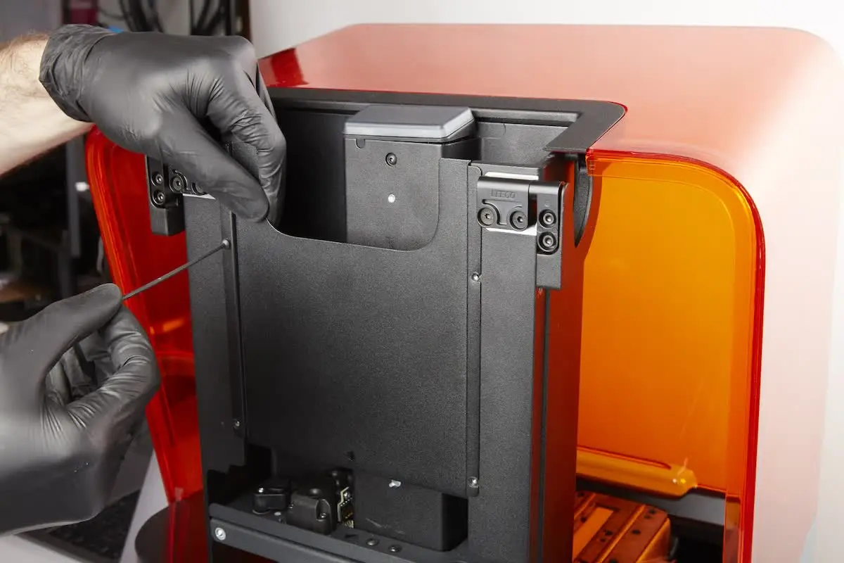

Use a 2 mm hex driver to loosen and remove the four screws holding the cartridge slot plate to the Z-tower.

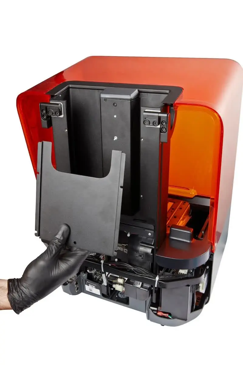

Step 2: Remove the cartridge slot plate

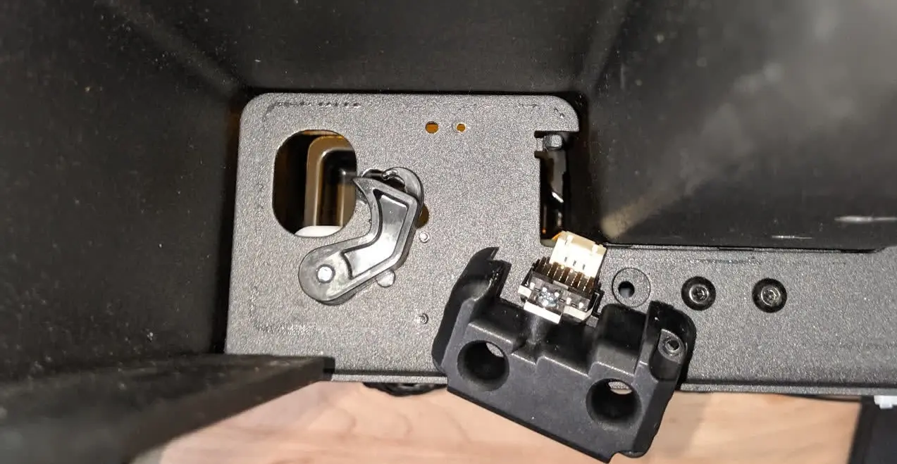

Option 2: Removing the cartridge floor
Overview: Remove the cartridge floor to gain access to the cartridge dispense spring and arm.
Step 1: Unscrew the cartridge floor screws
Using the 2 mm hex driver, unscrew the two screws securing the cartridge floor to the printer frame. Set the screws aside.
NOTICE:
The cartridge floor is still attached to the printer via the cartridge spring finger cable. Do not pull on the cable or pull the display assembly away from the printer. Doing so may damage the cartridge spring finger cable.
Removing the cartridge dispense spring
Overview: Clean the cartridge floor and remove the cartridge dispense spring from the printer.
Step 1: Clean the cartridge floor
Absorb any resin on the cartridge floor with a clean paper towel.
NOTICE:
Do not use any solvents to clean the cartridge floor. Any solvent on the cartridge floor can contaminate resin dispensed during subsequent prints.

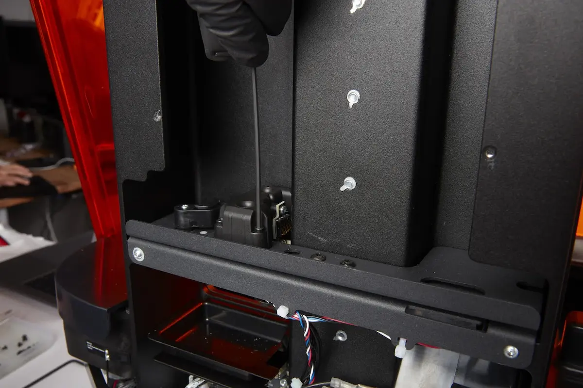

Step 2: Unscrew the cartridge spring finger assembly screws
Use the 2 mm hex driver to loosen and remove the three screws that secure the cartridge spring finger assembly to the bottom of the cartridge slot.
Move the cartridge spring finger assembly to the side to access the cartridge dispense spring. Do not unplug the cartridge spring finger assembly.

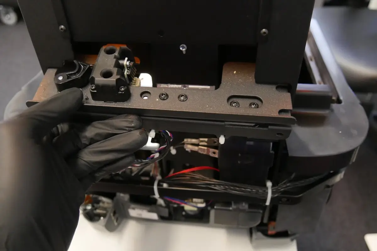

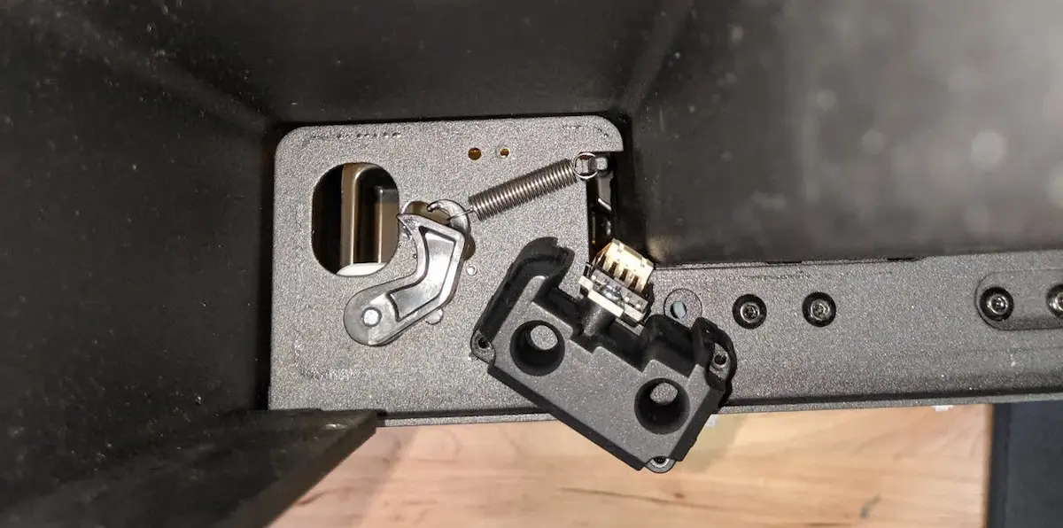

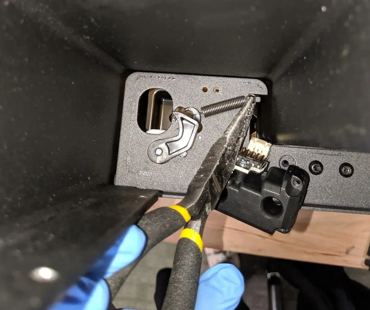

Step 3: Remove the cartridge dispense spring
The cartridge dispense spring is attached to the resin dispense arm and to a metal tab on the cartridge floor. Gently remove the spring from the metal tab using needle nose pliers, tweezers, or another similar tool.
Remove the other end of the spring from the dispense arm. Set the spring aside.

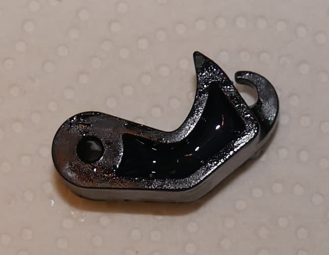

Removing the cartridge dispense arm
Overview: Remove the cartridge dispense spring from the printer.

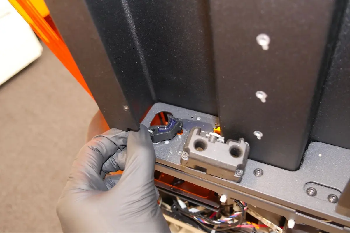

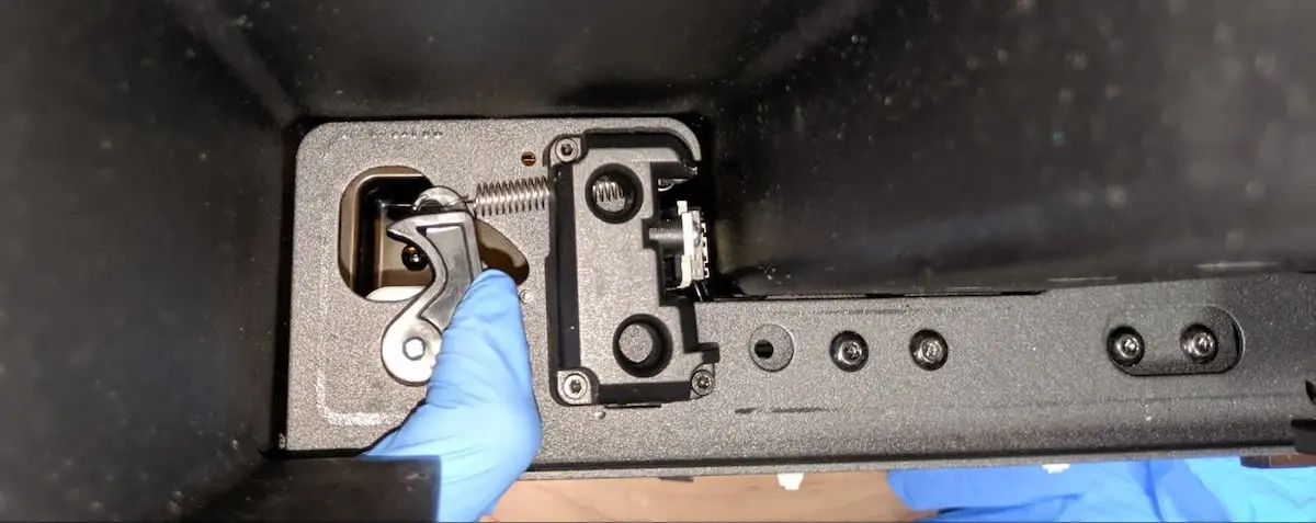

Step 1: Unscrew the cartridge dispense arm screw
Using a Phillips head driver, unscrew the screw securing the cartridge dispense arm to the cartridge dispense floor. Set the screw aside.

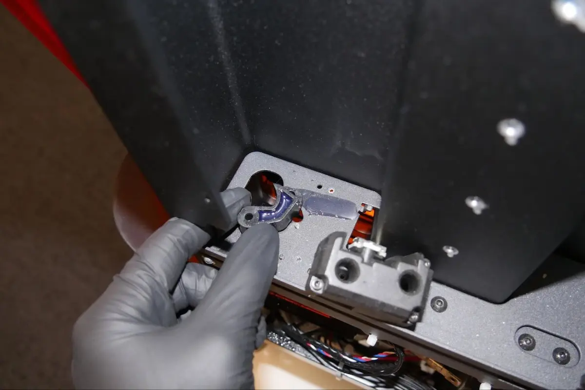

Step 2: Remove the cartridge dispense arm
Gently lift the cartridge dispense arm off its mount. Set the cartridge dispense arm aside.

Step 1: Mount the cartridge dispense arm
Align the post on the distal end of the cartridge dispense arm with the curved slot in the cartridge floor. Press the cartridge dispense arm onto its mount.
Step 2: Secure the cartridge dispense arm
Insert the cartridge dispense arm screw into the screw hole in the cartridge dispense arm. Tighten the screw with the Phillips head driver until finger tight.

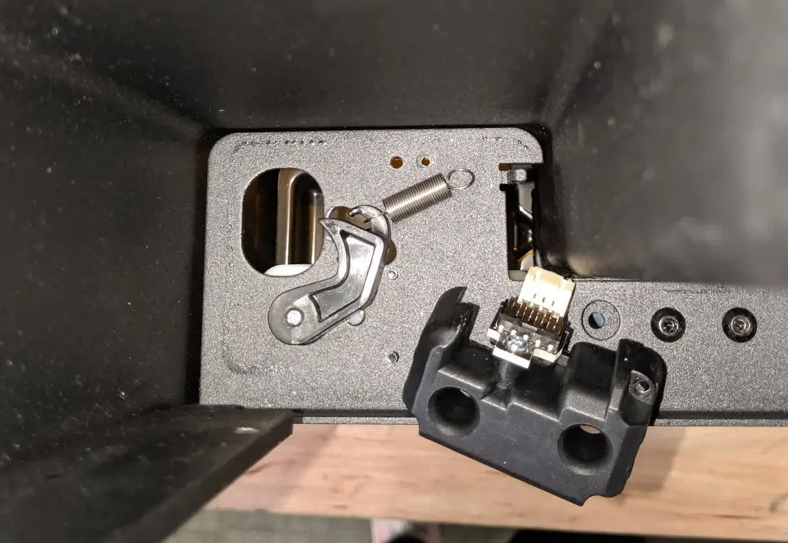

Step 1: Install the cartridge dispense spring
Slip the ends of the cartridge dispense spring over the hook on the resin dispense arm and over the metal tab on the cartridge floor using needle nose pliers, tweezers, or another similar tool.
Step 2: Test the cartridge dispense spring
Push the dispense arm to extend the cartridge dispense spring. Release the dispense arm and ensure that the spring fully retracts.
