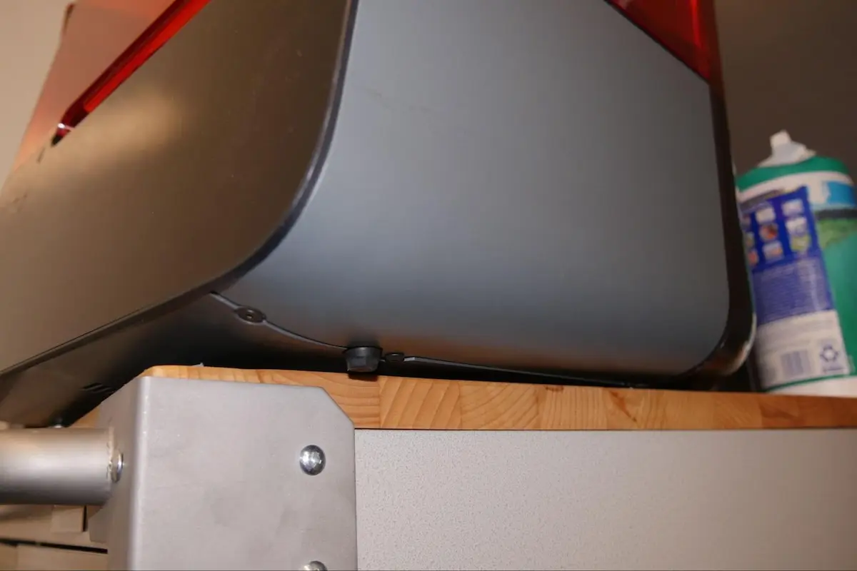

Step 1: Position the printer at the edge of the work surface
Move the printer to the edge of the workspace so that you can access the leveling foot that you plan to replace.
Step 2: Slide the leveling foot off the work surface
Carefully slide the leveling foot that you plan to replace off the work surface so you can access it freely. Ensure that the other three leveling feet remain firmly on the work surface and that the printer is not in danger of tipping or falling.

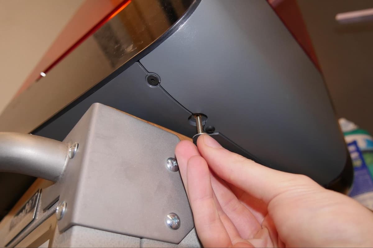

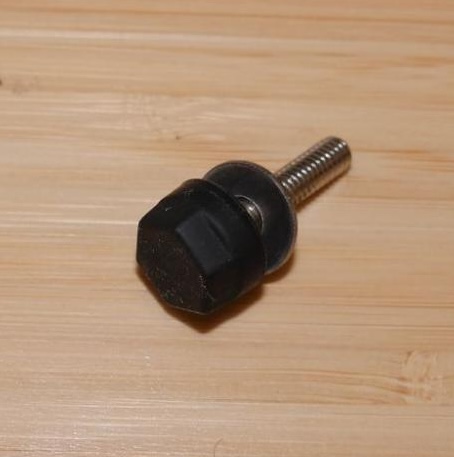

Step 3: Remove the leveling foot
Unscrew and remove the leveling foot. Place the leveling foot aside.

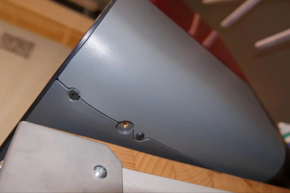

Overview: Screw the replacement leveling foot into the printer.

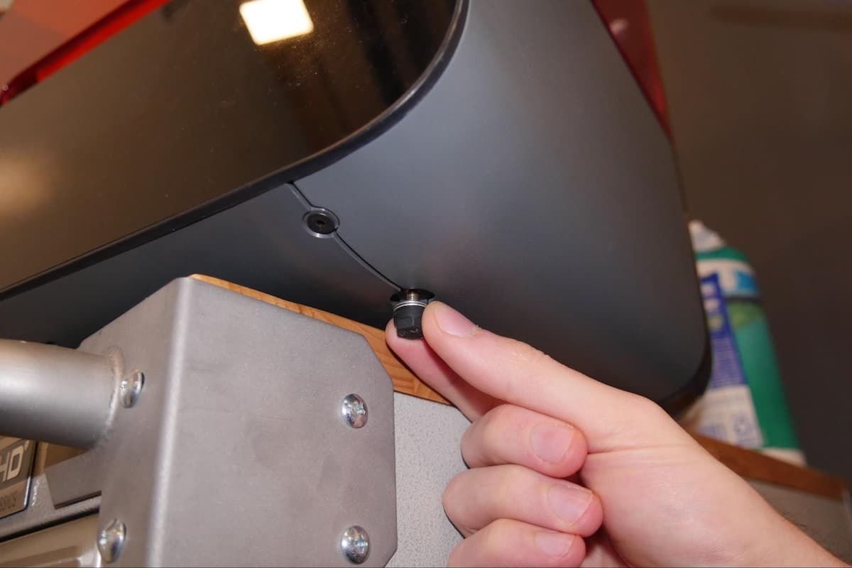

Step 1: Install the leveling foot
Thread the replacement leveling foot into the threaded insert in the bottom of the printer. Tighten until the leveling foot is secure and can bear the weight of the printer.

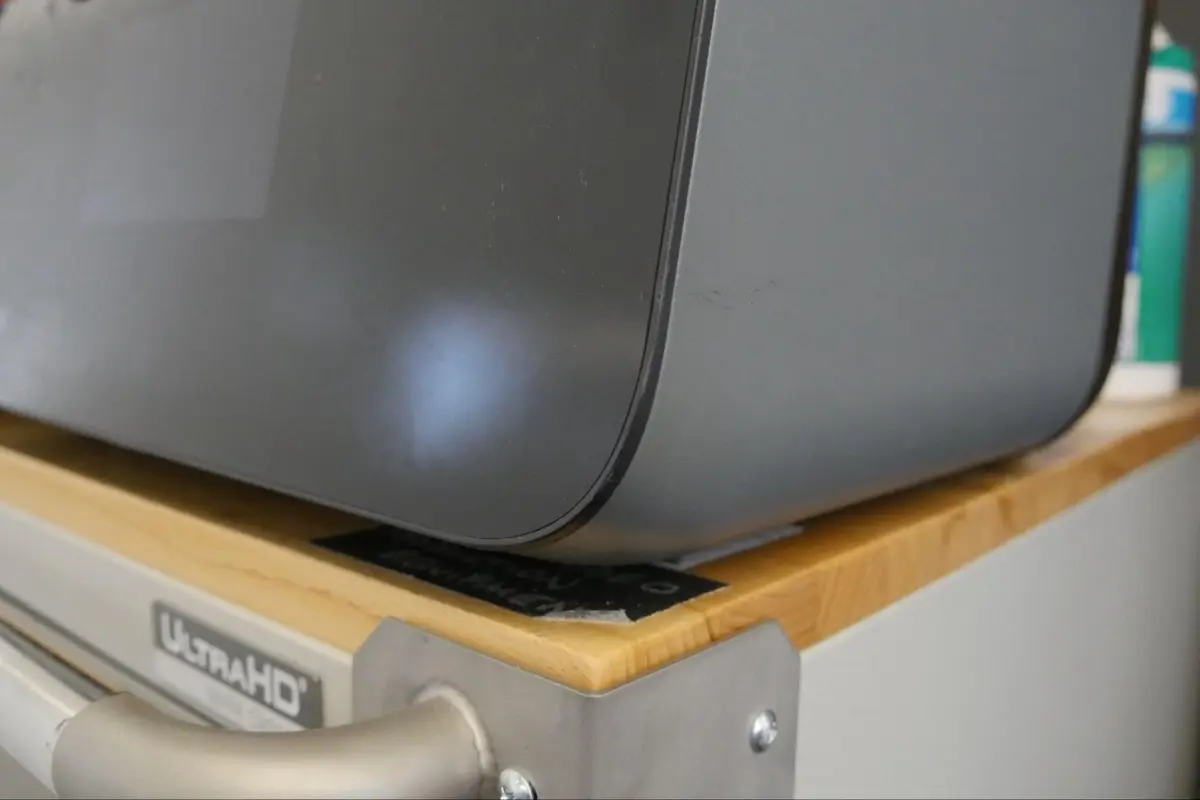

Step 1: Reposition the printer
Slide the printer back onto the work surface so that it sits on all four leveling feet.
