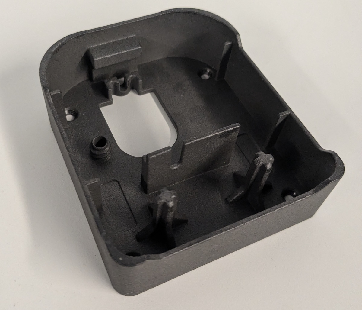

Print and post-process a replacement pump skirt. For best results, print this part in Tough 2000 Resin V2. Other resins will also work but the part may not be as impact-resistant.

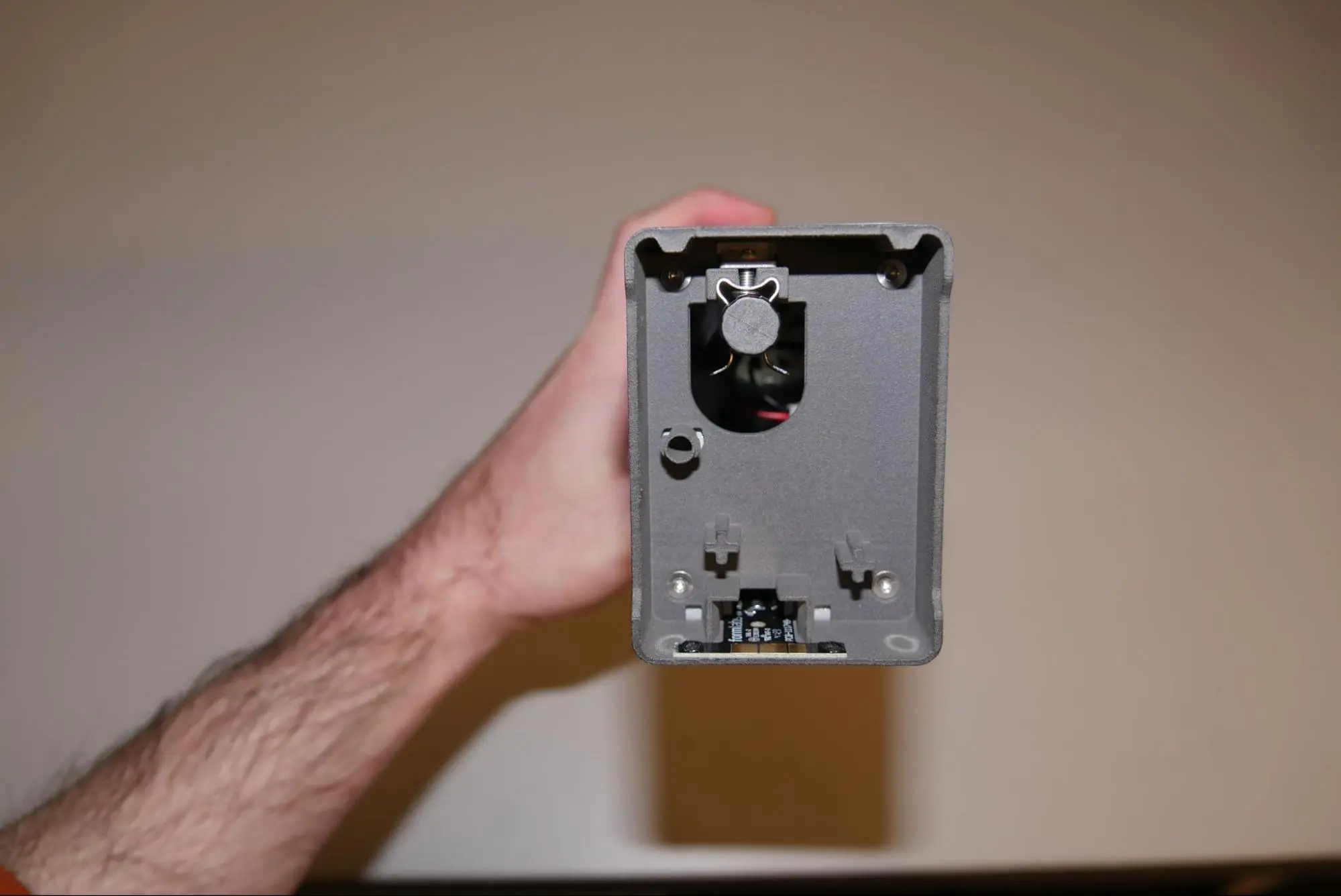

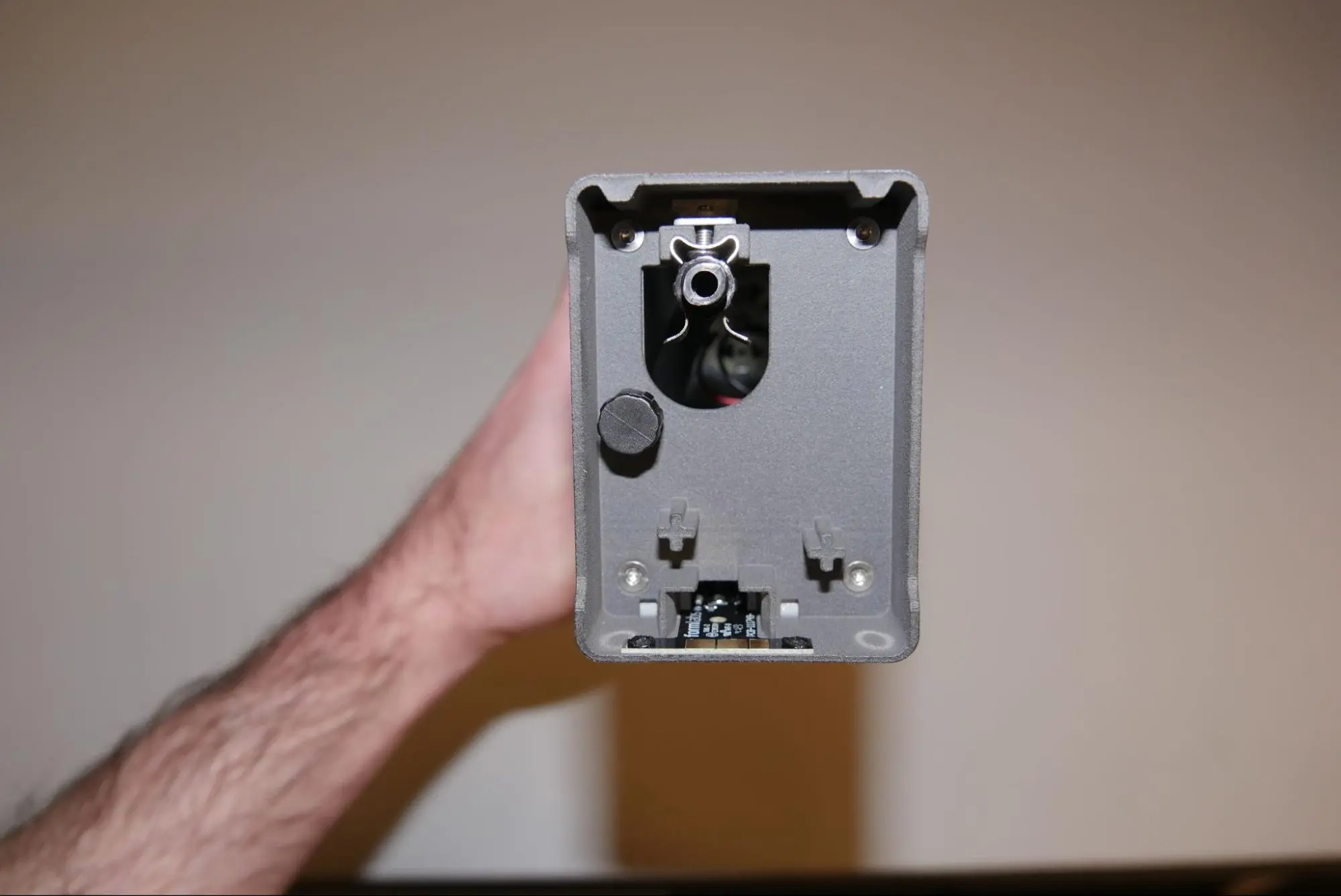

If the resin pump is currently installed in a printer, remove the resin pump.
To prevent resin from dripping onto your work surface, unscrew the cap from the retention post on the bottom of the pump and screw it onto the outlet of the pump tube.

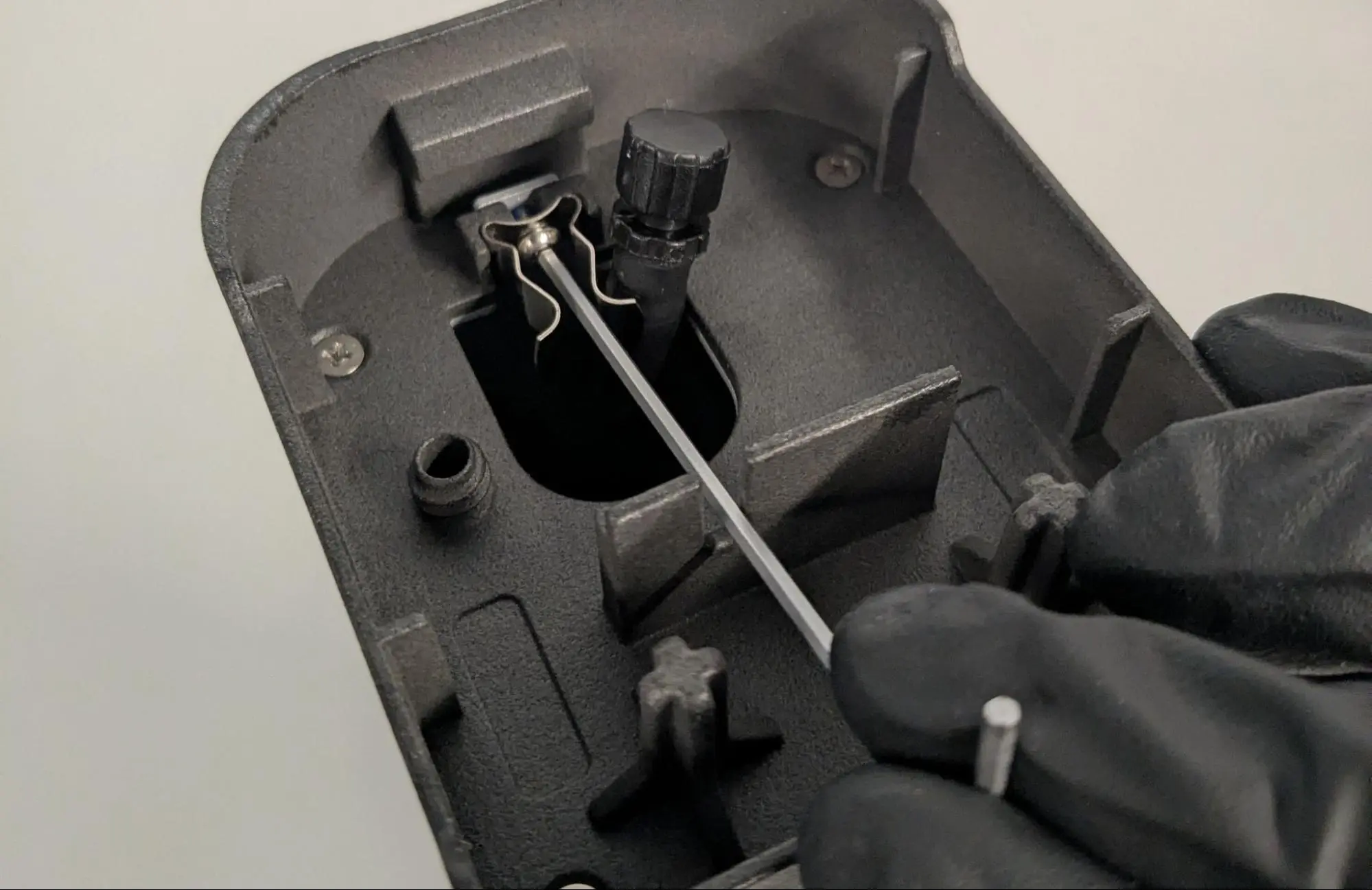

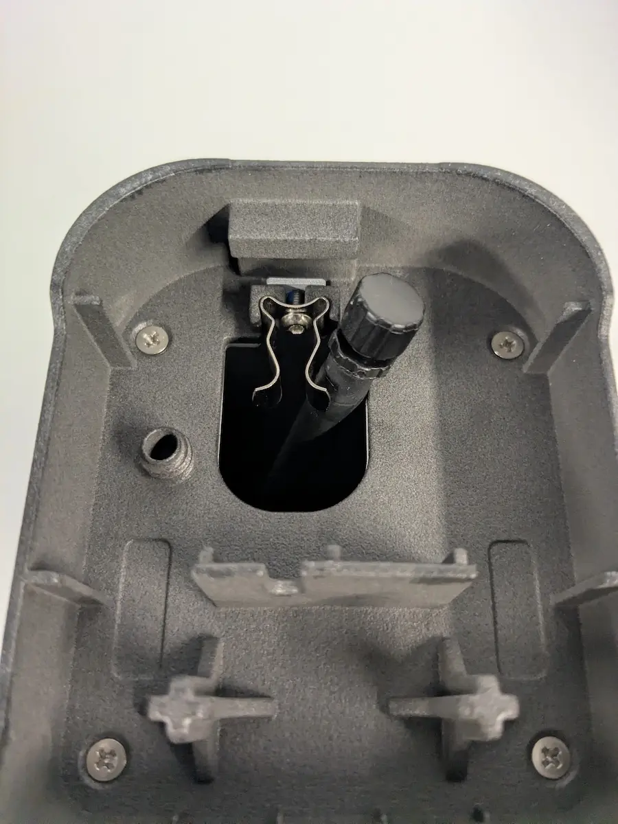

The pump tube is held in place with a clip, which is in turn secured to the body of the pump with an 8 mm M3 button head screw. Remove the pump tube from the clip and move it to the side. Using a ball-end 2 mm hex driver, loosen and remove the screw from the clip. Set the screw and clip aside.

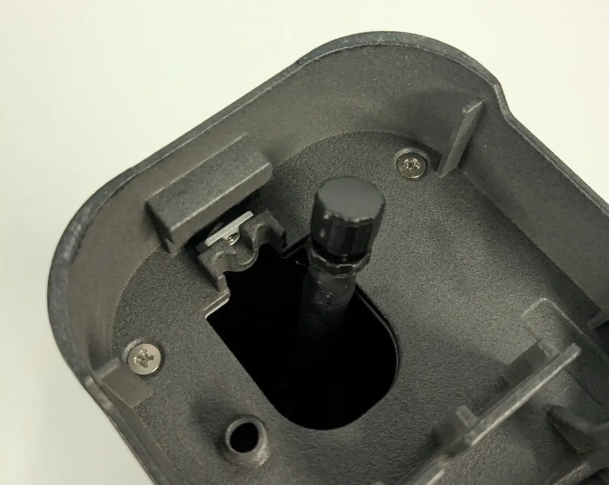

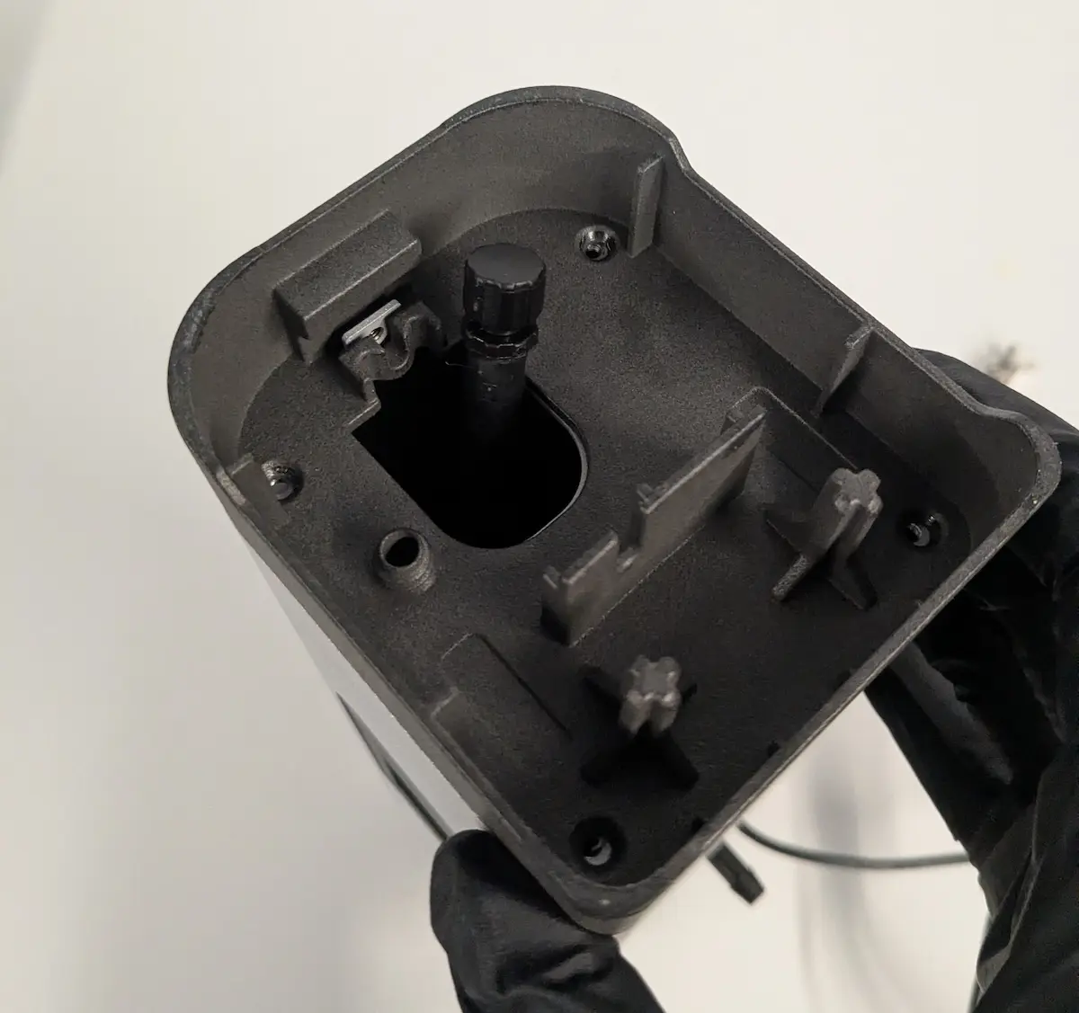

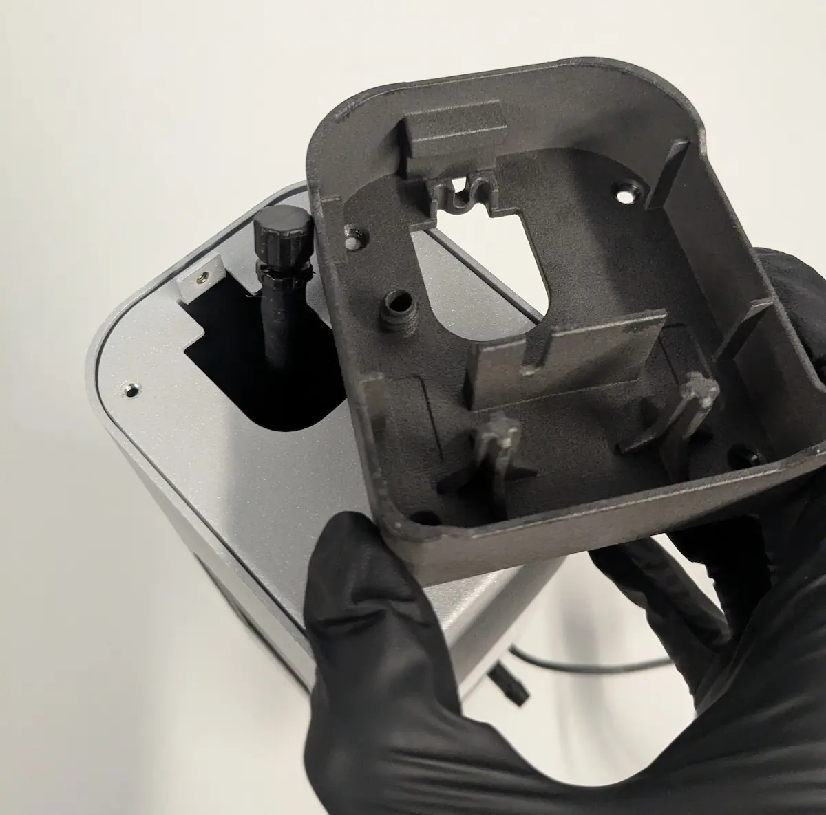

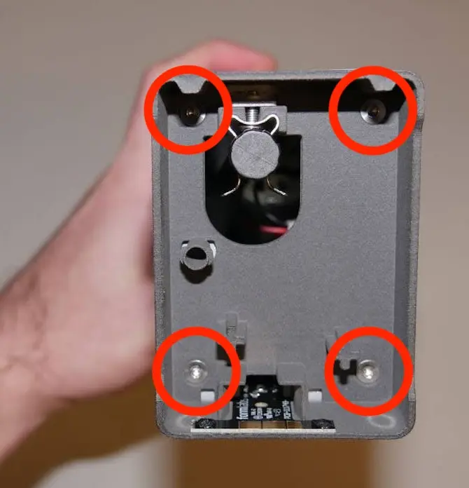

Using a 2 mm hex driver, loosen and remove the four 6 mm M3 flathead screws securing the pump skirt to the body of the pump. Set the screws aside. Pull the pump skirt off of the pump and set it aside for disposal.

Place the printed pump skirt against the base of the pump. Align the four screw holes in the printed skirt with the corresponding screw holes in the pump body.
Step 2: Secure the pump skirt
Thread one 6 mm M3 flathead screw into each of the four screw holes at the corners of the pump skirt. Using a 2 mm hex driver, tighten until snug.

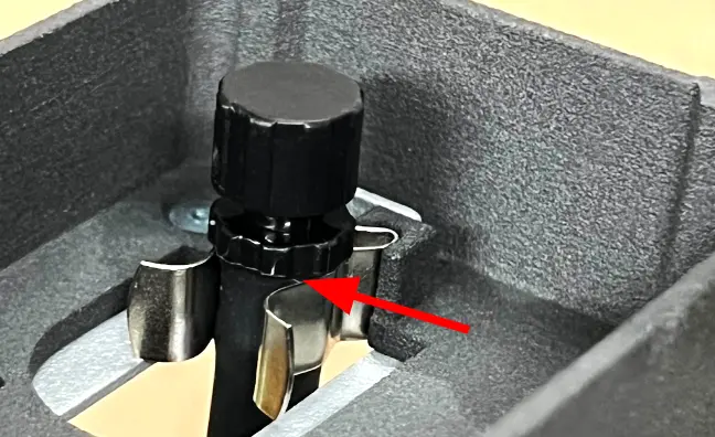

Thread the 8 mm M3 button head screw into the screw hole in the pump tube clip. Using a ball-end 2 mm hex driver, tighten until snug.
Step 5: Clip the pump tube to the resin pump
Press the pump tube into the retention clip. Ensure that the lip of the fitting at the end of the tube is flush against the bottom of the clip and that the pump tube does not extend beyond the bottom of the resin pump.
