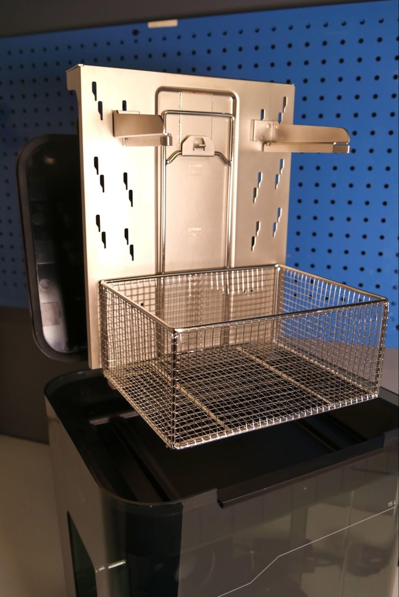

Turn the Form Wash knob to select Raise on the display. Push the knob to confirm. The Form Wash raises the elevator and basket out of the wash bucket, and opens the outer lid.
Step 2: Remove the build platform mount arms and wash basket
Unhook the build platform mount arms from the elevator. Lift the wash basket off its hook. Set the build platform mount arms and wash basket aside.

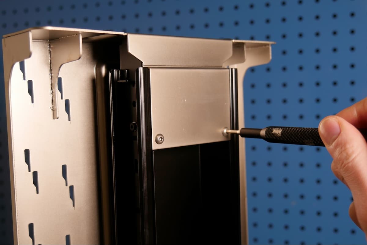

Step 1: Remove the back screws
Using a 2 mm hex driver, unscrew the two screws securing the back of the elevator to the unit. Set the screws aside.

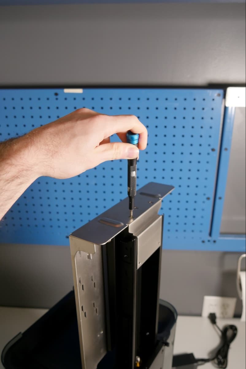

Step 2: Remove the top screws
Using a 2 mm hex driver, unscrew the three screws securing the top of the elevator to the unit. Set the screws aside.

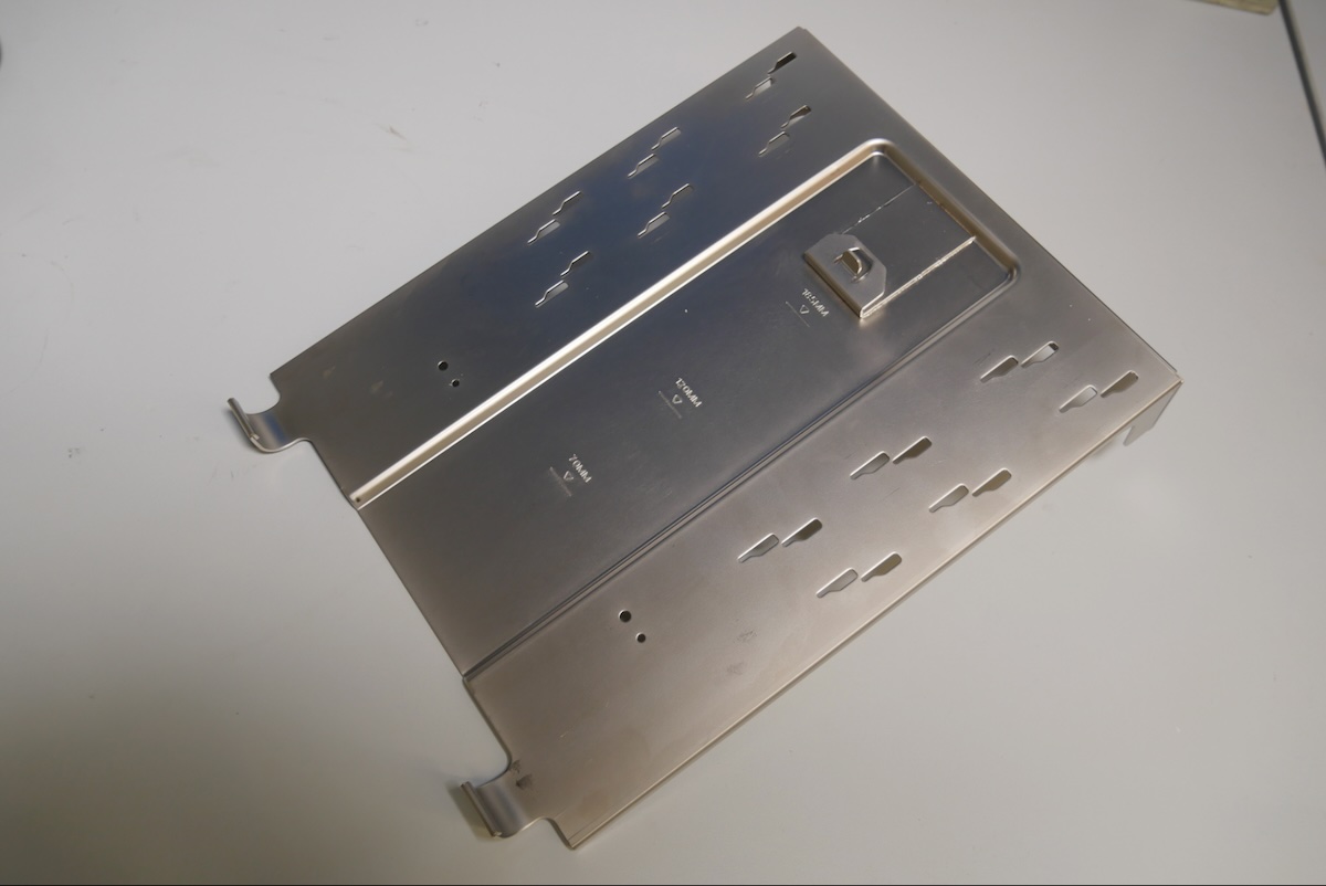

Step 3: Remove the elevator
Lift the elevator off of the Form Wash. Set the elevator aside for disposal.

Step 1: Mount the elevator
Place the replacement elevator on the Form Wash, aligning the screw holes in the elevator with those on the frame of the unit.
