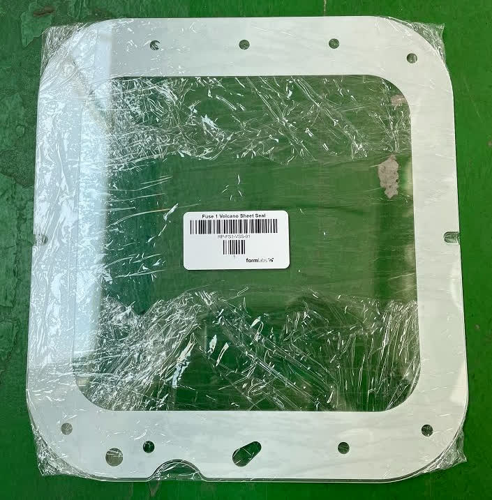

  • Replacement Fuse 1 generation build chamber inner gasket

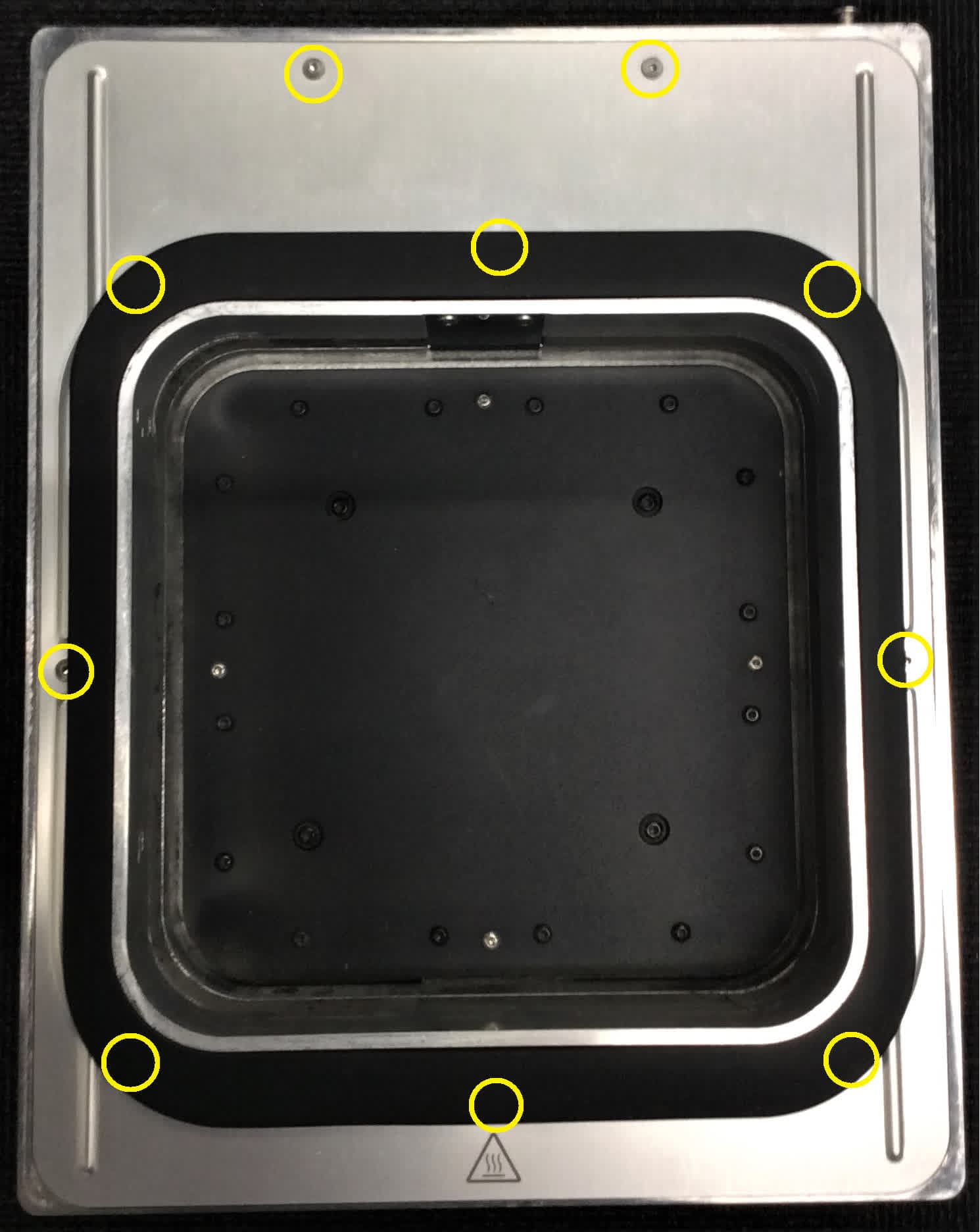

Step 1: Remove the top cover screws
Fuse 1 generation build chamber top cover screws

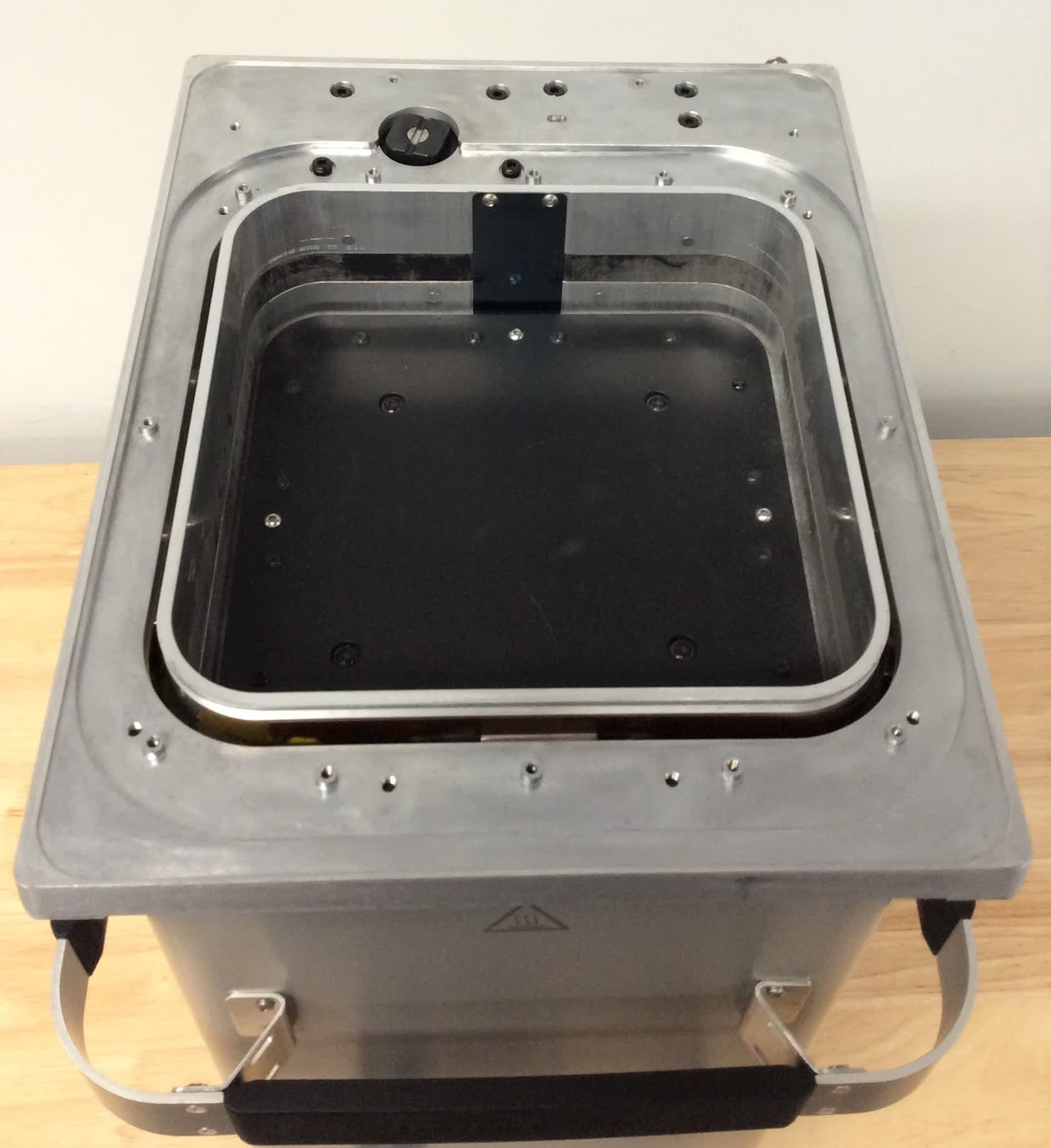

Using a 2 mm hex driver, loosen and remove the 10 M3 × 5 mm screws securing the build chamber’s top cover to the build chamber’s body. Set the screws aside.
Step 2: Remove the top cover
Remove the top cover and build chamber external frame gasket from the build chamber.
Removing the Fuse 1 generation build chamber top cover

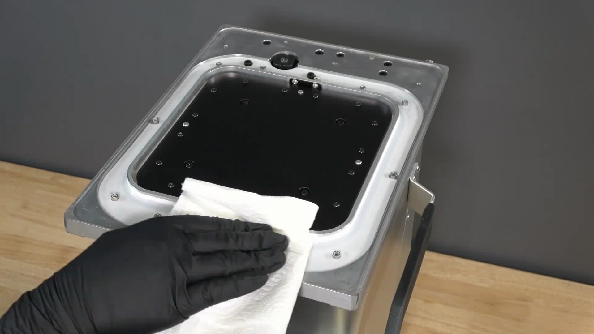

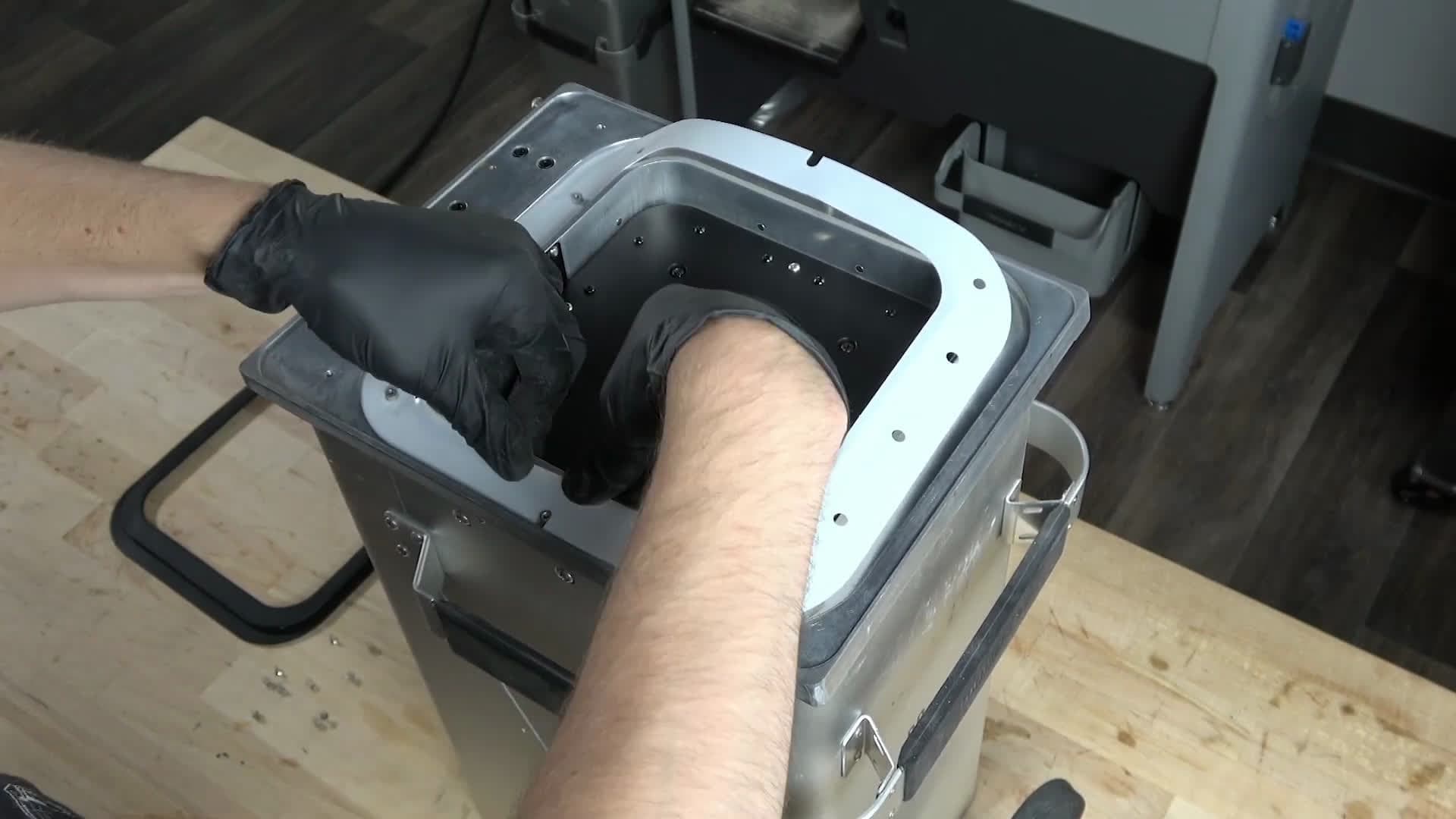

Step 3: Wipe the inner gasket
Use a clean paper towel to clean any powder off of the inner gasket below the top cover.
Wiping the inner gasket

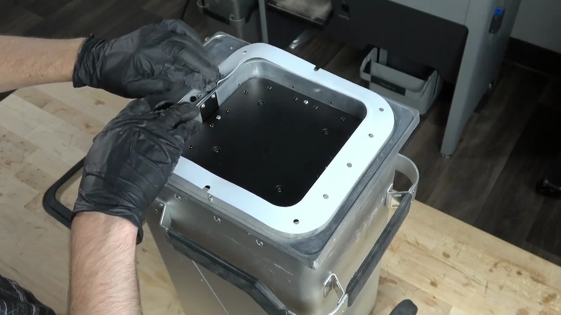

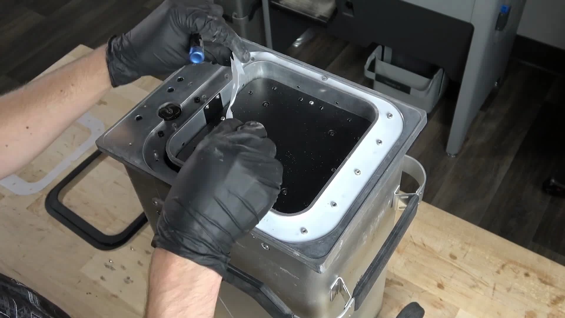

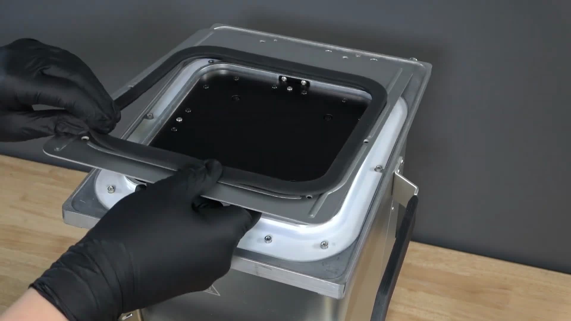

Step 4: Separate the inner gasket from the build chamber
Removing the Fuse 1 generation build chamber inner gasket
Peel the inner gasket away from the build chamber.

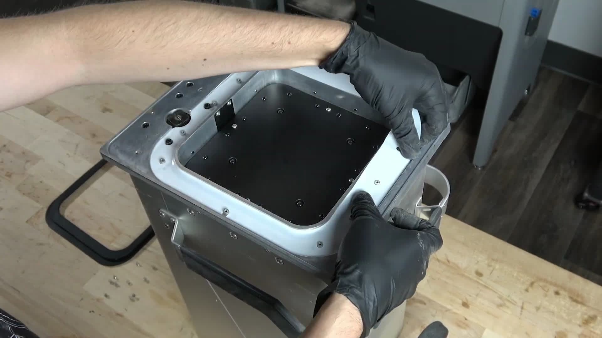

Step 5: Wipe the machined surface under the seal
Use a clean paper towel to wipe away any powder that may have accumulated underneath the inner gasket. Ensure the machined build chamber surface is clean and free of debris.
Wiping under the inner gasket

Step 1: Inspect the replacement inner gasket
Inspect the replacement inner gasket for any contamination or debris. Use a clean paper towel to wipe it clean.

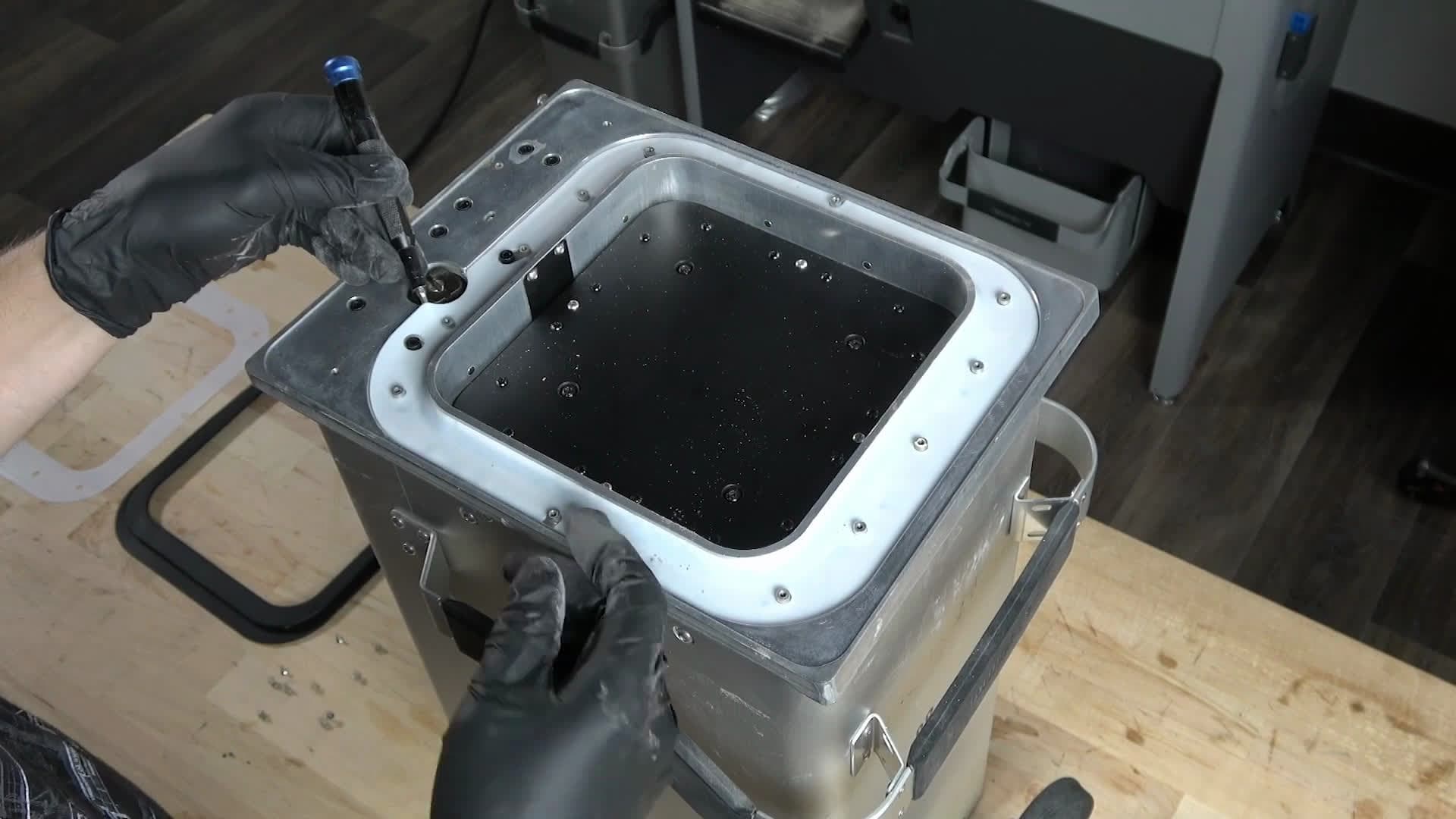

Step 2: Place the replacement inner gasket on the build chamber surface
Installing the inner gasket

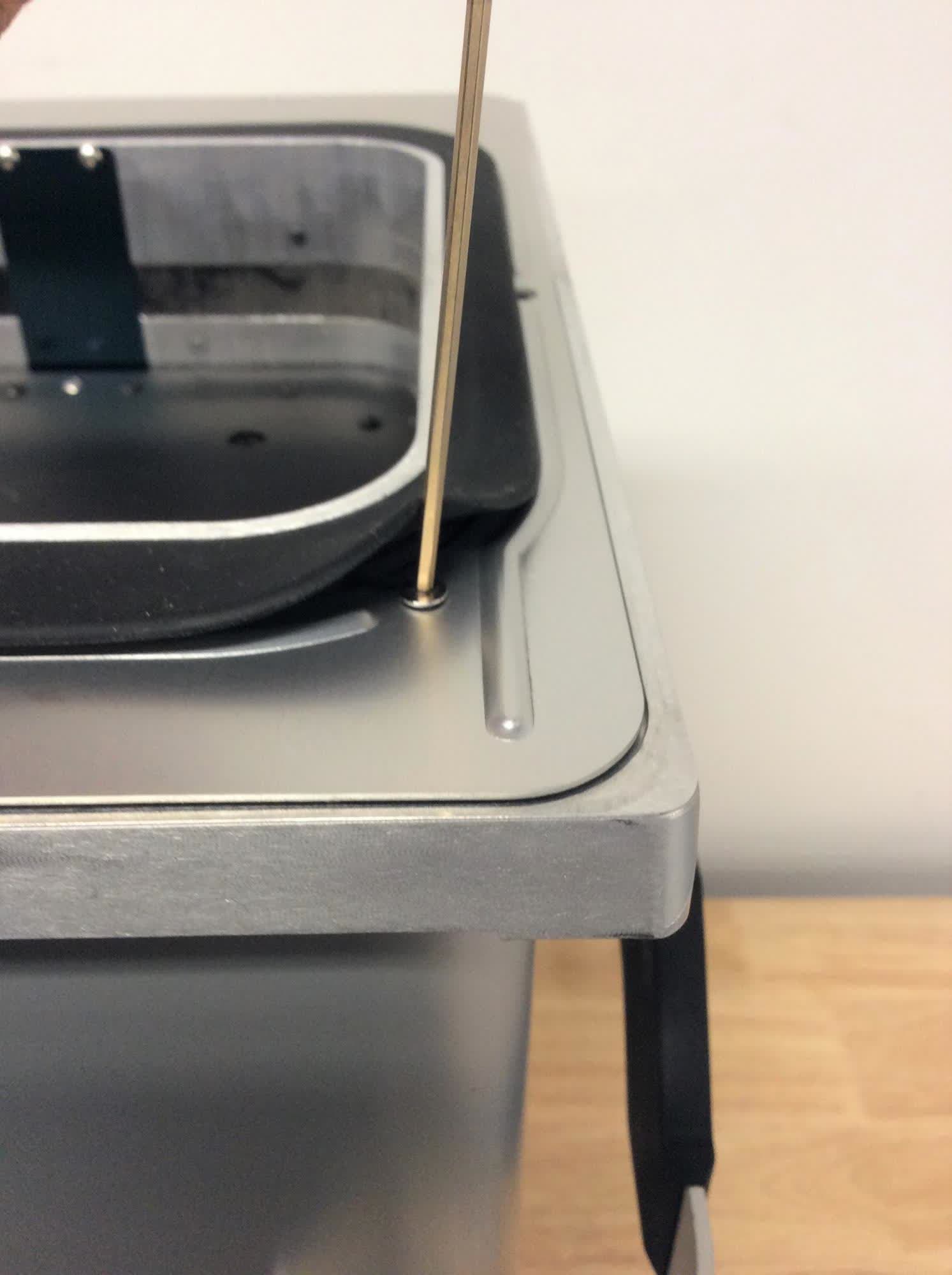

Place the replacement inner gasket on the machined build chamber surface. Take care to orient the print bed correctly. The inner gasket only fits over all standoffs and holes in one orientation.
Make your way around the gasket, stretching it into place over the inner wall of the build chamber.

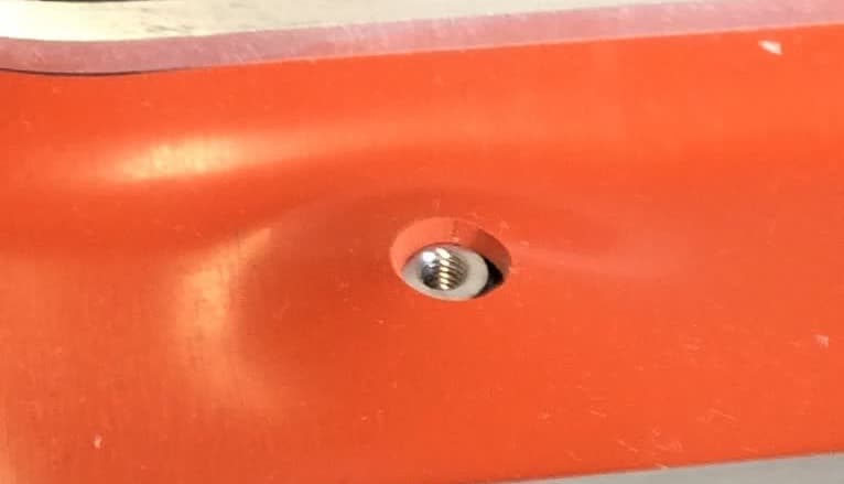

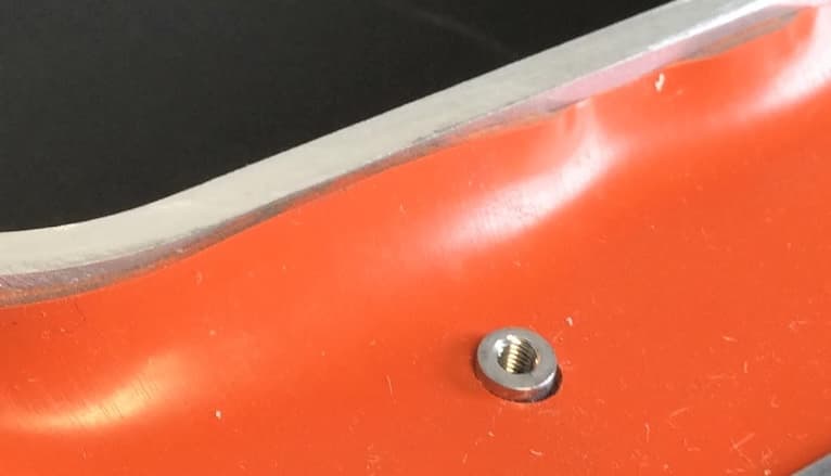

Step 3: Inspect the inner gasket fit and position
Correct inner gasket position
Incorrect inner gasket position

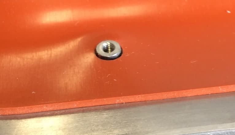

Inspect all surfaces of the seal and ensure the following:
  • The seal is flush along all edges.
  • The top part of the seal is positioned in the groove in the build chamber.
  • The seal is properly located around all standoffs.
Note that while the gasket shown here may be a different color than your build chamber's original gasket or the replacement, the inspection criteria are the same.
