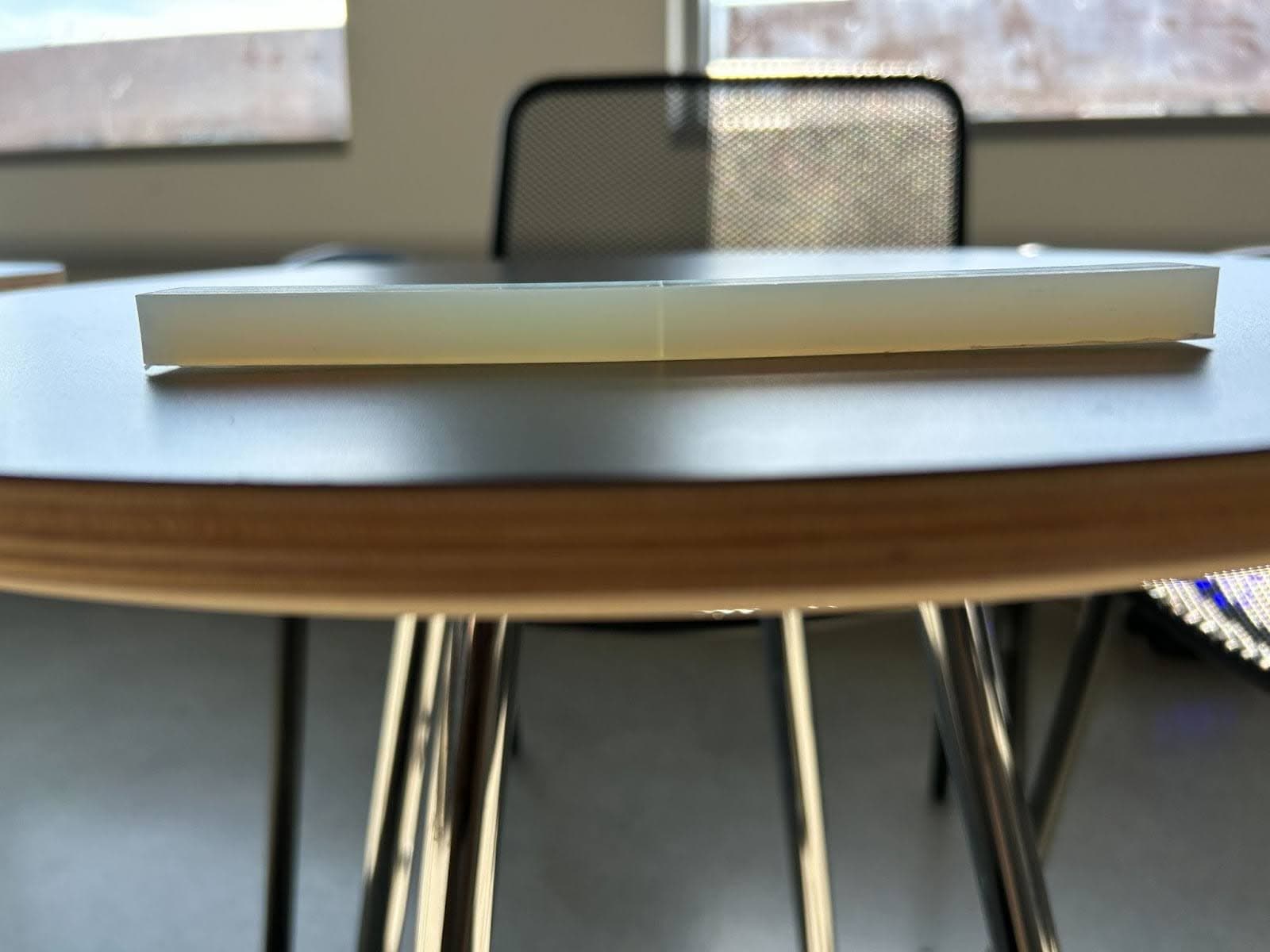

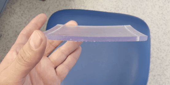

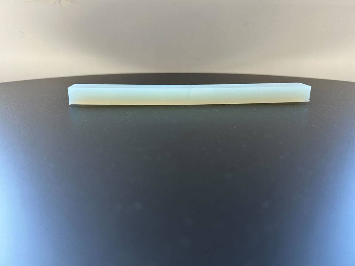

Warping refers to the process through which printed parts turn out with a different shape than intended. Warping affects the entire printed part and may occur during printing, washing, or post-curing.
Undersupported parts can warp and sag during printing. The layers of resin are not strong enough to support their own weight, causing the layers to fall away from the build platform and warping the part.
While washing parts, long wash times allow the printed part to absorb solvent, causing the outer edges to expand and warp the part.
Heat and light cause the part to shrink during post-curing. If one side of the part cures and not the other or the part is undersupported, the part warps.
Warped part
Warped part
Warped part
Warped part
