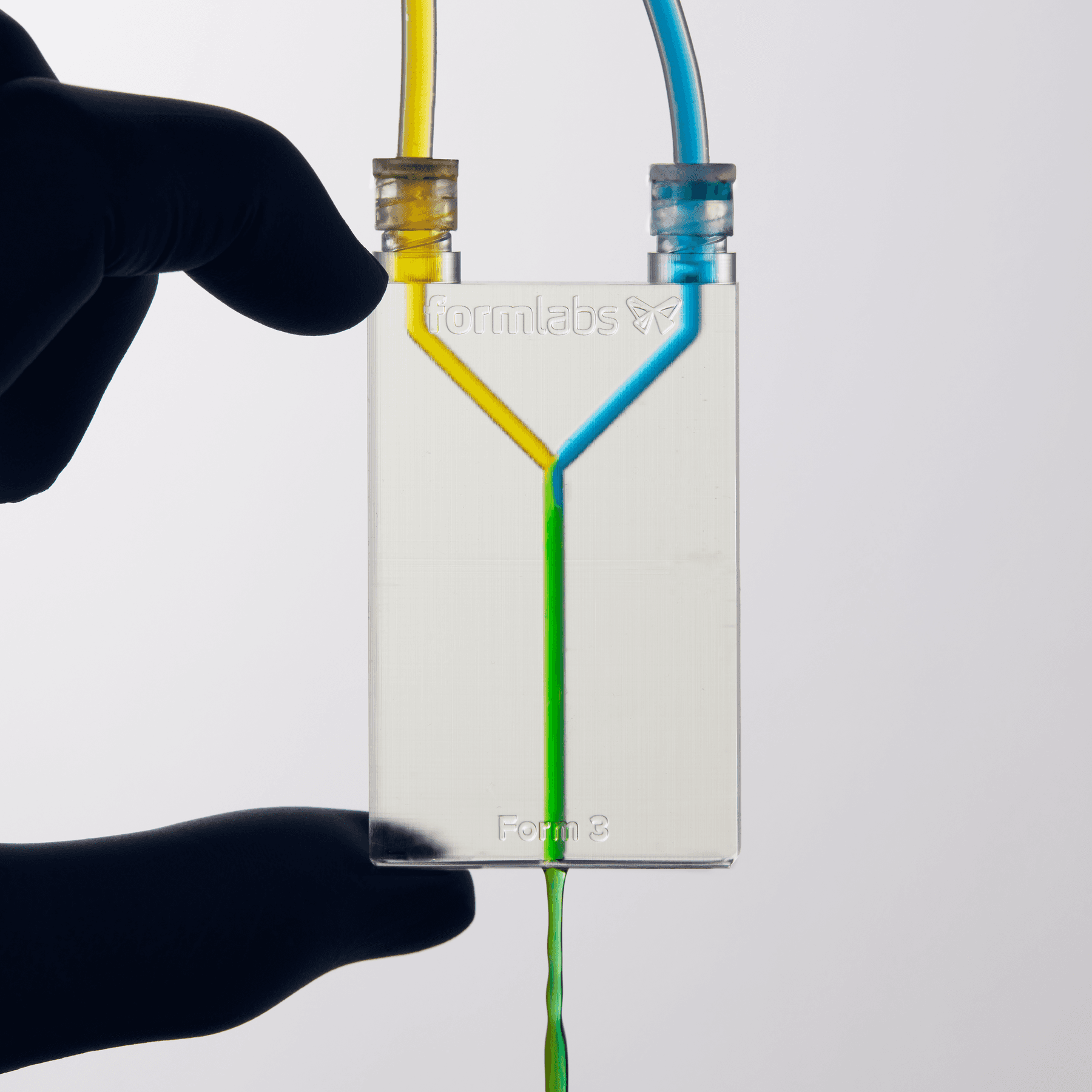

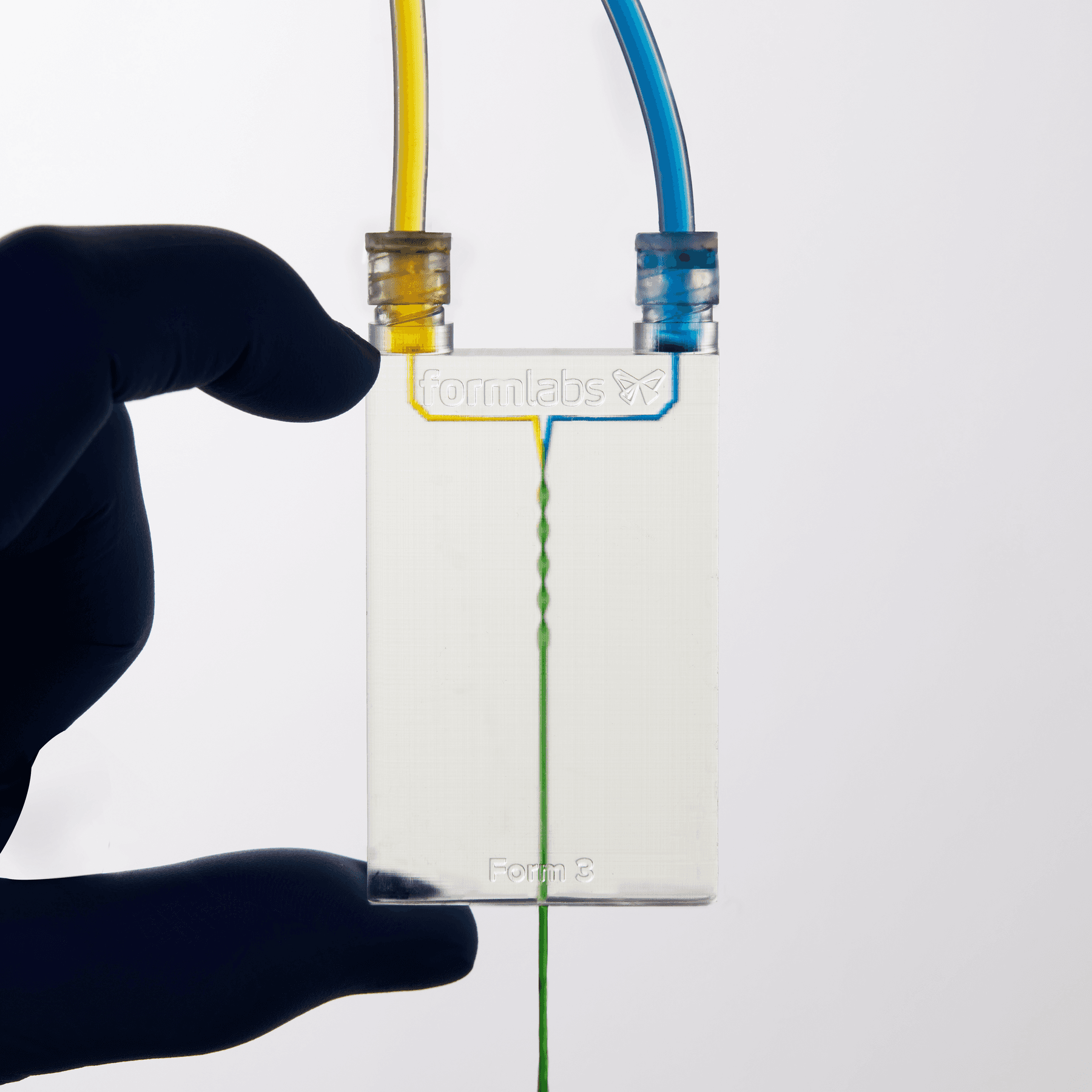

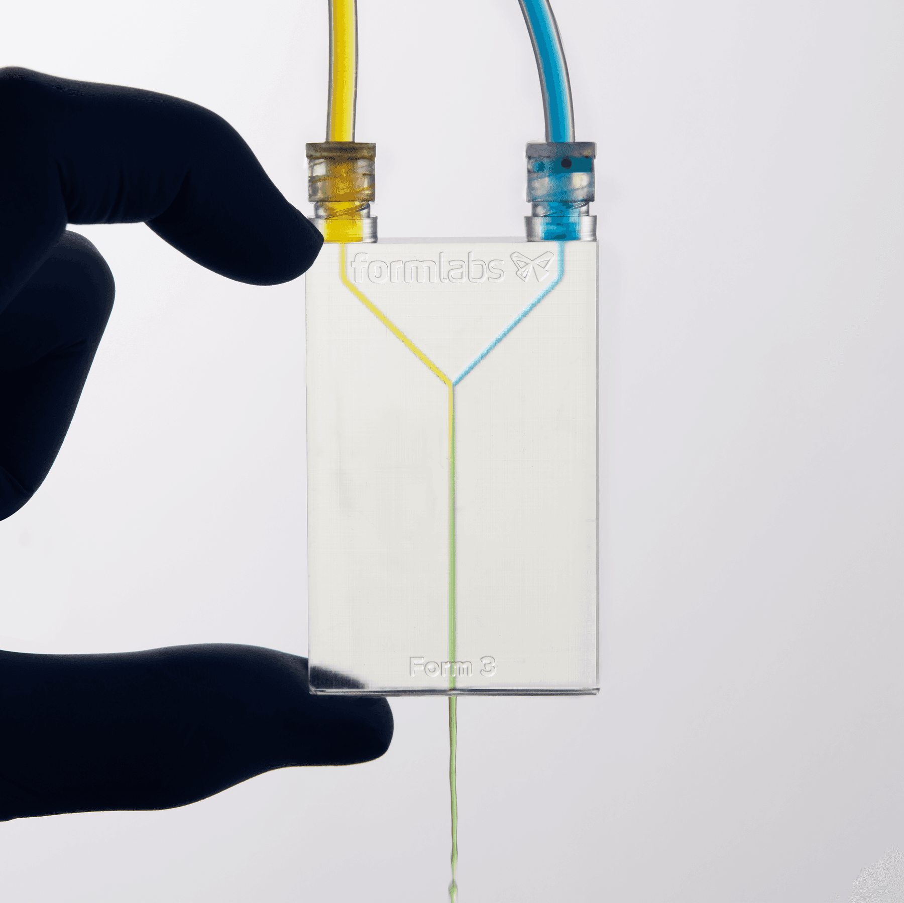

Y-Mixers
Both the large and small channel Y-mixer produced excellent results, with both liquids adequately mixing. The food dye allows us to see when, where, and how thoroughly the liquids in the channel mix.
A clear fluidic device with 2.5 mm channels. Yellow liquid enters from top left and blue from top right, mixing to form green
A clear fluidic device with 1.1 mm channels. Yellow liquid enters from top left and blue from top right, mixing to form green
On the left, a Y-mixer with 2.5 mm channels. On the right, a Y-mixer with 1.1 mm channels.
In both Y-mixers, the channels were clear, and fluid mixed as desired. The wide channels caused liquids to mix immediately, producing a thoroughly mixed green fluid. The thinner channel version caused a more gradual mixing of the two liquids. Mixing models can easily be made shorter or longer, and have the channel sized changed, depending on the results desired.

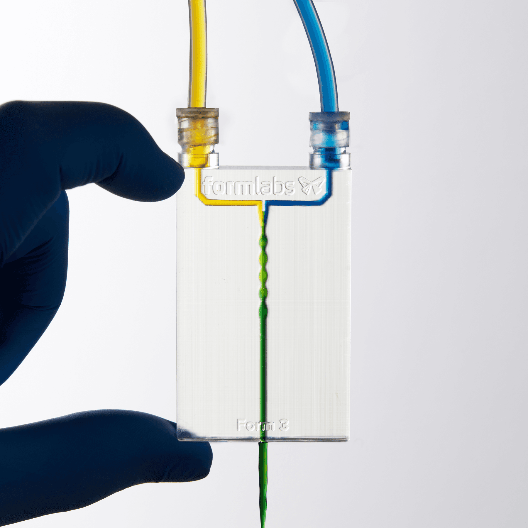

3D Channels
A clear device with 3D channels. Yellow liquid enters through the top left, blue through the top right, and the output is green
3D channels highlight a unique and powerful feature of 3D printing in-house millifluidic models. Sharp 3D features disrupt laminar flow in narrow channels and allow the designer to control when and how fluids mix.

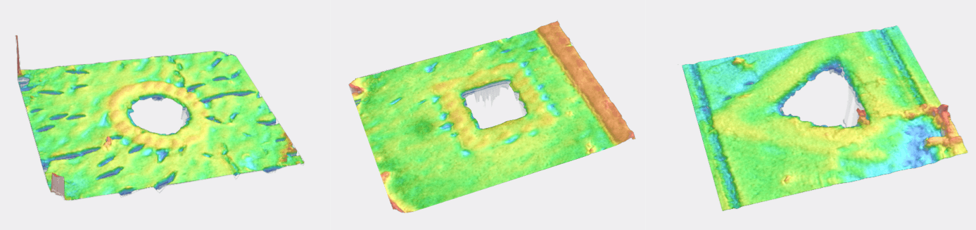

Channel Cross Section
With the full geometric freedom that comes with 3D printing, millifluidic chip designers have the ability to create any three-dimensional channel shape with no added cost.
Testing shows that circular channels consistently resolve with a 700 μm diameter, and optimal chip designs can see good results at 500 μm. Following suggested post-processing procedures will help prevent residual liquid resin in the channels from curing.
Three channel cross section shapes including circular, square, and triangular
Channel cross-sectional shapes. Circular profiles are most likely to resolve in more orientations compared to other profile shapes.
Further testing shows that channels with a circular profile will be much more likely to print correctly than channels with sharp edges and tight corners, such as triangular cross sections. When designing your chips for SLA, try to keep your channels as circular as possible at small diameters. If a unique profile is needed, print larger to ensure success.

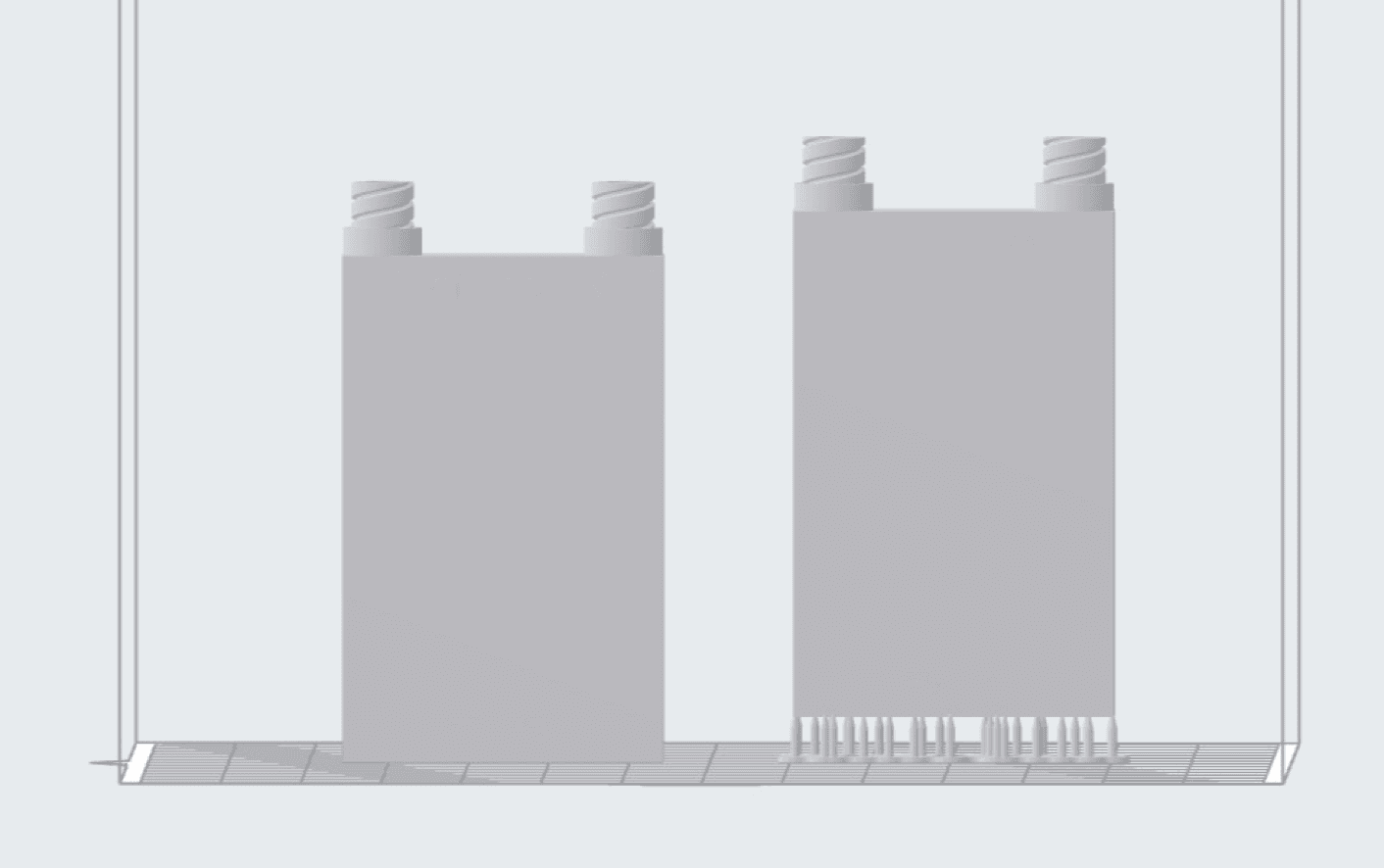

As with the majority of additive manufacturing processes, SLA can sometimes produce parts that warp very slightly after printing. But with a field as precise as millifluidics, dimensional accuracy is a crucial component for success. Orientation of your chip on the build platform plays a large roll in how your part cools and warps.
Testing shows that printing millifluidic chips vertically results in the least amount of warping. Users may need to print a few different versions of their chip to find which one creates the best channels for their geometry. Light touch supports mean minimal damage and residue to the chip surface when printing on an angle.
Screenshot of PreForm with one part flat to Build Platform and one on supports
We saw print success with vertical prints, both directly on the build platform and on supports. Printing directly on a Build Platform Flex will make the part easier to remove.
