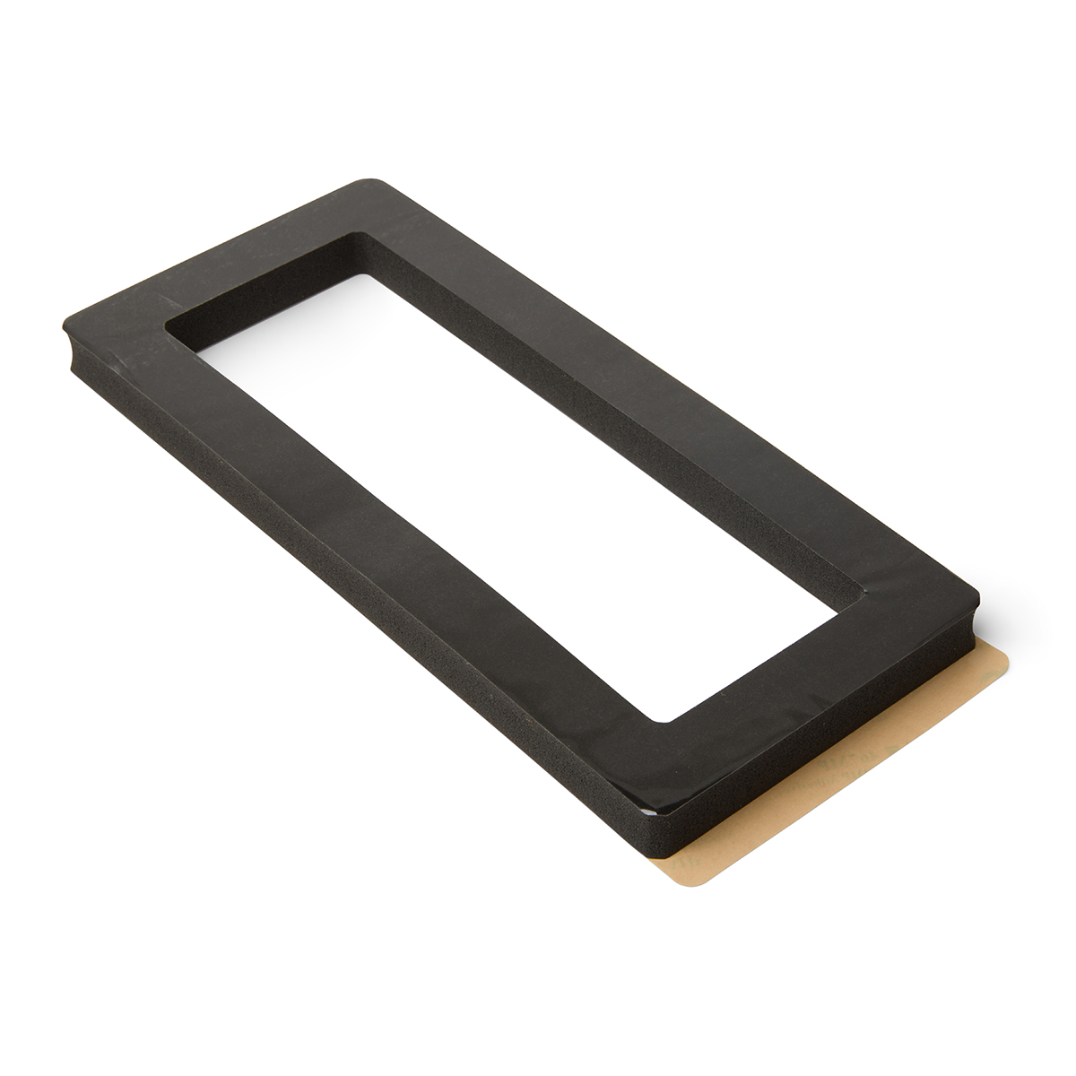

Step 1: Inspect the replacement hopper gasket
Inspect the replacement gasket for any contamination or debris. Use a clean paper towel to wipe it clean.
Fuse 1 hopper gasket
Step 2: Place the replacement hopper gasket on the hopper
One side of the replacement gasket has adhesive pre-applied. Peel any protective layers off of the gasket and adhere it to the bottom of the hopper. Make sure that the gasket does not extend into the hopper opening.
