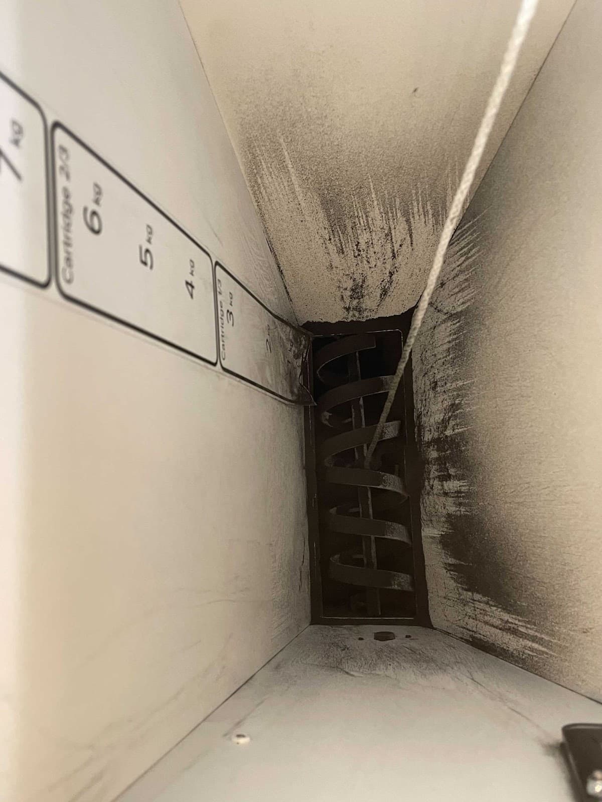

When cleaning powder out of a Fuse 1 generation printer, remove the bulk of the powder from the hopper and print enclosure before wiping surfaces or cleaning more sensitive components.
Note:
You may need multiple passes to remove the bulk of the powder from the printer. Repeat as needed, alternating between cleaning the hopper and the print enclosure.

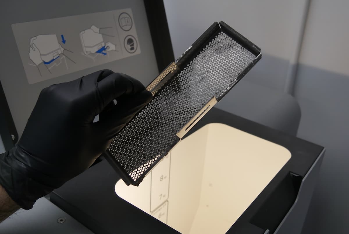

  1. Fuse 1 only: Remove the debris catcher grate from the hopper and vacuum it to remove all powder.
The Fuse 1's debris catcher grate removed from the hopper

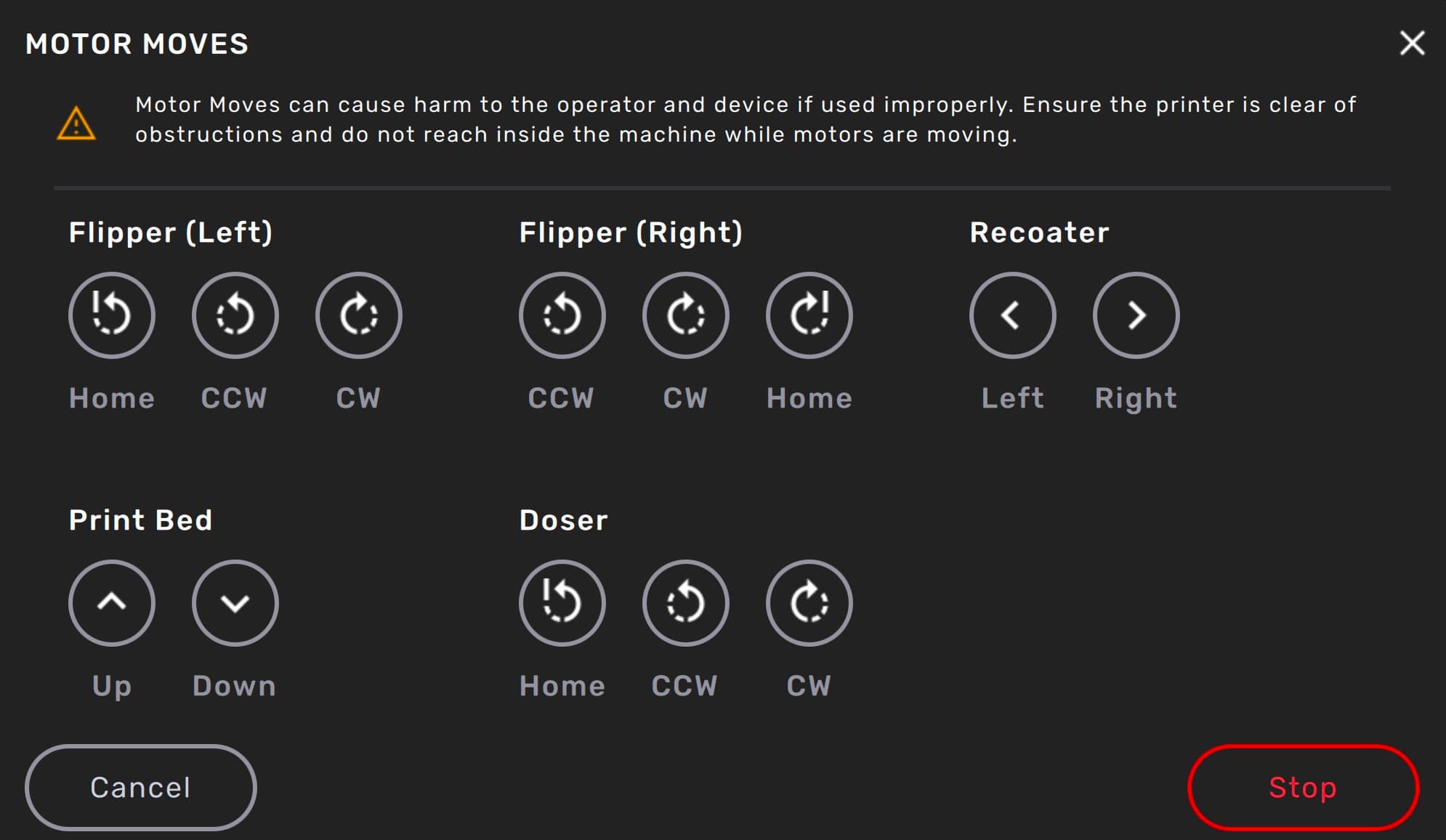

  1. Tap Maintenance > Motor Moves on the printer’s touchscreen. The Motor Moves screen appears, which allows you to manually activate various motors in the print enclosure.
  2. Tap and hold Left on the Recoater motor until the recoater reaches the left side of the print enclosure and stops moving.
  3. Tap Home on the Doser motor. Wait until the doser stops moving before continuing.
  4. Open the print enclosure door and locate the right-hand trough. Tap and hold CW on the Flipper (Right) motor until the flipper is completely vertical.

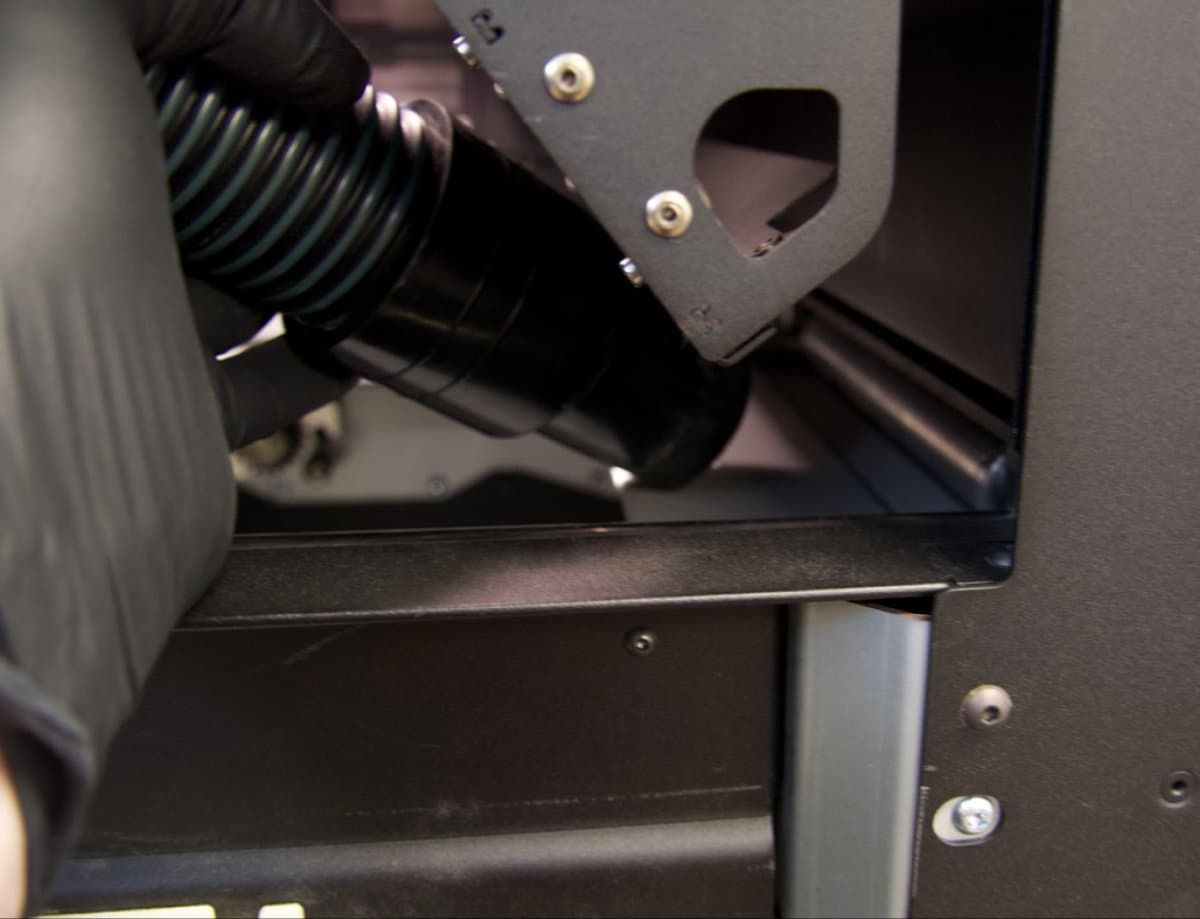

alttext
  1. From within the print enclosure, insert the vacuum attachment where the build chamber would usually be placed. Face the attachment upward toward the troughs and recoater.
  2. Bring the attachment up through the hole where the print bed would usually be to insert the wide end into the right-hand trough. The attachment hooks into place underneath the flipper.
  3. Pull the tube that attaches to the vacuum downward to test that it is in position. The attachment should not come out.
The vacuum attachment enters up through the print enclosre to hook into place and hold up the doser.
  1. Attach the vacuum hose to the attachment.
The vacuum attachment enters up through the print enclosure to hook into place and hold up the doser.

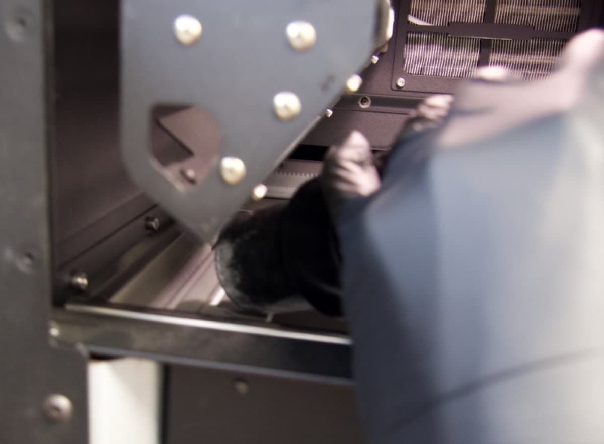

Step 4: Clean the doser assembly
Leave the vacuum with the attachment inserted inside the trough as you move the doser inside the hopper to dislodge powder.
Notice:
  • When using compressed air or a gas duster to clean the machine, always keep the vacuum running to catch any mobilized powder.
  • Do not use a brush attachment to clean the doser, particularly when the doser is running. The doser can pull bristles off the attachment, potentially contaminating your powder and causing future prints to fail.
  1. Turn the vacuum on while keeping the vacuum with the attachment inserted inside the trough.
  2. Tap and hold CW for the Doser for 10 seconds, then tap and hold CCW for the Doser for 10 seconds while vacuuming. Repeat this cycle four times.
  3. Tap and hold CW for the Doser in small, two-second intervals until the doser completes a full revolution.
  4. Tap and hold CCW for the Doser in small, two-second intervals until the doser completes a full revolution in the opposite direction.
  5. Aim compressed air into the hopper from the top of the hopper.
  6. Tap and hold CCW for the Doser for 30 seconds while compressed air is used from inside the hopper. Repeat until no more powder comes out. If you are cleaning a Fuse 1+ 30W printer, ensure that all surfaces of the agitator are visibly clean.

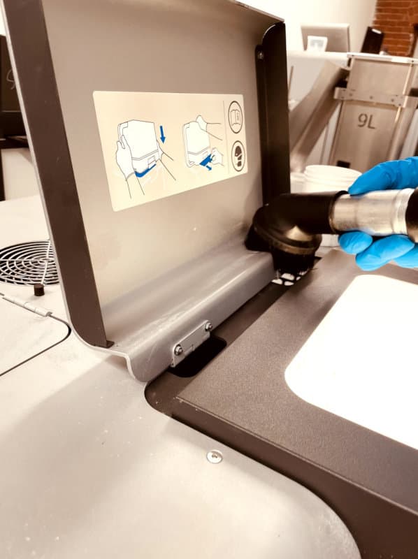

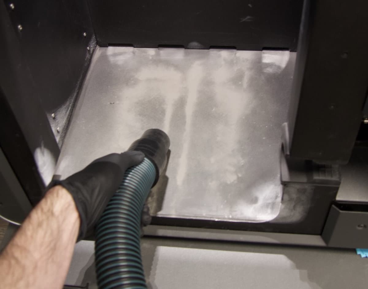

Step 1: Vacuum the print enclosure
Open the print enclosure door. Vacuum any loose powder in the print enclosure. Use compressed air or a gas duster as necessary to remove powder from hard-to-reach areas.
Vacuuming the Fuse 1's print enclosure

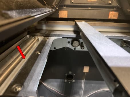

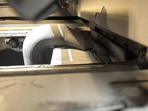

Step 2: Clean the powder troughs
Two troughs run from the front to the back of the printer at the top of the print enclosure. The troughs store powder to be dispensed into the build chamber. Use the vacuum, fitted with a small brush attachment or the flexible hose attachment, to clean all powder out of the troughs. Use compressed air or a gas duster as necessary to remove powder from hard-to-reach areas. Check in particular for powder buildup along the inner walls and corners of the troughs.
If you previously printed the nozzle set, you can use the hook tip to reach into the troughs.
Vacuuming the left powder trough
Vacuuming the right powder trough
Step 3: Move powder trough motors
Close the print enclosure door and move the flipper motors to dislodge powder for cleaning.
To move the flipper motors:
  1. Close the print enclosure door.
  2. On the touchscreen, tap the wrench icon. The Maintenance menu appears.
  3. Tap Motor Moves. The Motor Moves screen appears, which allows you to manually activate various motors in the print enclosure.
alttext
Caution:
Unless specifically advised, do not select any of the options in the Motor Moves menu while the print enclosure door is open or any objects are in the path of the powder handling mechanisms at the top of the print enclosure. Moving parts present a crushing or tangling hazard. If necessary, tap the Stop button on the touchscreen to stop a motor movement.
  1. Tap the CW, CCW, and Home arrows under the Flipper (Left) and Flipper (Right) headers to rotate the left and right flippers clockwise, counterclockwise, or back to their home positions. Repeatedly move the flippers and vacuum the powder troughs until they are clean. In particular, ensure that the inner edge of both powder troughs as well as any adjacent components are free of powder.
Left powder trough with an arrow pointing at the inner edge of the trough

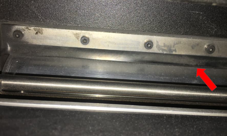

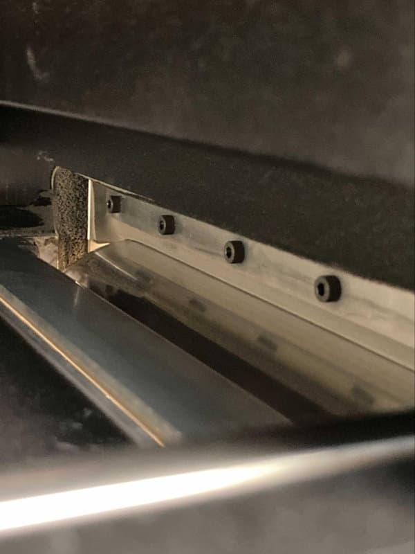

Step 4: Check the hopper gasket
After cleaning the powder troughs, examine the trough on the right side of the printer. Check the position of the gasket running along the outside edge of the trough. Blowing compressed air down into the hopper can force the gasket out of place and into the path of the recoater. Use a thin tool or your gloved fingers to push the gasket back into place behind the edge of the trough.
Right powder trough with an arrow pointing at the hopper gasket
Hopper gasket positioned correctly
Hopper gasket positioned incorrectly, overlapping with the right powder trough
The left image shows a hopper gasket that is properly placed behind the edge of the right-hand powder trough.
The right image shows a hopper gasket that is not properly placed behind the edge of the right-hand powder trough. The gasket overlaps with the powder trough.

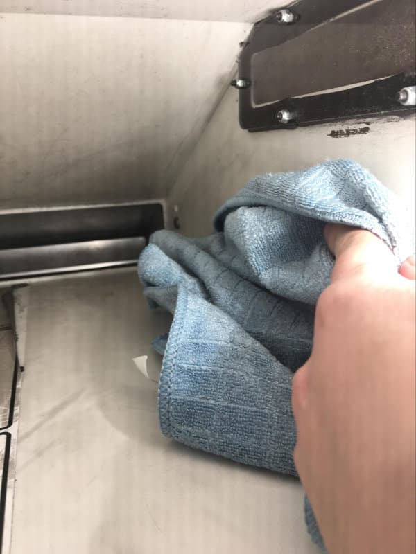

Step 5: Wipe the print enclosure
Wipe the print enclosure with a clean microfiber cloth to remove any residual powder.

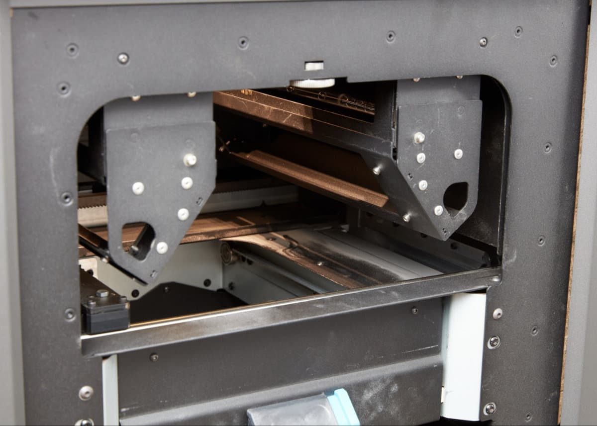

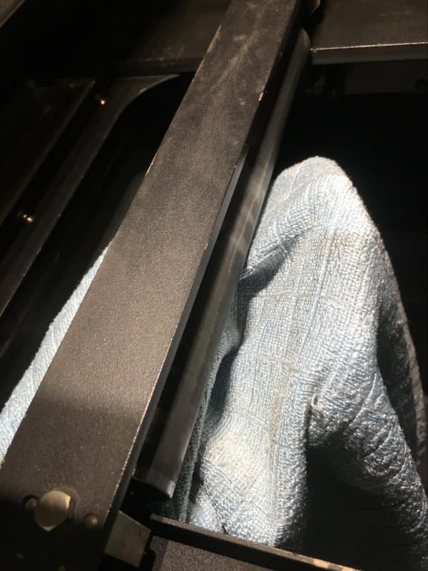

Step 6: Wipe the recoater
The recoater is a bar that moves left and right across the top of the print enclosure, spreading powder across the print surface to form a new layer of the print.

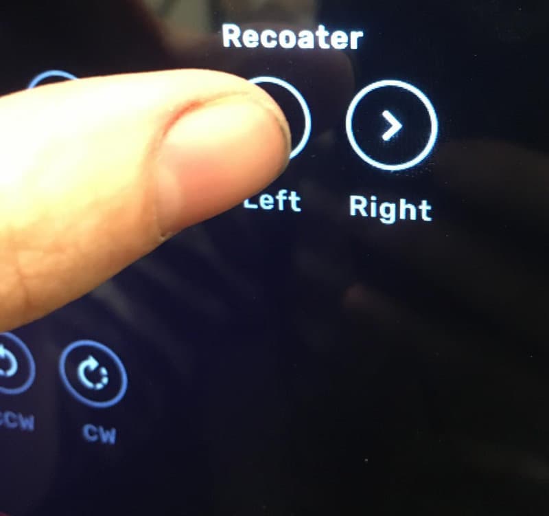

To move the recoater into position for cleaning:
Caution:
  1. Tap the Left and Right arrows under the Recoater header to move the recoater. The recoater rotates as it moves, changing the area that is exposed. Repeatedly move the recoater and wipe it with a microfiber cloth until it is clean.
Moving the Fuse 1's recoater with the 'Motor Moves' screen
Wiping the Fuse 1's recoater with a microfiber cloth
Notice:
If you are switching between Nylon 12 Powder and Nylon 12 GF Powder or between Nylon 11 Powder and Nylon 11 CF Powder, stop here. If you are switching between any other two materials, continue following the cleaning steps below.

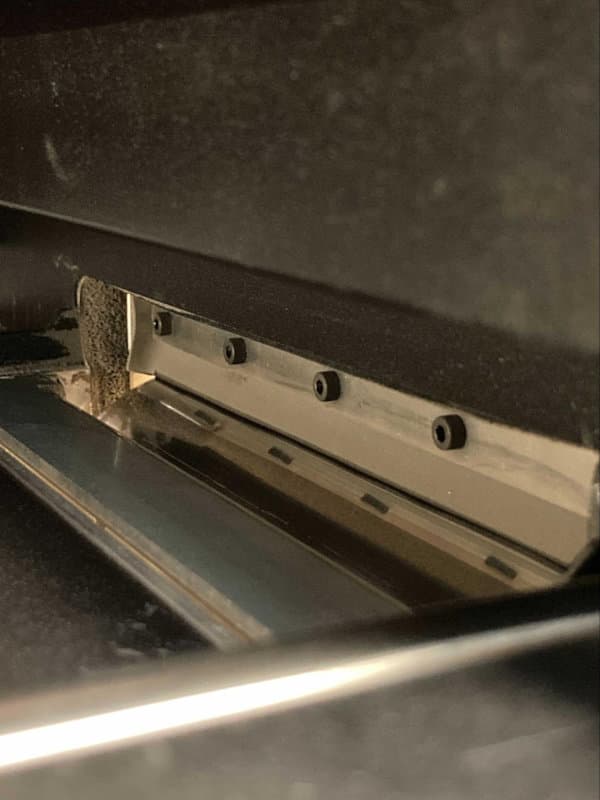

Cleaning the print enclosure door
Clean any powder that may have settled on the inside of the print enclosure door, particularly behind and around the gasket.
Step 1: Vacuum the print enclosure door
Connect a brush attachment to the vacuum hose. Vacuum the inside surface of the print enclosure door.

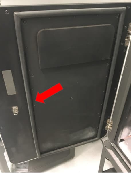

Step 2: Clean behind the door gasket
The print enclosure door has a large rectangular gasket on its inner face. Use compressed air or a gas duster to remove powder from around and behind the gasket.
Human head (left-hand profile) wearing a mask
Notice:
The Fuse 1's print enclosure door with an arrow pointing at the gasket on the inside of the door

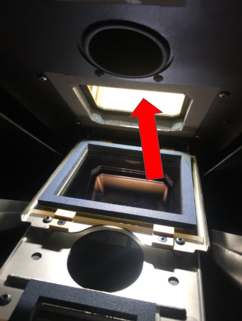

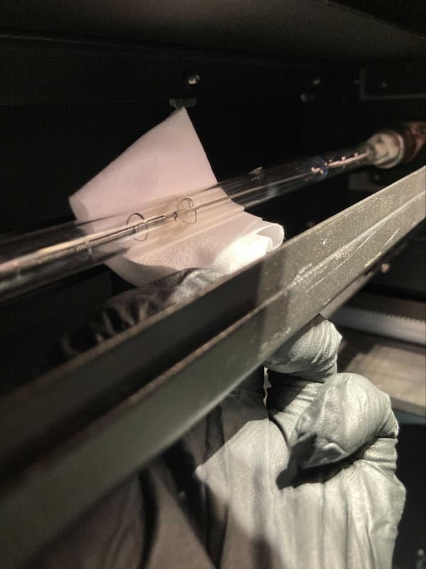

Cleaning the quartz heaters
Put on a new, clean pair of nitrile gloves. Carefully wipe the quartz heater tubes with a clean, dry PEC*PAD.
Warning:
The heater tubes are fragile and very sensitive to damage and contamination from skin oils. A damaged or contaminated heater tube may explode when heated. Do not turn on the machine if the heater tubes are damaged or contaminated.
Step 1: Wipe the heater tubes
Two quartz heater tubes run from the front to the back of the printer at the top of the print enclosure. Gently clean one of the heater tubes with a clean, dry PEC*PAD to remove any powder buildup. Repeat with a new PEC*PAD for the other heater tube.

Never handle the heater tubes with your bare hands. If at any point bare skin contacts the quartz glass, thoroughly clean the tube with a clean PEC*PAD wetted with ethanol.
The Fuse 1's heater tubes at the top of the print enclosure
Wiping the Fuse 1's heater tube with a PEC*PAD

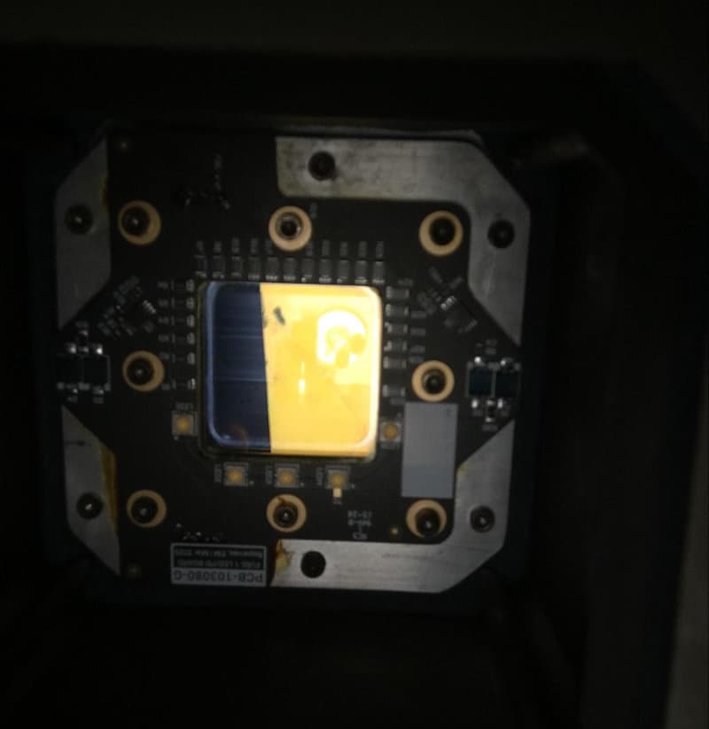

Cleaning optical surfaces and sensors
Clean the optical and sensor surfaces: the optical cassette, IR sensor, and upper laser window. Follow the normal cleaning procedures for these components, as you would when doing routine maintenance.
Step 1: Clean the optical cassette
Remove the installed optical cassette and clean it to remove any powder that may have settled on it during cleaning.
Step 2: Clean the upper laser window
Inspect and clean the upper laser window. Reinstall the optical cassette.
The Fuse 1's print enclosure with an arrow pointing at the upper laser window
The Fuse 1's upper laser window
Step 3: Clean the IR sensor
Open the IR sensor door at the top of the printer. Clean the IR sensor. Reinstall the sensor and close the IR sensor door.

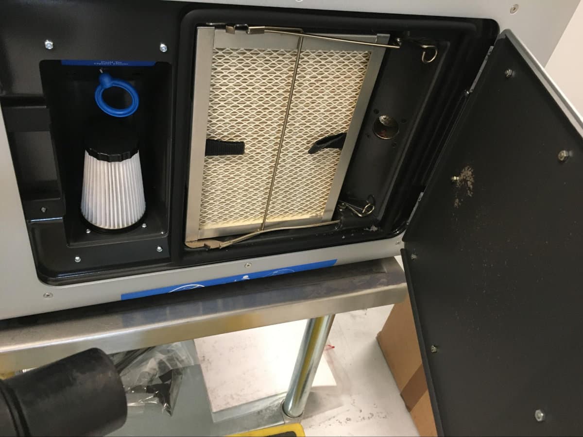

Cleaning the air filters
Vacuum or replace the air filters and clean the related air handling hardware. Take care to clean any powder that may be mobilized while working with the filters.
Step 1: Vacuum or replace the air filters
Open the filter cabinet door on the right side of the printer. Clean the air filters, exhaust lines, and exhaust fan. As an alternative, replace both the intake filter and the exhaust filter.
Tip:
Gently use compressed air, a gas duster, or soft brushes to knock powder loose from the filters.
The Fuse 1's filter cabinet
Step 2: Reinstall the air filters
Reinstall the filters and close the filter cabinet door.
Wiping the powder hopper
Finish by wiping down the inside of the hopper with a clean microfiber cloth. If you used compressed air to clean inside the print enclosure, powder may have been blown back into the hopper.
Step 1: Wipe the hopper
Wipe the inside of the hopper with a clean microfiber cloth to remove any residual powder.
Wiping the inside of the Fuse 1's hopper with a microfiber cloth
