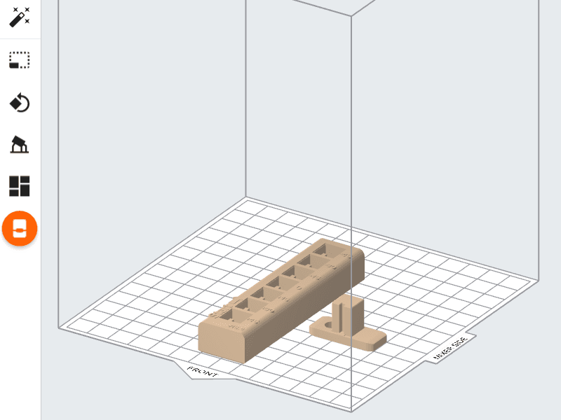

The test file opens the Fit Tuning Test as two separate parts within PreForm
