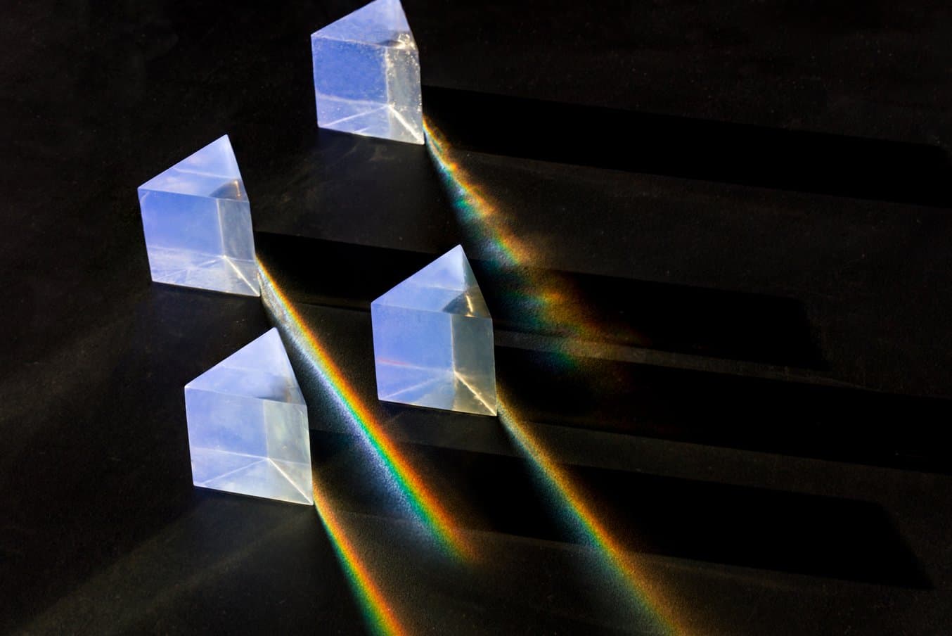

From left to right: Not sanded, no rainbow. Sanded + Clear Resin, hints of spectral splitting. Sanded + clear nail polish, a fractured rainbow. Sanded + glossy acrylic spray, a strong rainbow. Have fun with your prism
Use prisms together to bend rainbows.
In our winter office, we had best results between 2:00 and 3:30 on a sunny day. Your results depend on your location, season, and sunlight direction. If you don’t want to wait for the sun, a flashlight or laser pointer will also shine through the prism. Experiment with different angles and light colors, and enjoy the beautiful product of your hard work.
