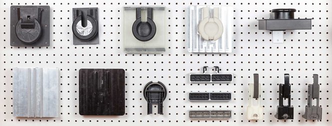

Pictured below is an early prototype of a jig that we currently use on our manufacturing line. We designed it from the start to print directly on the build platform (rather than requiring support structures) to reduce post-processing time, then quickly assembled and tested it. After several rapid iterations, we sent the jig out for machining, tested for reliability and product quality, and then implemented it at our factory.
An early prototype of a jig that we currently use on our manufacturing line.
The version on our manufacturing line now is machined from aluminum, but the initial printed part was dimensionally accurate enough that it performed as we expected, better than the last version, and helped us decide that it was worth machining this part.
Nothing beats machined metal for longevity. Printed parts experience wear after thousands of cycles, but the ability to quickly, easily print parts that we can test, fix, and re-print within 24 hours has saved us a great deal of time, money, and agony.
