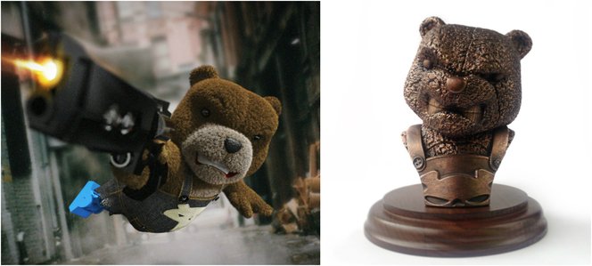

With its menacing gun and blue mechanical leg, Matt Burniston’s Mega Bear is no ordinary plush toy. Starring in Matt’s The Mega Plush short film series, which features the story of a gang of plush vigilantes, this Mega Bear has expanded its presence beyond the virtual world and made an appearance as a Form 1 3D-printed bust!

MB: My main software is Modo. I also love to jump in to Zbrush and get sculpting. Sometimes it’s a combination of both, like the Mega Plush busts I recently created. All the modelling was done in Modo, but for the film they are covered with a fur material, which cannot be exported as geometry for print data. The underlying models are quite simple, so to mimic the fur texture for 3D print, I took them over in to Zbrush and reapplied a fur looking surface texture to them. Then it is just a case of hollowing them out and scaling them to size, and exporting .stl files ready for PreForm.

MB: The finishing process is actually quite simple. After getting my print out and cleaned up, I fill the hollow shell with Plaster of Paris. I had been reading online that people were using a 2 part epoxy or urethane, and had commented that it was quite pricey, so I figured that Plaster of Paris is a super cheap, rock solid alternative.
Once it is all filled in and dry, I use Rustoleum 2X Ultra Cover flat black primer. This stuff is amazing. One coat is all you need to take the grey resin (which is what I have been using) to a super solid matte black surface. It sticks to the print really well and I haven’t had any issues with it so far.
After that I use Rub 'n' Buff, which is kind of like a metallic shoe polish. And you do exactly what it says - rub it on and buff it up - and boom you have a metallic looking surface. I've experimented with a few techniques of application, including a cloth, finger and brush. I find that a brush works the best, but you have to make sure you only have the tiniest amount loaded on the bristles at any time. To do this I dab the brush into the Rub 'n' Buff, then use a rag to wipe off the excess, then very lightly rub that over the surface of the print. By only applying the metallic color onto the high parts of the model, it leaves the black base color in all of the creases, which simulates dirt build-up and giving the model really nice dimension. Once it is dry I then go in and buff it up for a nice shine.
