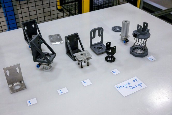

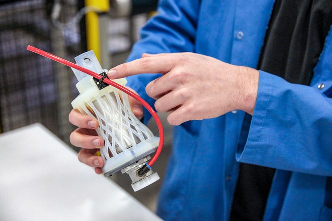

The process of optimizing an end of arm gripper bracket part at AMRC consisted of five stages.
The part was ultimately produced with stereolithography (SLA) 3D printing.
This gripper bracket example from AMRC is a perfect illustration of part level optimization. Engineers looked at the available materials and the constraints of the 3D printing manufacturing process to create a part design that balanced optimization in its final usage as well as manufacturability.

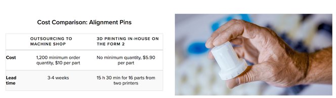

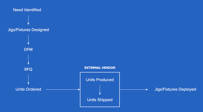

One prominent area in which 3D printing contributes to process optimization is jigs, fixtures, and customized tooling for manufacturing operations. Often, companies are using in-house 3D printers to re-verticalize; this means replacing the high cost of outsourced purchase orders, the pain of minimum order quantities, and long lead times from their vendors’ shops to implementation on the factory floor.
In House/ Re-verticalization:

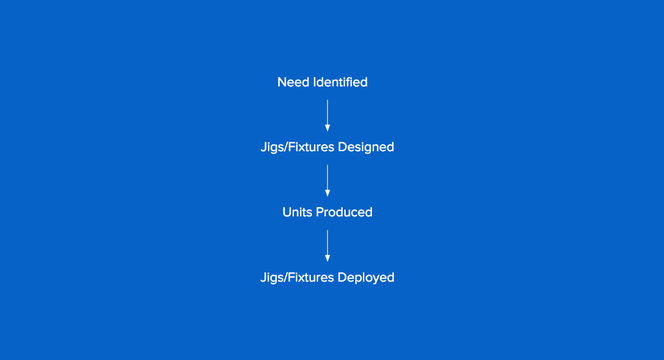

A traditional workflow of outsourcing jig and fixture production with machining requires DFM, often carries minimum order quantities to be cost effective, and can take days or weeks of lead time.
Additive-enabled workflow for producing jigs and fixtures in-house significantly cuts down the steps between identifying a need and integrating a solution on the factory floor.
Using in-house 3D printing for re-verticalization has helped Ashley Furniture’s case goods unit save time and money on jigs, fixtures, and tooling, like this alignment pin.

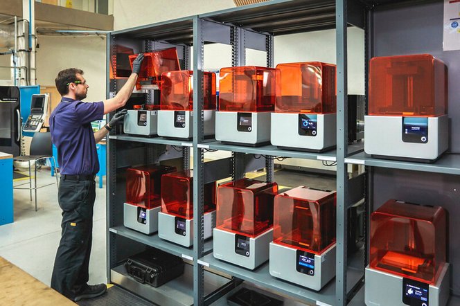

The University of Sheffield Advanced Manufacturing Research Centre (AMRC)
“I needed units that staff members can be easily trained on and be successful with so that they want to use them again. The Form 2 is the first small SLA machine that I've used where I thought, ‘yeah, this is a game changer.’ In terms of machinery, it's so simple to use,” Cocking said. “The software is very intuitive, engineers can pick it up very quickly. It's easy for them to understand and grasp the basics, and from there on, they can learn themselves and can push their additive experience themselves. Currently, we have just over 100 engineers trained to use the Form 2 bank.”
AMRC’s Formlabs print farm is used extensively by their team of over 100 engineers.

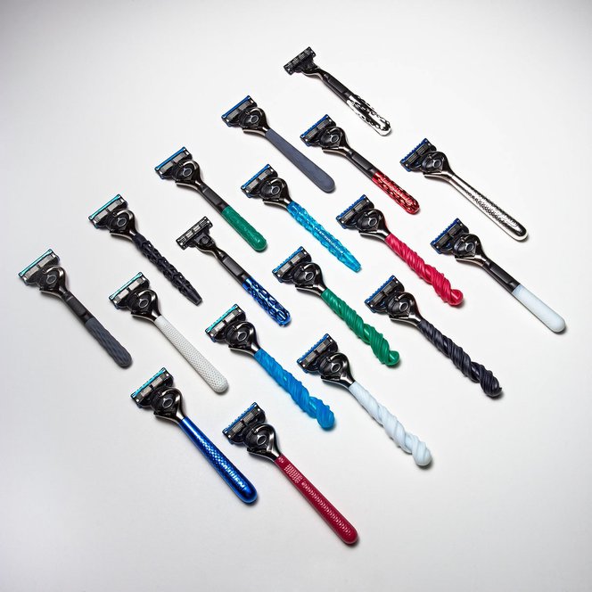

For example, Gillette used direct 3D printing in their Razor Maker initiative, which allowed customers to choose from an incredibly wide range of color and pattern combinations, and even included the ability to personalize razor handles with names. Producing goods on demand, with batch sizes of 1 in some cases, would be impossible to achieve cost effectively with traditional manufacturing practices.
Similar personalization or customization efforts are underway in orthotics, earbuds, and vehicle components. In all of these examples, customized or personalized goods enable optimized products that truly match individual bodies or tastes. Brands are better able to provide customers with exactly what they want, when they want it.
