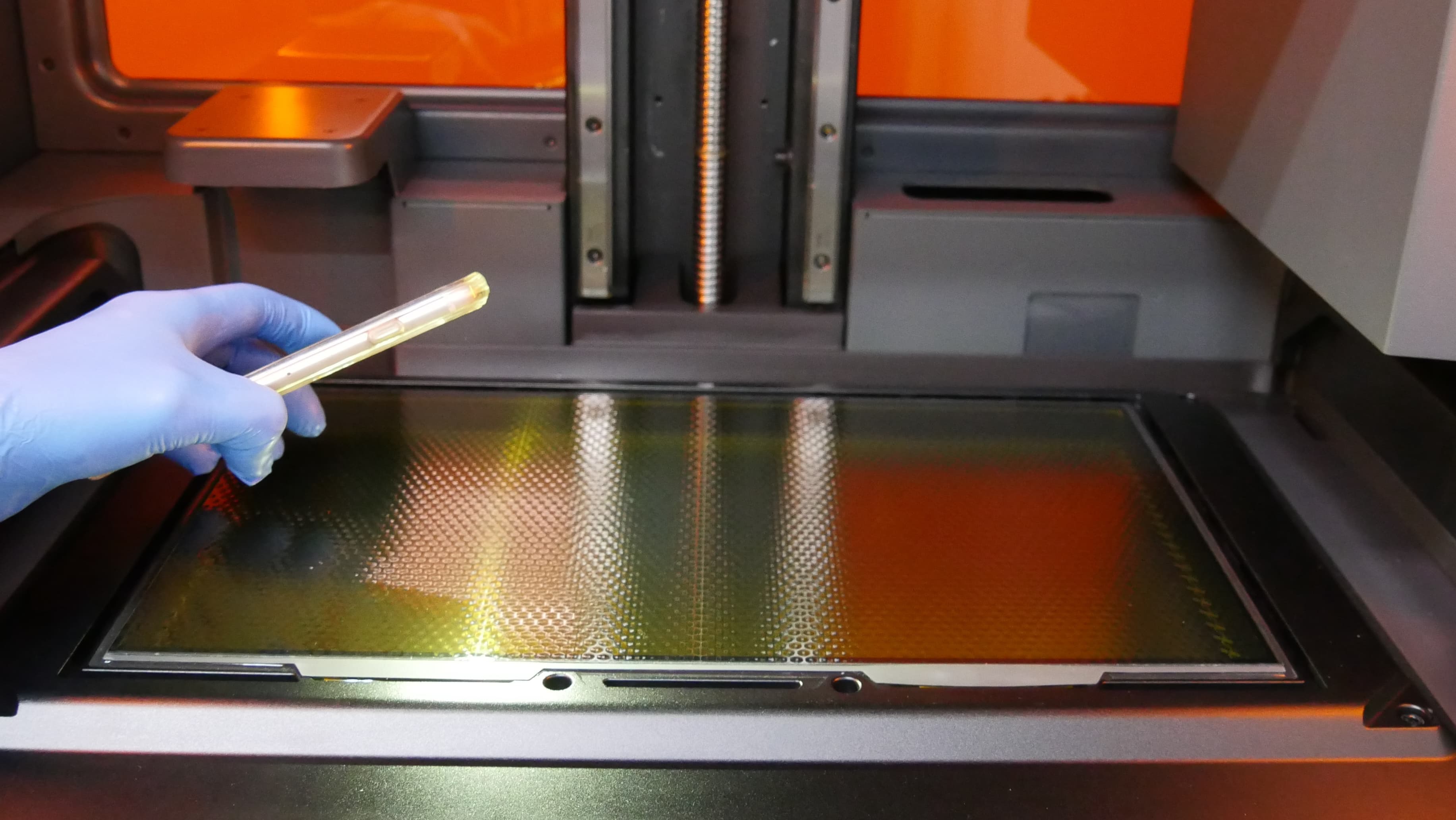

  4. Shine a secondary light source (for example, a flashlight, LED or cell phone light) onto the release texture to reveal any hidden contamination on its surface.
  5. Hold the light source at the shallowest angle possible. From the edges of all three accessible sides, pass the light back and forth across the release texture.

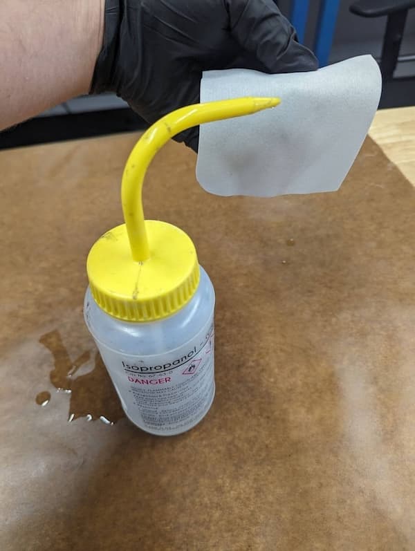

  2. Grip the top of a non-abrasive wipe with a gloved hand. Soak the bottom half of the wipe with clean isopropyl alcohol.
Wetting a non-abrasive wipe with isopropyl alcohol

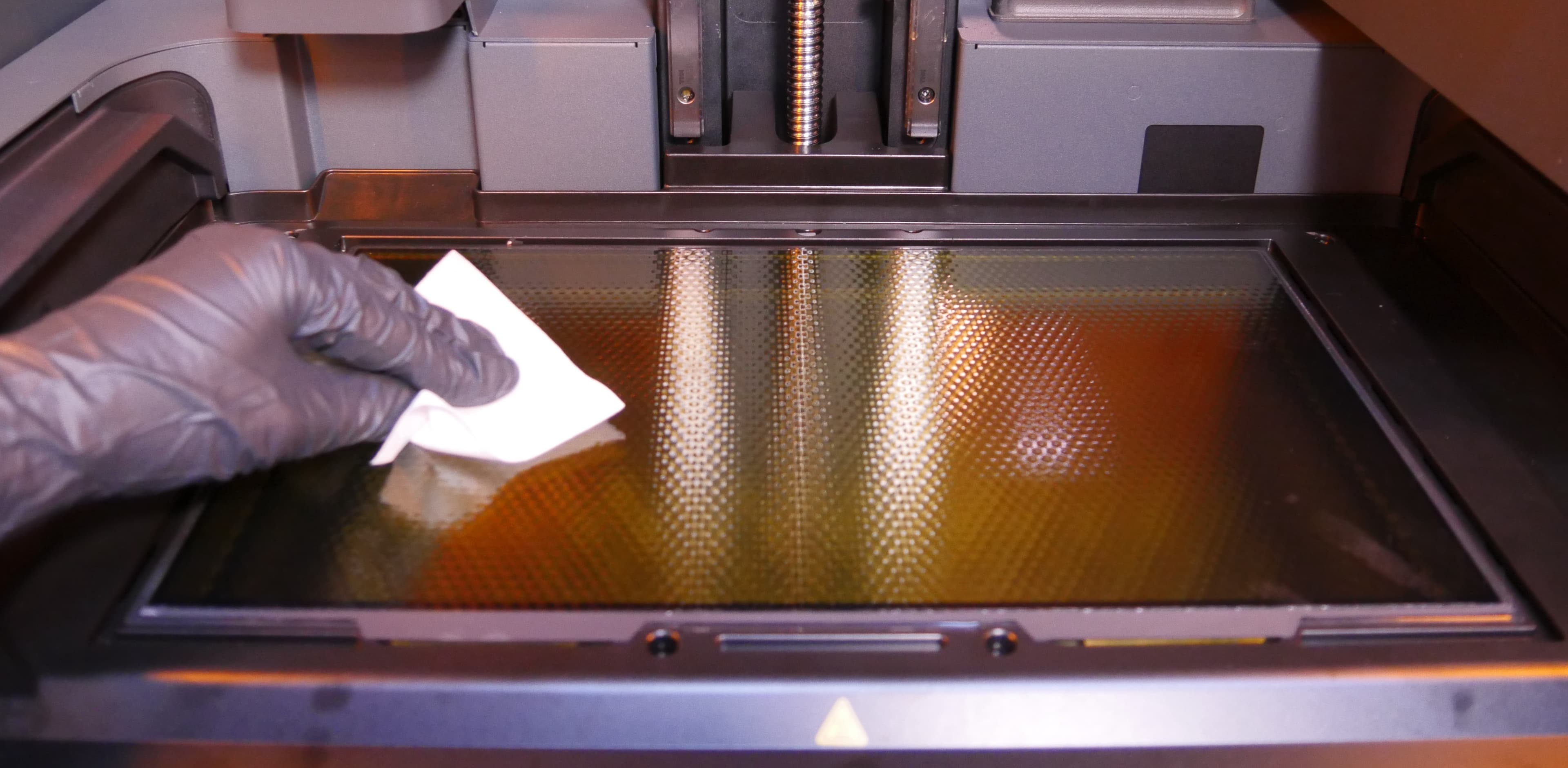

  1. Drag the isopropyl alcohol soaked wipe slowly across the surface of the LPU. It should take 20–30 seconds to traverse the width of the LPU.
    • Do not contact the release texture with your hand or apply pressure to the wipe.
    • For debris and resin near the edge of the LPU, always drag the wipe towards the edge of the LPU to avoid spreading the contaminant.
alttext
  1. Wait for the isopropyl alcohol on the release texture to dry.
  2. Repeat this process several times until the contaminant has been removed.

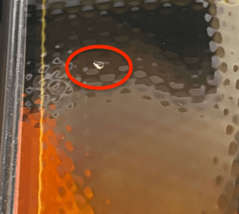

The LPU may sustain damage to the release texture that looks like cured resin or like part of the texture is missing. This is usually caused by the build platform squishing debris into the texture during a print.
Damage to the LPU may affect print quality, since it can redirect the light coming from the backlight unit. This damage may be very small and difficult to feel on the surface of the release texture. If you see LPU texture damage that you cannot remove, take a photo of the damage and contact Formlabs Support or your authorized reseller.
