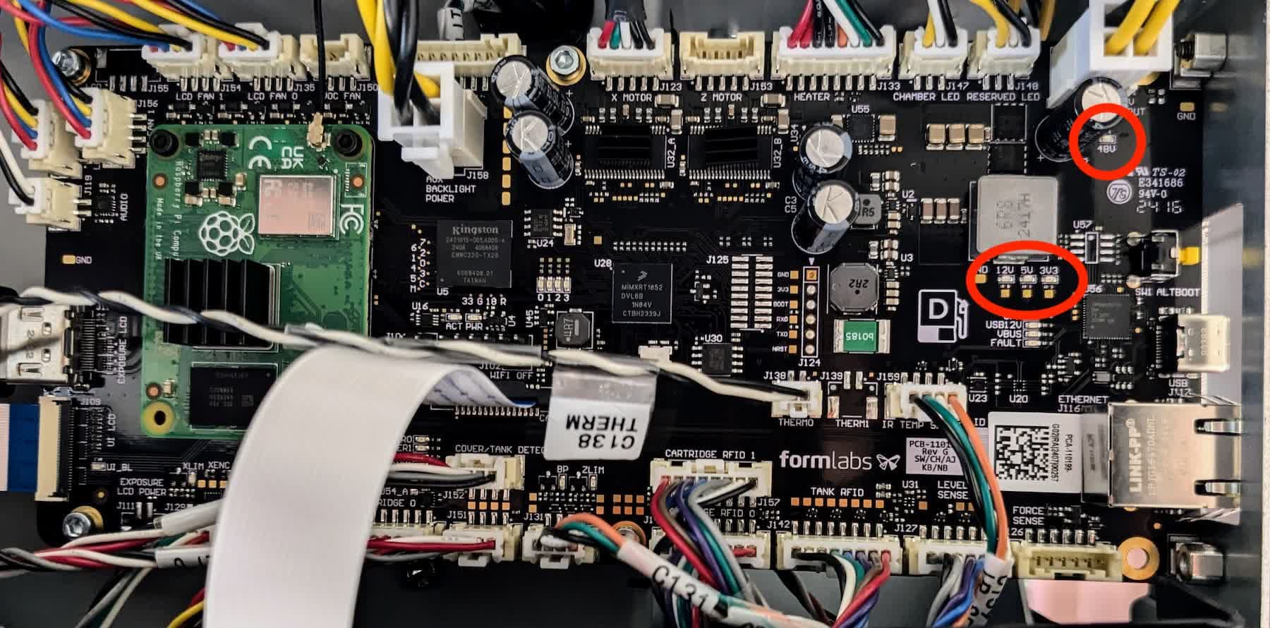

If the printer is not available in PreForm, you can diagnose which component has failed by checking the four power LEDs on the printer’s motherboard.

  1. Reconnect the machine to power and observe the motherboard power LEDs, shown below. Follow the steps in the flowchart below to check each of the power LEDs.
Power indicator LEDs on the Form 4 and Form 4L generation motherboard

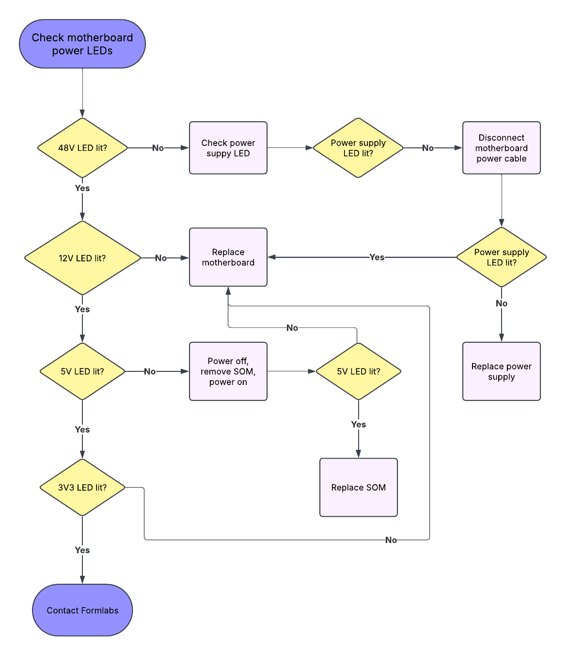

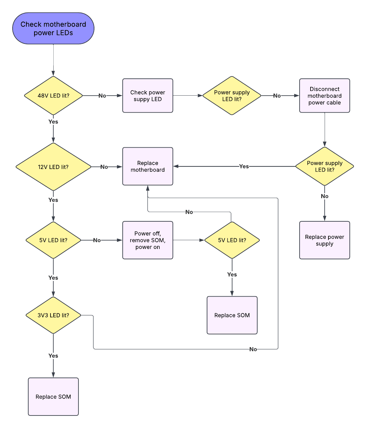

Flowchart for checking power LEDs
  1. If the 48V LED is not lit, check the power supply LED.
  2. If the 48V LED is lit but the 12V LED is not lit, replace the motherboard. Form 4 and Form 4L printers use the same motherboard, which is available on the Formlabs Store. Follow the appropriate guide for your printer to replace the motherboard.
  3. If the 12V LED is lit but the 5V LED is not lit, turn off the printer, remove the SOM, then turn the printer back on and re-check the 5V LED. Follow the appropriate guide for your printer to remove the SOM.
    1. If the 5V LED is still not lit, replace the motherboard.
    2. If the 5V LED is lit, the SOM needs to be replaced. Replacement SOMs are available for purchase on the Formlabs Store.
  4. If the 5V LED is lit but the 3V3 LED is not lit, replace the motherboard.
  5. If all four power LEDs are lit, replace the SOM.

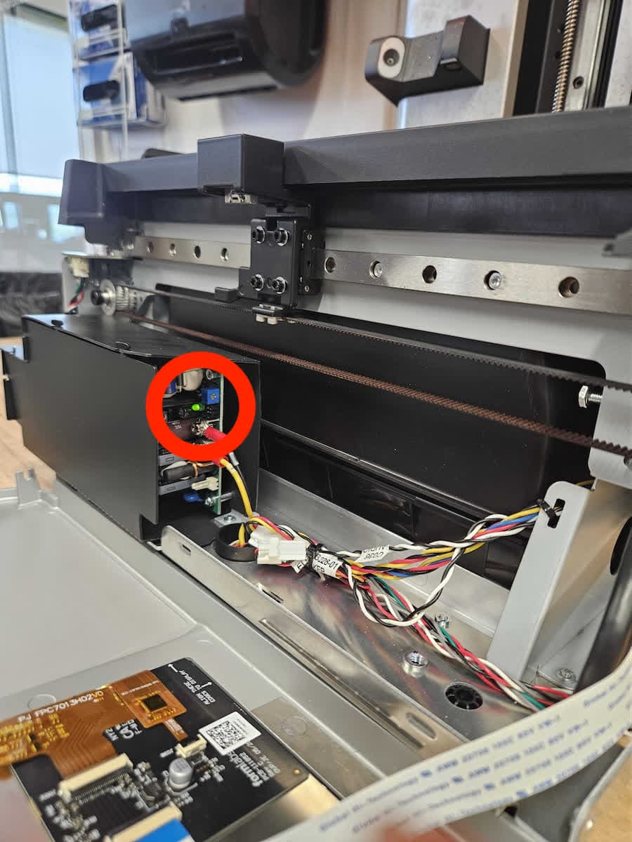

If the 48V LED on the motherboard is not lit, the power supply may be defective and not providing power to the motherboard or there is a fault on the motherboard that is interfering with power delivery. To determine which is the case, check the activity LED on the power supply.
  1. Disconnect the printer from its power source.
  2. Access the power supply. Follow the appropriate guide for your printer, linked below. Stop at the section titled “Removing the power supply.”
  3. Power on the printer and observe the power supply LED, shown below.
Power supply LED on a Form 4 generation printer
Power supply LED on a Form 4L generation printer
  1. If the LED is not lit, power off the device again and disconnect the power cable from the motherboard. The power cable has a square connector, located next to the green SOM on the motherboard. Disconnect the connector by pushing down on the tab and sliding the cable out of the connector. Take care not to pull on the wires.
  1. Turn the printer on again. If the LED still does not turn on, the power supply needs to be replaced.
  2. If the power supply LED turns on once the motherboard is disconnected, then it is more likely that the motherboard is defective and needs to be replaced.
