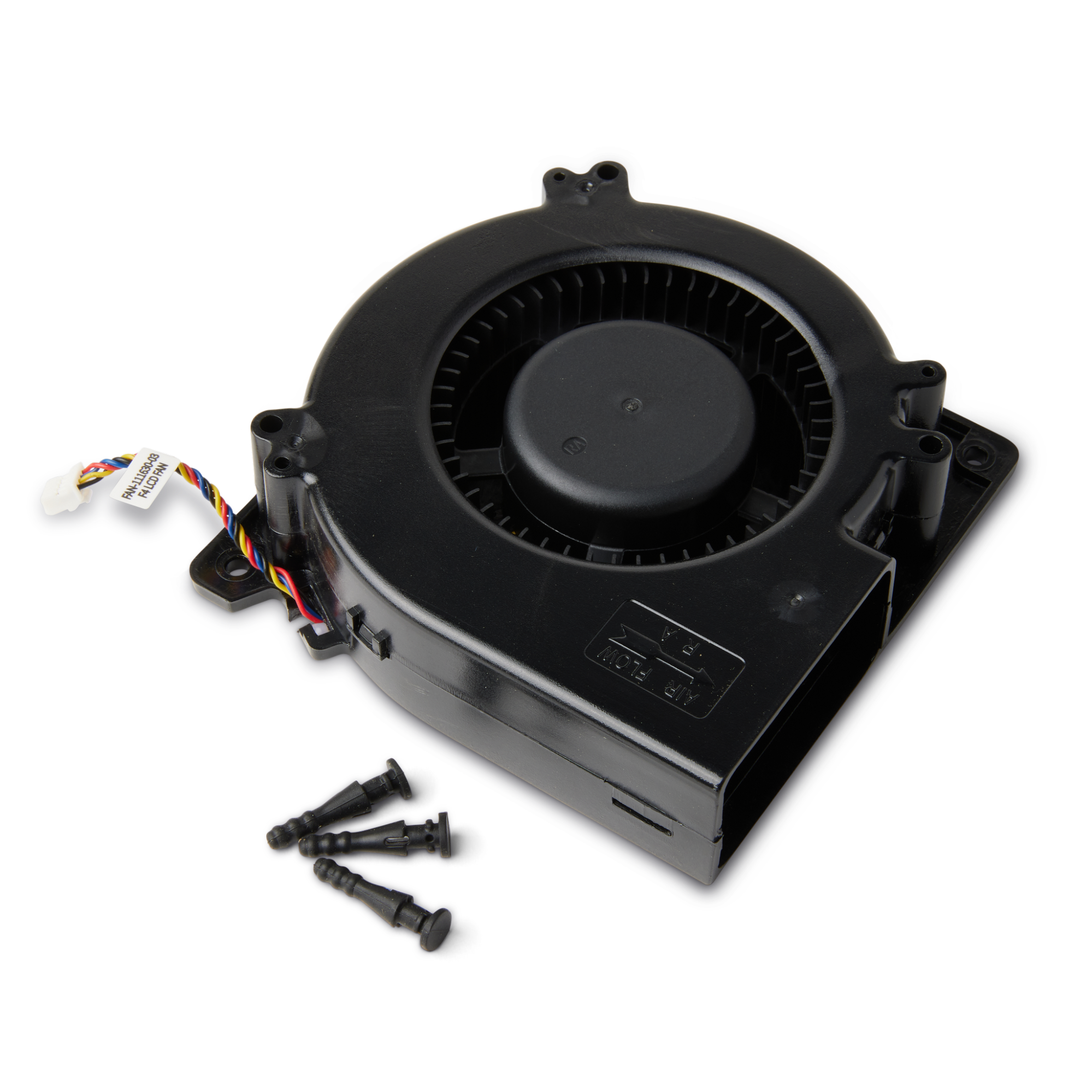

Required Supplies:
Formlabs:
  • Light Processing Unit fan
  • Fan mounting hardware
  • 2.5 mm hex driver (included in the Form 4 tool caddy)

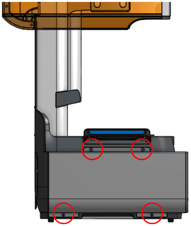

Step 1: Remove the left panel retention screws
Remove the Form 4 left panel retention screws
Use a 2.5 mm hex driver to remove the four screws securing the left panel to the printer. Set the left panel and the screws aside.

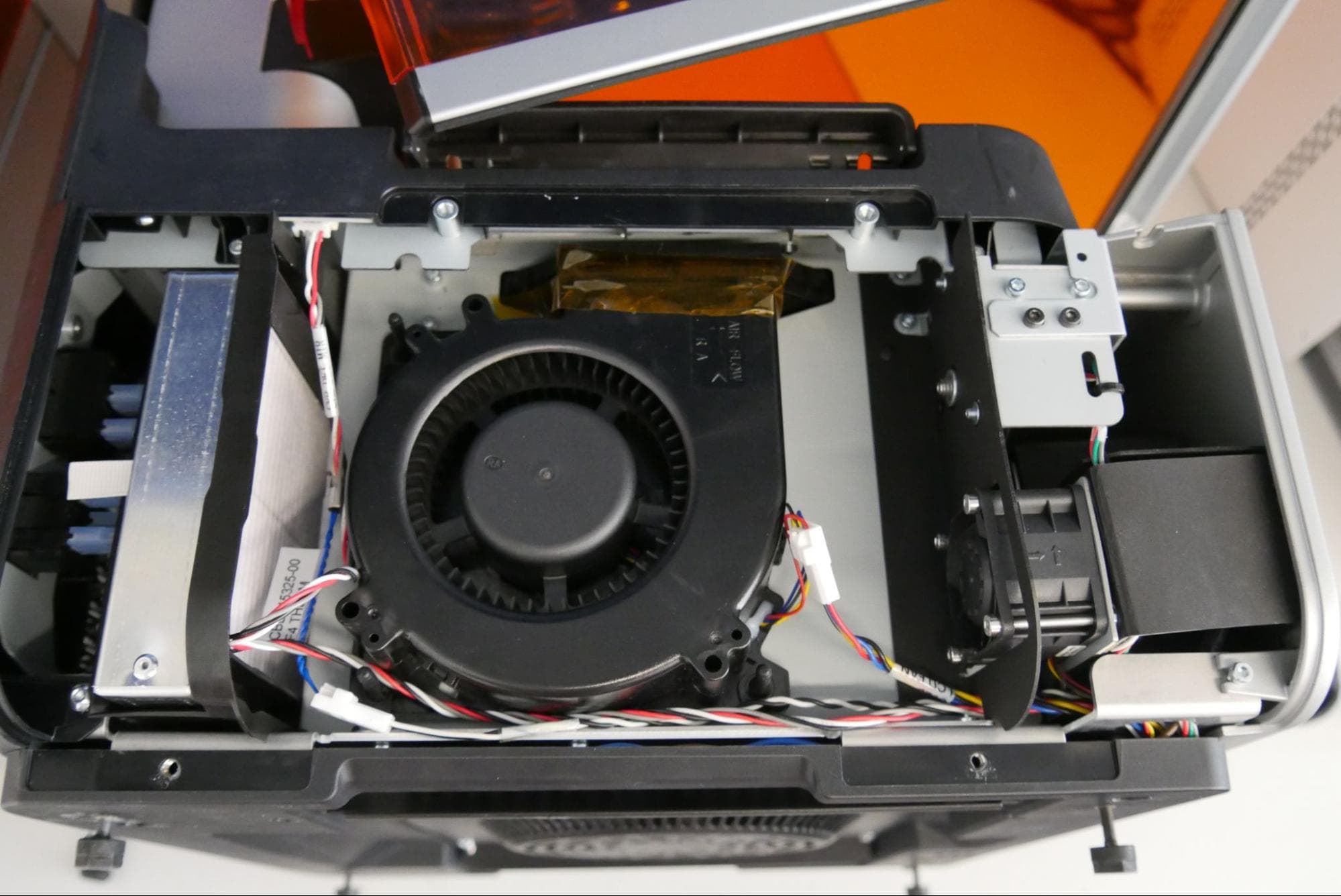

Step 2: Rotate the printer

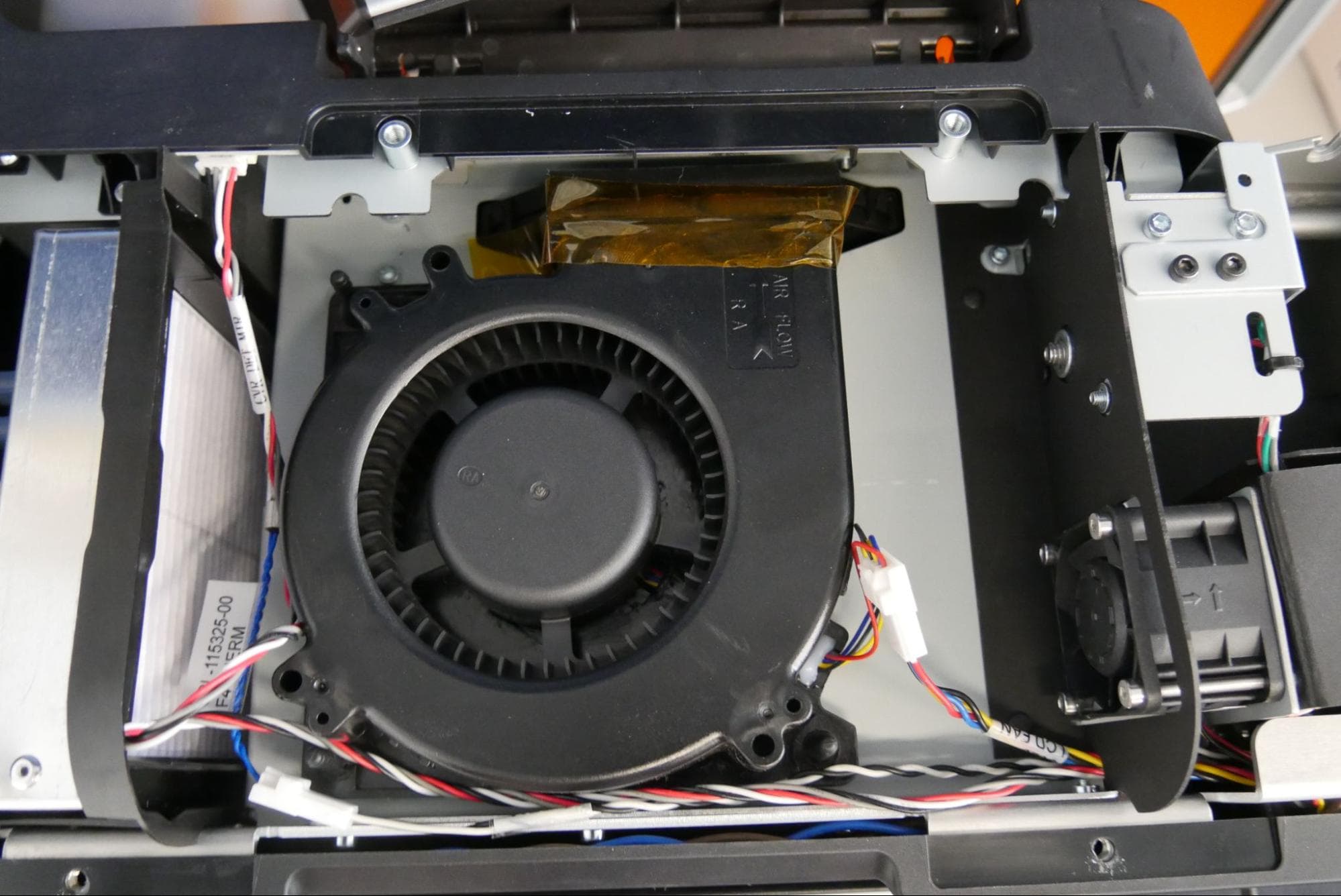

Form 4 LPU fan visible with printer on its right side
Rotate the printer onto its right side so the LPU fan is facing up.

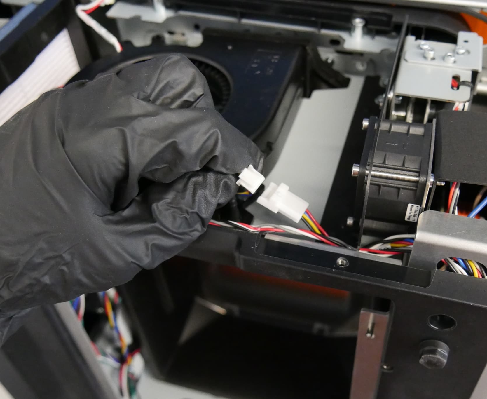

Step 3: Disconnect the cable
Disconnecting the Form 4 LPU fan cable
Release the cable that connects to the LPU fan by pressing on the plastic tab on the connectors. Take care when unplugging the cable to avoid damage. Once the plastic tab is pressed, the cable easily slides from the connector. Do not pull on the wires.

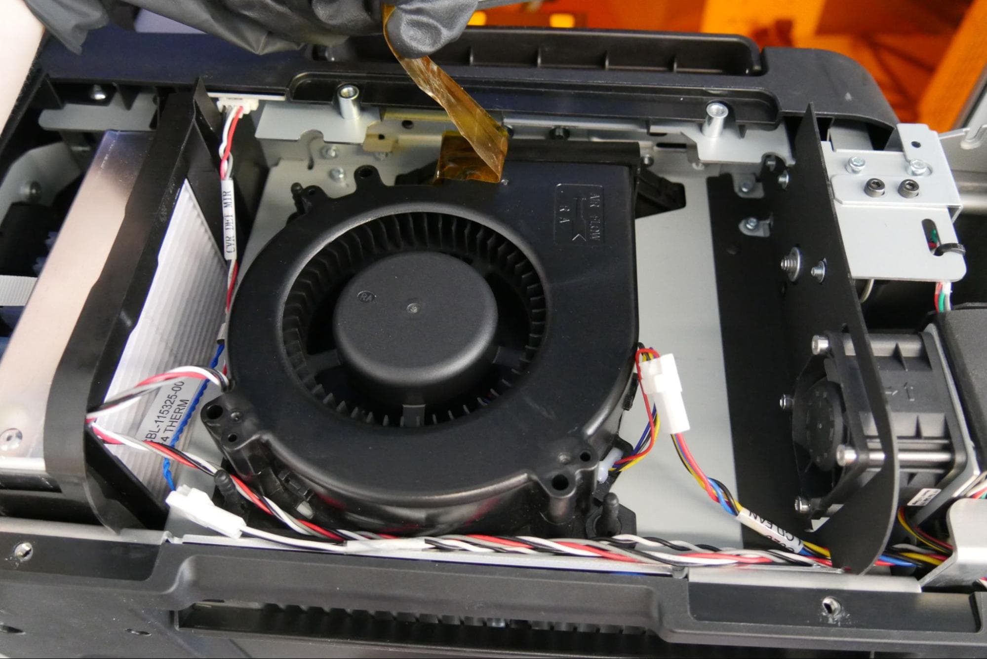

Step 4: Remove the tape
Carefully removing the tape from the Form 4 LPU fan
The LPU fan is secured by tape. Carefully remove the tape from the LPU fan. Set the tape aside for reuse during installation.

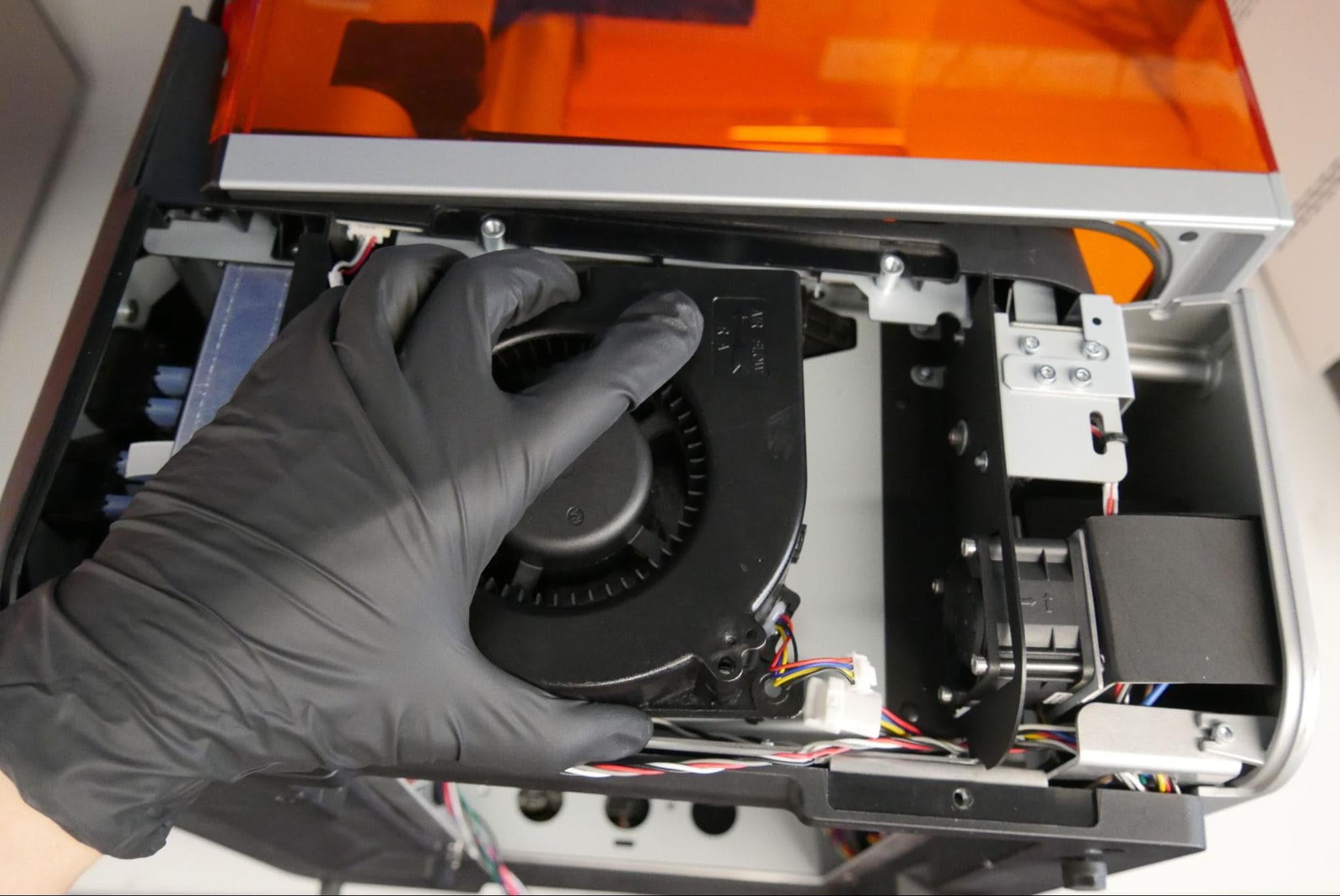

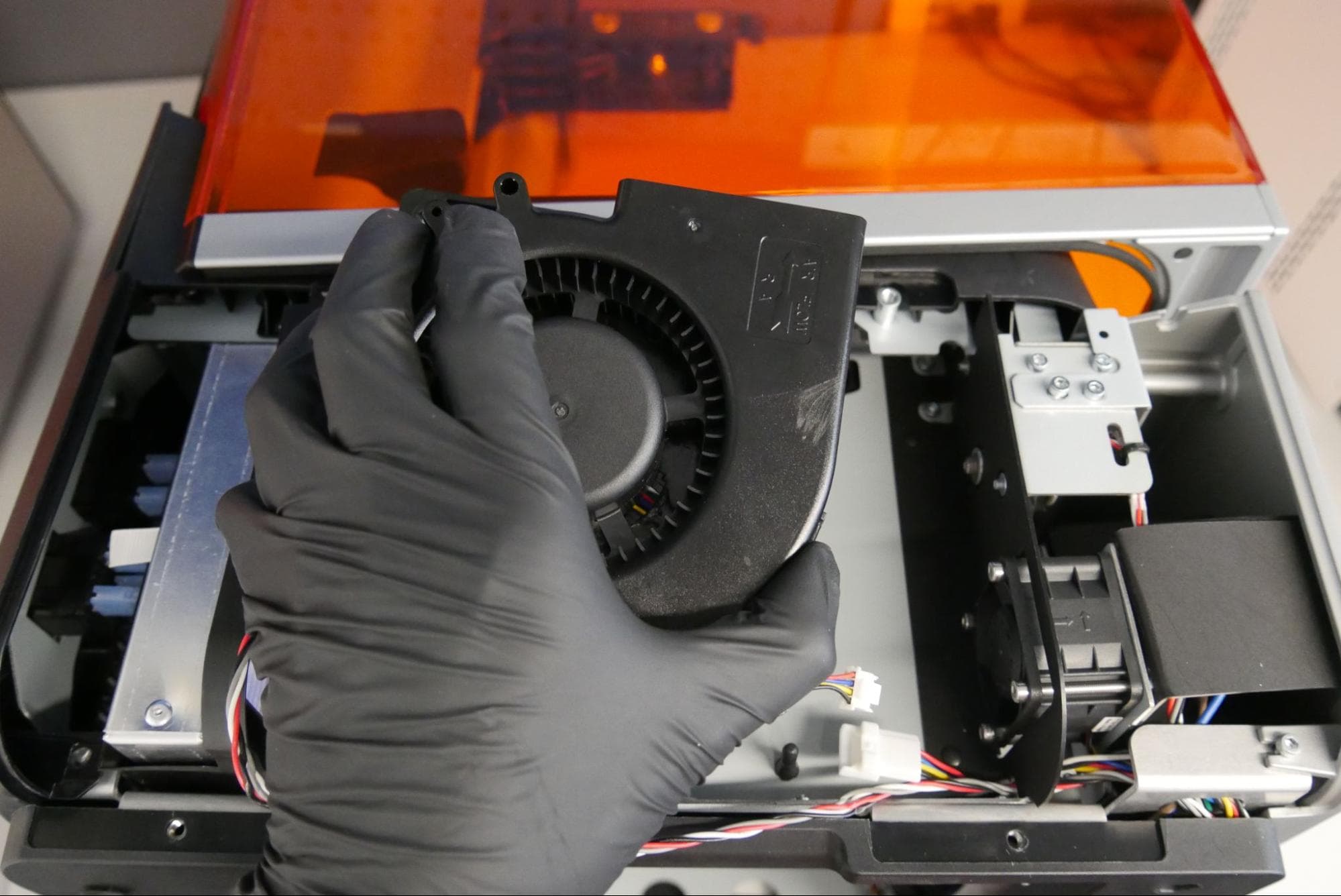

Step 5: Remove the LPU fan

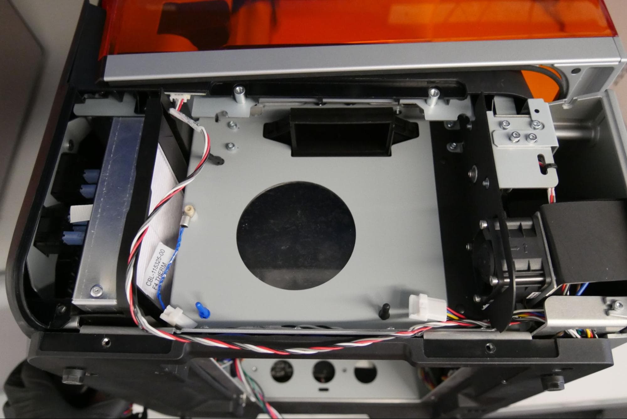

Gripping the Form 4 LPU fan to lift it out of the printer
Form 4 LPU fan removed from printer
The LPU fan is secured to the printer frame with three rubber pins. Grip the LPU fan and lift it out of the printer. If the LPU fan is difficult to remove or the rubber mounting pins become damaged during removal, proceed to the next section Optional: Replacing the fan mounting hardware.

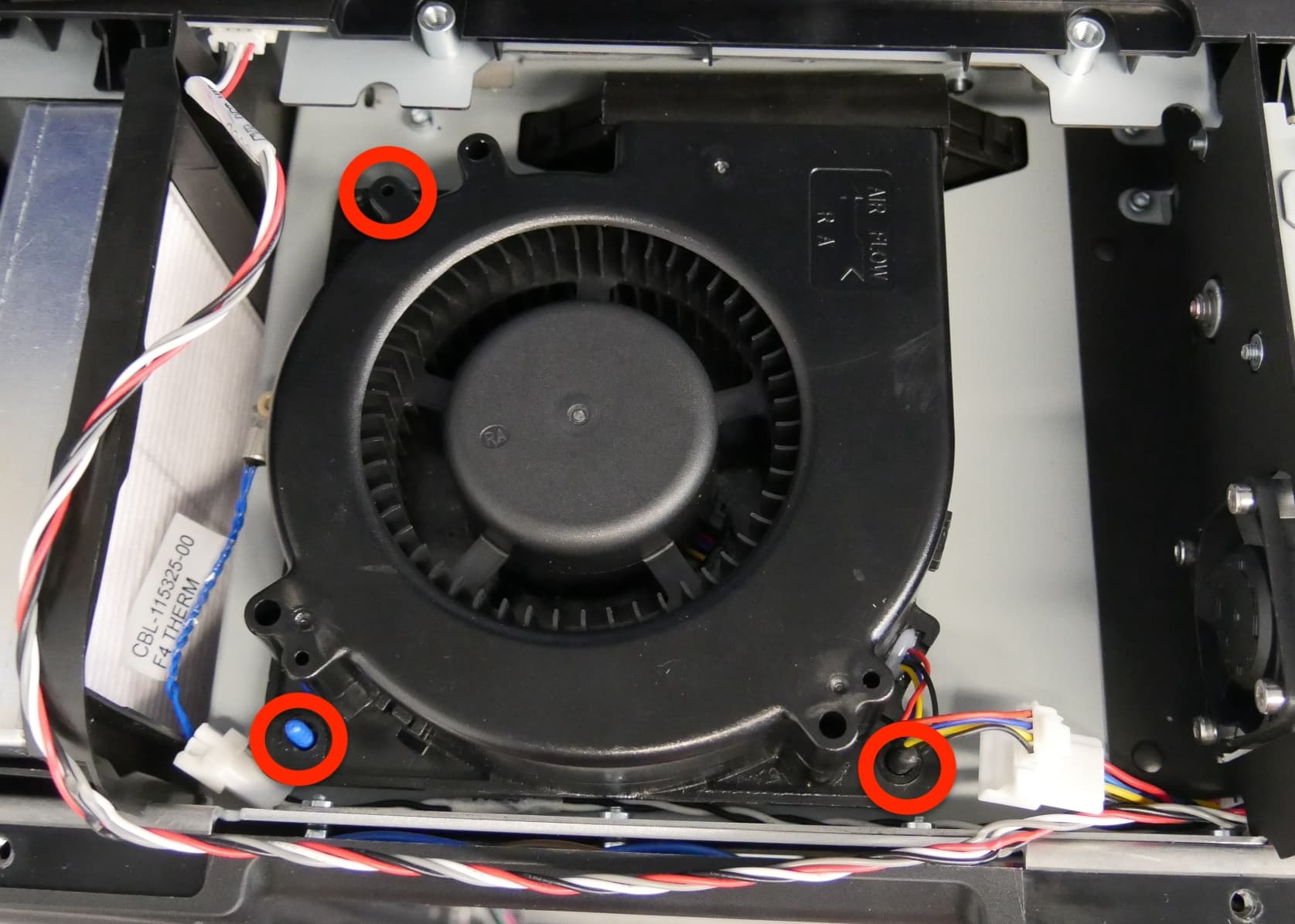

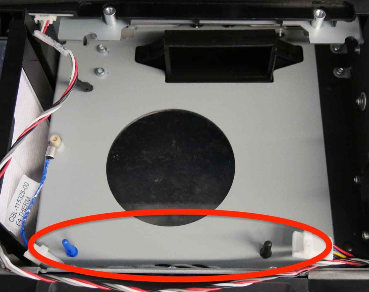

Step 2: Locate the fan mounting hardware

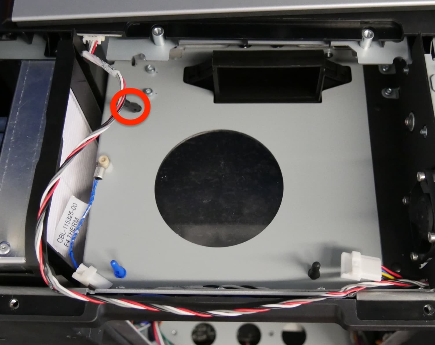

Form 4 LPU fan mounting hardware location annotated
The fan mounting hardware consists of three rubber pins that mount the LPU fan in the printer.

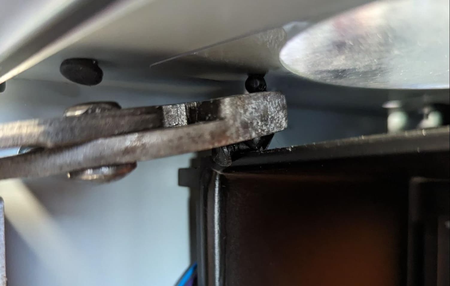

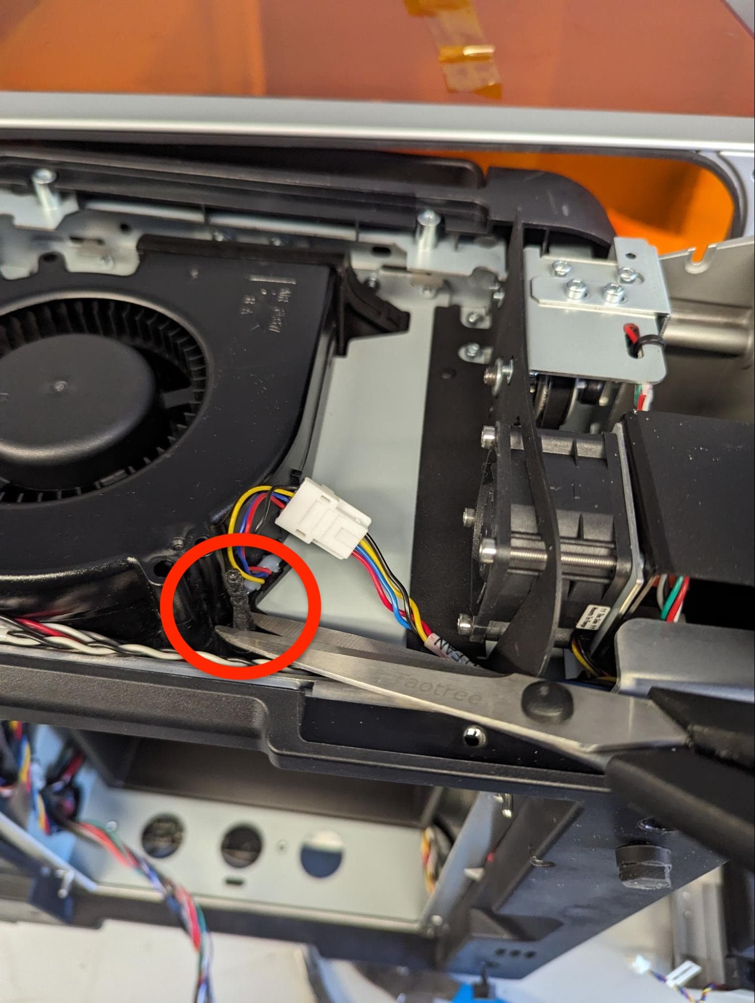

Cutting the Form 4 LPU fan rubber mounting pins annotated
Use flush cutters or scissors to cut the three rubber mounting pins.

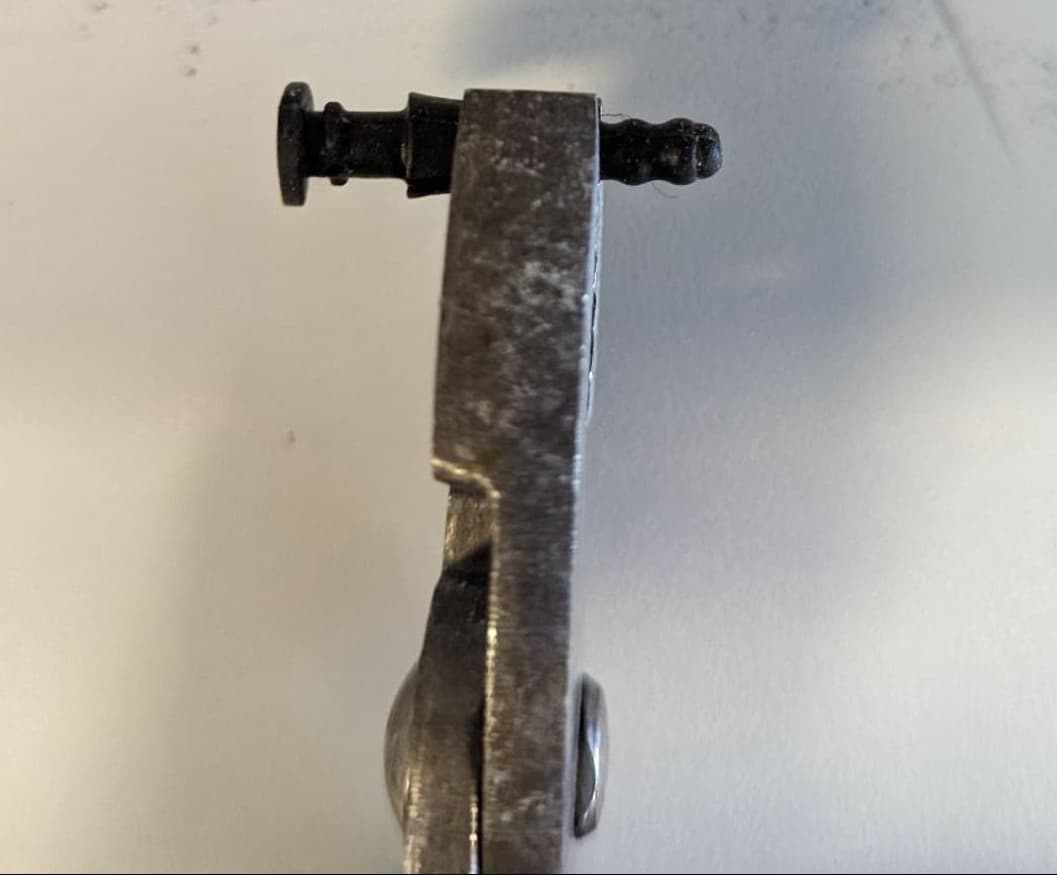

Step 6: Grip the upper mounting pin

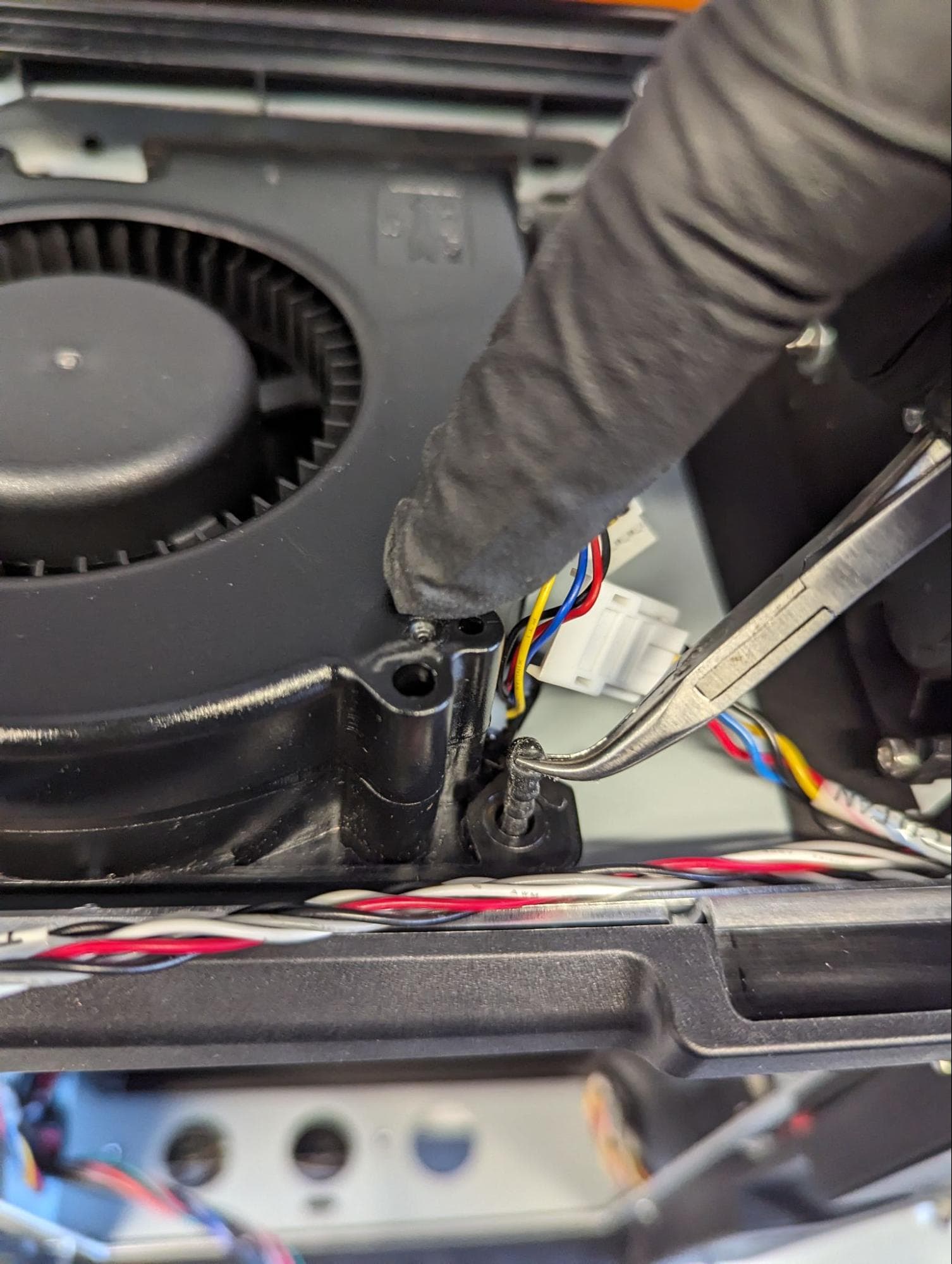

Gripping the upper LPU fan mounting pin with needle nose pliers
The upper fan mounting hardware is a single rubber pin. Grip the rubber pin with a pair of needle nose pliers, leaving 5–10 mm of the pin visible above the pliers.

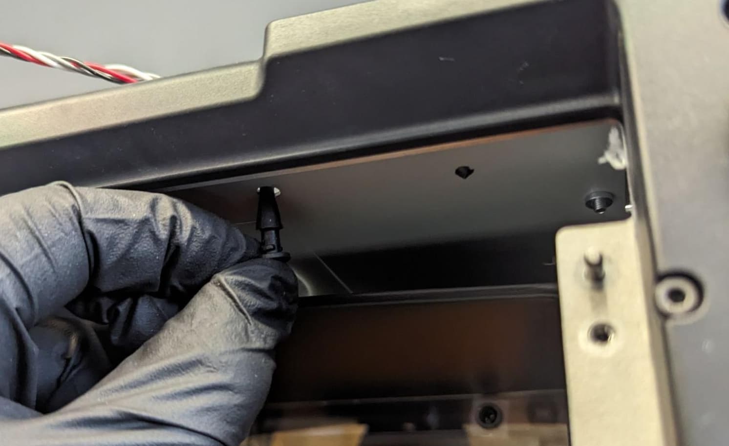

Step 7: Insert the mounting pin

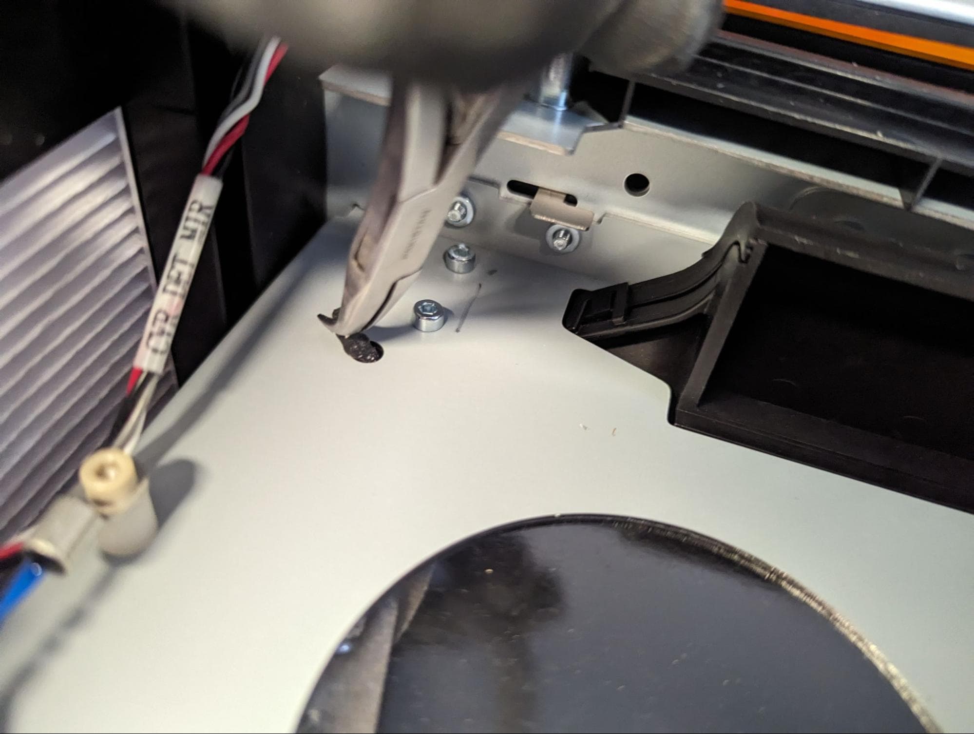

Inserting the upper LPU fan mounting pin with pliers
Upper LPU fan mounting pin inserted and annotated
Use the pliers to insert the rubber pin into the bottom of the printer between the black plastic optics shroud and the sheet metal until the rubber pin pops through the upper fan mounting hole. Take care not to touch or damage any optical components in the printer.
