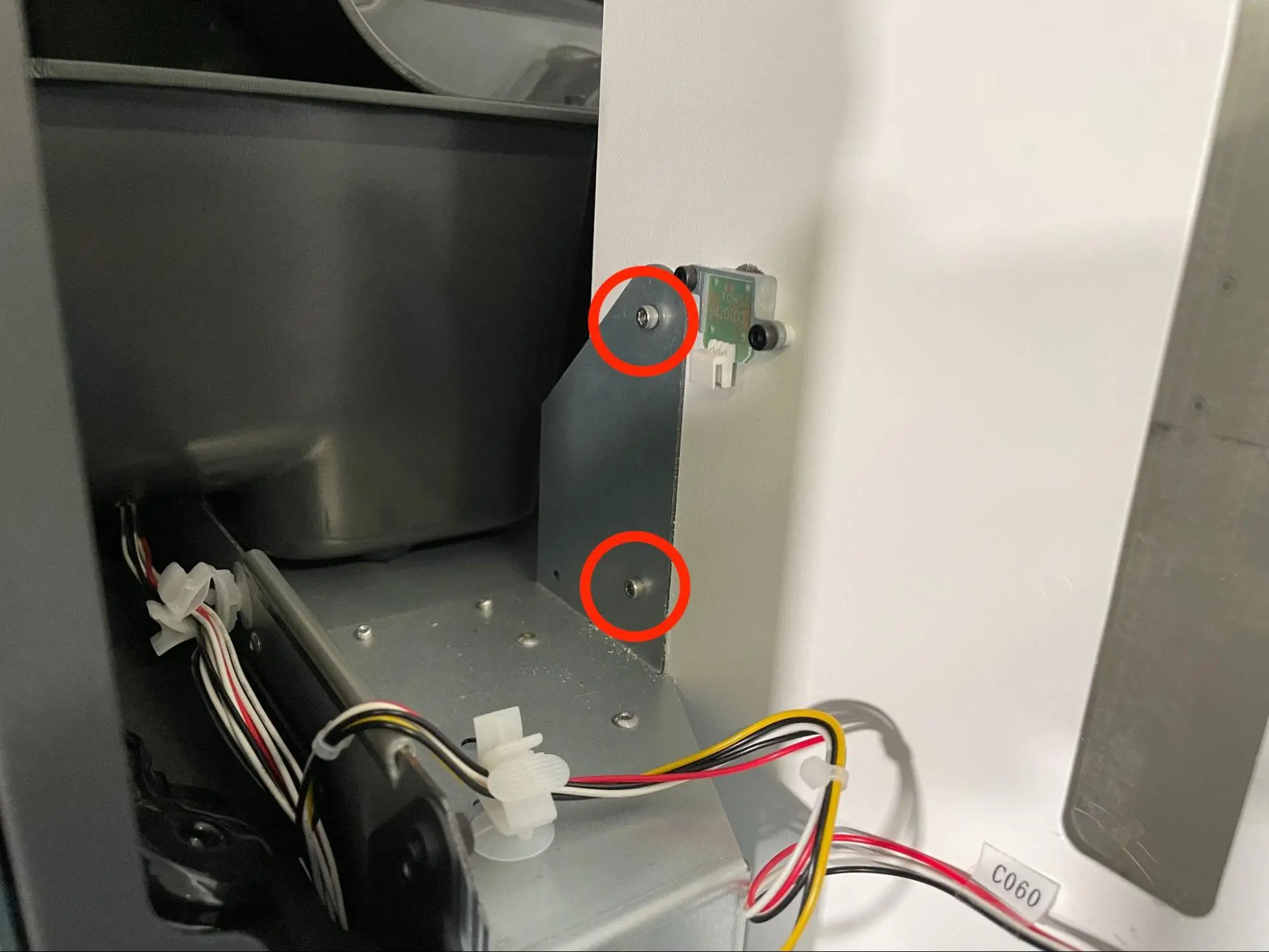

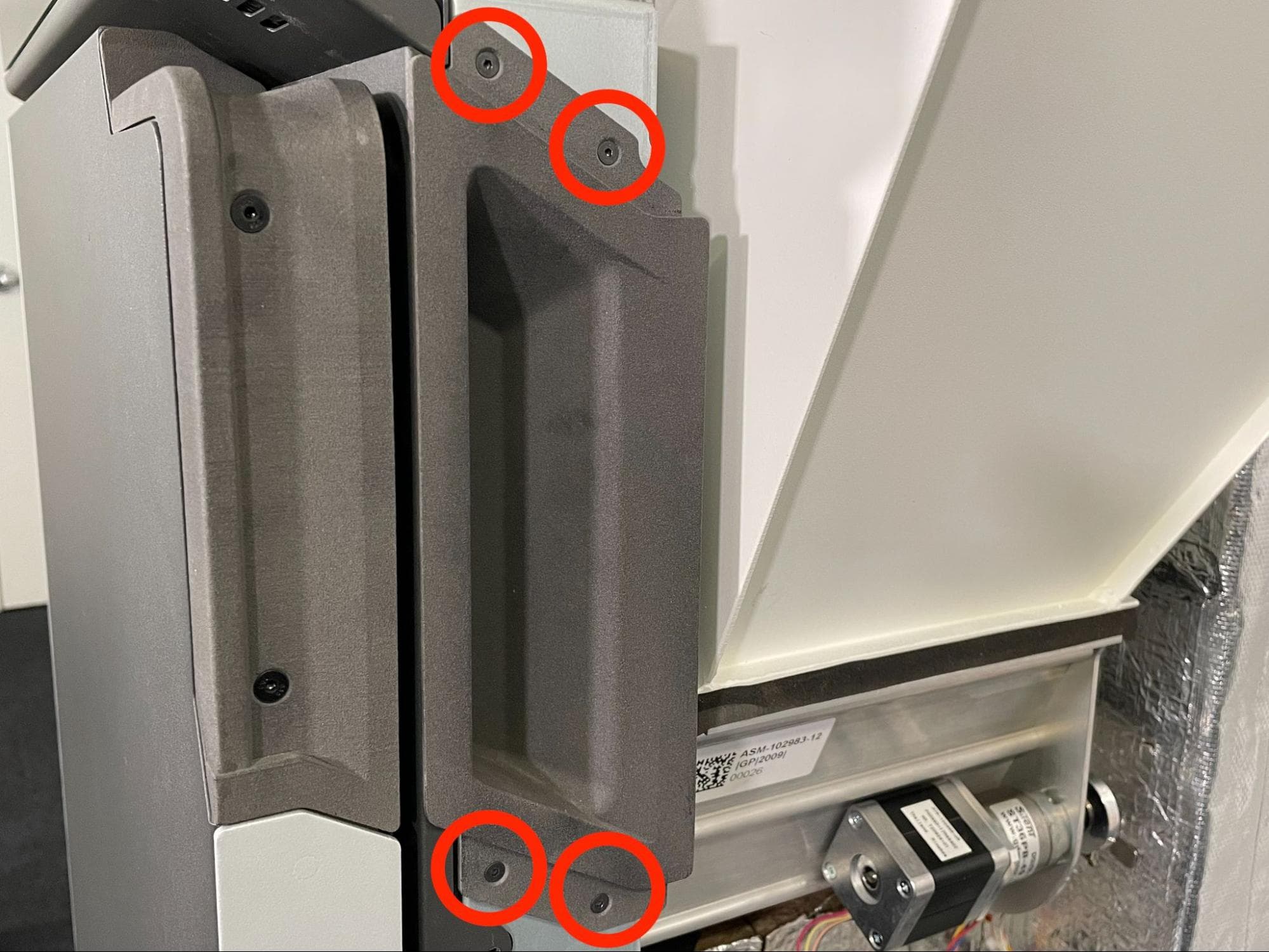

Step 1: Begin removing the hopper-side panel screws
Using a 2.5 mm hex driver, loosen and remove the two black (circled in red) and one chrome (circled in blue) 8.0 mm M4 button head screws from the back-left of the printer. Take note of the locations of these screws, as the placement of the chrome screws is critical to the printer's electrical grounding. Set the screws aside.

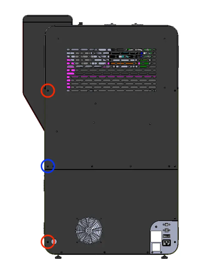

Step 2: Continue removing the hopper-side panel screws

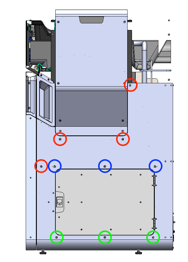

Move to the hopper side of the printer. Using a 2.5 mm hex driver, loosen and remove the 10 M4 countersunk screws holding the hopper-side panel to the printer. Remove the top-most 6.0 mm countersunk screws last to make removing the panel easier. Set the screws aside.
  • Three 16.0 mm screws, circled in green
  • Three 12.0 mm screws, circled in blue
  • Four 6.0 mm screws, circled in red

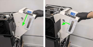

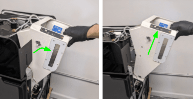

Step 3: Tilt the hopper-side panel
Allow the panel to tilt away from the printer, allowing access to the interlock switch cables. Do not remove the panel at this time.
Remove the top & hopper-side panels

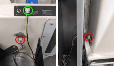

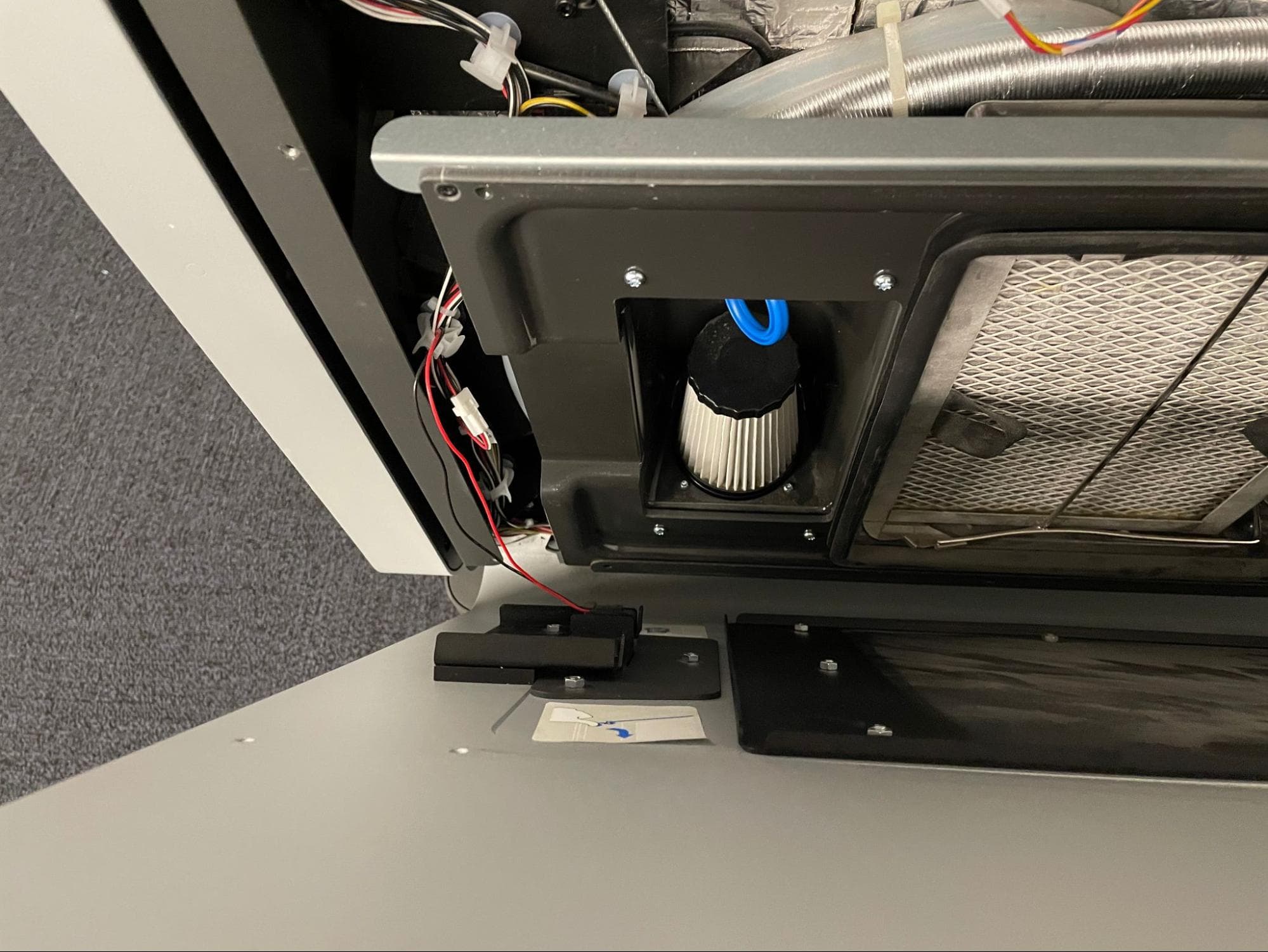

Step 4: Disconnect the interlock switch and remove the hopper-side panel

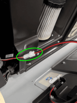

Locate the black and red cables leading to the interlock switch on the inner left-hand side of the panel. Disconnect the cable labeled C033.
Separate the hopper-side panel from the printer, taking care to ensure that none of the cables are caught or tangled. Set the panel down on a flat, clean surface.

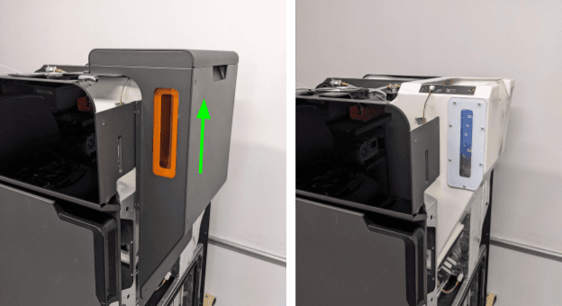

Step 6: Remove the hopper shell
Lift the hopper shell upwards then pull it away from the printer. Set the hopper shell and lid aside

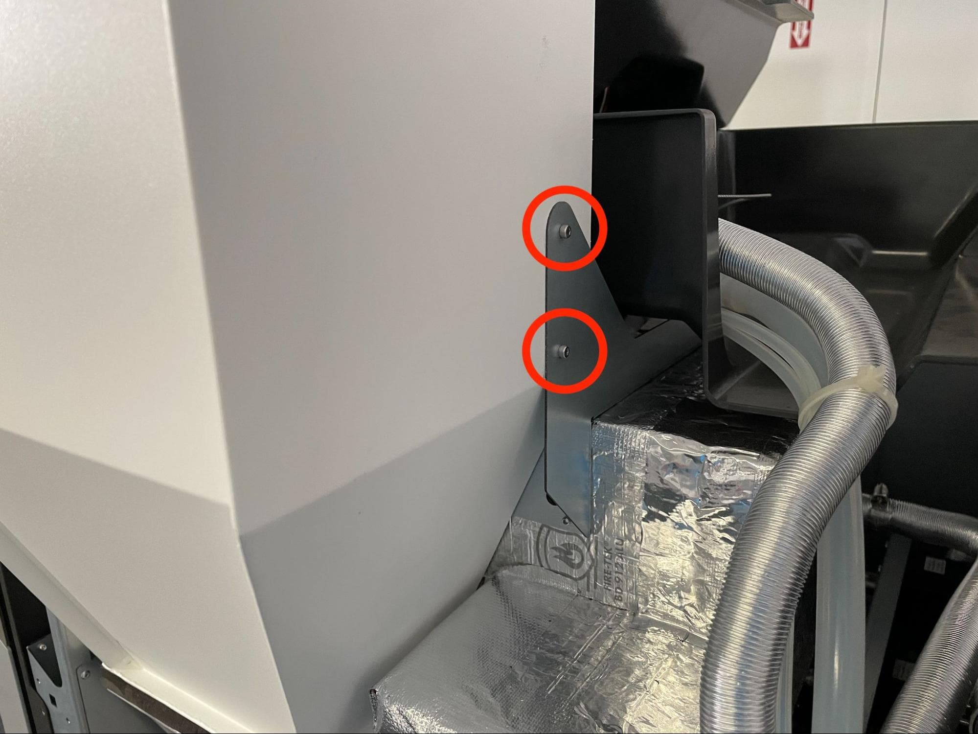

The hopper is secured to the printer using four 4 mm M3 chrome socket head screws: two on each side towards the bottom of the hopper. Using a 2.5 mm hex driver, loosen and remove the four screws. Set the screws aside.

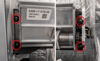

Step 2: Remove the doser assembly mounting screws
The doser assembly is secured to the printer frame by four 8 mm standoff nuts. There is a washer between each standoff nut and the doser assembly. Using an 8 mm nut driver, loosen and remove the standoff nuts. It may be helpful to use a telescoping magnet wand to catch and retrieve the washers; if they fall into the printer, they may be difficult or impossible to retrieve. Set the standoff nuts and washers aside.
If your nut driver cannot reach the nut on the top-right corner of the doser, try using an 8 mm box wrench instead.

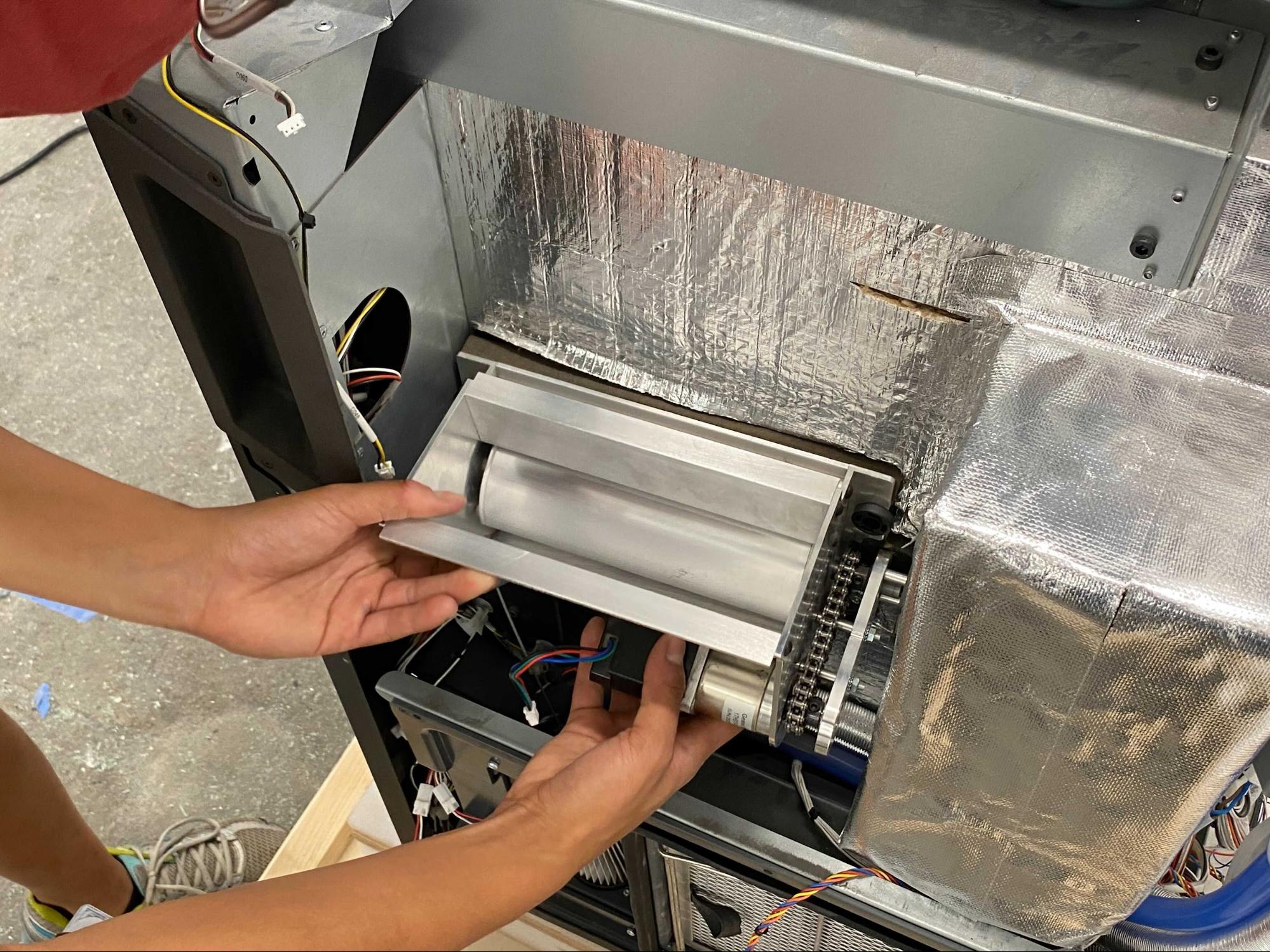

Step 3: Remove the doser assembly
Grab the doser assembly and pull it straight back from the printer. Set it aside for disposal.

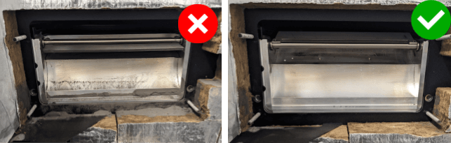

Step 4: Clean the doser interface
Vacuum any powder that remains in the interface between the doser and the printer.

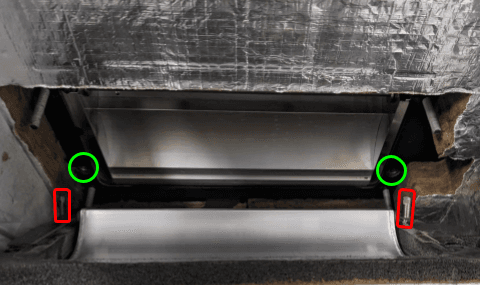

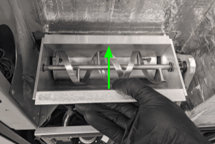

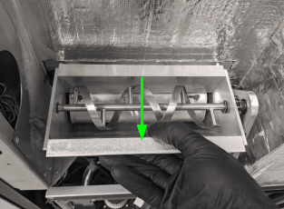

Align the two locating pins on the back of the doser assembly with the corresponding holes on the doser mounting surface. Slide the doser assembly into place until it sits flush against the printer frame.

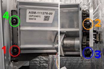

Thread the washers and standoff nuts into the four screw holes in the doser assembly. Using an 8 mm socket wrench or torque driver, torque each nut to 1.5 N-m in the sequence shown here.
Torquing the nuts out of order may lead to powder leaks. Over-torquing may strip the threaded stud, which is not repairable.

Thread one 4 mm M3 chrome socket head screw into each of the four screw holes in the hopper. Using a 2.5 mm hex driver, tighten the screws until snug.

Thread one M4 countersunk screw into each of the 10 screw holes in the hopper-side panel. Using a 2.5 mm hex driver, tighten until snug. For greatest convenience and ease of installation, thread and tighten in the following order:
  1. Four 6.0 mm screws below the hopper, circled in red
  2. Three 16.0 mm screws below the filter door, circled in green
  3. Three 12.0 mm screws above the filter door, circled in blue
