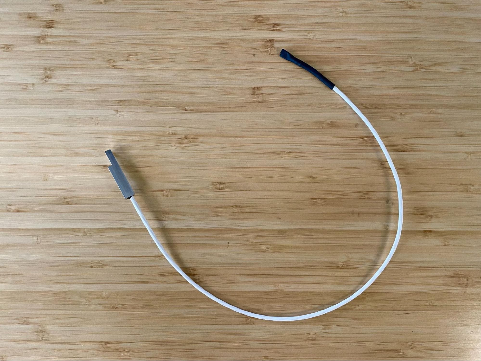

  • Fuse 1 generation RTD temperature sensor (RP-FS1-BRTD-02)

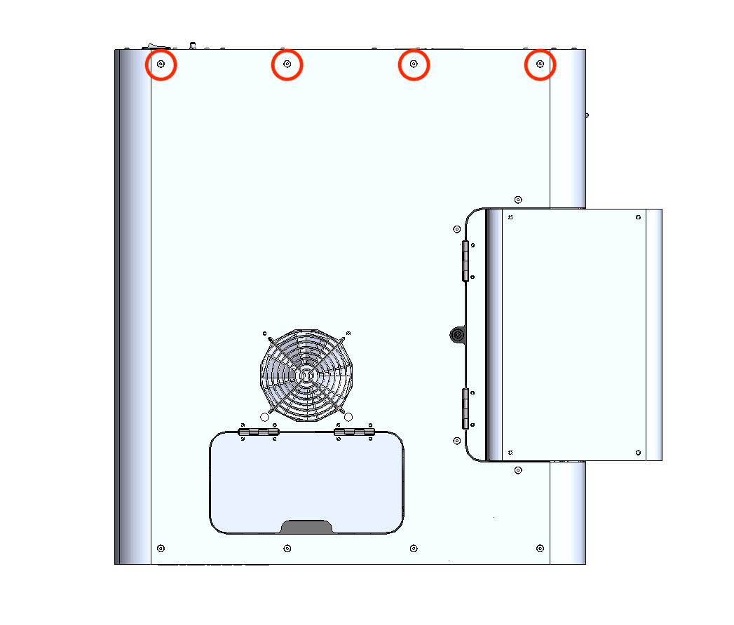

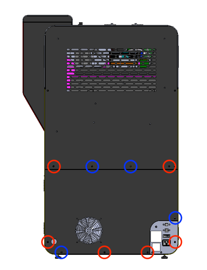

Step 1: Remove the lower rear panel screws
The six black lower rear panel screws are circled in red. The four chrome lower rear panel grounding screws are circled in blue.
Using a 2.5 mm hex driver, remove the six black panel screws and the four chrome panel grounding screws securing the lower rear panel to the printer. Set the screws aside, taking care to separate the black and chrome screws for later reinstallation.

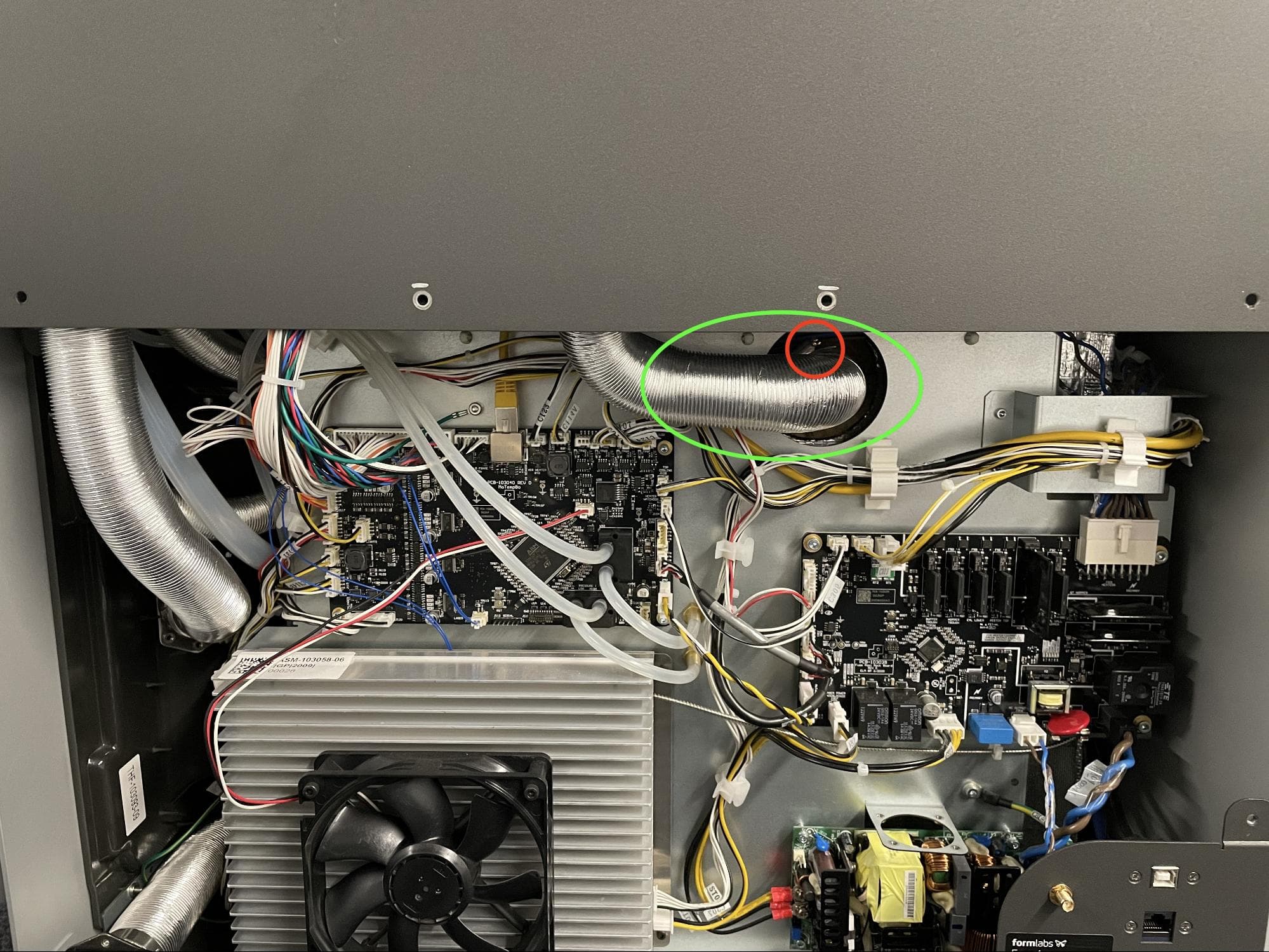

Step 3: Locate the exhaust duct and ring clamp
Locate the ring clamp attached to the exhaust duct in the center of the printer.
Step 4: Loosen the ring clamp screw
Using a 6.5 mm flathead screwdriver, loosen the ring clamp screw. Do not remove the screw. Pull the exhaust duct away from the exhaust pipe.

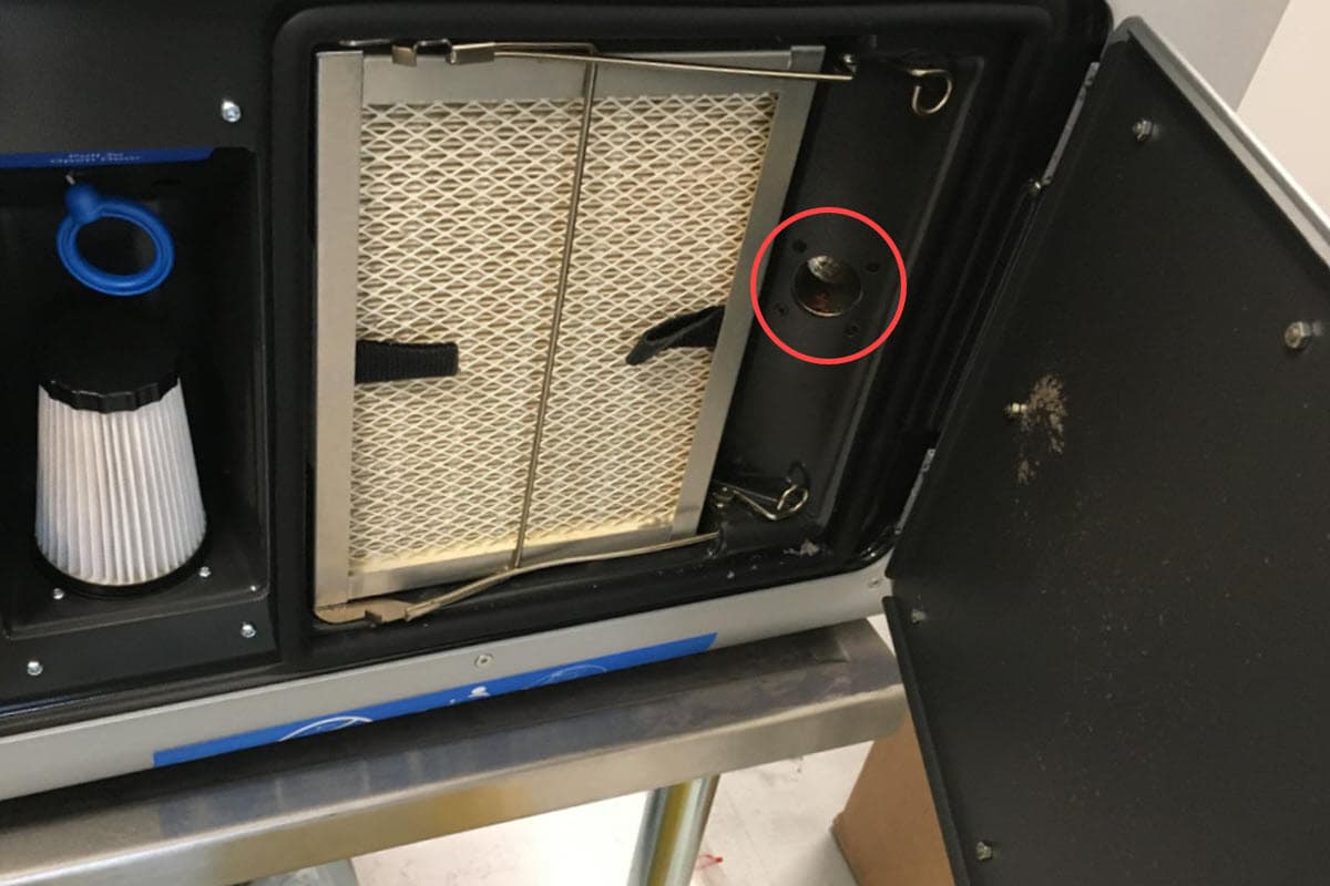

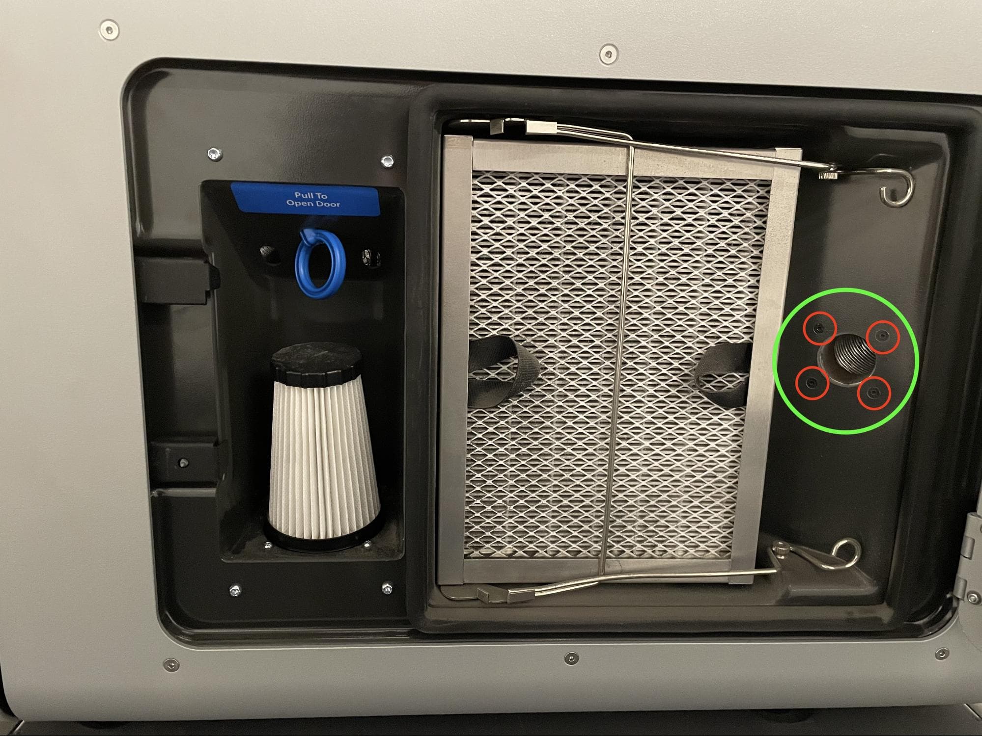

Step 5: Locate the exhaust inlet
Open the filter cabinet door on the printer. Locate the exhaust inlet on the right side of the cabinet.

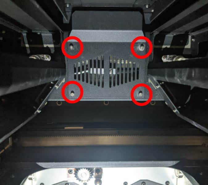

Step 6: Remove the exhaust inlet screws
Using a 2.0 mm hex driver, remove the four screws attaching the exhaust inlet to the filter cabinet. Set the screws aside.

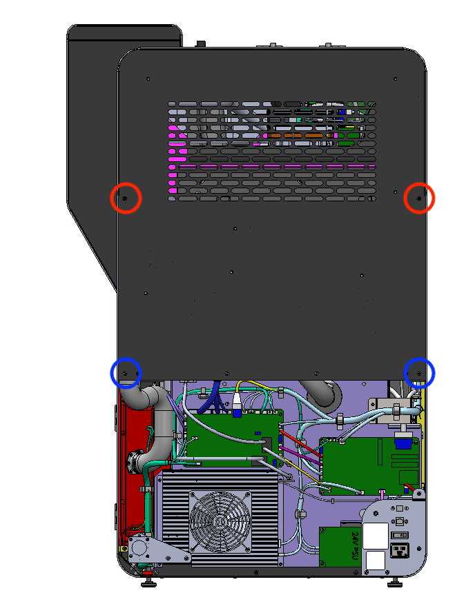

Step 7: Remove the upper rear panel screws
The two black upper rear panel screws are circled in red. The two chrome upper rear panel grounding screws are circled in blue.
Using a 2.5 mm hex driver, remove the two black panel screws and two chrome panel grounding screws securing the upper rear panel to the printer. Set the screws aside, taking care to separate the black and chrome screws for later reinstallation.

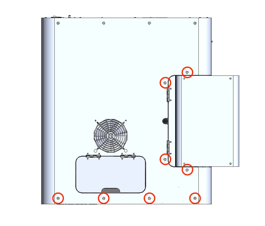

Step 8: Remove the upper rear panel screws
Using a 2.5 mm hex driver, remove the eight screws securing the upper rear panel to the printer:
  • Two 6 mm screws on the buffer side of the printer
  • Four 6 mm screws on the top of the printer
  • Two 6 mm screws on the hopper side of the printer

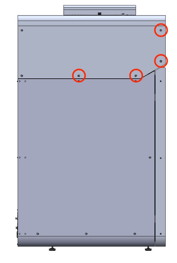

Step 1: Remove the buffer-side panel screws
Using a 2.5 mm hex driver, remove the four 6 mm M4 countersunk screws that secure the buffer-side panel to the printer.
Step 2: Remove the buffer-side panel
Separate the buffer-side panel from the printer and set it aside.

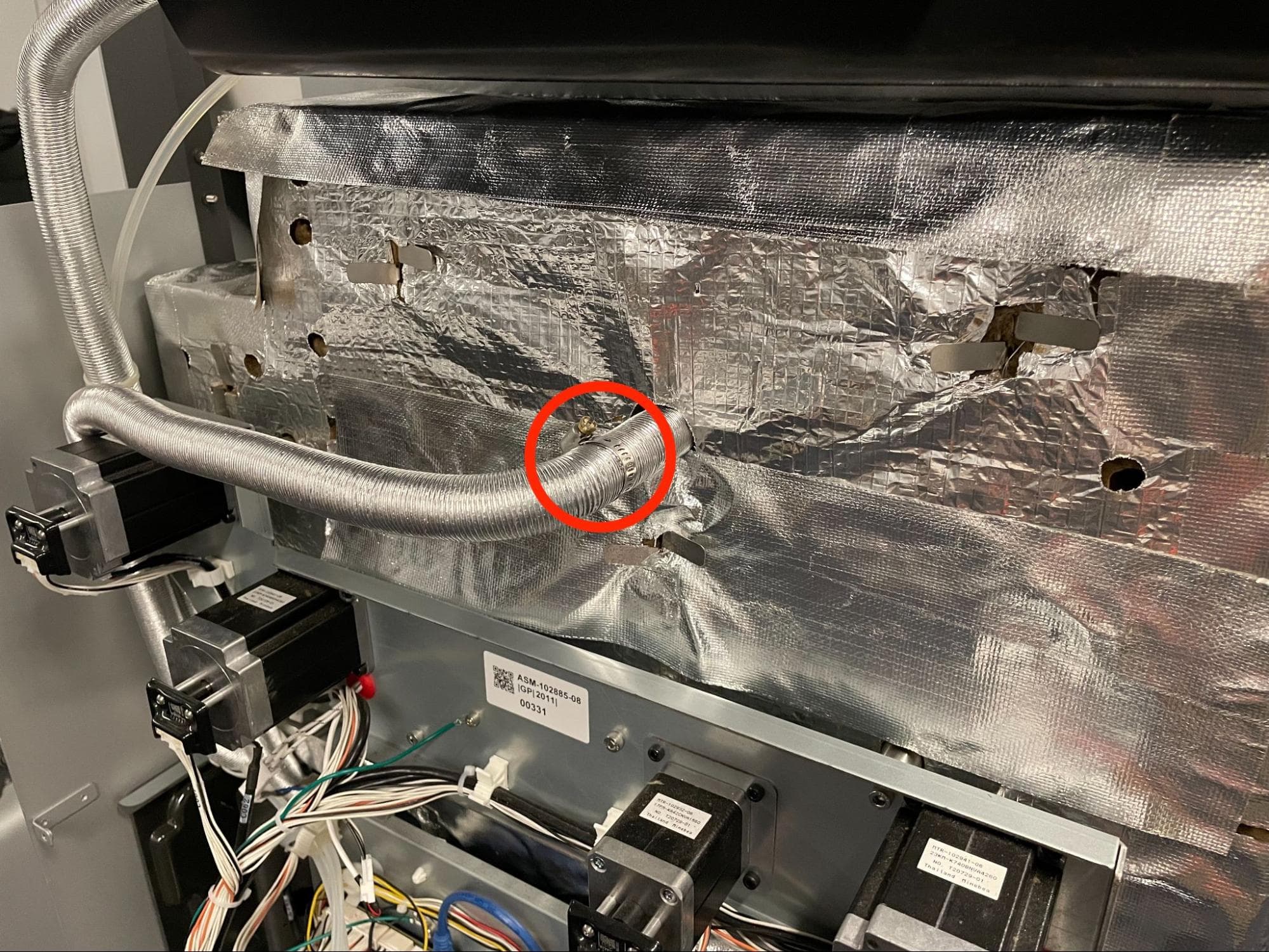

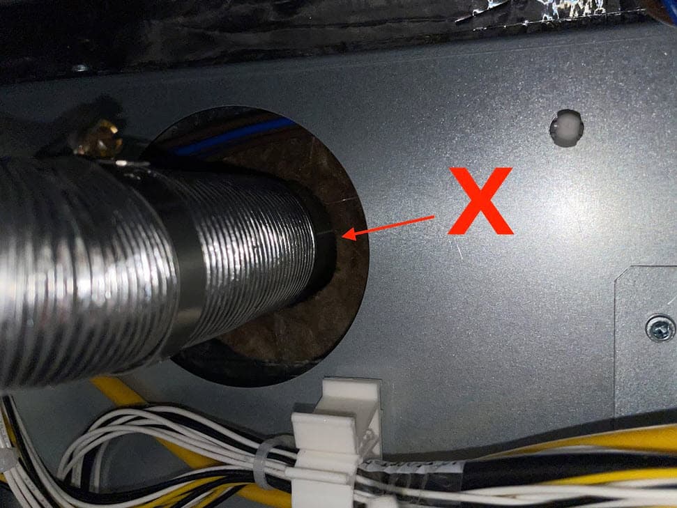

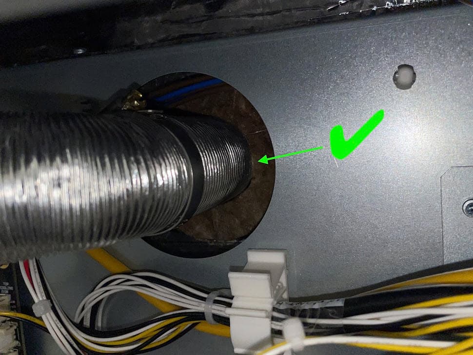

Step 1: Loosen the air duct ring clamp
If you have not already, put on a N95 or better respirator, a pair of safety glasses and a pair of nonreactive nitrile gloves. Use a 6.5 mm slotted screwdriver to loosen, but do not remove, the ring clamp screw securing the duct to the air heater inlet.
Step 2: Separate the air duct from the air heater inlet
Slide the duct off of the inlet. Gently move it away from the rear insulation panel.

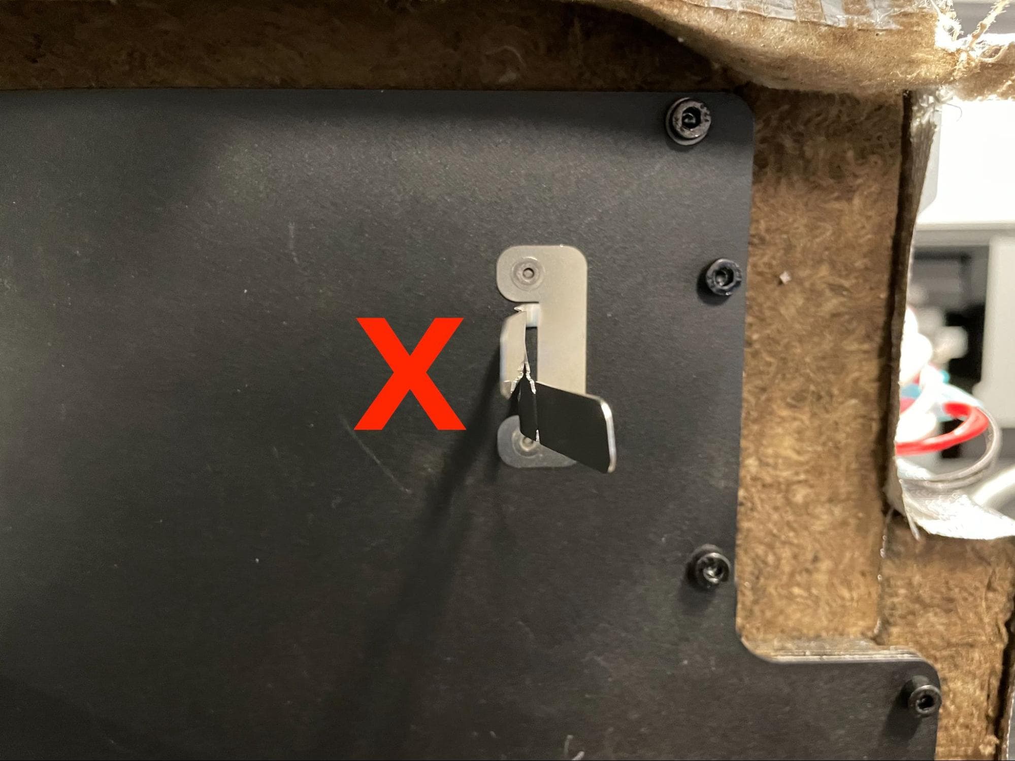

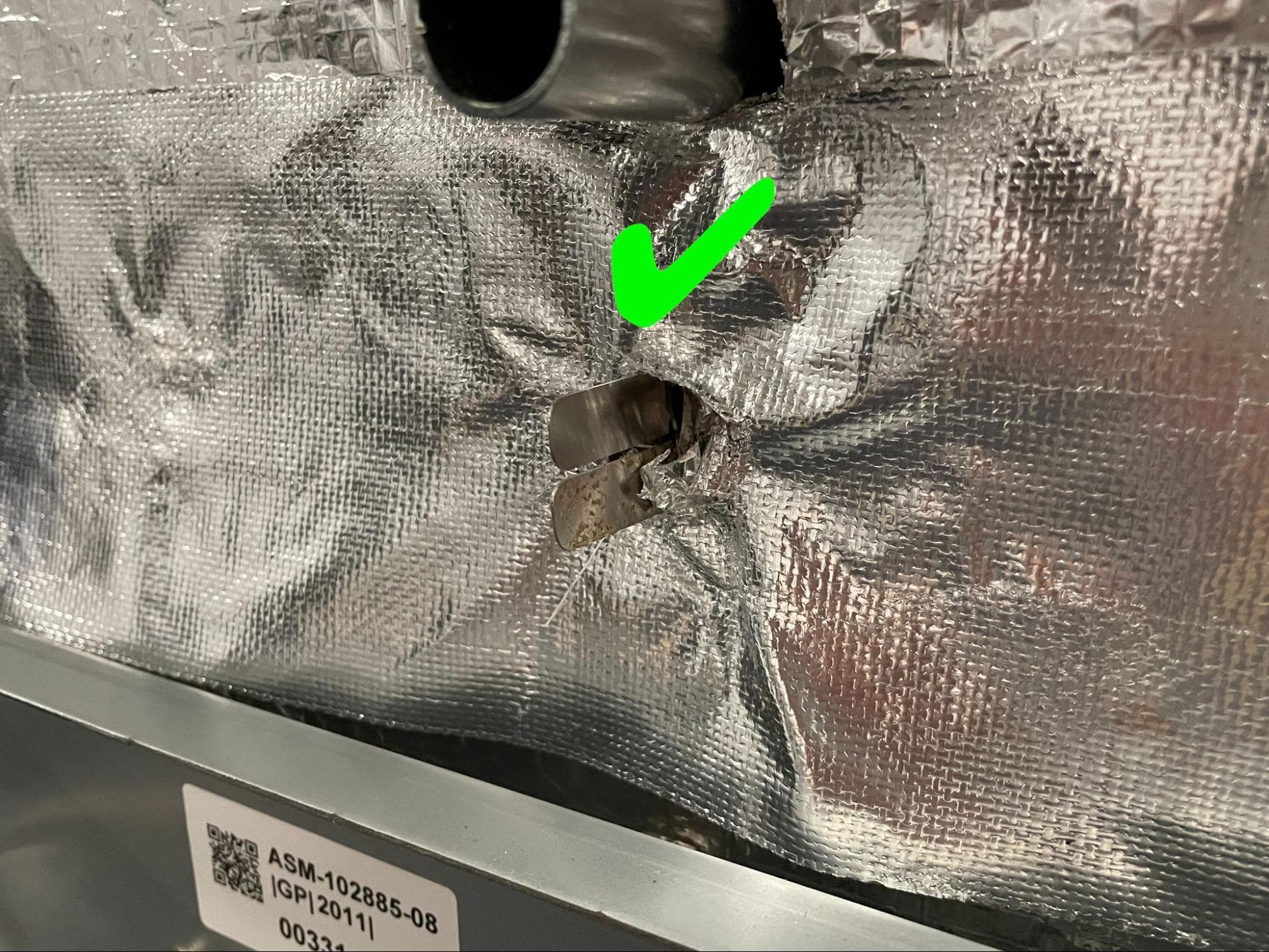

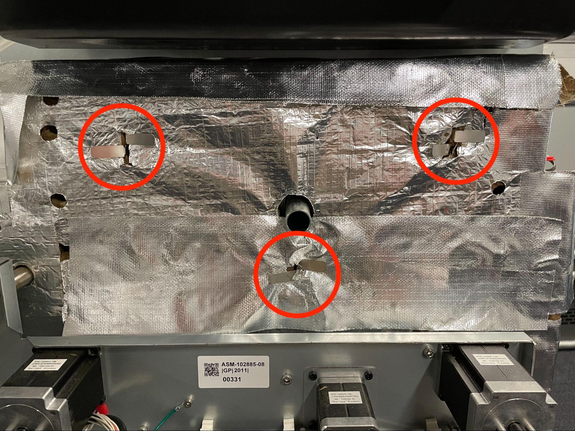

Step 3: Open the insulation retention tabs
Straighten the three metal retention tabs securing the rear upper insulation panel.
Remove the insulation and inner rear panels
Notice:
Ensure that both halves of each tab are parallel to each other. If they are not, they will shred the insulation as the panel is removed.

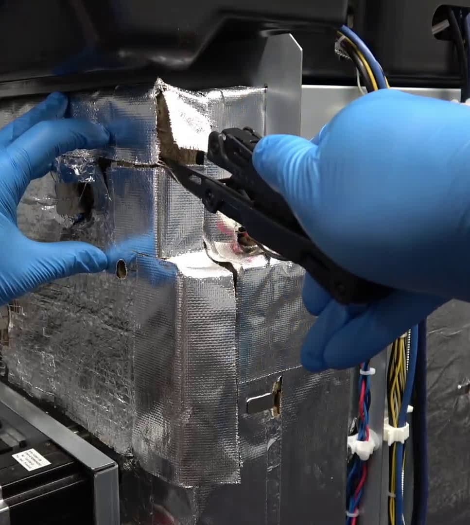

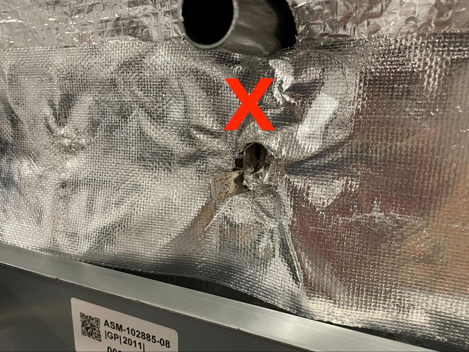

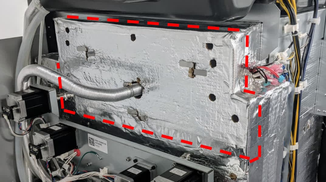

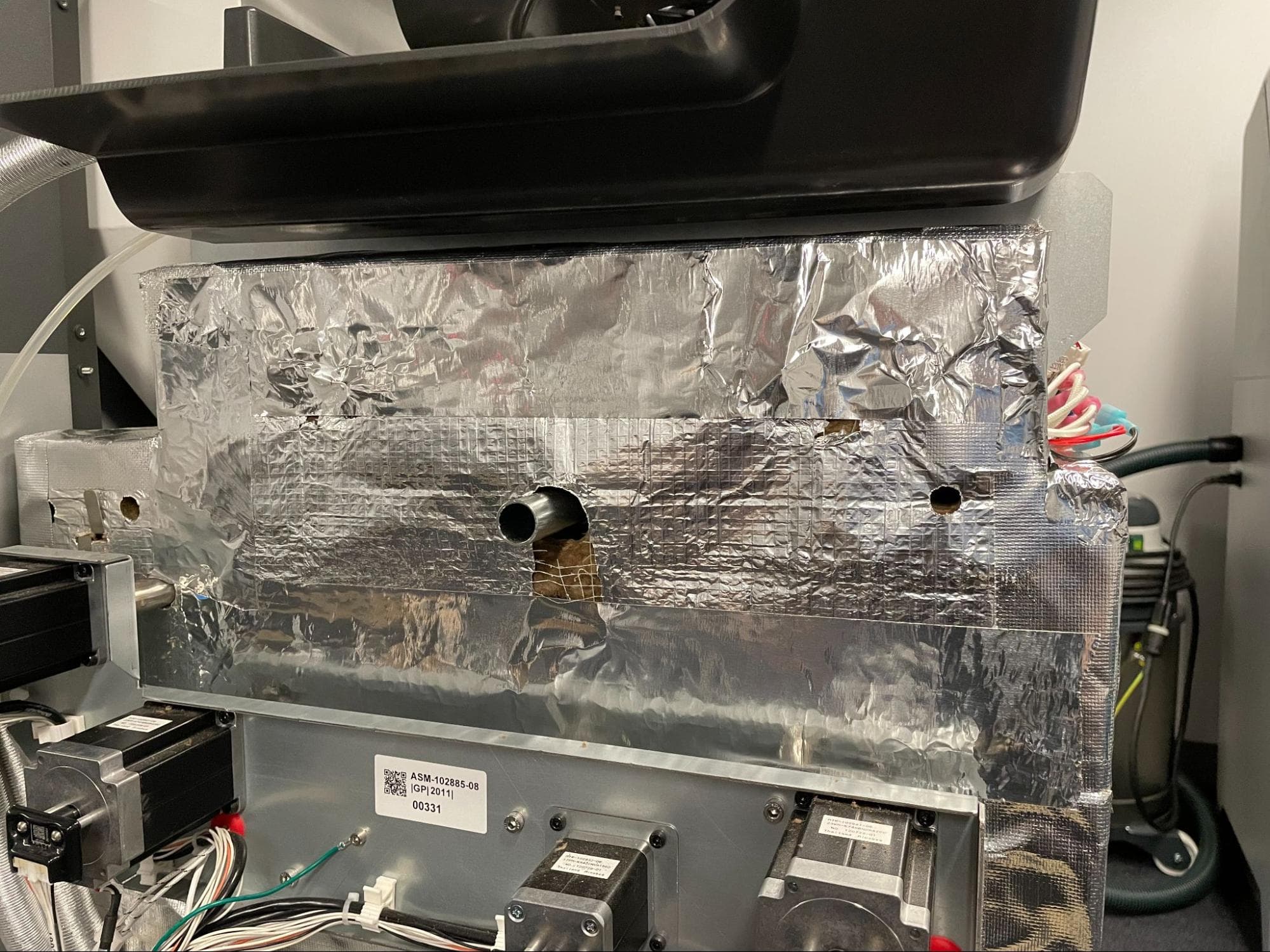

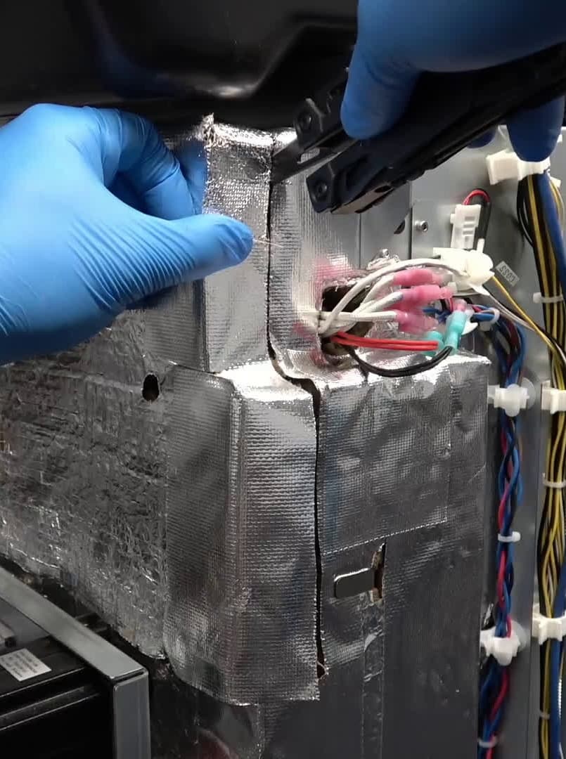

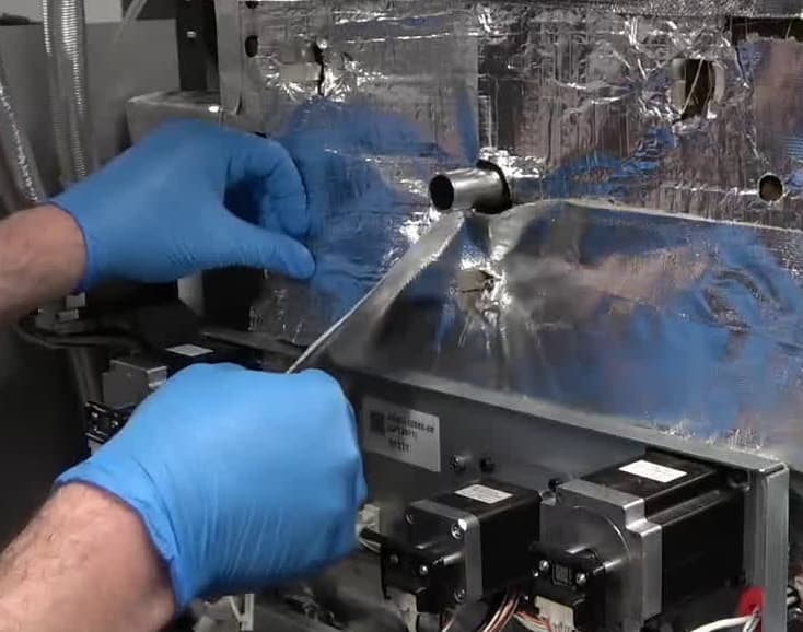

Step 4: Cut the insulation foil tape
Feel along the insulation for the seams identified in the above image. Use a utility knife to cut along these seams and release the insulation panel.
Note:
You only need to cut through the foil tape securing the insulation panel in place; the insulation itself is already cut to size.
Alternatively, locate an edge of the existing foil tape and begin peeling it away from the insulation panel. It will still be necessary to cut the top corner pieces of foil tape in order to separate the panel from the printer.

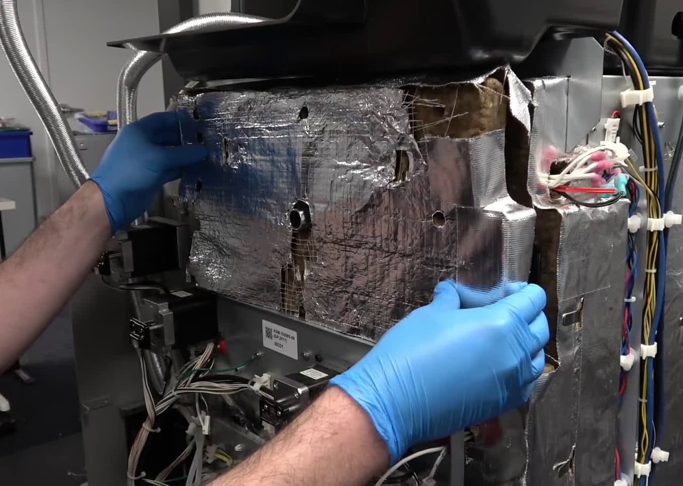

Step 5: Remove the insulation panel
Carefully pull the insulation panel away from the printer.

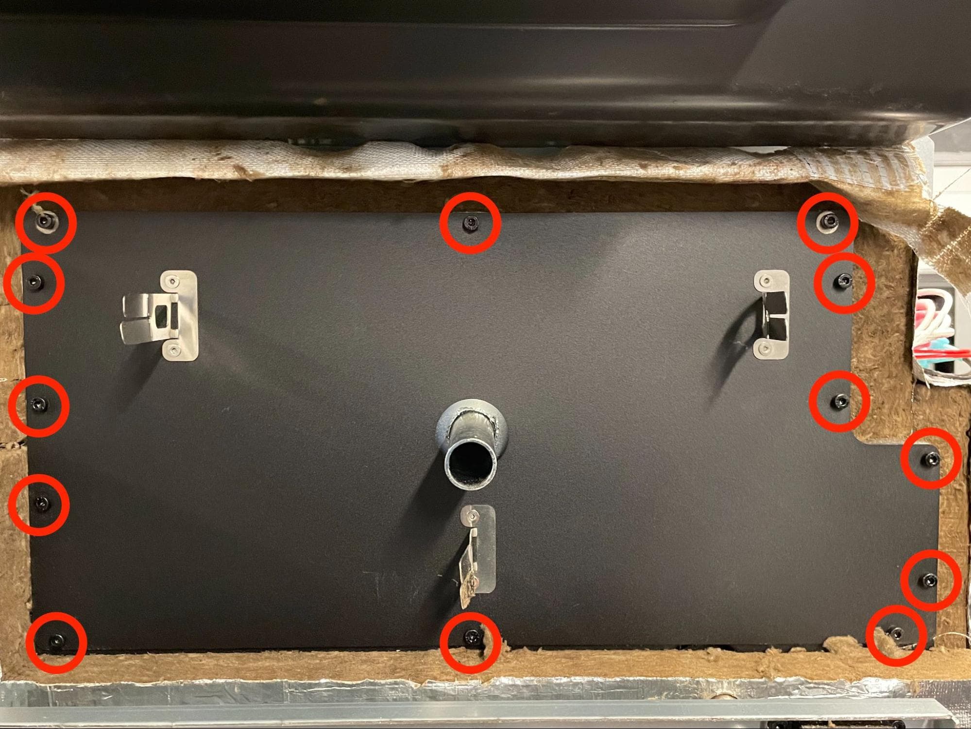

Step 6: Remove the inner rear panel screws
Use a 3 mm hex driver to remove the 13 8.0 mm M4 socket head screws that secure the inner rear panel to the printer.

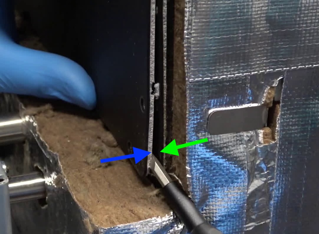

Step 7: Separate the inner rear panel from the printer

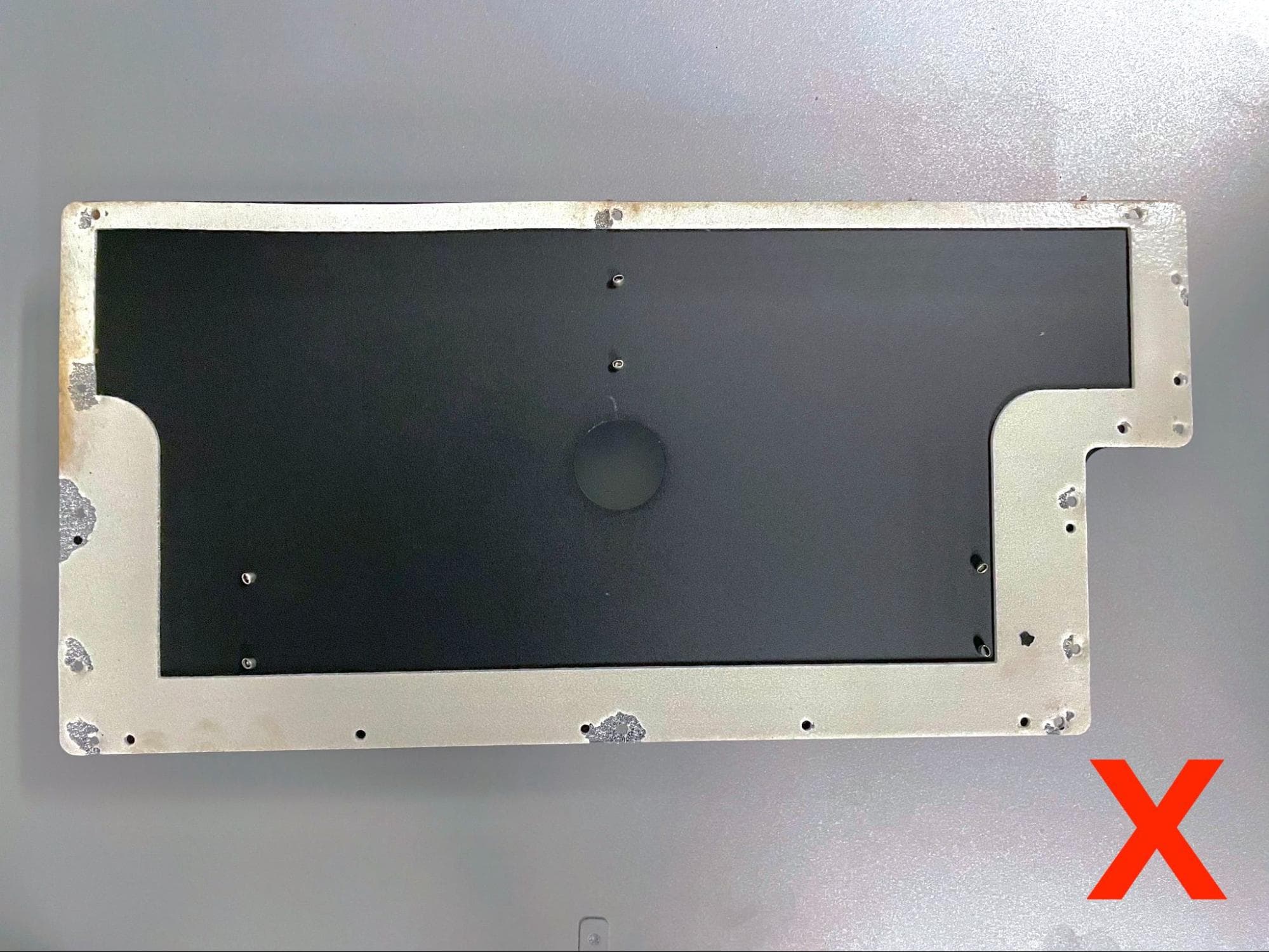

Use a 6.5 mm slotted screwdriver to separate a corner of the inner rear panel from the inner back plate. Ensure that the driver is inserted between the gasket and second black steel plate.
Notice:
Avoid gouging the gasket as much as possible. If it is damaged, it will need to be replaced.

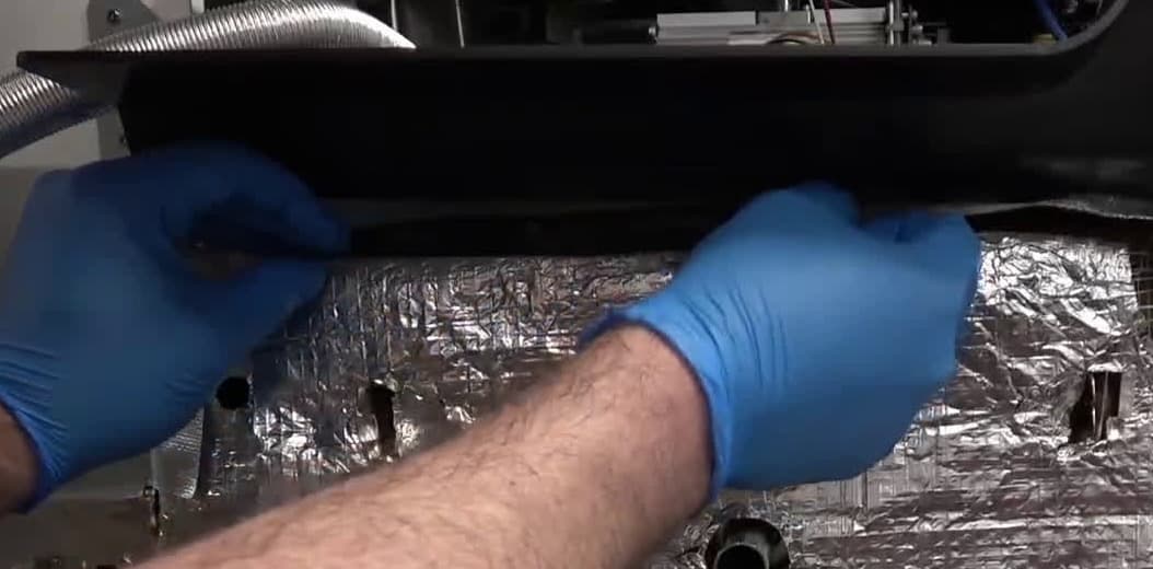

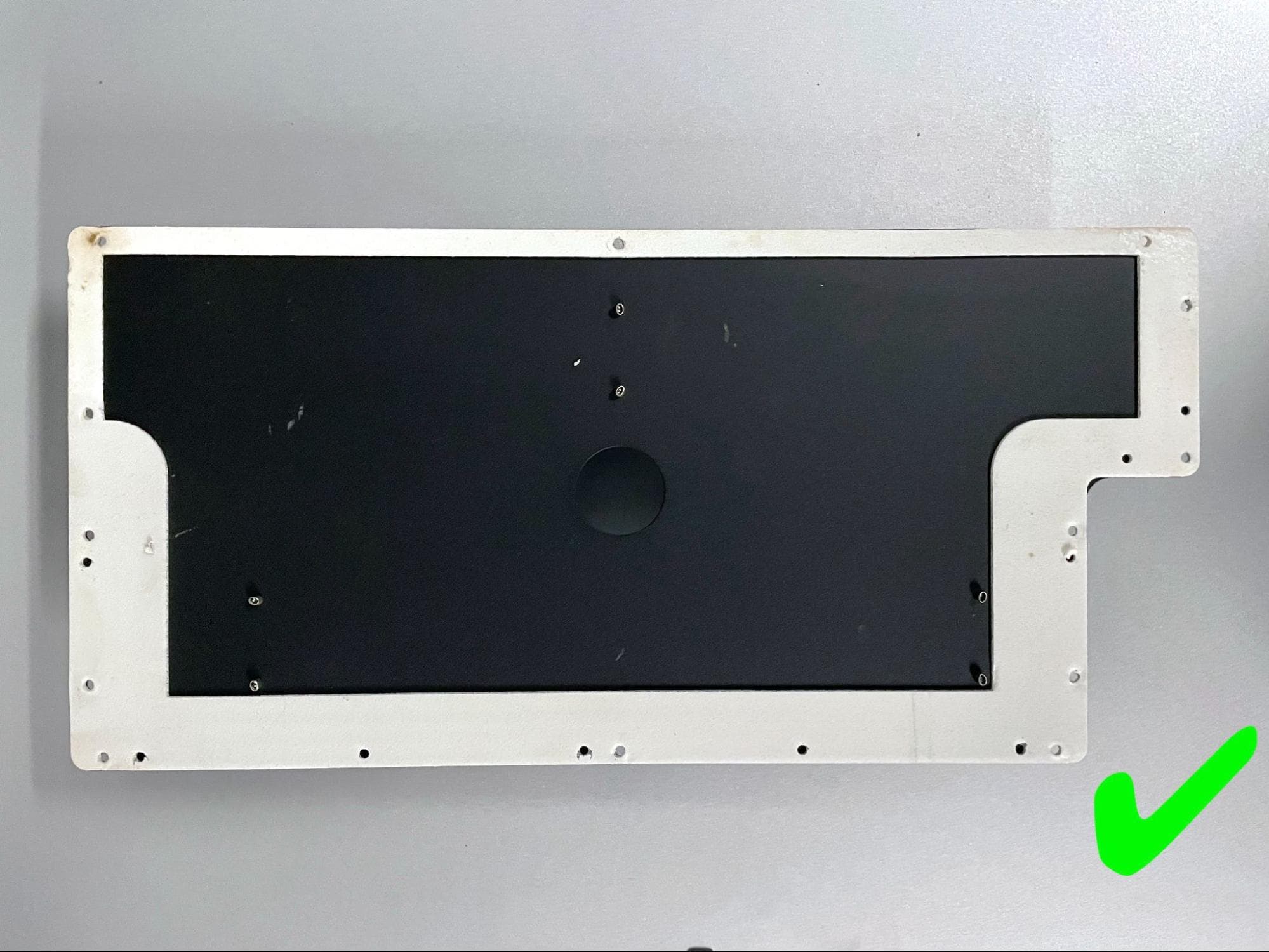

Step 8: Remove the inner rear panel
Continue separating the inner rear panel from the inner back plate without using the slotted screwdriver. Set the inner rear panel aside on a flat, clean surface with the gasket facing up.
Notice:
Ensure that debris from the insulation panels does not become embedded into the gasket, as this can prevent it from sealing properly when replaced replaced. Depending on when the printer was built, the gasket may be made of a white or black foam material.

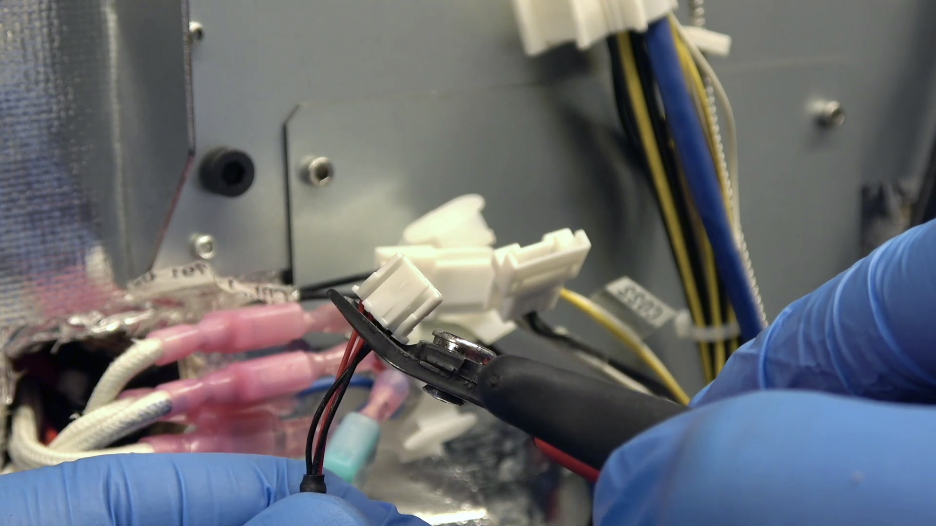

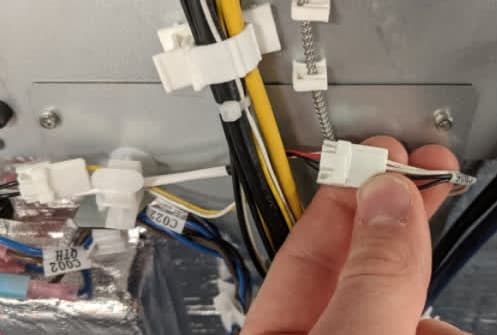

Step 1: Unplug the air heater RTD

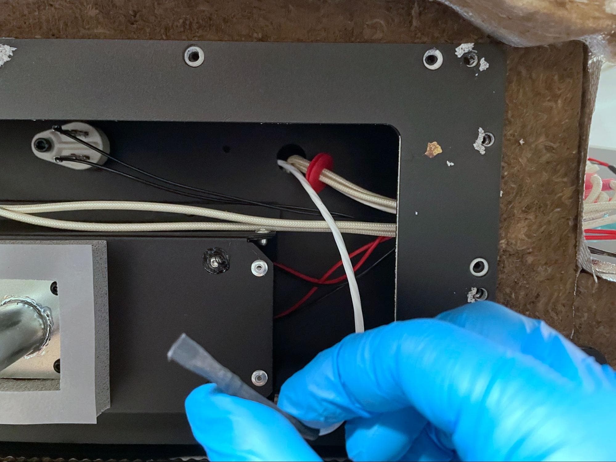

Locate the connector on the buffer side of the printer labeled C026. Disconnect the connector, then separate the cable from the cable clamp.
Step 2: Remove the air heater RTD connector
Use a pair of flush cutters to cut the connector off of the original RTD cable.
Remove the original RTD
NOTICE:
Make sure to cut the connector off of the RTD cable and not the extension cable that it attaches to.

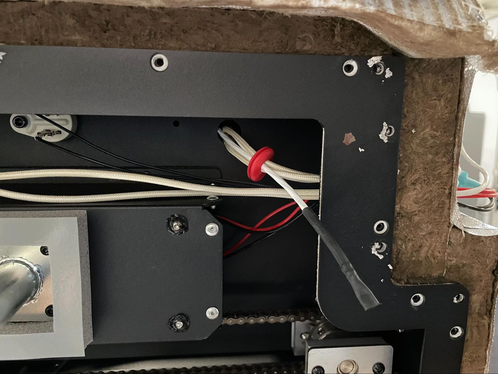

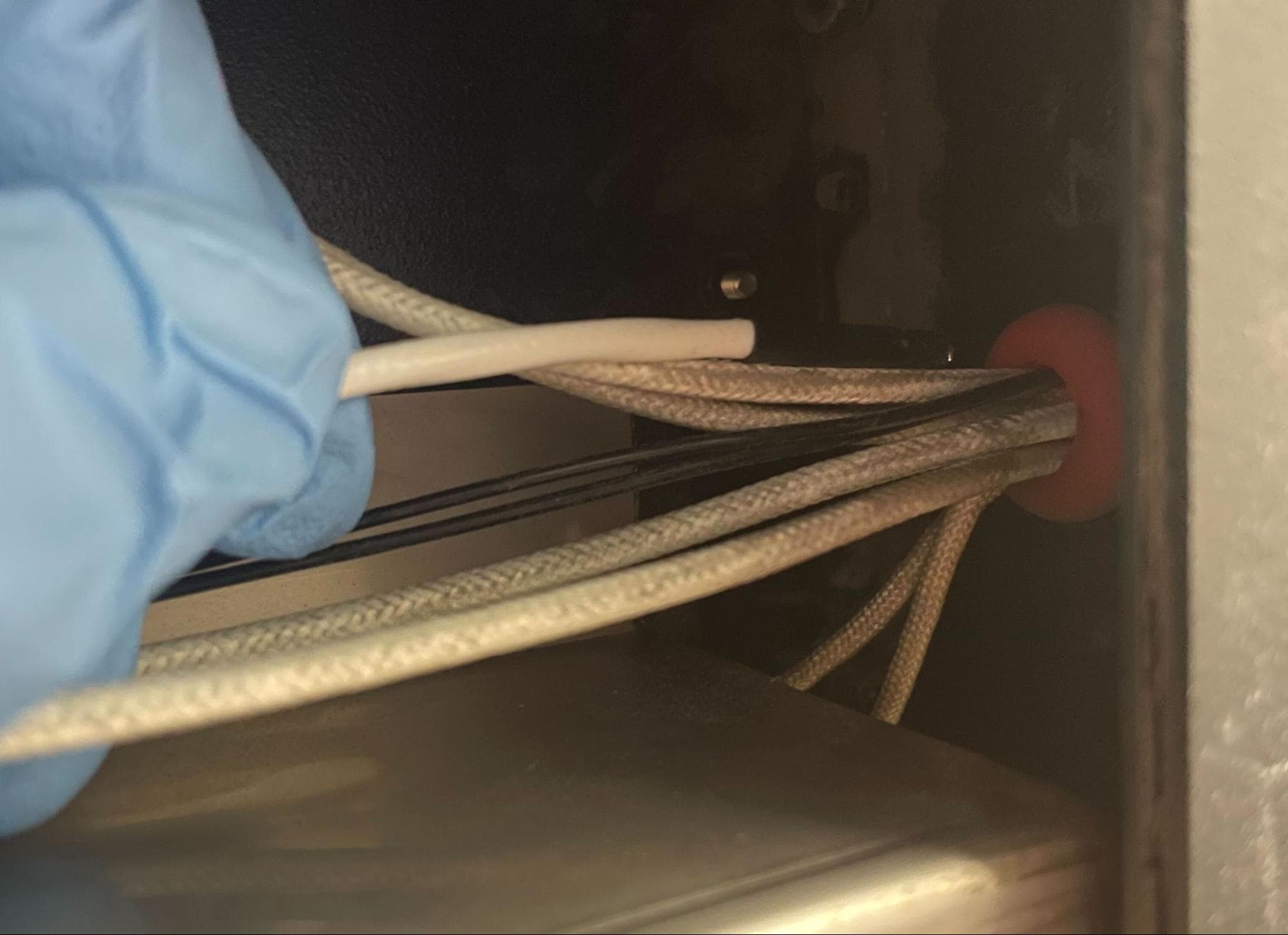

Step 3: Route the air heater RTD cable
Pull the severed end of the RTD cable through the first silicone grommet into the inner-rear cavity of the printer.

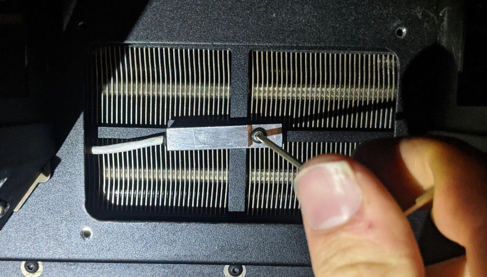

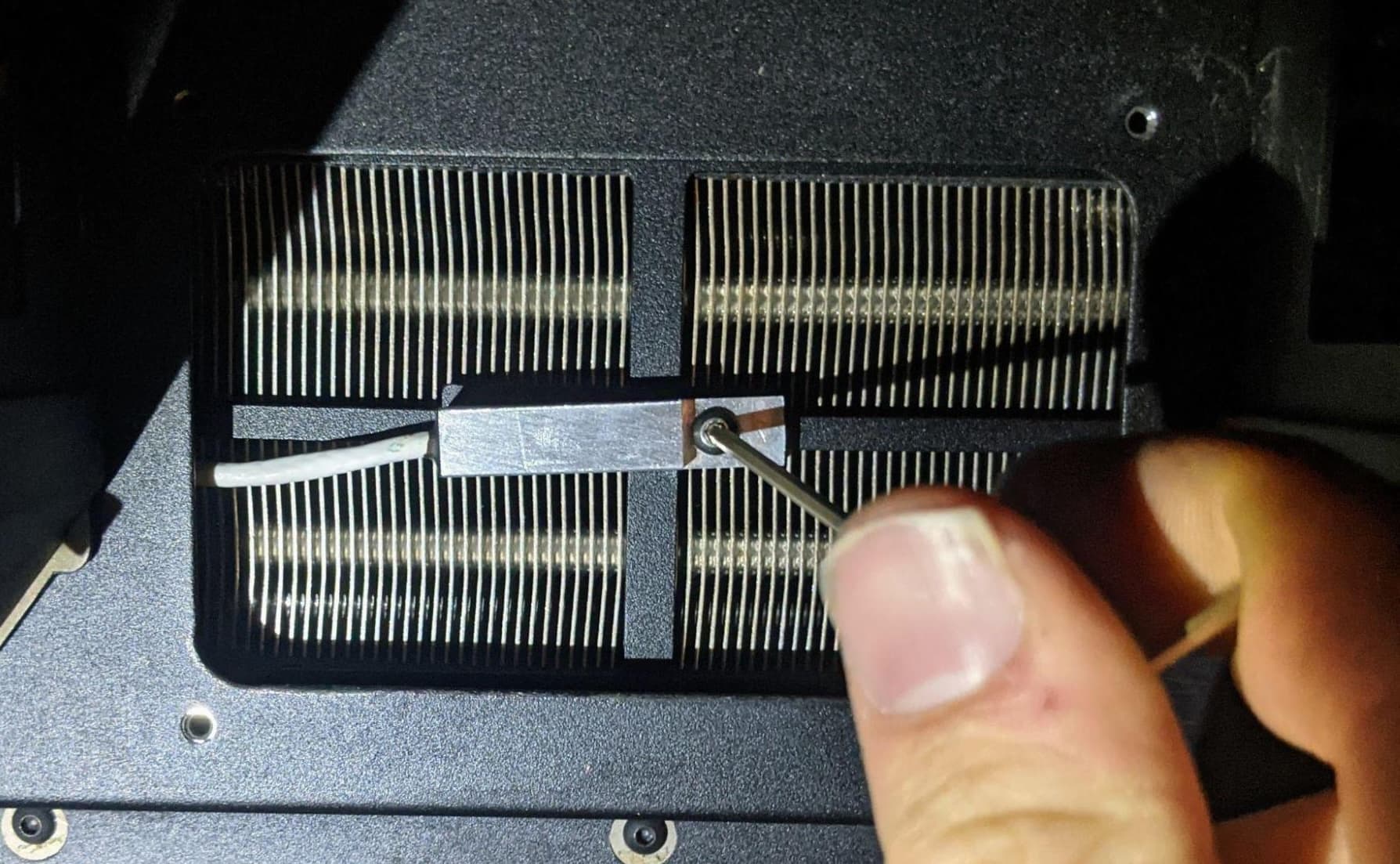

Step 6: Unmount the air heater RTD
Using a 2 mm hex driver, loosen and remove the 8 mm M3 button screw securing the RTD to the air heater assembly. Set the screw aside.

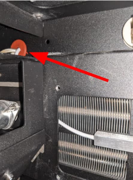

Step 7: Remove the air heater RTD

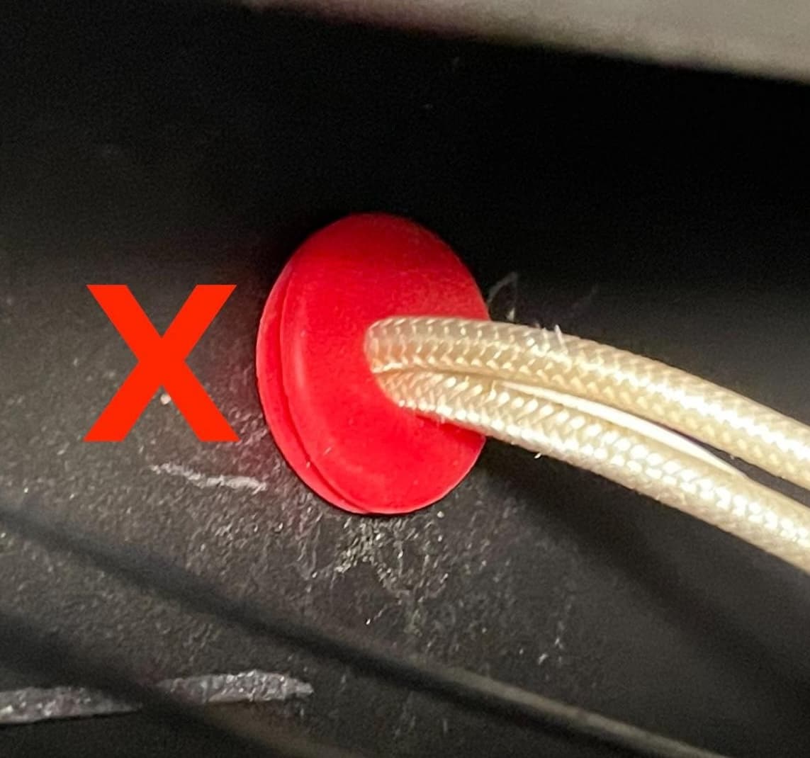

Locate the red silicone grommet in the top buffer-side corner of the print enclosure. Pull the RTD cable through the grommet and then remove the old RTD from the printer. Dispose of the RTD.
Step 8: Remove the air heater RTD cable routing grommet
From inside the print enclosure, push the red silicone grommet out of its frame.

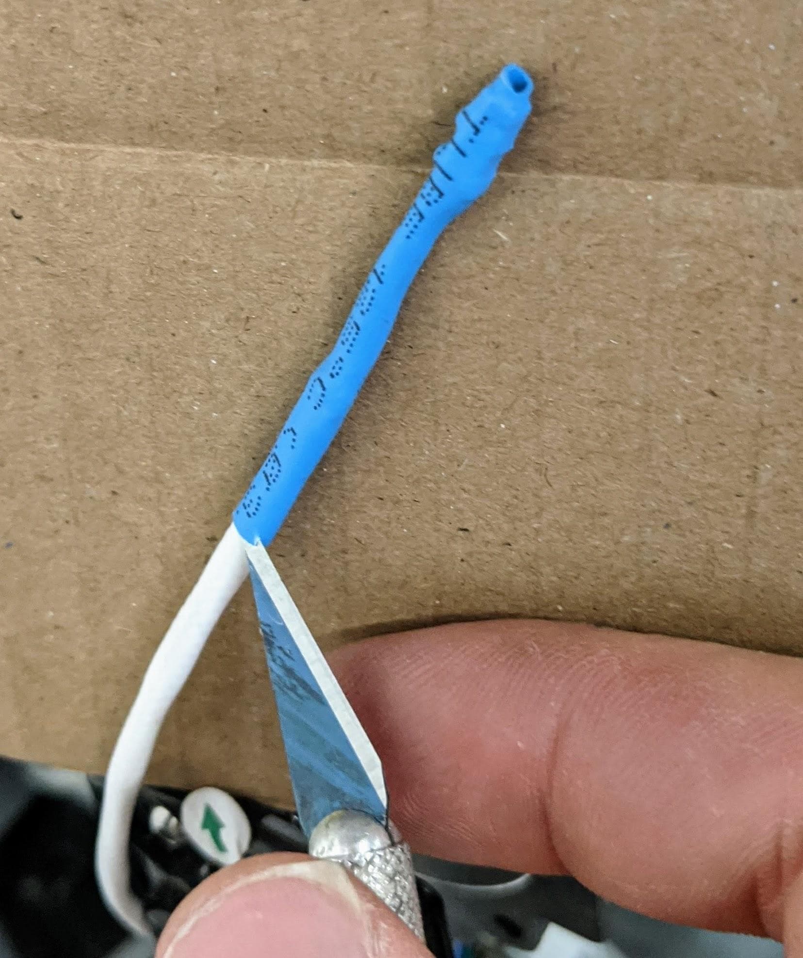

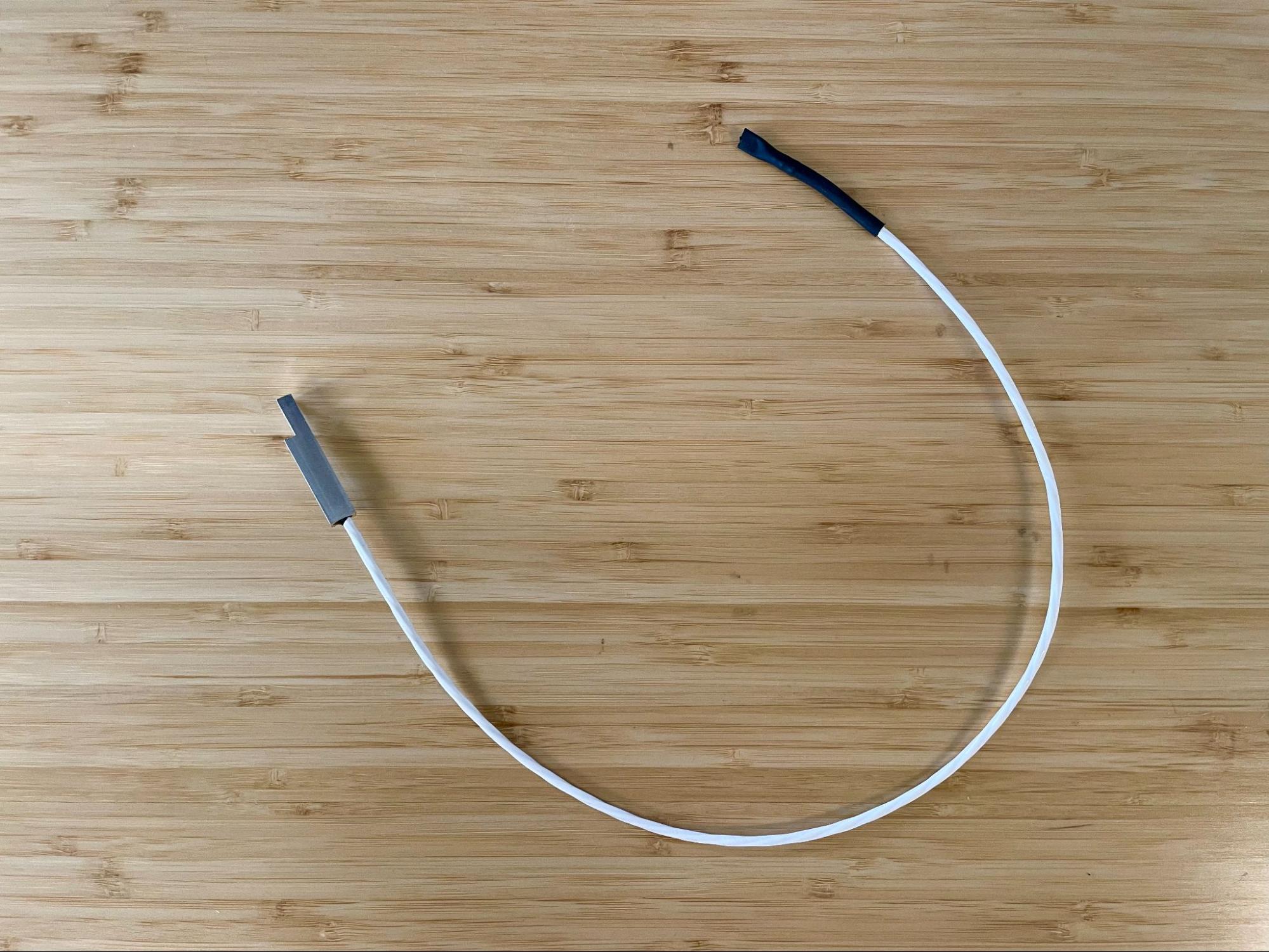

Step 1: Prepare the air heater RTD for installation
Unbox the replacement air heater RTD. Apply a piece of heat shrink tubing or tape to the end of the wires as shown. This makes it easier to feed the wires through the grommets without damaging them.

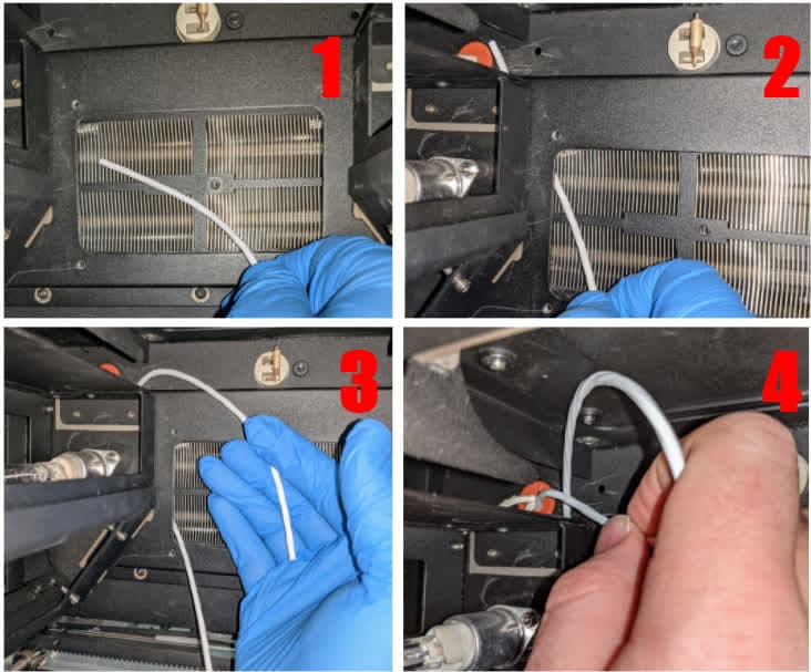

Step 2: Route the air heater RTD cable
Route the new RTD cable through the top-left corner of the air heater grate (1) and out the upper left near the grommet hole (2). Pull the cable away from the grommet hole to gather slack (3), then feed the cable through the hole (4).
Install the new RTD
Step 3: Mount and secure the air heater RTD
Align the screw hole in the RTD with the corresponding hold in the air heater grate. Thread the 8 mm M3 button screw into the screw hole, then use a 2 mm hex driver to tighten until snug.

Step 6: Continue routing the air heater RTD cable
Install the new RTD
Install the new RTD
Move to the back of the printer. Continue pulling the new RTD cable through the grommet hole from the backside of the printer. Ensure there is no slack left inside the print enclosure. Feed the new RTD cable through the detached silicone grommet.

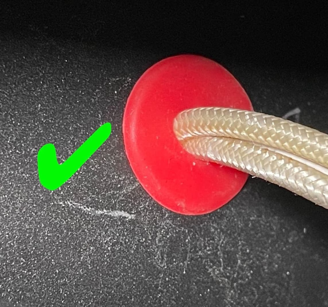

Step 7: Reinsert the rubber grommet
Install the new RTD
Install the new RTD
Secure the grommet back into the printer’s frame.

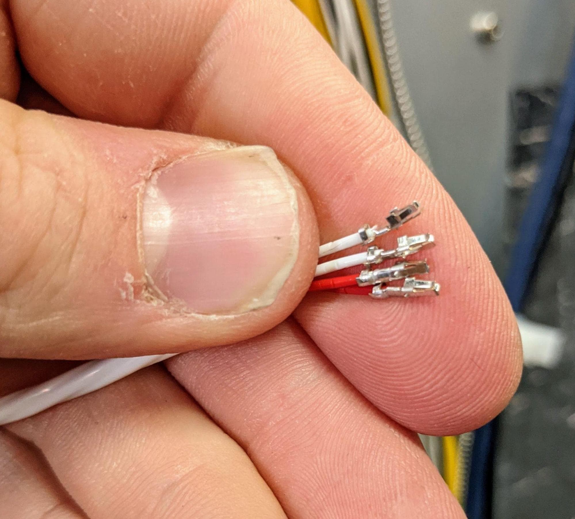

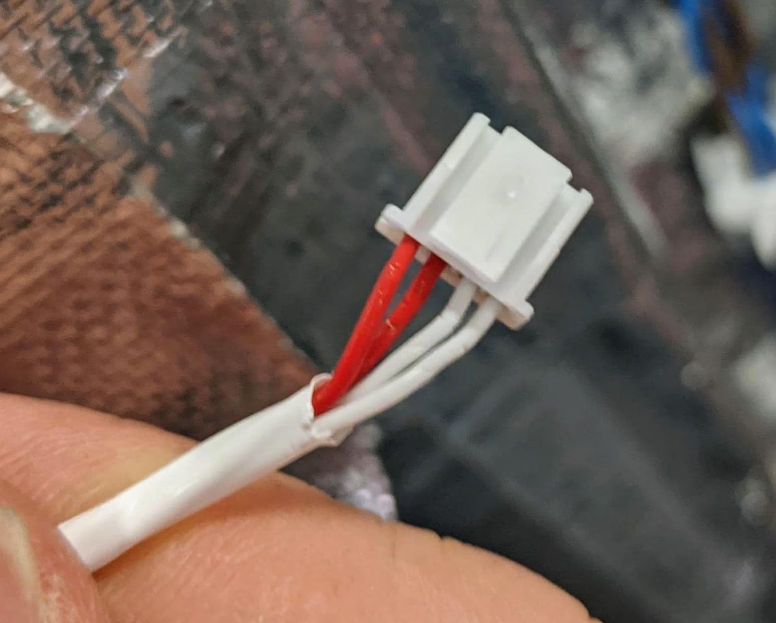

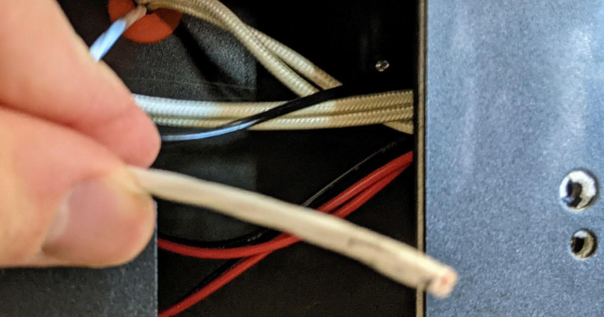

Step 9: Expose the air heater RTD wires
Install the new RTD
Install the new RTD
Carefully remove the heat shrink tubing or tape from the end of the wires and expose the contacts. If the insulation on any of the individual wires is broken and the conductor is exposed, the RTD cannot be used.
Step 10: Reconnect the air heater RTD connector
Install the new RTD
Slide the crimped connectors into the new connector. Follow pin order shown here. Reconnect the air heater RTD to its extension cable.

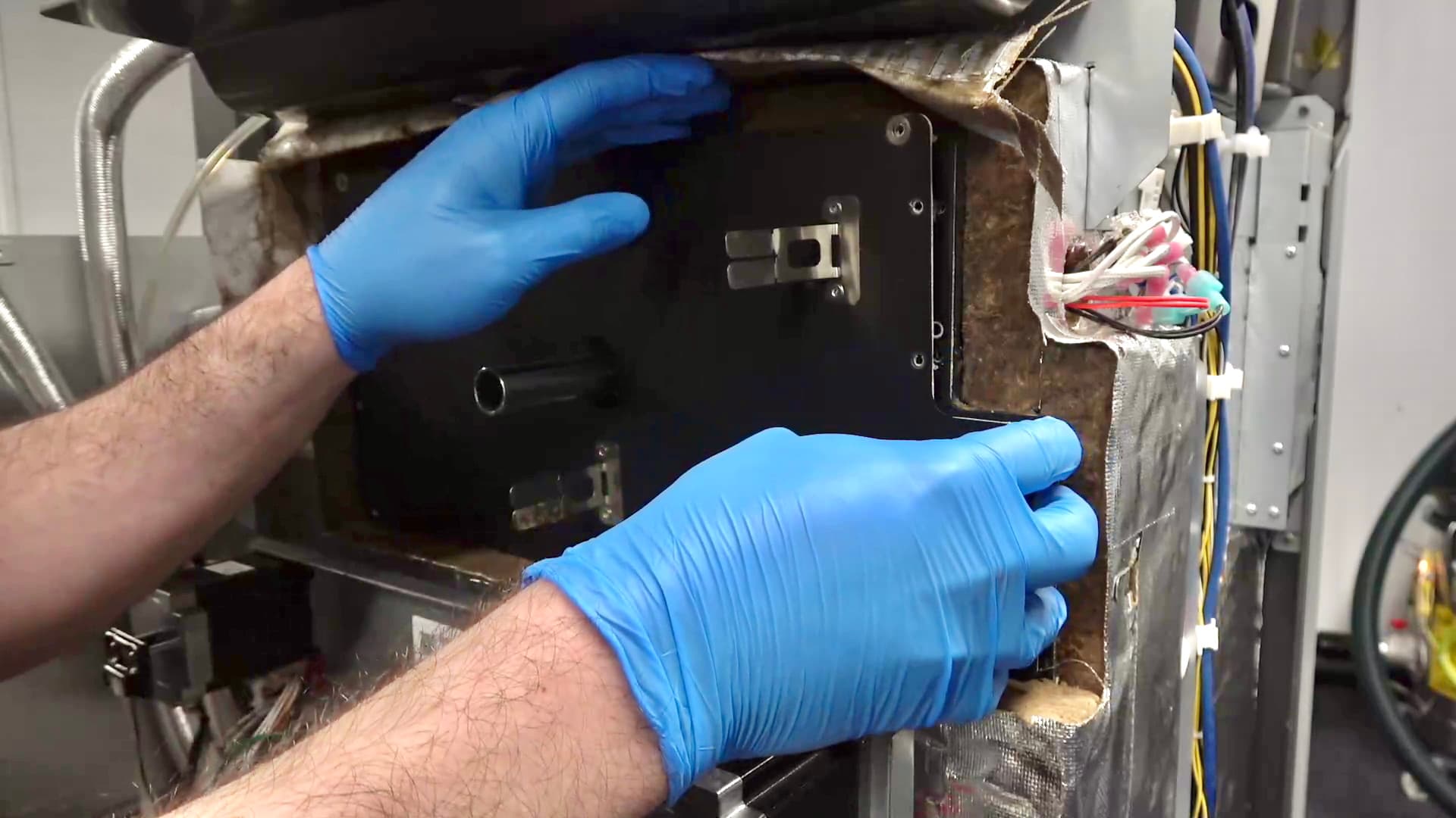

Step 1: Mount the inner rear panel
Put on a pair of clean nitrile gloves. Orient the inner rear panel with the metal retention tabs facing you. Slide the panel over the air heater inlet. Ensure that the screw holes in the panel align with those in the printer.
Replace the inner rear and insulation panels
Step 2: Secure the inner rear panel
Thread one M4 socket head screw into each of the 13 screw holes in the inner rear panel. Using a 3 mm hex driver, tighten until snug.

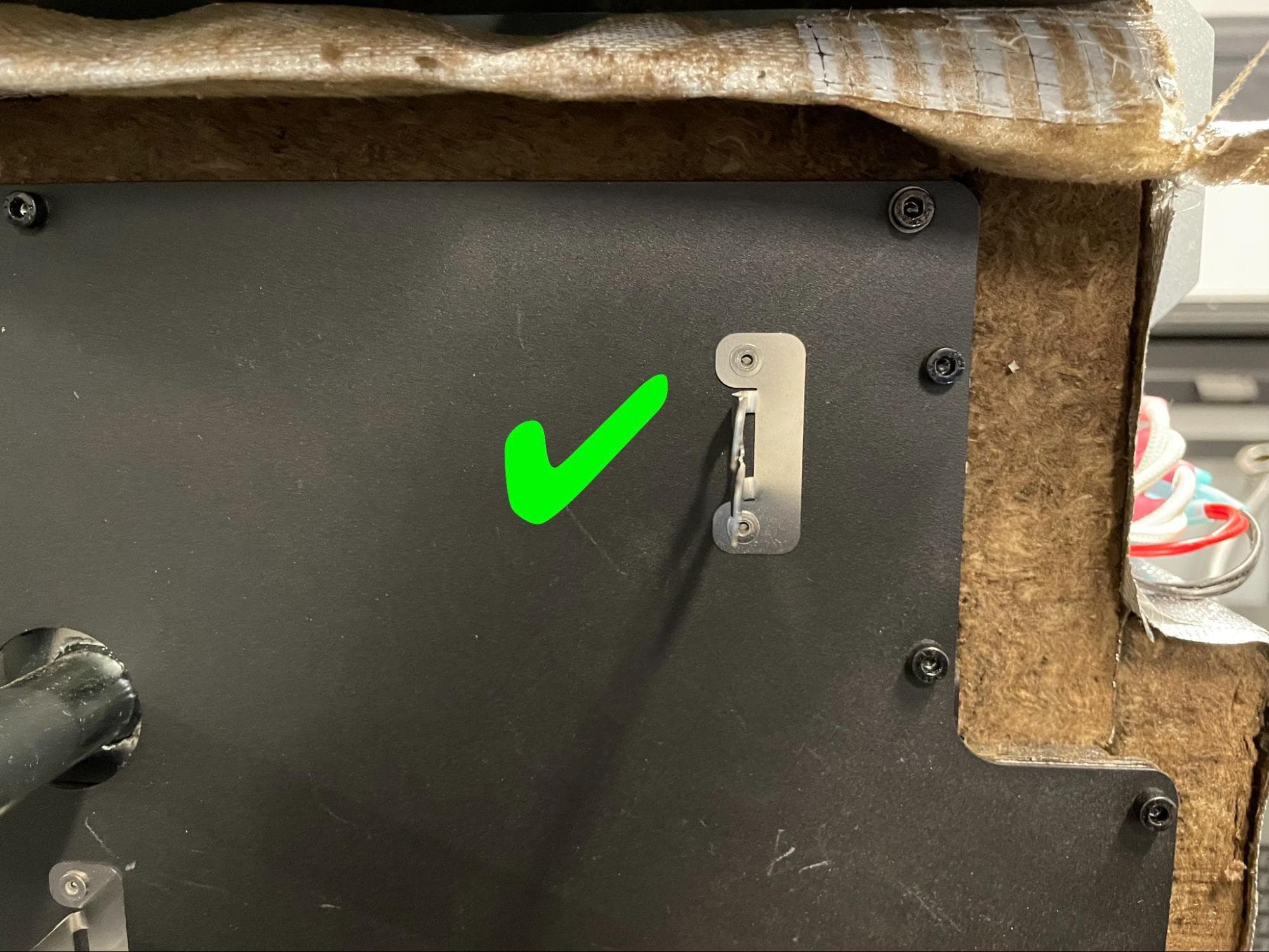

Step 3: Prepare the retention tabs
Straighten the three metal retention tabs that secure the rear upper insulation panel to the back of the printer. Ensure that both halves of each tab are parallel to each other. If they are not, they will shred the insulation as the panel is removed.
Step 4: Mount the insulation panel
Slide the upper rear insulation panel in place and fold the tabs over to secure it.

Step 5: Seal the insulation panel in place
Use 100 mm (4 in) foil tape to cover any seams around the rear insulation panel. If the previous tape was peeled off instead of cut, replace the entire piece.
Step 6: Mount and secure the air heater duct
Slide the air heater duct back onto the inlet pipe, then tighten the ring clamp to secure the duct.

Step 1: Align the upper rear panel with the printer
Lift the upper rear panel and align it with the four screw holes on the top of the printer.
Step 2: Secure the upper rear panel top screws
Thread the four 6.0 mm screws into each of the screw holes on the top of the printer. Using a 2.5 mm hex driver, tighten the screws until finger tight. You may need to adjust the exhaust duct to correctly position the upper rear panel.
Step 3: Secure the buffer side panel screws
Thread the two 6 mm screws into the screw holes on the buffer side and the two 6 mm screws into the screw holes on the hopper side. Using a 2.5 mm hex driver, tighten the screws until snug.
Step 4: Secure the hopper side panel screws
Thread the two 6mm screws into the holes on the hopper side. Using a 2.5 mm hex driver, tighten the screws until snug.
Step 5: Secure the upper rear panel grounding screws
Thread the panel screws into the indicated screw holes on the upper rear panel. Refer to the image for the correct locations of the black and chrome screws. Using a 2.5 mm hex driver, screw in the two black panel screws and two chrome grounding screws securing the upper rear panel to the printer.

Slide the end of the exhaust duct with the ring clamp back onto the exhaust pipe. Ensure the exhaust duct presses against the insulation panel.
Step 7: Tighten the exhaust duct ring clamp
Using a 6.5 mm flathead screwdriver, tighten the ring clamp until finger tight.
Step 8: Secure the exhaust inlet screws
Open the filter cabinet door on the printer. Thread the four 8.0 mm screws into the screw holes. Using a 2.0 mm hex driver, screw in the four exhaust duct screws until finger tight.
Step 9: Check the exhaust duct seal
To ensure there is no gap between the exhaust duct’s mounting plate and the filter cabinet housing, shine a flashlight or other light source around the exhaust inlet inside the filter cabinet. If any light is visible behind the filter cabinet, the duct is not properly sealed. If necessary, use a 2.0 mm hex driver to tighten the exhaust duct screws. Close the filter cabinet door when finished.
Step 10: Secure the lower rear panel grounding screws
Thread the panel screws into the indicated screw holes on the lower rear panel. Refer to the image for the correct locations of the black and chrome screws. Using a 2.5 mm hex driver, screw in the six black panel screws and four chrome panel grounding screws securing the lower rear panel to the printer.
Notice:
The placement of the chrome screws is critical to the printer's electrical grounding. Incorrect placement may lead to printer damage.
