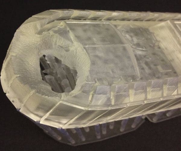

Undeveloped features
An "undeveloped feature" is a print defect in which a void of missing material forms within a print and widens as the print builds away from the build platform. These voids can look like a crater and frequently exhibit sharp edges and rough surfaces. In some cases, it can look like the missing material exploded” outwards from the build platform.
