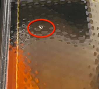

Inspect the release texture for dust, oil streaks, fingerprints, or cured resin.

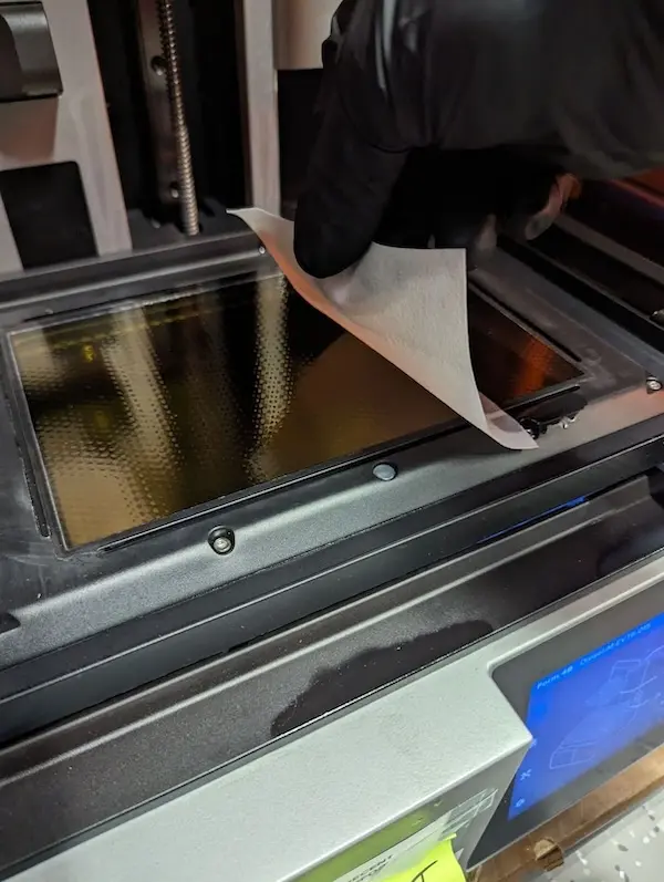

  1. Put on a new, clean pair of nitrile gloves.

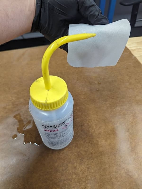

  2. Grip the top of a non-abrasive wipe with a gloved hand. Soak the bottom half of the wipe with clean isopropyl alcohol.
Wetting a non-abrasive wipe with isopropyl alcohol

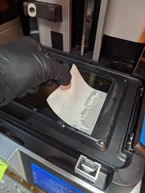

  1. Drag the isopropyl alcohol soaked wipe slowly across the surface of the LPU. It should take 20–30 seconds to traverse the width of the LPU.
    • Do not contact the release texture with your hand or apply pressure to the wipe.
    • For debris and resin near the edge of the LPU, always drag the wipe towards the edge of the LPU to avoid spreading the contaminant.
Cleaning a Form 4 LPU with a wetted non-abrasive wipe
  1. Wait for the isopropyl alcohol on the release texture to dry.
  2. Repeat this process several times until the contaminant has been removed.

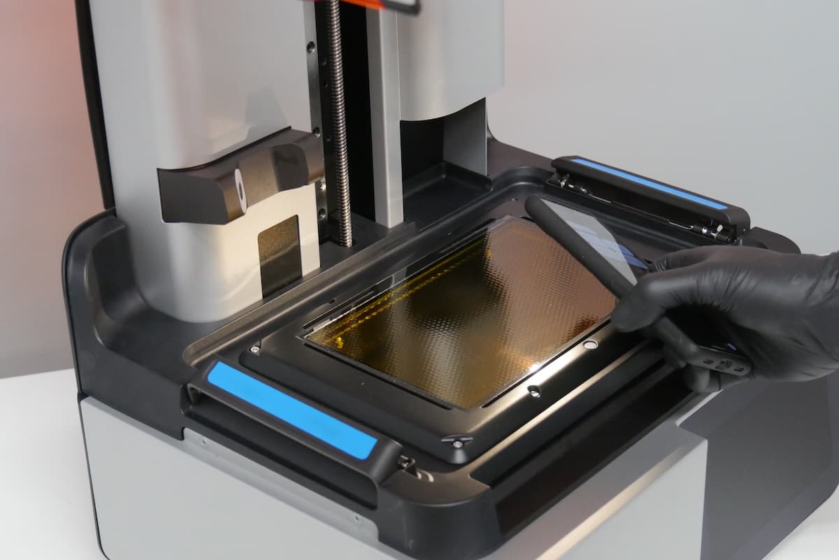

Cleaning cured resin
Cured resin cannot be removed with IPA and requires removal with the plastic scraper.
Notice:
Avoid using sharp tools to remove cured resin because they may scratch the release texture.
  2. Gently slide the plastic scraper underneath the cured resin at a shallow angle to remove it from the release texture.
  3. For cured resin that is difficult to remove, apply clean isopropyl alcohol on to the release texture to help with removal. After removal, wait for the isopropyl alcohol on the release texture to dry.

LPU release texture damage
The LPU may sustain damage to the release texture that looks like cured resin or like part of the texture is missing. This is usually caused by the build platform squishing debris into the texture during a print.
Damage to the LPU may affect print quality, since it can redirect the light coming from the backlight unit. This damage may be very small and difficult to feel on the surface of the release texture. If you see LPU texture damage that you cannot remove, take a photo of the damage and contact Formlabs Support or your authorized reseller.
