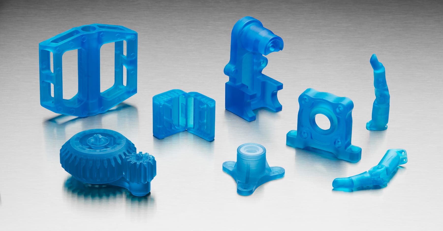

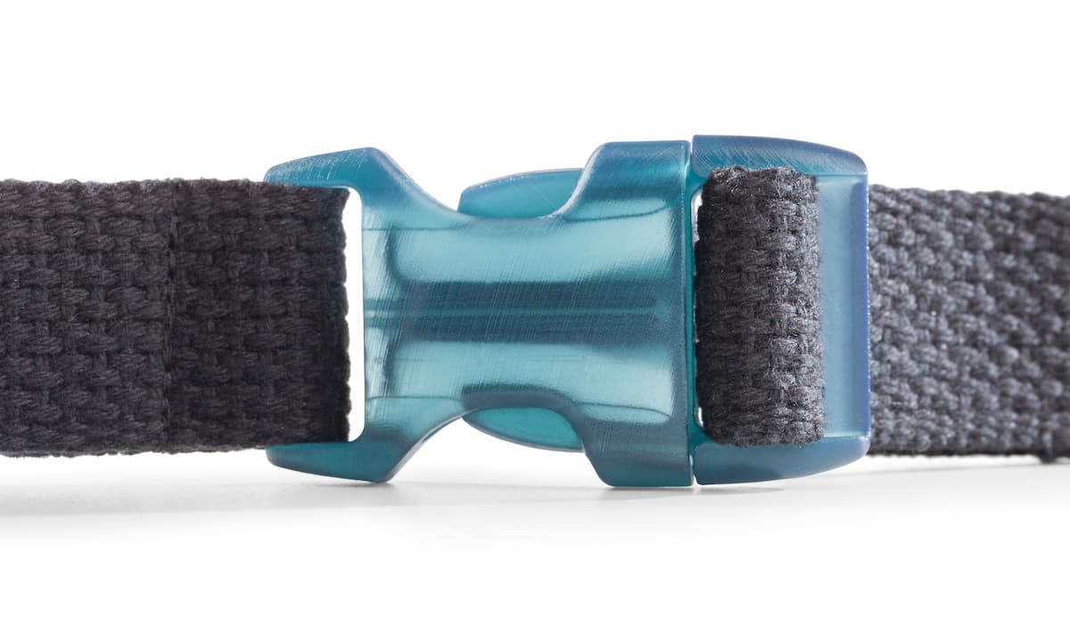

Tough Resin V5 simulates the feel and many of the important mechanical properties of Acrylonitrile Butadiene Styrene (ABS) plastic. ABS is a very common thermoplastic that provides a good balance of strength and flexibility. Tough Resin V5 creates strong engineering prototypes and has been developed to withstand high stress and strain. Consider using this material for “works-like” prototypes and assemblies, including designs with snap fit joints and living hinges. For further finishing, Tough Resin V5 can also be machined once printed.
Tough Resin V5 prints at 50 microns and 100 microns.
