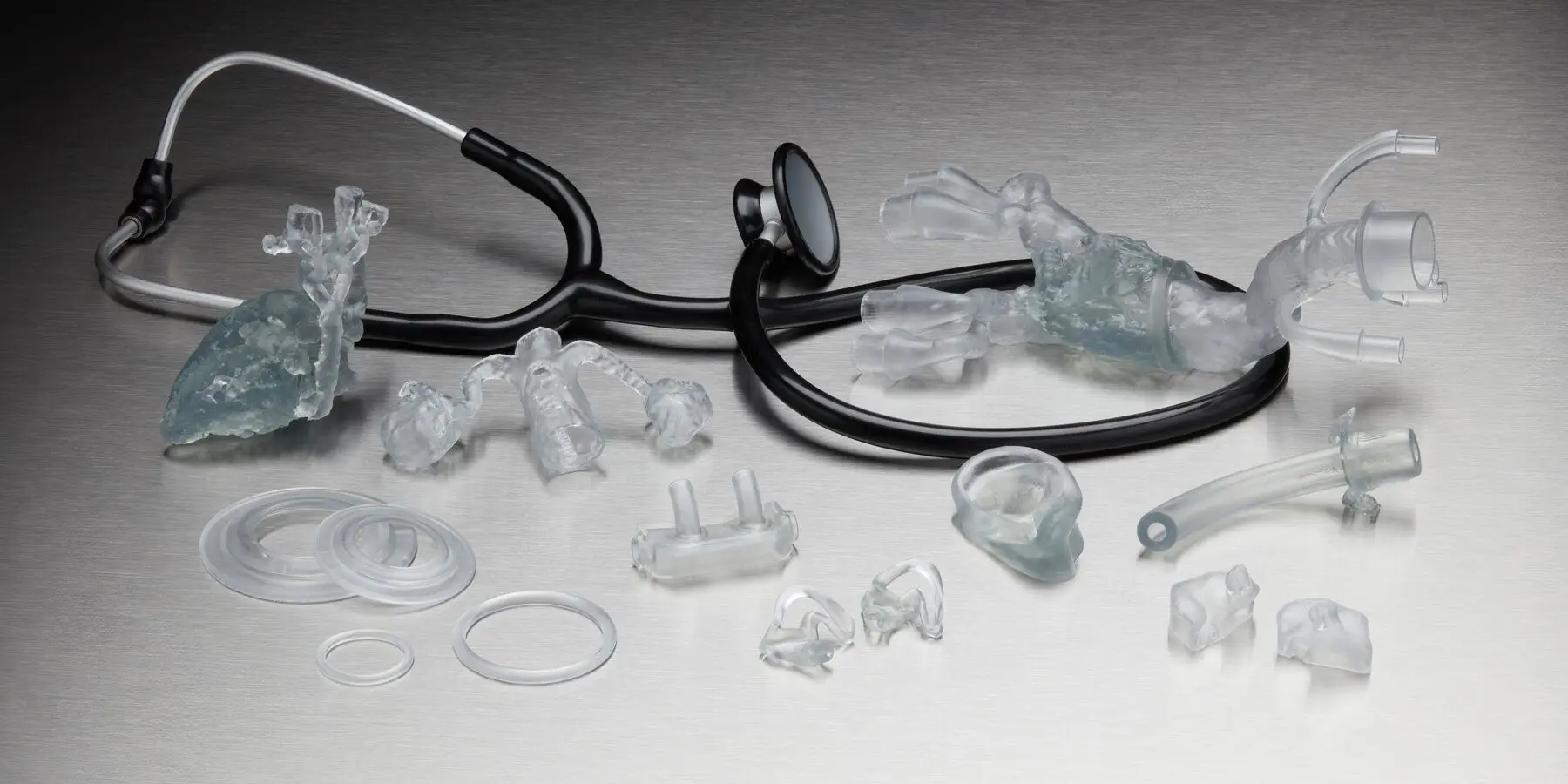

A selection of medical device parts printed with BioMed Elastic 50A Resin
