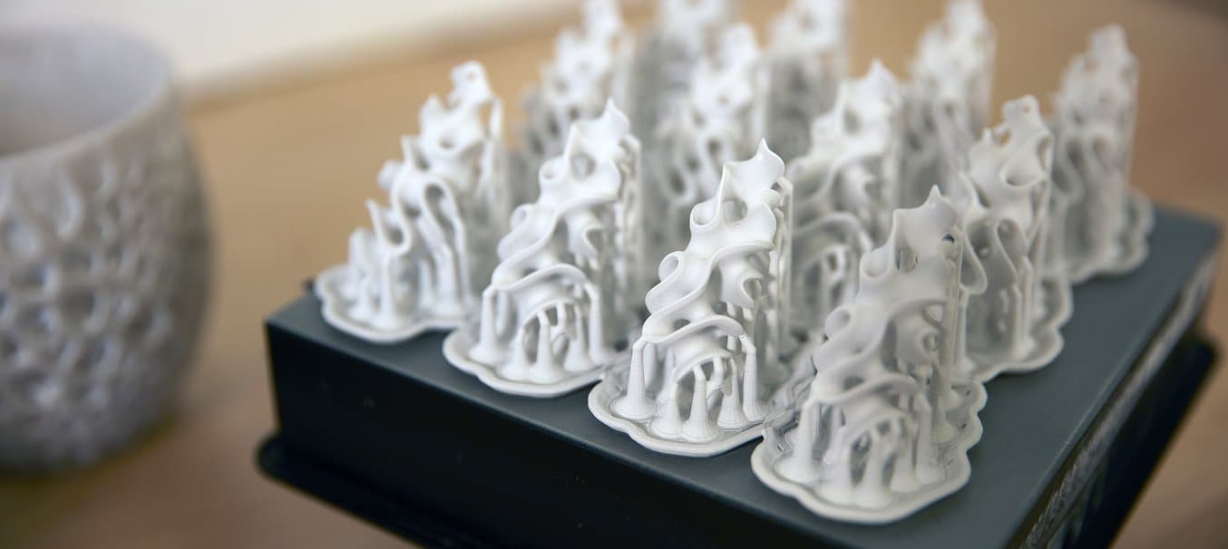

In parallel to exploring 3D printing ceramics, Nervous System was investigating minimal surface structures, an offshoot of work with New Balance, and came across similar geometries in glass sea sponges.
The sponges’ interconnected, self-supporting shapes were ideal for printing with Ceramic Resin, and also worked well for successfully placing and removing supports from the 3D printed parts.
The team simulated the sponge geometries to generate forms that became the final necklaces and earring pieces for the collection.

It took a lot of testing to find a successful firing and glazing workflow. Nervous System’s final process influenced the Formlabs Ceramic Usage Guide, which any Ceramic Resin user should read in full before printing with the material.
Previous ceramic materials Nervous System worked with did not reach the density of traditional ceramics, so parts in their fired state were still very porous, and required a different glazing process.
“We would sort of fully fire them, then glaze them, and then do a low fire glaze,” Louis-Rosenberg said. “That doesn't make sense for Formlabs Ceramic Resin, because it's able to get more of a fully dense final part. This is what is good about it, but that means that if you fire it all the way, it's very hard to glaze because the glaze doesn't actually stick to a glassy surface.”
With the help of their ceramicist, the team realized they needed to fire parts at a much lower temperature to make them porous, then apply the glaze and fire at a higher temperature.
“What we do is actually much more like a traditional ceramic process; we first do this process, called a burnout where all of the resin is removed and we fire it to a lower temperature—1900 degrees Fahrenheit, which is around a cone of 05. That leaves kind of a very brittle, porous part. We want it to be porous, because that way it accepts glaze very well,” Louis-Rosenberg said.
After the bisque firing, printed parts are brittle and porous. The studio dips parts in a glaze developed by their ceramicist based on commonly available recipes. Once glazed, parts are fired a second time to cone 10, which is around 2350 degrees Fahrenheit.
