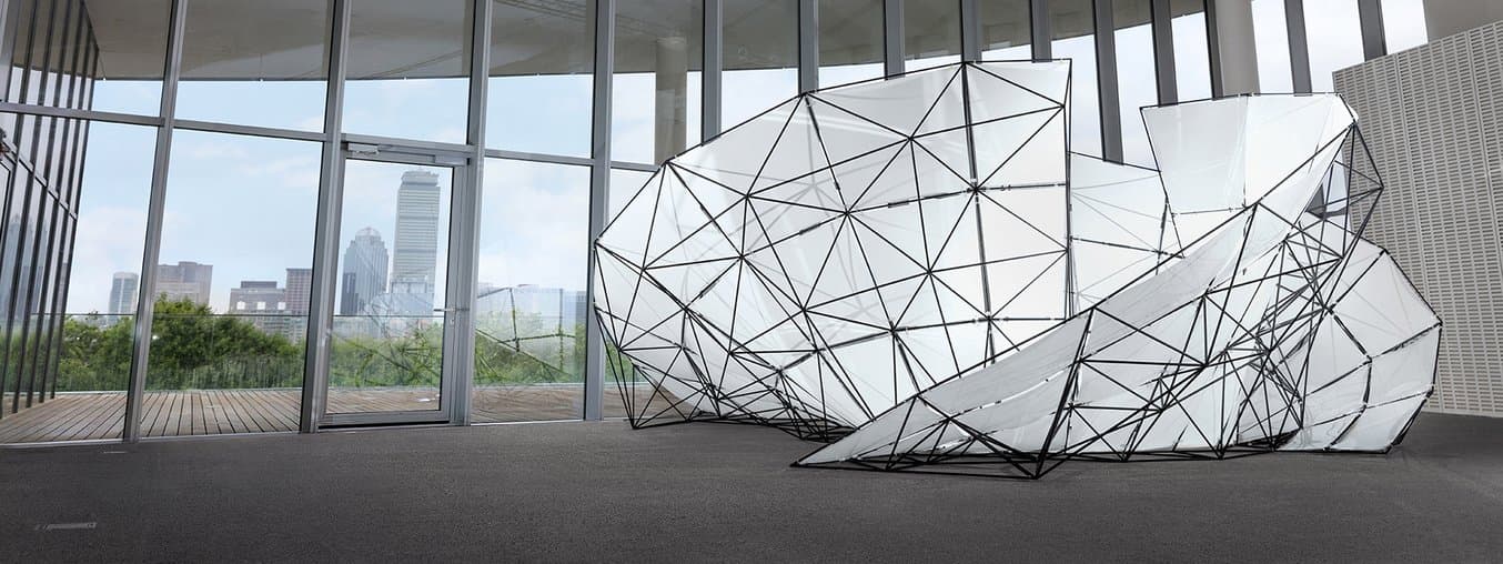

To put SLS technology’s capabilities to the test, we decided to build a large pavilion structure to serve as a unique meeting space during the 2017 FUSE conference. We used the Fuse 1 SLS printer to produce more than a hundred unique construction modules en masse, which were assembled in four days to create a structure covering 150 square feet.

We landed on a design derived from the equation for a mobius strip, revolved to create an enclosed meeting space surrounded by three large, sweeping blades. The blades become rigid and structural by adding a space frame to the rear side.
The pavilion is by far the largest structure that we know of made with Formlabs parts: at 15 ft across and 8.5 ft tall, it was able to fit three people comfortably inside.

Three people spent six hours a day for four days constructing the pavilion. We took the guesswork out of building the frame by projecting a 3D diagram of the structure on the wall and pre-sorting all of the parts. Even so, the build was a test of spatial reasoning and patience; simply finding and orienting each part in physical space took considerable time.
