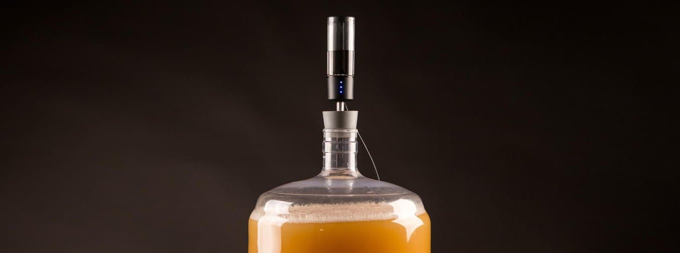

“[For brewing], a product should withstand spillage, corrosion, and accidental dropping. You have to have everything cleaned and sanitized, as you’re always risking contamination and infection. We had to develop a method that monitors fermentation activity without putting any sensors inside the brew because it's so sensitive to invasive measurements. Basically, we needed to create a product that measures the activity without touching the beer,” Kononsky said.
To answer these unique parameters, the entrepreneurs decided to develop an optically clear airlock.

“I think we had around 1,000 different clear part prototypes—we produced six prototypes a day, then iterated the design in Solidworks based on the conclusions, while having a new part already printing. We measured the bubbles, measured the flow, tweaked the parameters, and used some machine learning and empirical learning. Working so closely with the parts, you actually understand the material and its properties.”
Kononsky and Ingebrigtsen required highly accurate prototypes that can be taken apart, cleaned, washed, and reassembled to click exactly at the same spot so that the sensitive sensor would give the correct reading in their next test.
“It's the same working principle like a pen, with a cup that you click on and that stays at the exact same spot. We managed to solve it with a combination of the Clear Resin for the clear part, and the Tough Resin for the bottom. Clear parts are very rigid, while the Tough bottom parts had some flexibility to allow for a tiny groove, some ribs, and a double-click ring. We managed to simulate the final product’s behavior; it worked 100% correctly just like the plastic [injection] molded part,” said Kononsky.
