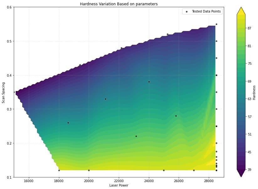

In order to unlock new print possibilities with variable durometer SLS TPU powder, there are two main settings to understand.
  • Fill Laser Power: PSE can control the laser’s power. Lower-powered lasers do not sinter the TPU particles together as densely, resulting in a softer part. However, if the Fill Laser Power is set too low, the part may not sinter at all, and features will not resolve.
  • Fill Hatch Spacing: PSE can control the spacing of the laser’s scanning process. A wider spacing of the laser’s scan undersinters the material, resulting in a softer part. If the Fill Hatch Spacing is too wide, it can result in visible defects on the surface and some delamination of certain positive features.
To achieve a softer durometer TPU, you can alter either Fill Laser Power, Fill Hatch Spacing, or both. The following results can be achieved through a combination of changes to these two settings.
variable durometer tpu graph
As the graph shows, a shore hardness of 38A was achieved during testing. In general, changing Fill Hatch Spacing has a much larger effect on the hardness of the part, while Fill Laser Power amplifies the effect. For example, to sinter a part with a hardness of 60A, a good starting point would be a Fill Hatch Spacing of 0.35 mm and a Fill Laser Power of 21,000 mW.
At the extremes of very low Fill Laser Power or wide Fill Hatch Spacing, there may be visible surface effects. Certain features may not resolve, and there may be a ‘fuzzy’ or ‘crumbly’ surface texture. Changing the thickness of a part can help mitigate the effect of changing a setting on the feature resolution; thick parts typically resolve better, even with wider Fill Hatch Spacing settings. Formlabs does not recommend printing thin parts with greater than 0.45 mm spacing.

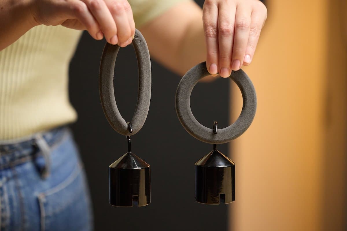

two lattice sls 3d printed

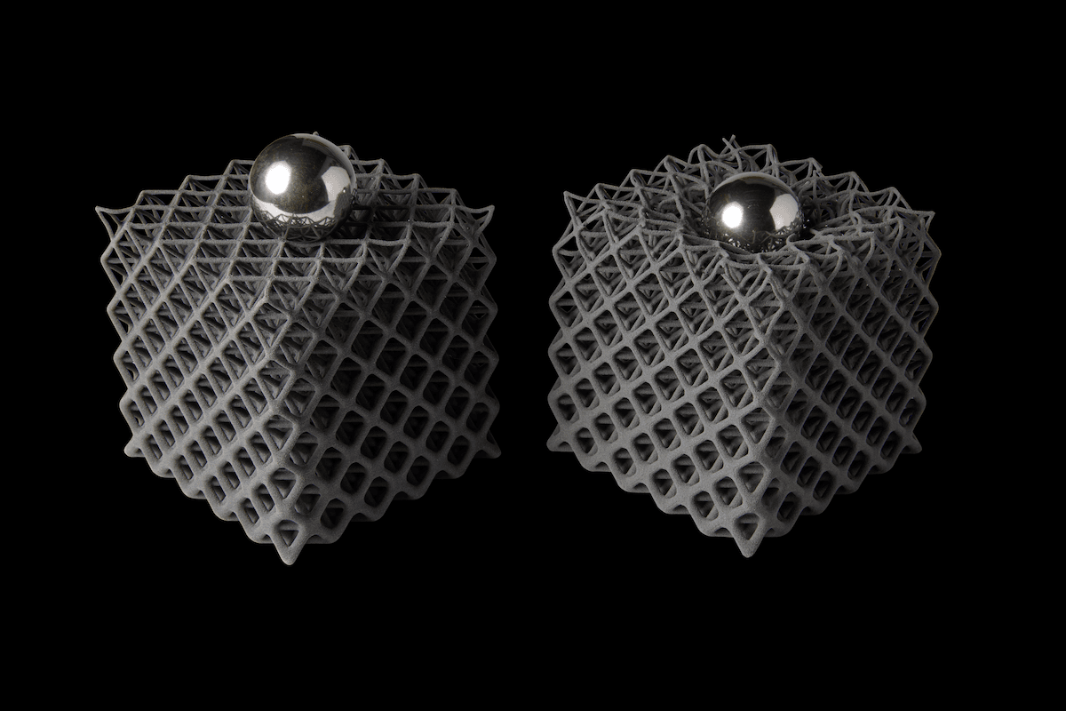

Variable durometer TPU can be helpful when prototyping cushioning components.

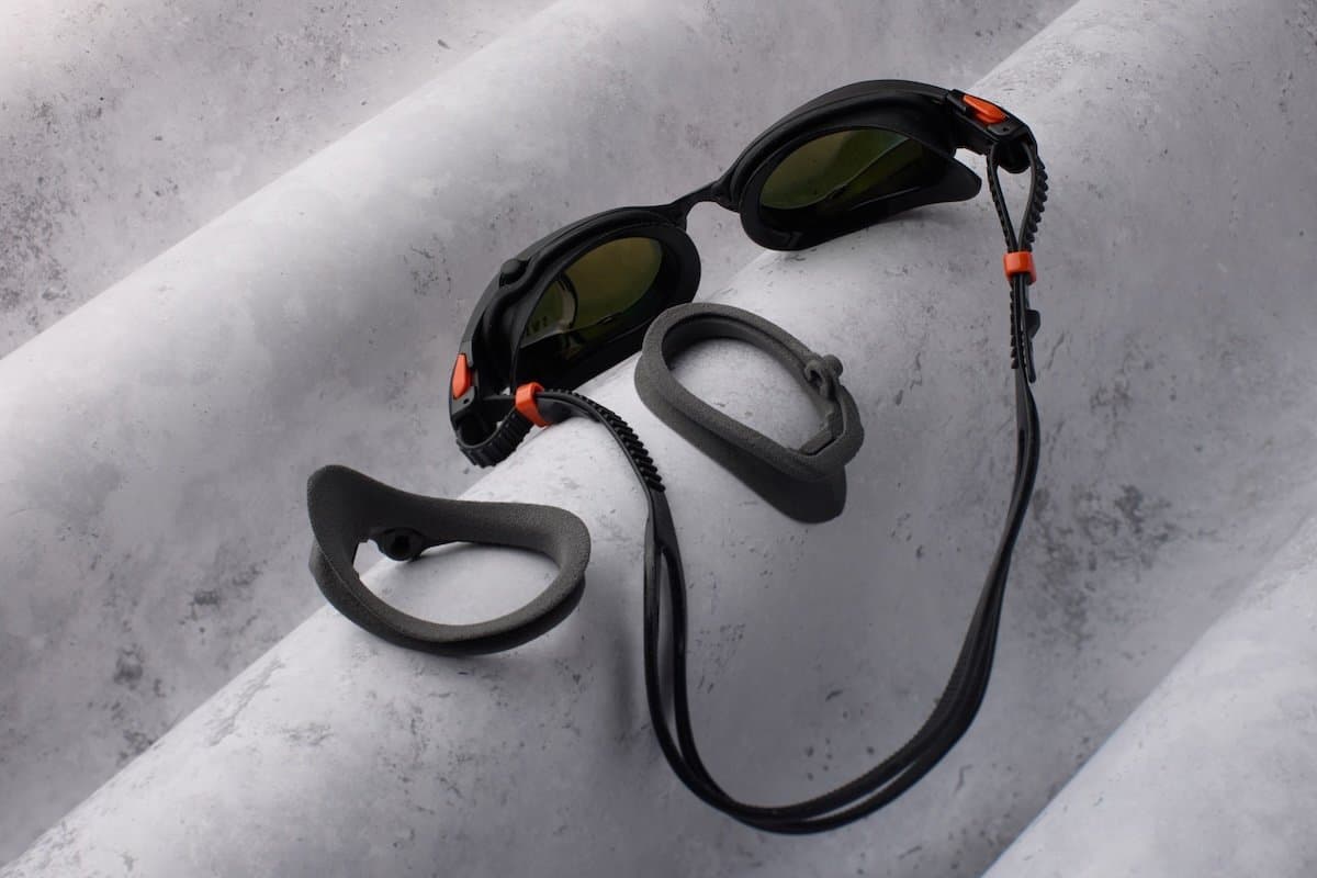

variable durometer tpu goggles sls 3d printed
TPU 90A Powder already has a skin-safe certification, so softer durometers can be ideal for customizing gear.

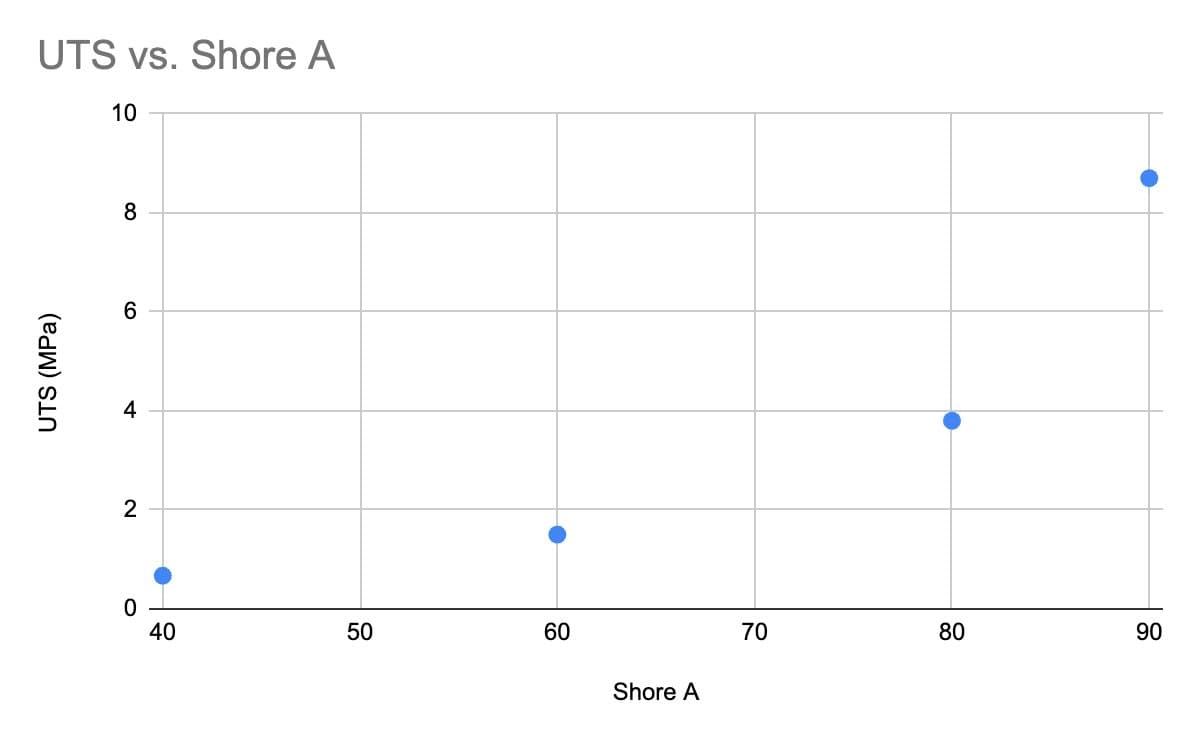

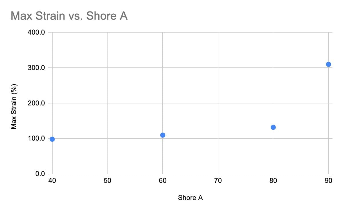

Elongation at break (EAB), ultimate tensile strength (UTS), and stiffness are particularly affected by changing Fill Laser Power and Fill Hatch Spacing.
variable durometer TPU bending dogbones
On long strips like the tensile bars in this image, changing material properties are particularly evident. Rearmost bar (40A), middle bar (60A), and front bar (80A) all exhibit different levels of stiffness.
To quantify this effect more precisely, see the graphs below. Reducing the hardness from 90A to 80A also reduces the UTS and maximum strain of the parts by over 50%. This makes it more likely for parts to tear during depowdering, damaging fine features.

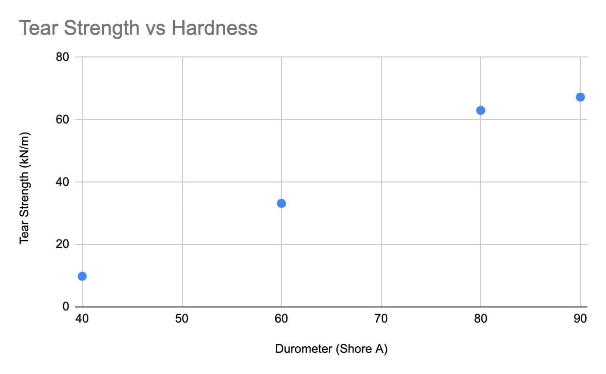

Reducing the hardness from 90A to 80A also has a significant effect on the tear strength of the parts, with the higher hardnesses coming in at closer to the nominal tear strength of 66 kN/m and the lower hardness parts rapidly decreasing in strength.

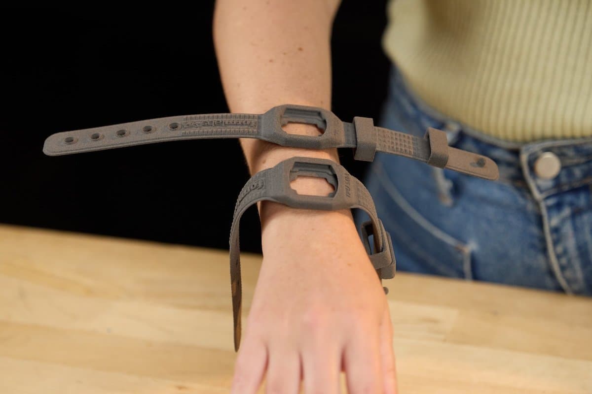

For consumer product testing, softer elastomeric materials like a TPU powder with a durometer of 60A can help get your design team closer to the final injection molded product.

Raw Testing Data
The table below lists raw data from Formlabs testing on the effect of Fill Laser Power and Fill Hatch Spacing on Shore hardness. Reference this data when developing your own print settings.
Fill Laser PowerFill Hatch SpacingHardness
150000.3537.7
180000.1290.1
186250.2666.3
194000.4340.4
200000.1288.5
211000.3362.7
221600.4843.6
231500.2278.6
240000.3862.3
250000.1289.8
252500.5245.3
258000.2874.9
270000.1290.6
285000.1289.8
285000.1291.4
285000.1390.7
285000.132589.5
