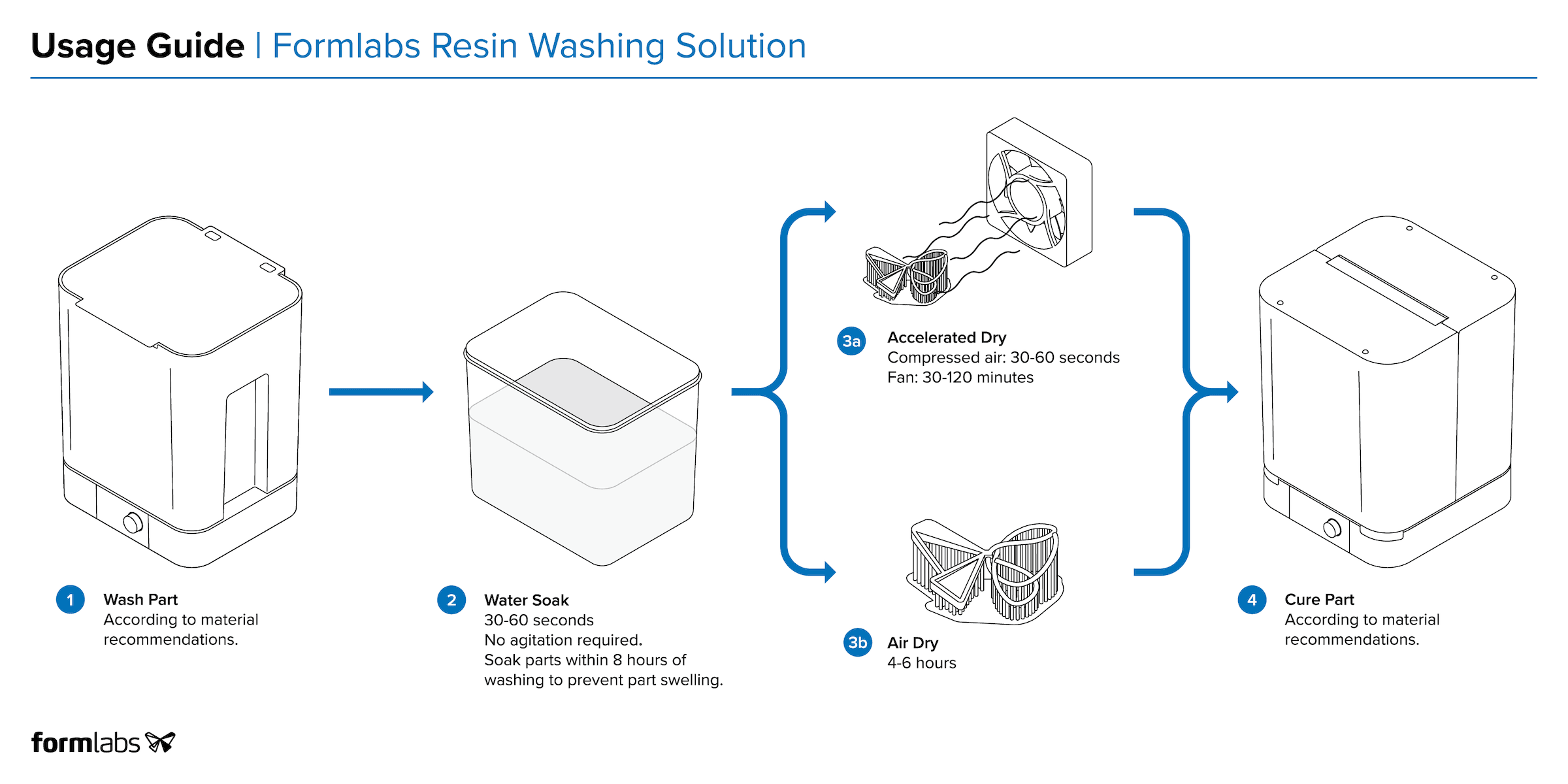

Formlabs Resin Washing Solution usage guide
To wash parts in Formlabs Resin Washing Solution:
  1. Fill your wash containers. Fill the wash bucket (e.g., of your Form Wash or Form Wash L) with Formlabs Resin Washing Solution. Fill a separate container with water. Ensure the container is large enough so that printed parts can be fully submerged in water and that the container has a lid. Alternatively, IPA can be used instead of water for faster drying times.
  2. Wash your printed parts as you would with IPA. Follow the guidelines in our support article Form Wash/Form Wash L time settings as a baseline.
  3. When the wash cycle is complete, move your prints to the secondary container and let them soak in water for 30–60 seconds. No agitation is required.
    • Ensure the parts are rinsed within eight hours of washing with Formlabs Resin Washing Solution. If parts are wet with Formlabs Resin Washing Solution, they may swell and have reduced accuracy and mechanical performance.
  4. Let the prints air dry. The parts will regain their normal appearance as they dry. Air drying takes 4–6 hours. Use compressed air to accelerate dry time to 30–60 seconds or a fan for parts to dry in 30–120 min.
