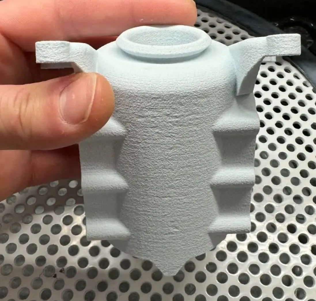

SLS printed parts typically have a grainy matte finish. If material is not heated optimally during printing, the surface finish can worsen, exhibiting a texture similar to birchbark, orange peel, or sandpaper.

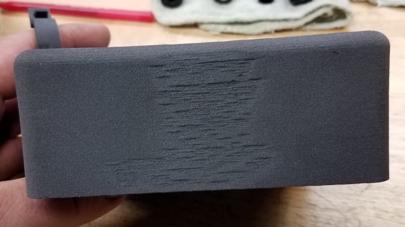

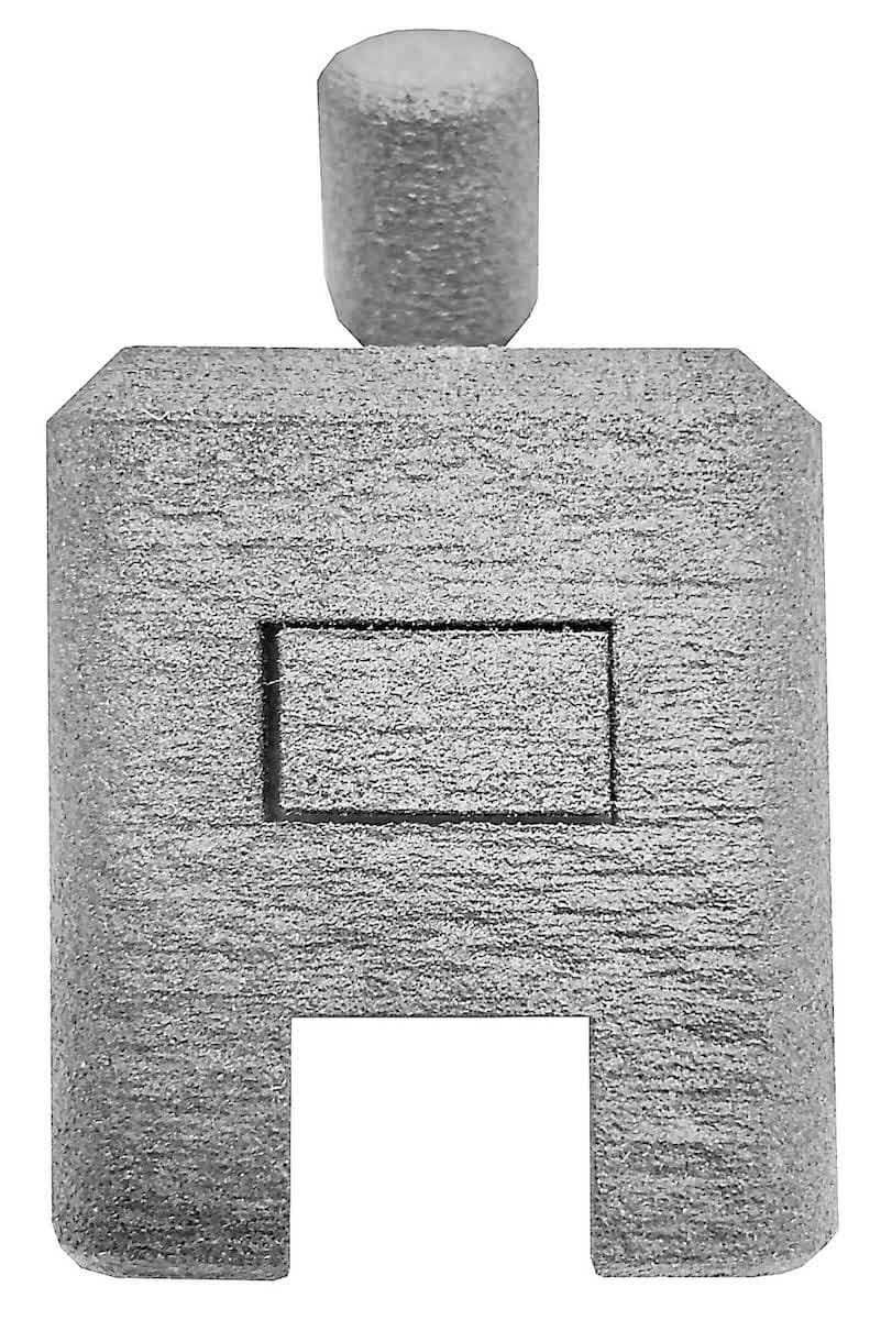

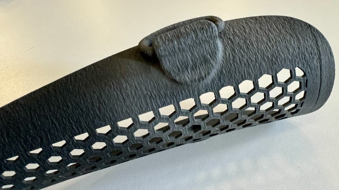

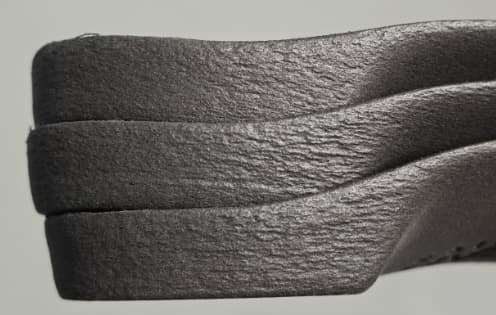

Symptoms
  • Shallow ridges running along layer lines
