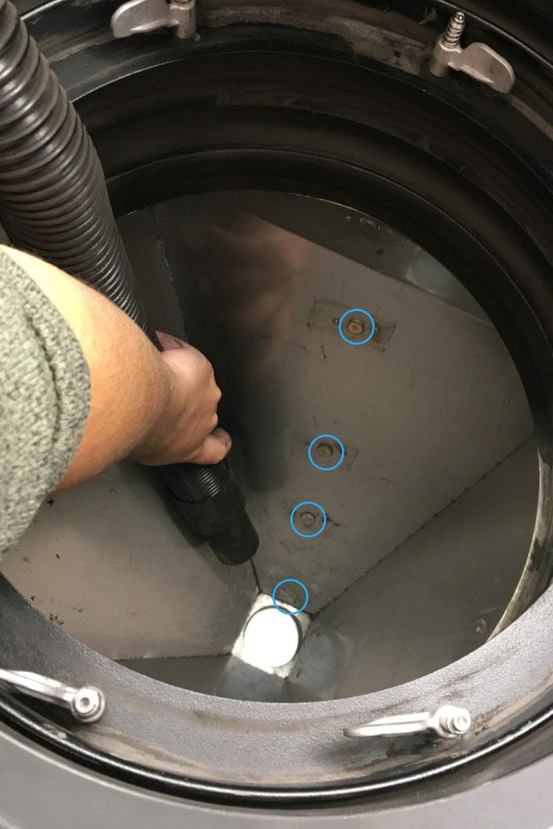

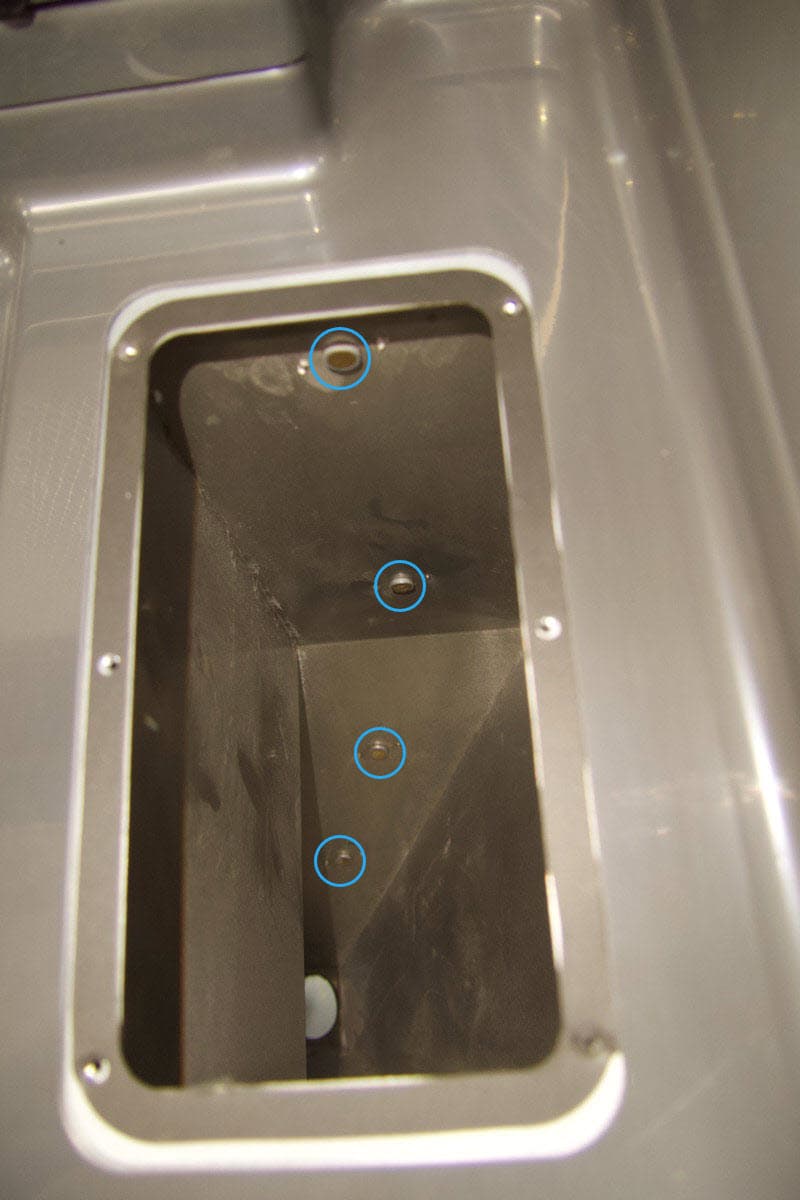

  3. Clean the fresh powder hopper and the used powder hopper, paying attention to the four powder sensors in each hopper. Powder often collects on top of the sensor and falsely triggers it.
    • If powder accumulation is causing frequent issues with hopper fullness tracking, you can continue to clean the sensors or ignore any fill-related errors if you know there is sufficient powder in the hoppers.
Fresh powder hopper sensors
Used powder hopper sensors
