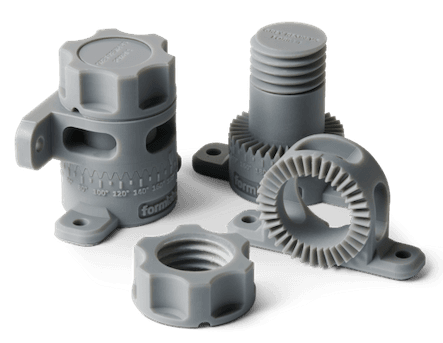

Several models printed in Grey Resin V5 on a Form 4 generation printer

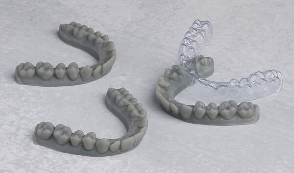

A diagnostic model printed in Grey Resin V5 on a Form 4 generation printer
