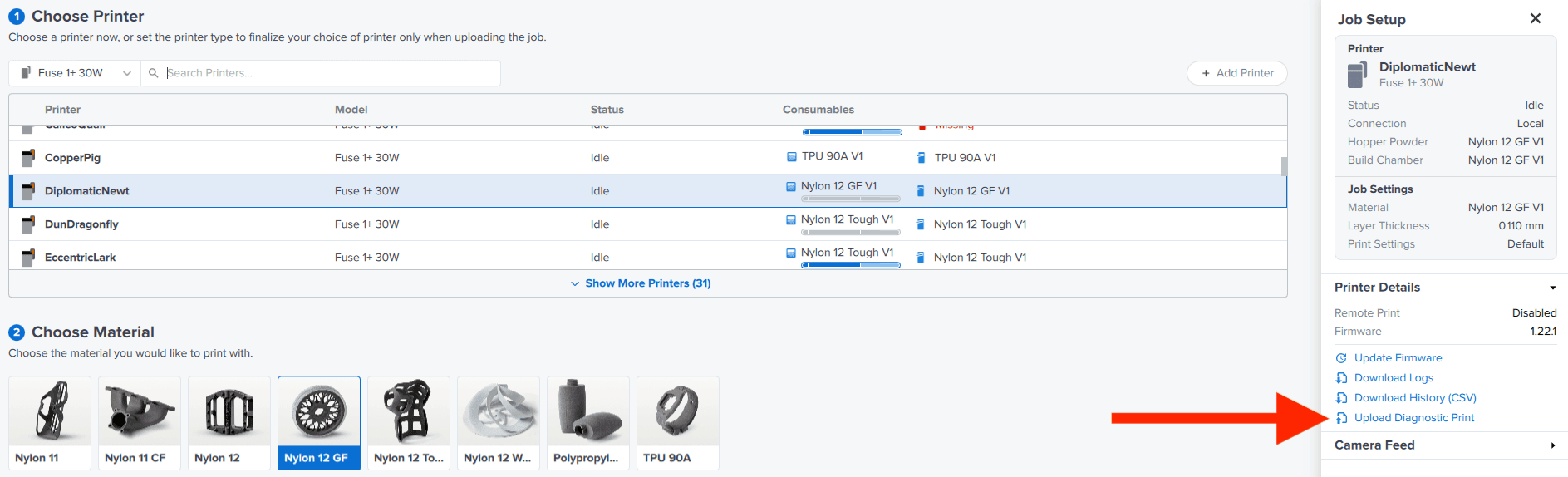

  4. Open PreForm and select Job Settings.
  5. In the Job Setup window, make sure the correct printer is selected, then select Upload Diagnostic Print.
alttext
  1. Select the file from your computer. Once the file has successfully uploaded, start the print from your printer.

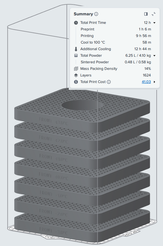

  2. To run the print, 3 kg of powder is required, at a refresh rate of 50%. Age powder if needed to create the correct mix. To load the printer’s hopper with 3 kg of powder, fill the hopper to the 7 L mark.
  3. Allow the print to fully cool per Formlabs recommendations.

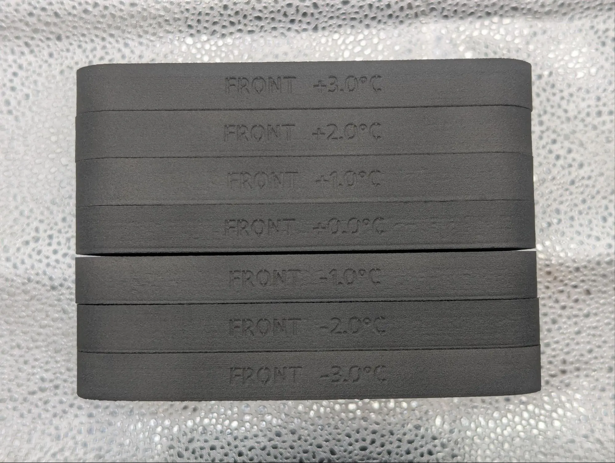

Once the print completes, parts can be extracted from the build chamber by using the Fuse Sift or the Fuse Depowdering Kit. Excess powder can be sifted with fresh powder and re-used.
Parts should be fully cleaned of powder prior to inspection either by the Fuse Blast or other media blasting solutions. Extract the seven plaques and clean them before inspection.
Each plaque is listed with the temperature offset it was printed with (-3 ºC, -2 ºC, -1 ºC, 0 ºC, +1 ºC, +2 ºC, +3 ºC). Line the plaques up from -3 ºC to +3 ºC to prepare for inspection.
Example of Nylon 12 GF plaques ready for inspection
