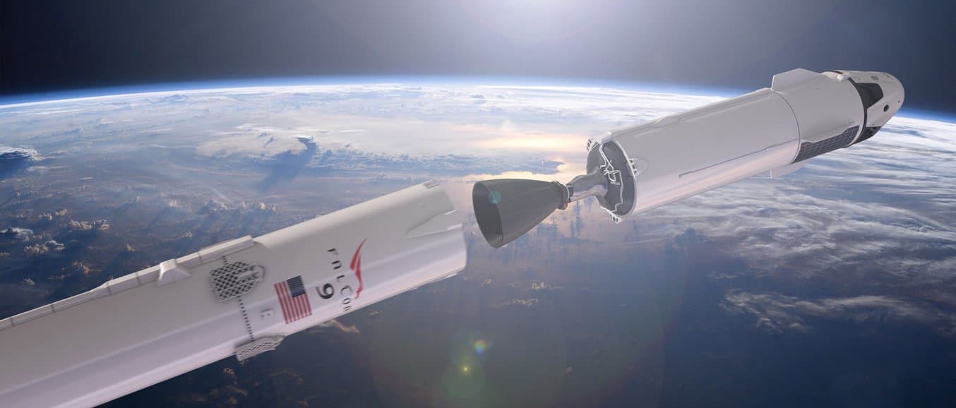

Oli designed the Falcon 9 CAD model in 3DS Max. This image shows the second stage of the Falcon 9 rocket and the payload with the Dragon capsule on the top.
