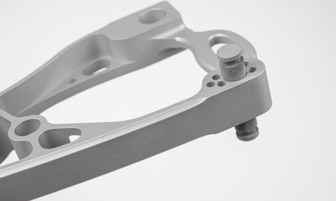

two spider gauge SLS 3d printed automotive components
Our test part, before and after vibratory tumbling. The tumbled part is light gray and matte in appearance.
