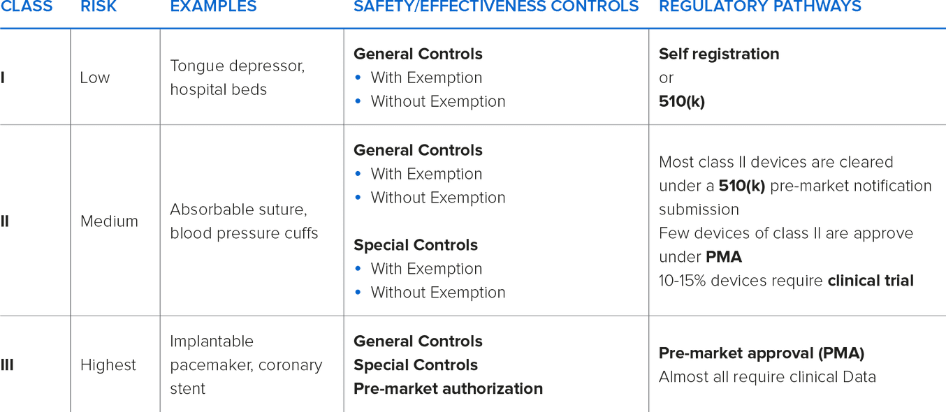

In the United States, the (Food and Drug Administration) FDA designates three classifications of devices. Classification is determined by intended use and indications for use. Classification differences may mean that the device requires a premarket clearance or approval (PMA) information and varying degrees of manufacturing controls.
Typically, as the classification increases, premarket clearances or approvals are necessary.
Class I and Class II devices can be considered either ‘Exempt’ or ‘Non-Exempt’. Exempt Class I & II devices are exempt from premarket notification. Some Class I devices may also be exempt from Good Manufacturing Practices (GMPs) requirements.
Most Class I and some Class II devices are exempt from premarket notification requirements, subject to certain limitations. A device may be exempt from 510(k) requirements if the FDA determines that a 510(k) is not required to provide reasonable assurance of safety and effectiveness for the device. The 510(k) program is used to achieve clearance through demonstrating substantial equivalency to a device already on the market, called a predicate device. A device is substantially equivalent if, in comparison to a predicate it: has the same intended use as the predicate; and has the same technological characteristics as the predicate; or has the same intended use as the predicate; and has different technological characteristics and does not raise different questions of safety and effectiveness; and the information submitted to the FDA demonstrates that the device is as safe and effective as the legally marketed device.
Class III devices are the highest risk devices that can be used to “support or sustain life”. The devices require full FDA PMA and GMP controls.
The manufacturer of the device assumes the responsibility of properly classifying their device and implementing the appropriate controls. For help with classification, the FDA maintains a database of marketed devices and their associated classifications.

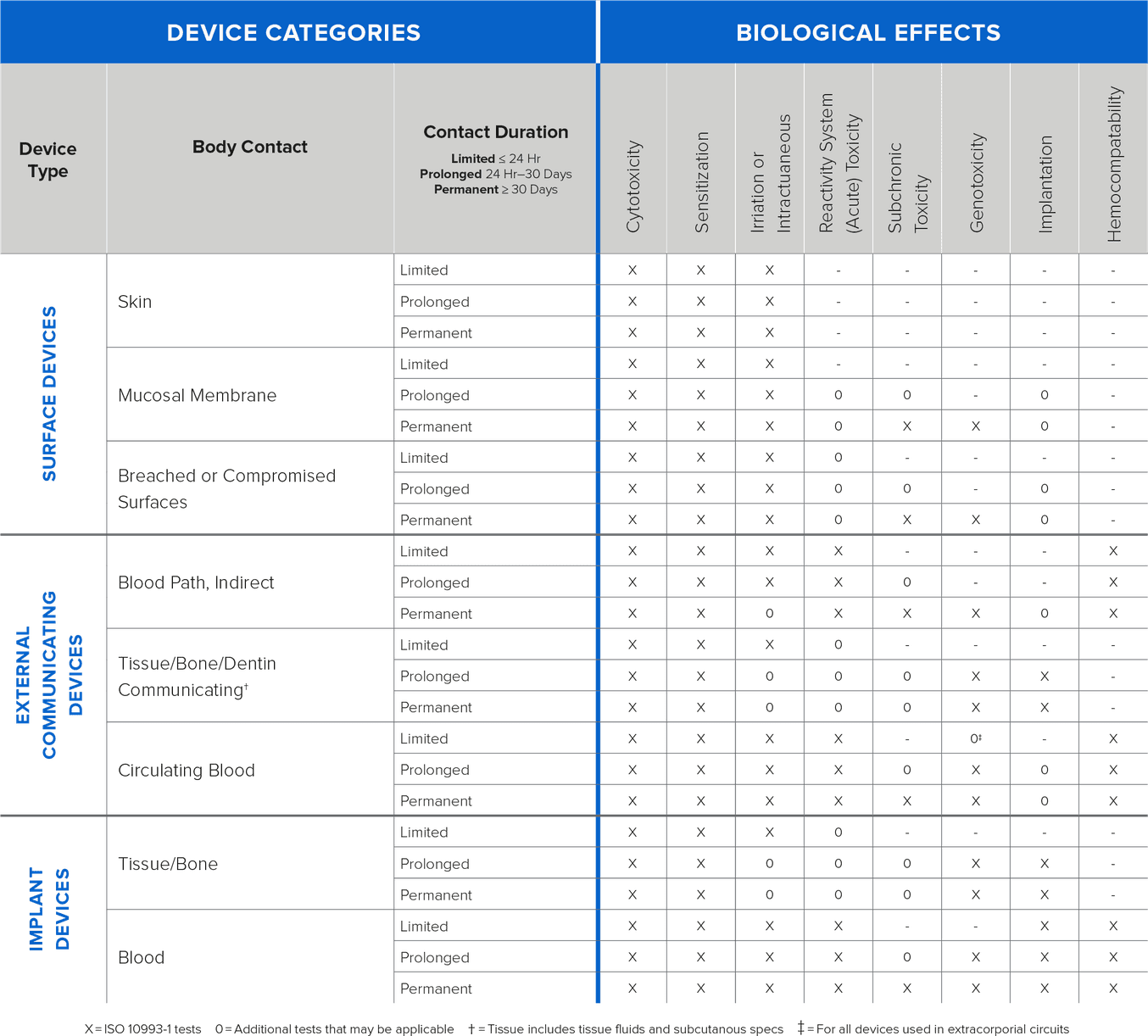

Biocompatibility testing requirements should be determined based on intended use of the device (type, area, and duration of exposure). Determining testing requirements early in the development process will allow ample time to complete testing prior to submission and should stem from the expected contact between the device and the human body. Contact is typically defined by three different categories:
Direct Contact: Comes into physical contact with the patient.
Indirect Contact: Comes into physical contact with a fluid, gas, or other material that then has direct contact with the patient.
No Contact: Does not have direct or indirect contact with the patient and is therefore exempt from biocompatibility requirements.
{Information on types of testing based on contact and duration}
Formlabs conducts biocompatibility testing based on ISO 10993, ISO 18562, and ISO 7405 standards and publishes the information on relevant resins. As the testing is conducted on standardized printed samples, manufacturers with complex design geometries, and other modifications must validate biocompatibility of the finished devices for their intended use.
