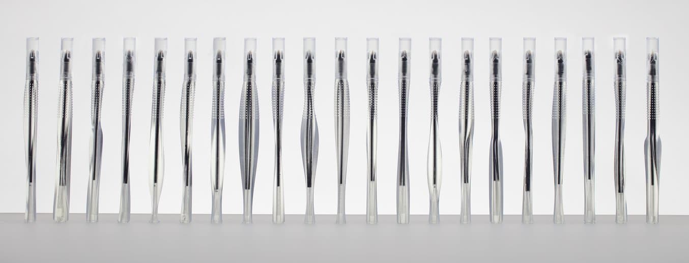

Since the digital factory of the future promises mass customization at no extra cost, we decided to parametrically generate a few hundred design options so each attendee could leave with a one-of-a-kind pen. The pens were designed with an eye toward a future where everyday objects are customized for individual users.

We decided to parametrically generate a few hundred design options so each conference attendee could leave with a one-of-a-kind pen.

For the sake of internal organization, we came up with a naming system that exported each generated pen into one of six groups (A through F), with each group comprised of 100 pens. This made it easier to move from a directory full of STL files to our PreForm software. Since the pens were meant to be giveaways, we did not label the pens themselves with a serial number. In hindsight, naming each pen would have enabled us to reprint a particular design if it were in higher demand.

The pen enclosure is essentially a surface lofted over three regular polygons with varying properties. The animation below shows the three distinct parameters of the polygon:
  • The radius of the polygon’s outer bounding circle.
  • The number of sides on the polygon.
  • The position of the polygons along the length of the pen.
  • The rotation angle of the polygon in its own plane.
For the third parameter, we varied the position of polygons along the length of the pen.
The total length of the tube is 115 mm, with two circles of a 8.1 mm radius on either end. These gaps in between the polygon ranges ensure that the loft does not lead to sudden drastic twists and turns, which might lead to undesirable intersecting surfaces.

These simple parameters allow for upwards of 1 million combinations.
