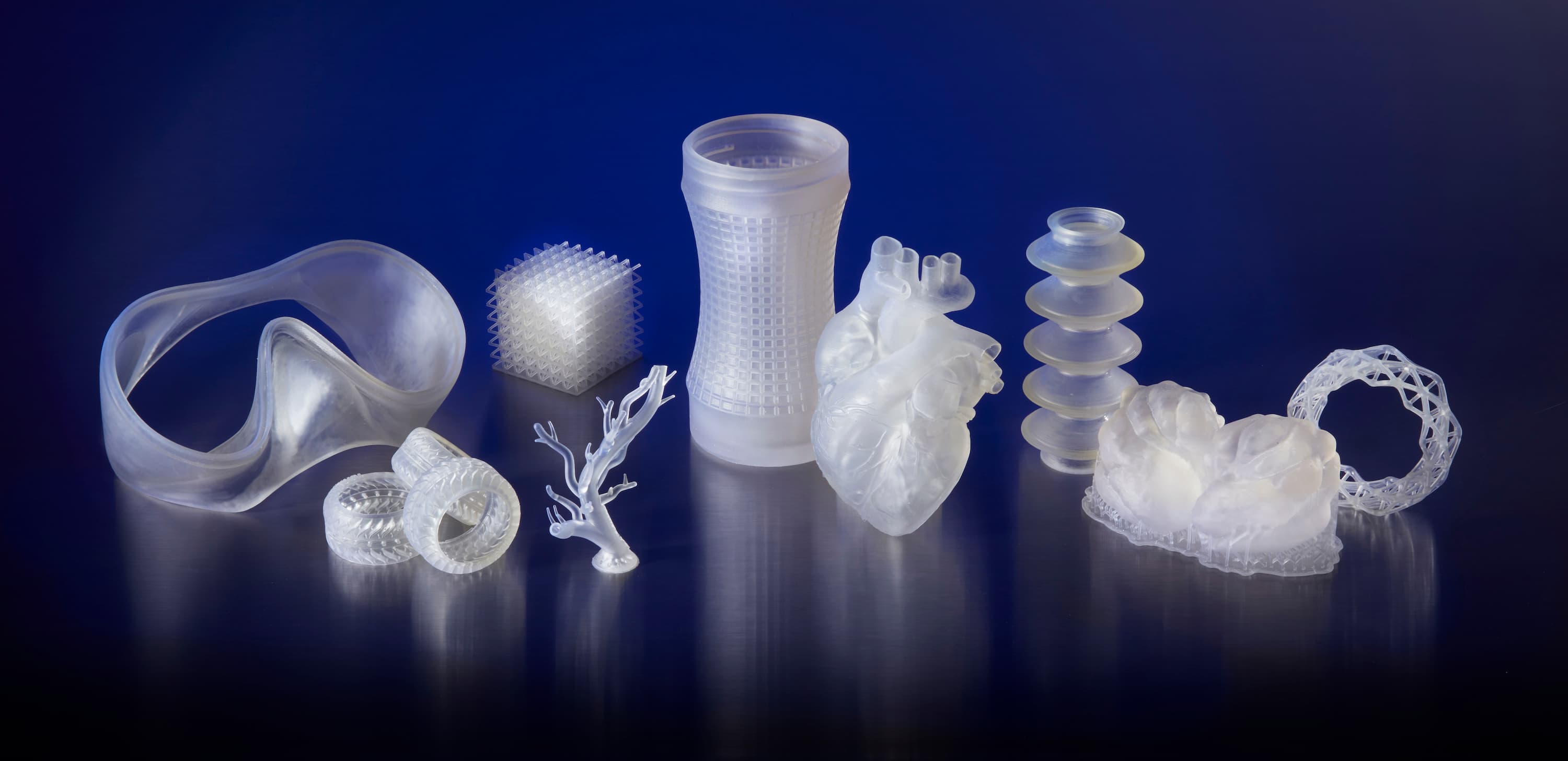

Flexible 50A Resin is an elastomeric material designed for applications requiring high elongation and high energy return. Use Flexible 50A Resin for parts that will bend, stretch, compress, and hold up to repeated cycles without tearing. Elastic is transparent, which makes it well suited for medical models for simulation or education. To learn more about potential applications for this material, read the blog post Introducing Elastic Resin: A Soft, Resilient 3D Printing Material (English only).
Note:
As of June 9, 2026, Elastic 50A Resin V2 has been renamed to Flexible 50A Resin. This better describes its performance relative to other flexible Formlabs resins.
Recommended for:
  • Wearables and consumer goods prototyping
  • Medical models and devices
  • Compliant features for robotics
  • Special effects props and models
