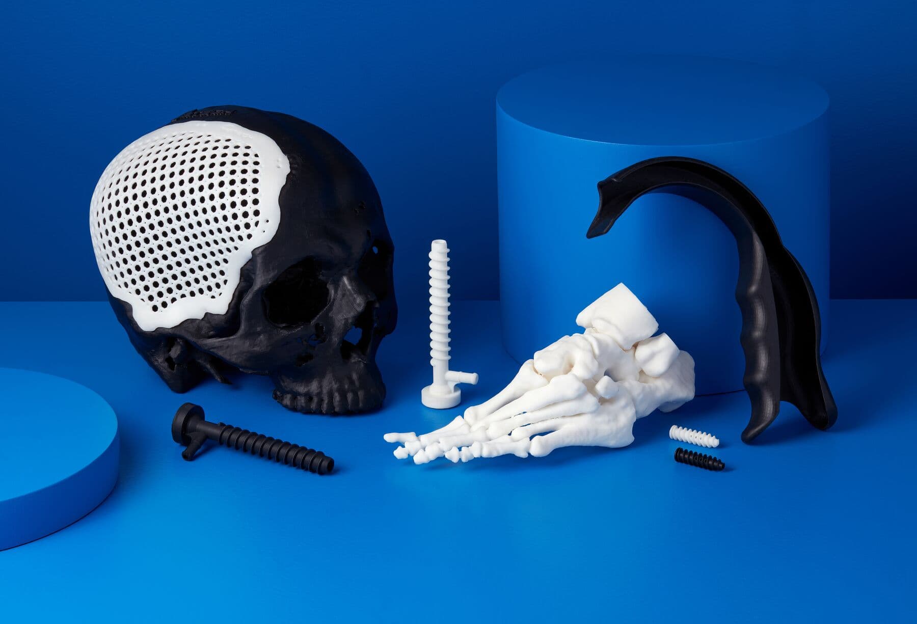

Medical models and fixtures printed with BioMed Black and White Resins
