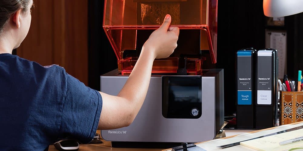

Ultimately, we decided that the best option was to start pre-heating sooner. Through research and testing, we identified three actions that indicate a user is starting a print:
- Interacting with the printer’s touch screen
- Opening the printer’s cover
- Uploading a print to the printer
Any of these behaviors trigger the Form 2’s heater to turn on and begin the pre-heating process. If a print isn’t started within 30 minutes, the heater automatically turns off.
Many Form 2 users print multiple builds in a row. To reduce downtime between prints, the tank also remains heated for 30 minutes after a print has completed.
