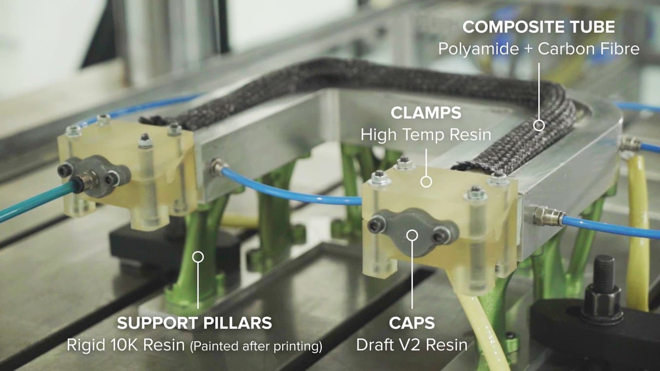

IGESTEK’s team also uses 3D printing beyond prototyping, to produce rapid tooling for producing composite parts, such as thermoforming carbon prepregs.
“Formlabs resins, such as Rigid 10K and High Temp are quite useful for engineering purposes. We usually work with composite compression thermoforming technologies. To work with a press, the tool needs to be stiff and heat-resistant, because you're using pressure [to form the composite parts] and also high temperature, usually 180 degrees or 200 degrees,” said Nerea Romero, Innovation Manager at IGESTEK.
This thermoforming rig for composite tubes was built using a variety of 3D printed parts.
One recent example is a tool that the team developed to manufacture composite tubes. They used Rigid 10K Resin to produce the support pillars of the rig that required high stiffness, High Temp Resin to produce the clamps that needed to withstand high temperature and air pressure, and Draft Resin to quickly produce end caps for the tool.
“[If we didn’t have access to 3D printing], we’d have to produce it with metal, which obviously takes more time and is more expensive. With 3D printing, we have the quick answer for what we are researching. If something doesn't work, we can just print another prototype and improve it," said Romero.

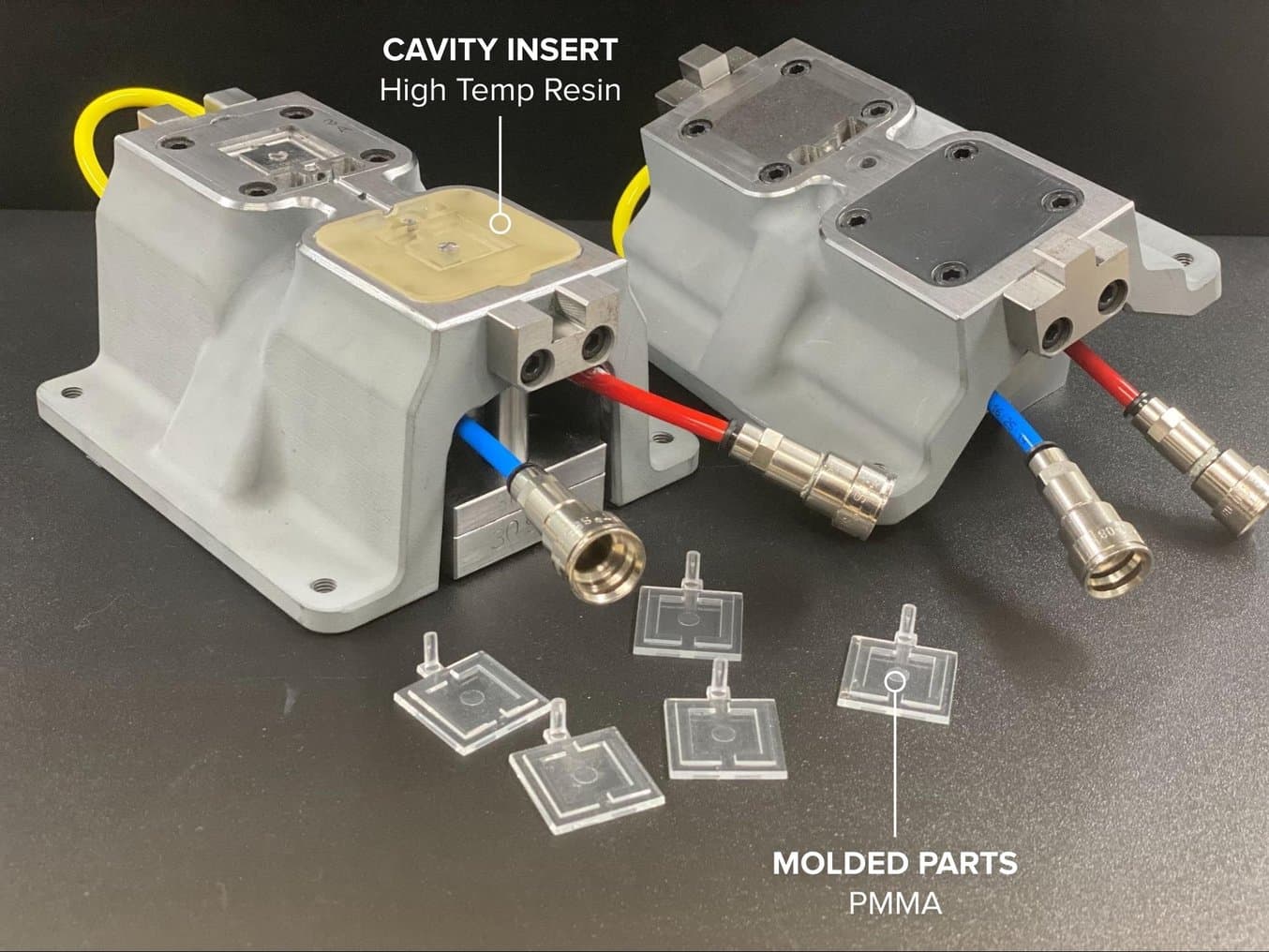

IGESTEK’s team also uses 3D printing to create mold inserts for injection molding plastic parts. Traditionally, they’d machine these inserts out of aluminum and steel—in-house for simple parts and outsourced for more complex molds—but this incurs high costs and long lead times, especially for one-off or low-volume prototypes.
With a recent example of an injection mold insert for manufacturing a component for the exterior cover of a car, 3D printing allowed the team to reduce costs and lead time to less than a third of the original.
Injection Mold Insert | 3D Printed | Machined Metal |
Cost | 300€ | 1000€ |
Lead time | 10 hours | 30 hours |
The mold has two cavities: one cavity is made of a metal insert and the other cavity is a custom 3D printed insert that contains the negative of the design. For prototyping, this is ideal, because the team can easily change the 3D printed inserts and test different iterations rapidly.
“For the prototype phase, you only need a few components that will be assembled with other components to test the symmetry of everything. With 20 or 50 components, it's enough to prove what you're doing works," said Romero.
Injection molding setup for a PMMA car component, using mold insert printed in High Temp Resin.
The number of molded parts that can be obtained with a 3D printed insert depends mainly on three factors: molding material, injection system, and molding process parameters.
“It depends a lot on what type of material you're using for the injection molding or for the composite. Because for injection molding, for instance, if you're using plastic, which is reinforced with fibers, it's much more aggressive than conventional materials. So, [the insert] will be damaged earlier. Maybe you can obtain 20 components, but if you want to produce more, you just need to exchange the inserts to continue producing," said Romero.
