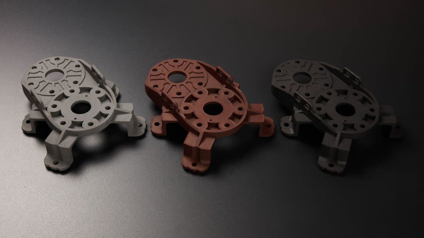

Nine copies of a 3D printed differential swerve drive top plate, each with a different finishing technique.
Post-processing techniques can change the appearance, texture, and performance of an SLS 3D printed part.

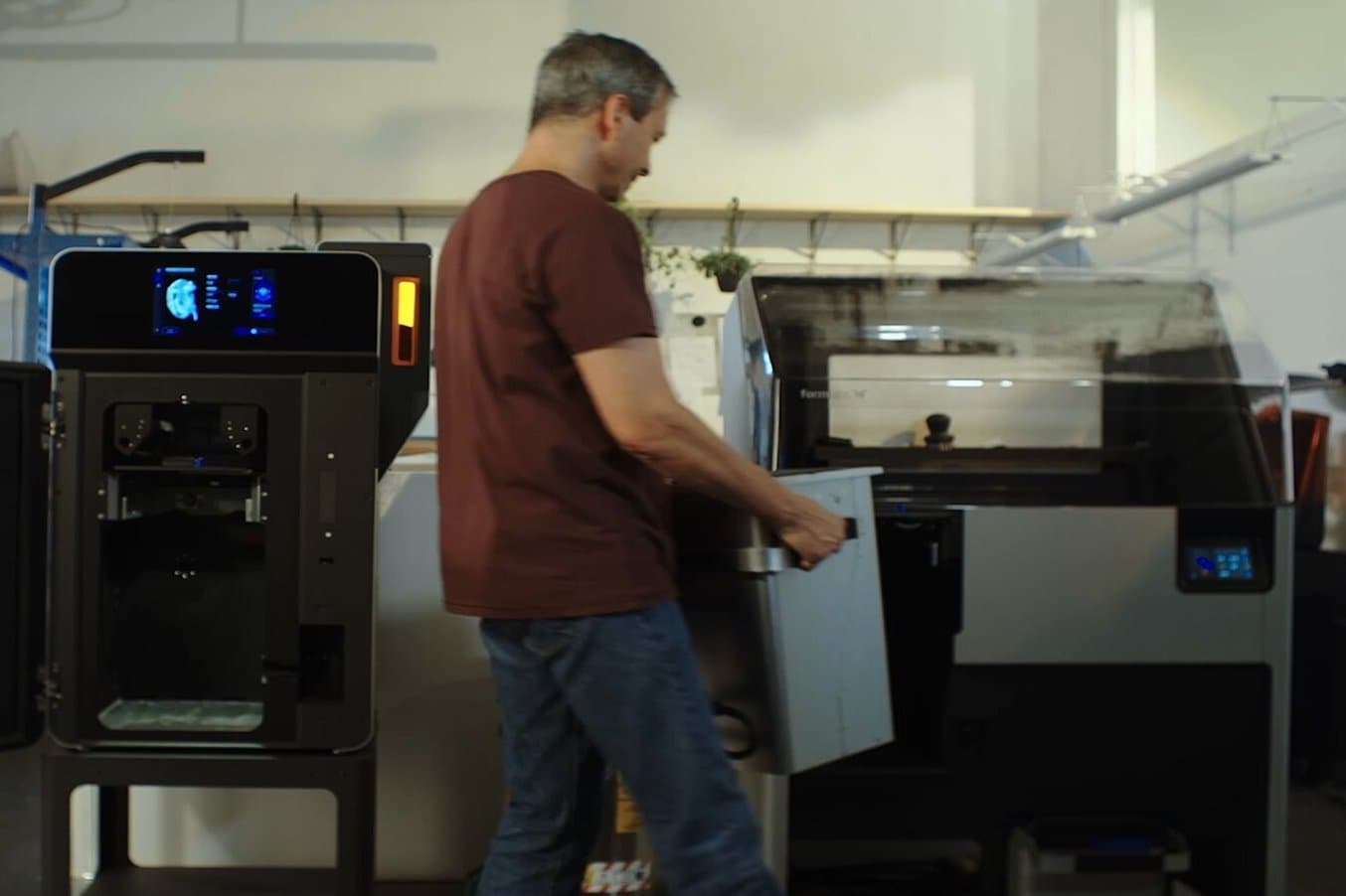

The Fuse Series allows the build chamber to be removed and transported to the Fuse Sift within just one to two hours of the print job concluding.
Person rolling out the Fuse X1 Build Unit
Once a print completes, the Build Unit is rolled out from the Fuse X1 printer to cool. Integrated insulation inside the Build Unit cools prints inside the unit, freeing the printer to start the next job while the last one is still cooling for near continuous operation.
The second stage of the cooldown process can take place with the build chamber already transferred into the Fuse Sift or Fuse Sift X1. Once the cooldown is complete, part extraction can begin. The Fuse Sift or Fuse Sift X1 will slowly raise the powder cake out of the build chamber, allowing you to separate sintered parts from unsintered powder, while a fan pulls any dispersed powder into a filter. The unsintered powder should fall away from the prints with the touch of your hand, exposing the completed prints.
When using Fuse Blast, operators can spend as little as five minutes extracting parts from the powder cake in the Fuse Sift or Fuse Sift X1 before moving the still-powdery parts into the basket for cleaning. When using other media blasters, we recommend removing loose powder and semi-sintered Surface Armor with the provided brushes in the Fuse Sift or Fuse Sift X1 to avoid media contamination.

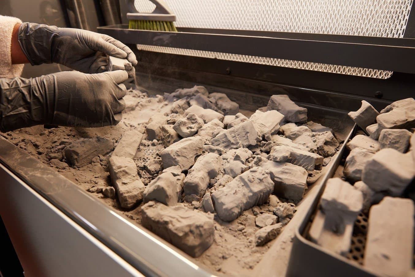

Step 2: Powder Recovery
Any powder left unsintered after a Fuse Series print can be recycled and used again, reducing waste and material costs. The Fuse Sift recovers loose powder and tumbles it to mix with fresh powder for use in future prints. The recovered powder from the Fuse Sift X1 is moved via the Fuse X1 Vacuum Conveyor to the Mix Kit, where new powder is mixed in. The percentage of new powder added is called the refresh rate, which can vary between different manufacturers’ machines, materials, and printing environments.

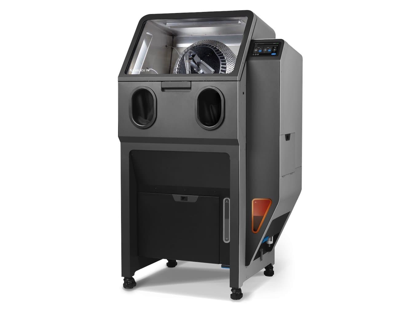

Formlabs’ Fuse Blast is the first affordable, automated media blasting solution that can complete either a Fuse Series SLS ecosystem or act as a printer-agnostic media blaster for other types of powder bed fusion 3D printers.

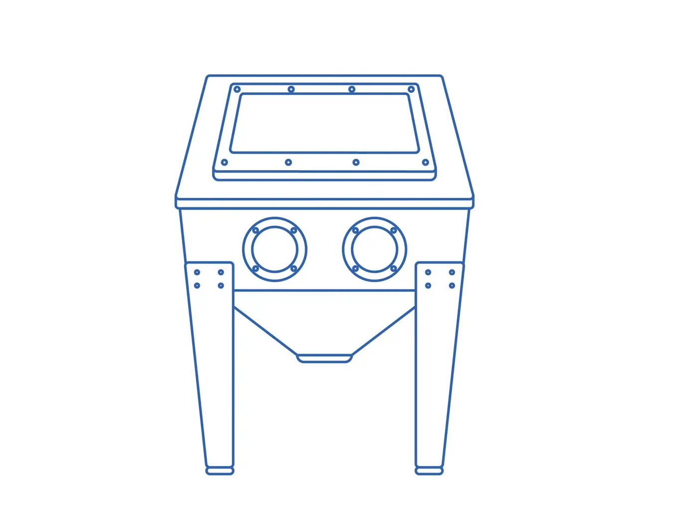

a manual media blaster
Manual media blasting cabinets are often accessibly priced, but require hands-on labor and make it harder to achieve a consistent finish.
the Fuse Blast
Fuse Blast delivers hands-free, automated, professional-grade SLS part cleaning at an accessible price and size.
automated blasting cabinet
Traditional automated blasting solutions are very expensive, large, and often require complex infrastructure.
Fuse Blast enables hands-free part cleaning in as little as 10 minutes thanks to a combination of basket rotation, compressed air, and abrasive media, and ensures consistent results thanks to the pre-programmed routines. Parts will come out clean-to-the-touch thanks to the in-line ionizer that prevents loose powder from resettling on the parts.
The High Capacity Kit can be added to Fuse Blast. This unlocks bigger batches on Fuse Blast, making it great for Fuse X1 users as well as those running multiple Fuse 1/+ printers.
Automating the powder removal and cleaning process not only frees up operators' time for high-value tasks but also reduces wear and tear on their bodies as well as the ventilation systems in their workspace. The option to add the Fuse Blast Polishing System streamlines a manual workflow that used to take multiple machines and hours of physically demanding labor.

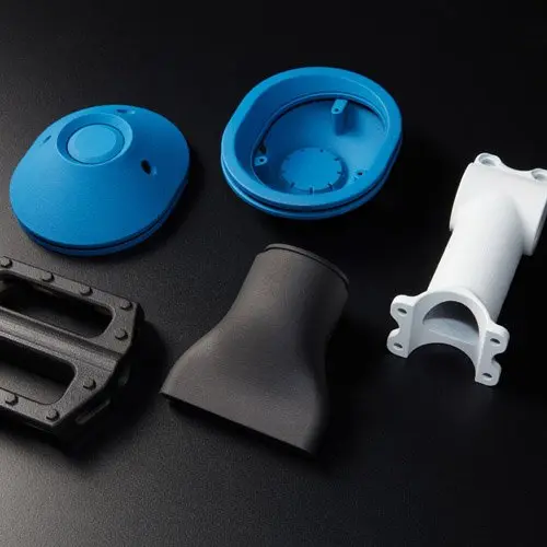

Overview of Advanced SLS Post-Processing Techniques
Smoothing, coating, and coloring processes can add mechanical benefits as well as aesthetics improvements to SLS 3D printed parts. Each of these processes has its own benefits and drawbacks, and each can impact different material properties to different degrees. When considering these workflows, including whether to bring the equipment and skills in-house or have it outsourced, it is important to consider the capital cost and skill required.
The summary below shows the barrier to entry and potential outcomes of different advanced post-processing techniques on SLS 3D printed parts.
MethodBarrier to Entry (Cost & Skill)SmoothnessChemical ResistanceSurface HardnessColorConductivity
PolishingLow
DyeingLow
Vibratory TumblingLow
PaintingLow✔✔
Liquid Polymer CoatingLow✔✔
Ceramic CoatingHigh✔✔✔✔
Powder CoatingHigh✔✔
ElectroplatingHigh✔✔
Vapor SmoothingHighest✔✔
These steps can be done in sequence to achieve multiple attributes. In this article, we will discuss each option separately. If you are interested in stacking post-processing techniques to achieve a specific outcome, contact our team to speak with a specialist who can consult on your use case.

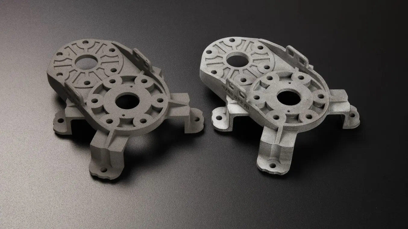

Polishing
Media polishing uses a stream of specialty plastic media, designed specifically for polishing, and propelled at high pressure to compact the part surface, reducing roughness and porosity, leaving a glossy and dye-ready finish. The media used for polishing is a highly spherical specialty formulation, unlike granulated plastic used in standard blasting. The results of media polishing are similar to those of vibratory tumbling, but because the media is concentrated on specific surfaces, the process is much quicker — typically 15 minutes on the Fuse Blast, compared to tumbling for two to four hours.
With the Fuse Blast Polishing System upgrade, you can go beyond cleaning to surface finishing with an all-in-one system. Polishing parts in Fuse Blast will allow you to clean and surface your parts in one step, delivering parts that are not only powder-free, but also smooth, scuff-resistant, and dye-ready with a professional semi-gloss finish in as little as 15 minutes. This step can be done automatically thanks to the pre-programmed routines, or manually for delicate or intricate parts, by controlling the nozzle and aiming it directly at parts.
Parts cleaned and polished side-by-side. Cleaned parts are powder free and clean to the touch, while polished parts show a smooth, semi-gloss finish.
Deliver parts with a smooth, semi-gloss surface finish thanks to the Fuse Blast Polishing System add-on.

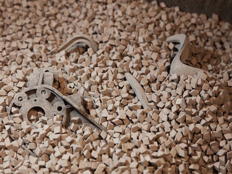

Vibratory Tumbling
Vibratory tumbling, also known as vibro-polishing or media tumbling, is a finishing process that smooths the surface of SLS 3D printed parts by placing them in a tumbler with other media. This produces a matte to semi-gloss finish that is satiny smooth to the touch. In our experiments, we observed an average reduction in surface roughness of 80%.
Vibro-polishing machines have a bowl, barrel, or tumbler that agitates the parts alongside pellets of media, such as ceramic chips, plastic pellets, or organic material like walnut shells, that gently abrade the surface. Cycle times typically vary from two to eight hours, and machines can run without a technician’s supervision.
Vibratory tumblers start at $100 for small benchtop models, making them an economical choice for any manufacturing setting. Larger, free-standing models are better suited for high-throughput production, and start around $3,000.

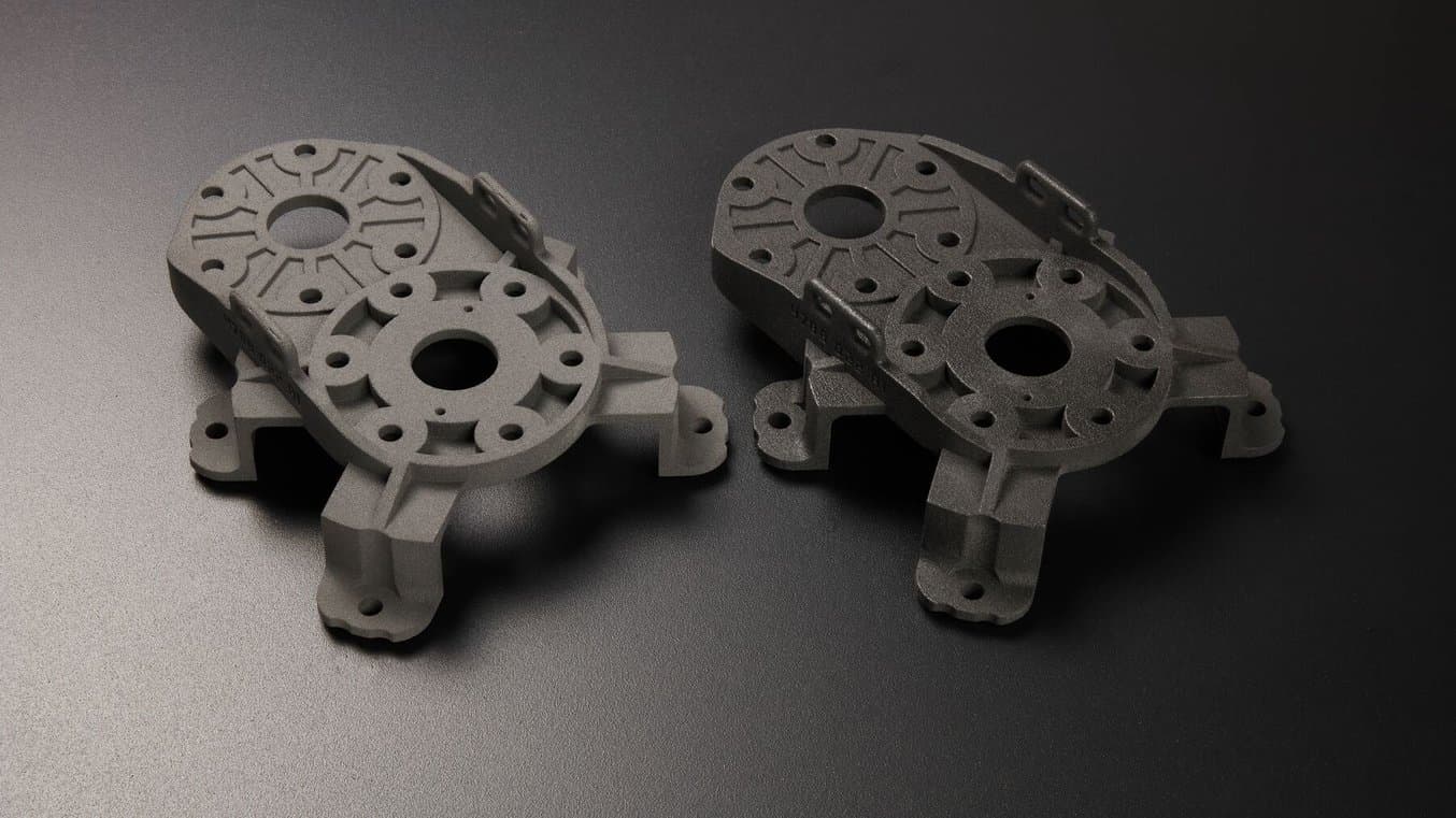

The part pictured below was tumbled with ceramic media in the Mr. Deburr 300DB for six hours.
Our test piece, before and after vibratory tumbling. The tumbled part is light gray and matte in appearance.

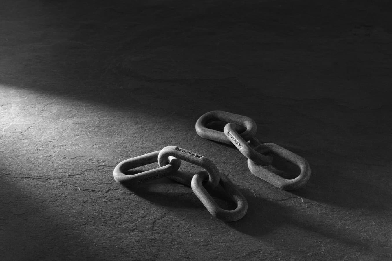

two chain links printed on an SLS printer
Sample part
Request a Free Tumbled Nylon 11 CF Powder Sample
This SLS interlocking chain was fully printed in place and would be near impossible to finish using manual methods. The part was tumbled overnight in a DB-300 vibratory tumbler filled with angle cut ceramic triangle media. The improved surface is ideal for painting, coating, and electroplating.

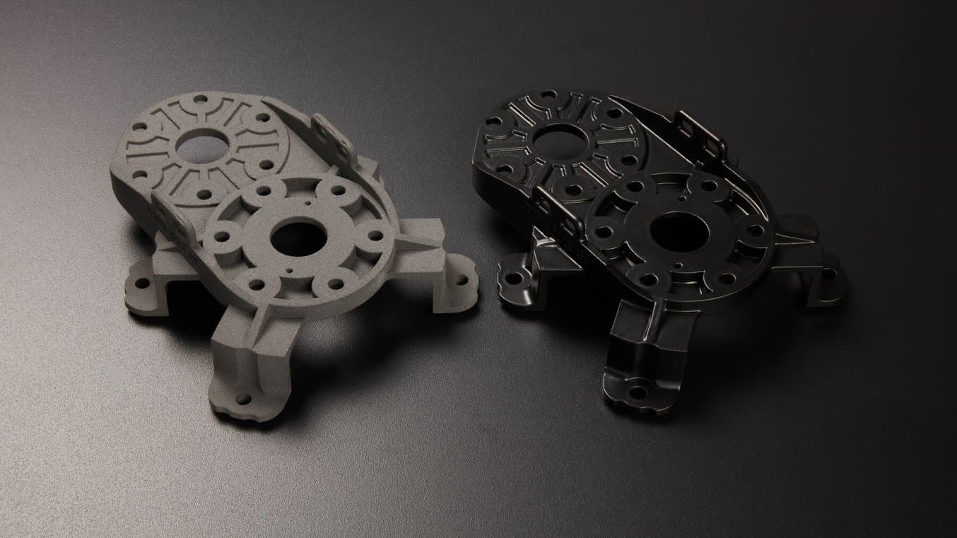

The part pictured below was vapor smoothed by DyeMansion, using a proprietary vapor mix. AMT also provides vapor smoothing equipment and services.
Our test piece, before and after vapor smoothing. The smoothed part is black and glossy in appearance.

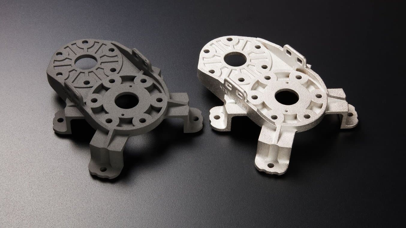

Metal
Coating 3D printed parts in metal may be done through electroplating, also known as electrodeposition. In this process, the 3D printed part is first coated in a conductive spray, then submerged in a chemical bath, where an electrical current transfers metal from a source material (the anode) to the surface of the 3D printed part (the cathode).
Parts can be plated in many metals, including chromium, nickel, zinc, and titanium. Manufacturers will sometimes layer multiple types of metals sequentially to achieve the right balance of mechanical, electrical, and cosmetic properties.
Although it is possible to electroplate SLS printed parts with a home or DIY setup, inexperienced users risk exposure to hazardous chemicals and may struggle to get a quality result. For any structural parts, we recommend sending parts to a specialized contract manufacturer. Download our white paper for a list of electroplating services by region and job size.
The part pictured below was plated with nickel by RePliForm, Inc.
Our test piece, before and after electroplating. The plated part is silver and metallic in appearance.

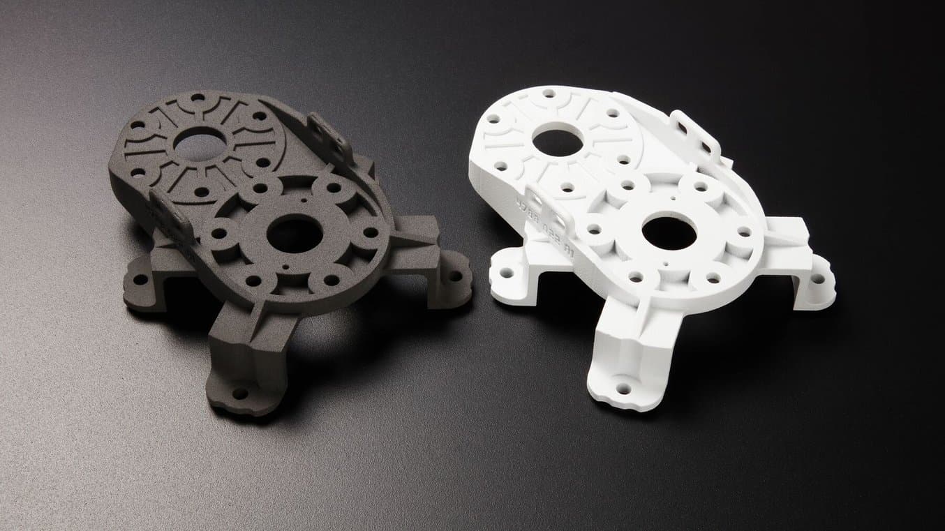

Options for Coloring SLS Parts
Whether for prototypes or final parts, you may wish to modify the color of all or some of a part. Dyeing results in a consistent, semi-permanent color, even in hinges and interior cavities, but it isn’t possible to use dyeing to lighten the color of a part. Painting offers more control and customizability, but is typically a more manual process and may chip with abrasion or heavy use.
Dyeing
Because SLS 3D printed parts are porous, they can be dyed with consumer-grade dyes. Many SLS 3D printing materials are nylon or polyamide, which are also used in textiles, so fabric dye designed for use with synthetics should suit.
Dyeing 3D printed parts can be done with household materials, in industrial vats, or with any level of sophistication in between. Whatever your setup, parts 3D printed in a nylon-based material, like those available on the Fuse Series, shouldn’t require any special steps—the directions recommended by the dye manufacturer should suffice.
Because the barrier to entry is low on both cost and skill level required, dyeing is a great way to experiment with advanced post-processing of SLS 3D prints. And, because it scales easily, it’s also suitable for production applications.
The parts pictured below were dyed with RIT fabric dye.
Our test piece, before and after dyeing. One dyed part is black and matte in appearance and the other is dark red and matte.

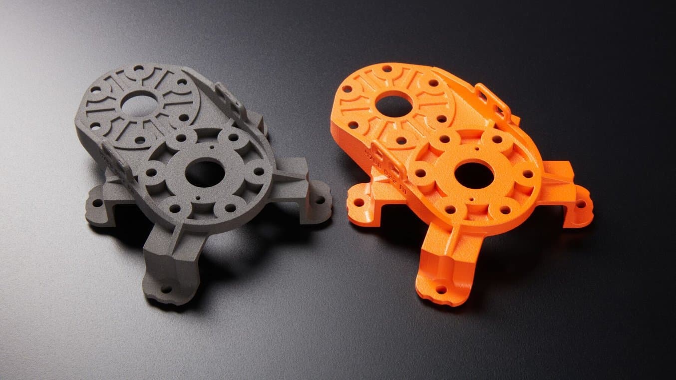

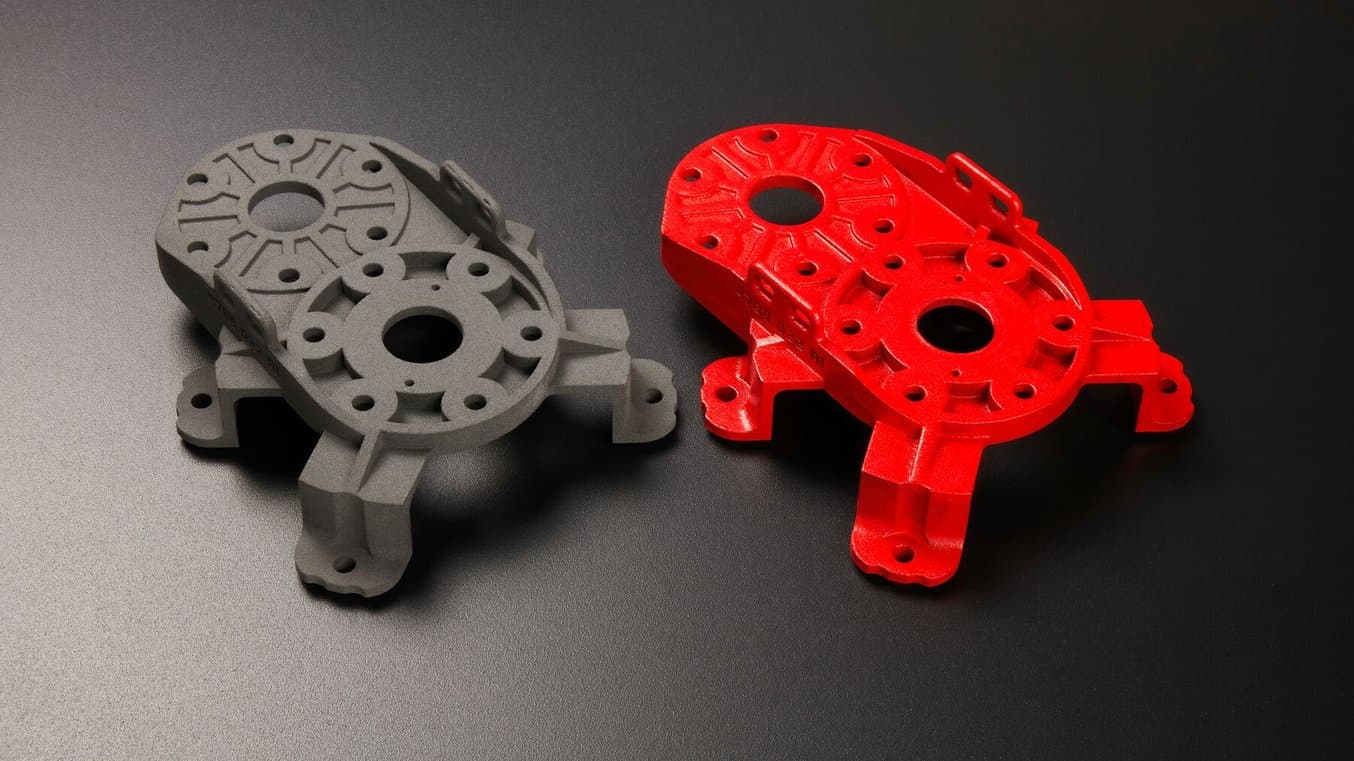

Painting
Painting may be preferable to dyeing when parts need to be brightly colored or color-matched to a reference. Spray painting provides the most even coverage and easier scalability, while painting by hand allows for greater detail. Both acrylic and enamel paints work well with powder printed parts. Other paints may work well, but Formlabs has not extensively tested these.
For best adhesion, use a primer that is designed for use with plastics. Spraying primer results in more consistent coverage. Additionally, a heat gun or hair dryer can be used to accelerate the drying process.
For an in-depth tutorial on spray painting 3D prints, check out our priming and painting guide.
 The part pictured below was painted with an inexpensive spray paint.
Our test piece, before and after painting. The painted part is bright red and glossy in appearance.
