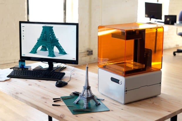

While printing, the Form 1 is whisper quiet — it can sit unobtrusively on your desk. It does, however, make a few unique sounds — particularly when starting a print.
